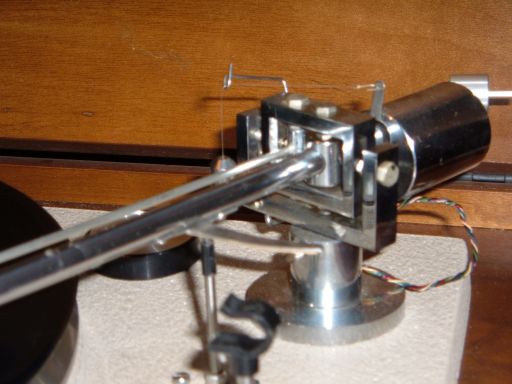

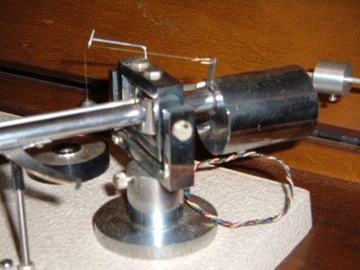

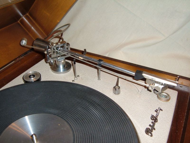

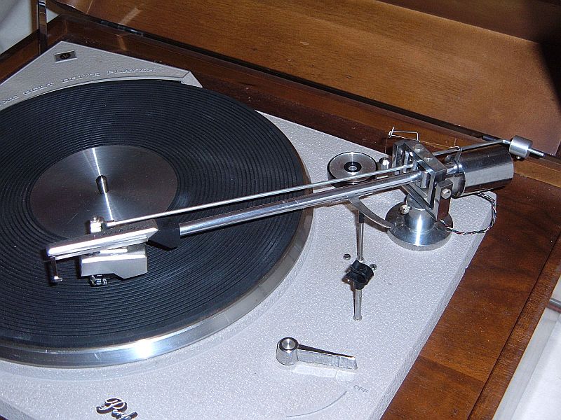

I am new to this group and I have been following this thread with interest. There have been many great posts and the I have enjoyed reading them.
I have a turntable that I have owned for about 25 years. It is a JVC Nivico Perfect Tracking. In all that time I have never seen or heard of another one except for one sold in Malaysia. It is a large turntable probably made in the 1970s. The most interesting thing about it is the tonearm. It is a tangential tracking arm. It is nicely made with a jeweled movement. If anyone can tell me anything at all about it I would love to hear what they have to say. It plays well and sounds good. The cartridge is a Shure X8.
Can anyone tell me about this tonearm ?

Hello robertmc48
I've never seen that tonearm before but it looks to be functioning like the Garrard Zero-100. Thanks for posting the pictures.

Hi, robertmc48
Your tonearm does indeed seem to be the same design as the Garrard Zero-100 (Klein, U.S. pat. #2983517, or British equivalent from A.B. Say). Do you still have the manual it had originally? Can you post any of it if you do? Thanks for sharing this player with us!

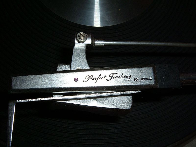

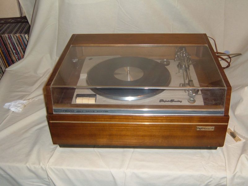

Sad to say I have no information about this tonearm. I have had a search on Ebay for about 10-12 years and one has never come up. I don't even know if it has a model number. I had it playing tonight and it plays very nice.
Wow. Thanks for posting and sharing with us such an interesting tonearm. As others have mentioned, it looks to be a Japanese copy of the Garrard Zero 100, except the guiding rod is on the left side of the main armwand, whereas Garrard is on the right. Looks like better pivot quality and well constructed. And the anti-skating uses a more conventional string and weight design than magnets. To me it's more attractive than the flimsy Garrard.

I am glad that some of you have enjoyed seeing this turntable. I have owned it for about 25 years and it always gets a lot of comments when it is seen by someone who appreciates turntables. I have owned many turntables over the years but this one remains a favorite. I think it looks better in person and it really does work and sound good.
