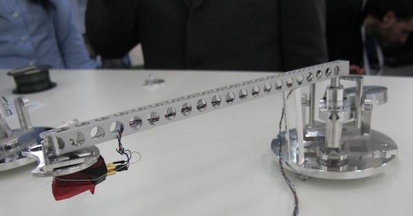

new product

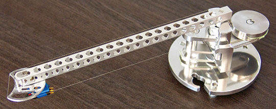

At the recent Munich High End Audio show, this new product fits the topic of this thread. The Schuch Tronic tangential arm uses strings to guide the pivoting headshell. Reminds me of the arm in post #349 and the mysterious DIY string arm.
I can see the advantage of eliminating rattling bearings via the string method, but how do you eliminate off axis forces? you may end up with the plane of the center of the tonearm pivot bearing at the pillar in an undesireable place. Still fascinated.
I wish there's a better close-up picture of the base area. I can't tell if the string is located on the same place as the pivot for vertical movement. For now, it appears to be over-engineered. Let's hope we'll find out more in the future.
I blew up some pictures to see better details.
I can see two tensioned springs - neither on the plane of the pivot, but possibly equidistant from it, and what seems to be a contrarotating balance weight. Hmmm. Are we moving into the "great theoretically if stuff always worked the way it is supposed to"?
Cheers Steve
Cheers Steve
