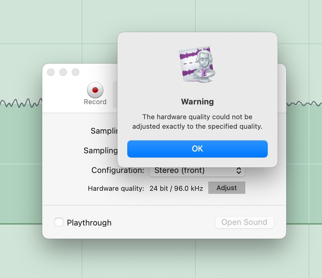

That all lists as float32 is a bit strange... no? I mean the output for speaker...
Now "Adjust" behaves a little different....
Thanks!

Could not detect any difference....
But as you can see, I'm in no way insightful in these matters...

Excellent, that's exactly the output needed.
.... a lot that I dont think has anything to do with the ADC
That's because you did not specify the VID PID of your device in the -d parameter (as written in https://www.diyaudio.com/community/threads/android-adc-usb-isolation.413723/post-7706383 ) and details of all USB devices were listed.
The descriptors say that Cosmos has 4 altsettings. Altsets 1-3 of PCM format for 16bit, 24bit (in 3 bytes), 32bit, and an altset 4 of unknown format 0x80000000 for 32bit (probably DSD, but I doubt the ADC can use that altsetting).
E.g. step by step:
1. confirming the device works in a regular OS (like your mac), direct connection, those formats you want.
2. dtto, with your isolation rig
If the above works OK, most likely your recording app has issues. IIUC it implements an UAC2 driver in user space, no easy job, it may be buggy.
