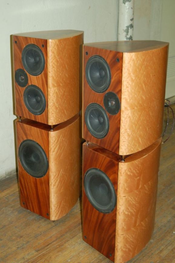

Very nice! Beautiful accents with the alternate veneer 🙂

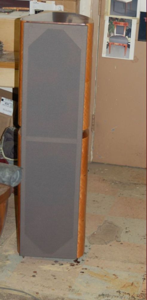

I see just 4 grille mounting holes, does this mean that if a grille were applied it would spread accross the two seperate units?
Any word on the sound yet? Certainly looks like a good design so will interesting to hear what you say about it 🙂

to see good ideas implemented in such a way that they appear flawless is really pretty cool. i wish i had your skills.
Thank you guys.
This system like any others has some problems and coloration. It's hard for me to compare this speaker to a well known commercial system because I simply don't have them around.
The crossover is relatively simple 2nd order L-R crossed at 300hz and 2400hz. Nothing really fancy there in terms of parts. Mid ranges and tweeter have simple impedance compensation (R-C).
Tweeter has a raising response towards upper range (this is a no ferro fluid version of seas T25) so I've notched it out with parallel notch filter. Objectively FR has a shallow wide deep between the woofer and midrange (not happy) and the tweeter is a bit rolled of on the top (very happy about it). I almost had an argument with my friend because I wanted to work on the x-over a bit more but he was in a hurry, leaving to Europe, so TA-TA.

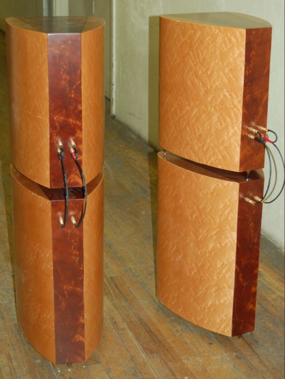

Yes, single grill for each speaker.
Crossover is broken down in 3 sections and located in both cabinets.

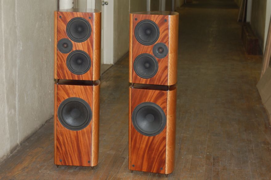

Wow, I'm a little late to the party, but these are some of the nicest pairs of loudspeakers I've seen!
Thanks guys. Unfortunately the happy owner thought so too and his 3 year old kinder pocked the drivers. 😱 The dust caps had to be sucked out back in shape.
