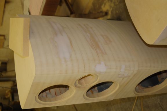

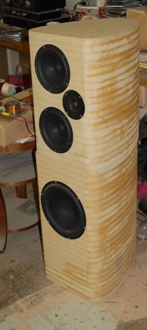

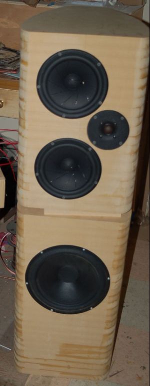

The speaker is in 2 parts and MTM will be separated from the woofer cabinet.
The internal diffraction I was trying to achieve didn't happen. Without dampening the cabinet rang just about as bad as if I'd make it square.
The rigidity of the walls however was quite a bit different. At high volume, walls vibrate allot less then a 1.5” thick flat top. I've added vertical bracing but decided not to attach the magnets to the bracing. I honestly don't see any point in it unless the basket is physically separated from the front panel. The tweeter has it's own enclosure and separated from the mid woofers by about 1.5” thick pocket walls.
Haven't done any measurements yet but put crossovers together with a drop of solder and eager hands.
Only had 3 hours to listen and the first impressions are strange. On Pink Floyd's “Pulse” the speakers disappear and “you are there”. Keith Jarret “Spheres” sounds amazing. Hissing thought out the recording is usually looked at as a defect, here it was obvious that it's the air coming out from organ pipes. Fist time I have heard mechanical clapping of organ on the background. Again there was no speakers, just music. On the “smaller” recordings like Dianna Krall or Holly Coll, it was exact opposite, the sound was coming out from 2 speakers and didn't form a cohesive sound stage. There's quite a bit of cheking and measuring to be done later.
The point is to share the reactive forces of the driver with more than the baffle (typically the weakest panel in the box). The point is to increase the downward dynamic range.
dave
I thought your idea is relative to Linkwitz Orion ++, there he is separating the basket of the driver from the front baffle and making front baffle less of the drum.
Dave, subjectively what is an audible difference between the speaker with attached and unattached drivers? What do you hear and is it clearly audible?
I was thinking of drilling a pair of holes and ¼ 20 with brass screws but scared to drill. I imagine it could be done with drivers that have aluminum backplate.
the result is greater downward dynamic range... the sound becomes less boxy (the rest of the box has to be designed with the concept in mind) becaue more of the box is involved in killing the driver reactive forces,
dave

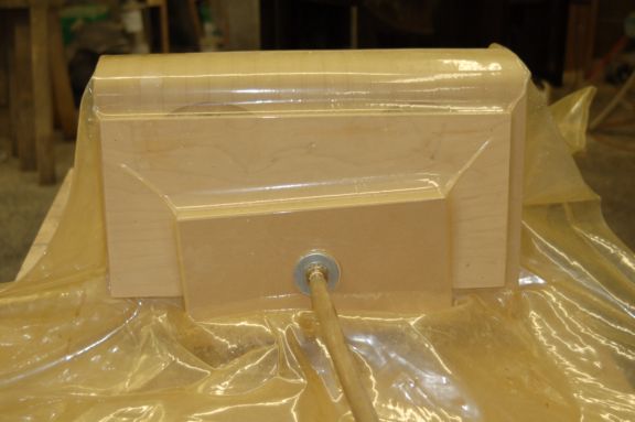

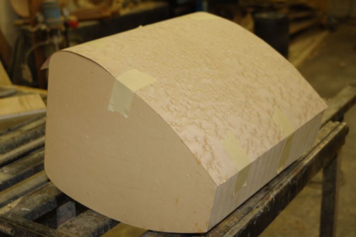

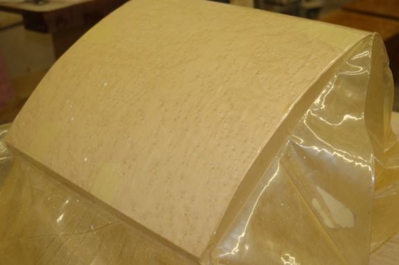

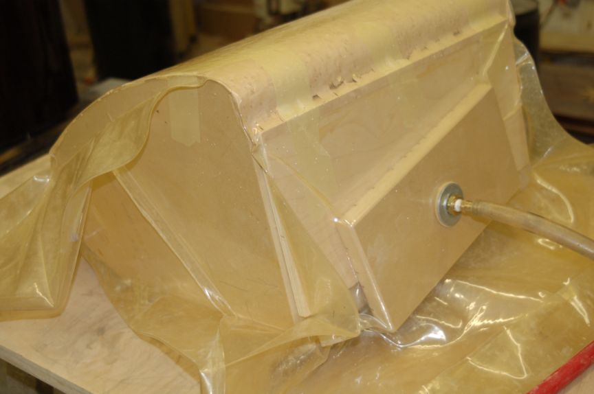

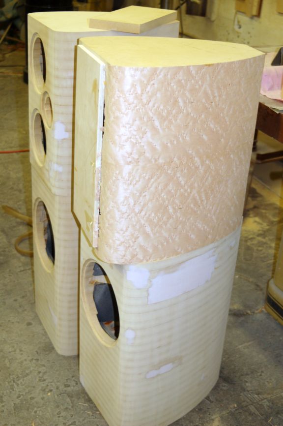

Veneer is trimmed, precut to size and joined. In this case I will be using just a bag itself to press the veneer against the MDF. The vertical corners are 4 inch radius and I'd like to have veneer go around, so I can't use Formica or Flex Form. The trick is to use just enough glue and spread it very evenly so it does not lamps up under veneer. I have a good old glue roller with reservoir but a paint roller can be used.
- And yet another trans lam for a friend.
