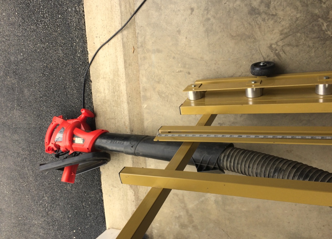

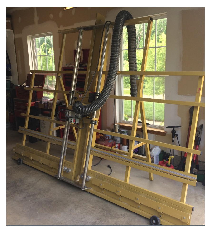

Always wanted one of these, now can check that off the bucket list.
Found it on Craigs List; a quick ride over to Alexandria Va (Ha, at 4:45am).
It is used, but not much.
Do you see some really big speaker cabinets in your future?

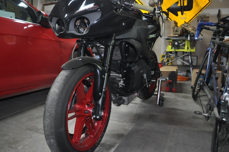

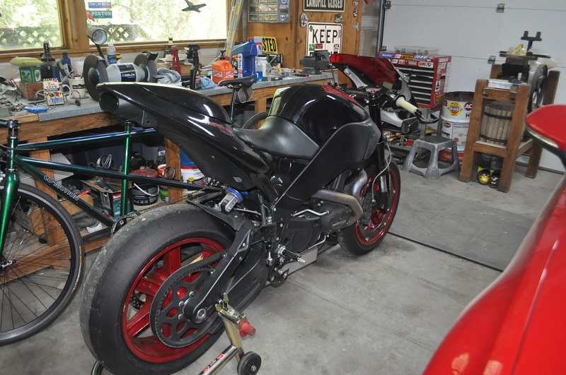

And given my nature on a bicycle, I'm not allowed to own a motorcycle. Or everyone should take a life insurance policy out on me. Pretty sure you'd find me at the bottom of some canyon after taking one corner too quick and finding gravel at the apex. At least having to power a bike myself means I can't get in trouble as fast. 🙂
There have been 5 collisions between me on a bicycle and a car in my lifetime. The last time I was broadsided in a crosswalk by an old guy who ran a red light and I was ticketed and charged with the accident! Motorcycle, no way! Bicycle, only on a trail or other place where cars are not allowed.
Yeah, I'm doing about 60-75 miles a week on the bicycle these days, but I stick to the local bike paths and stay off the streets. Fortunately we have a really nice system of bike paths around here.
Commuting 14 miles each way this time of year. I've had a couple run-ins with cars, unfortunately, but by and large cars are okay around here (and California previously).
I bike raced for a bit and like going downhill too quickly, ergo, no power for this guy. 🙂
