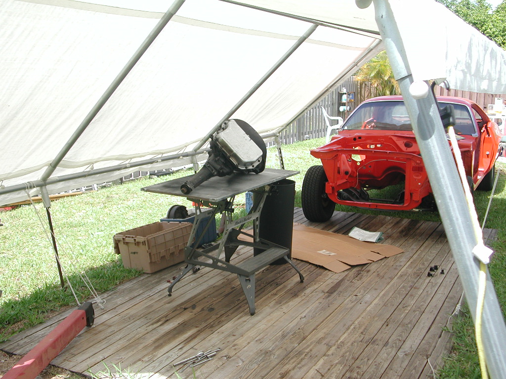

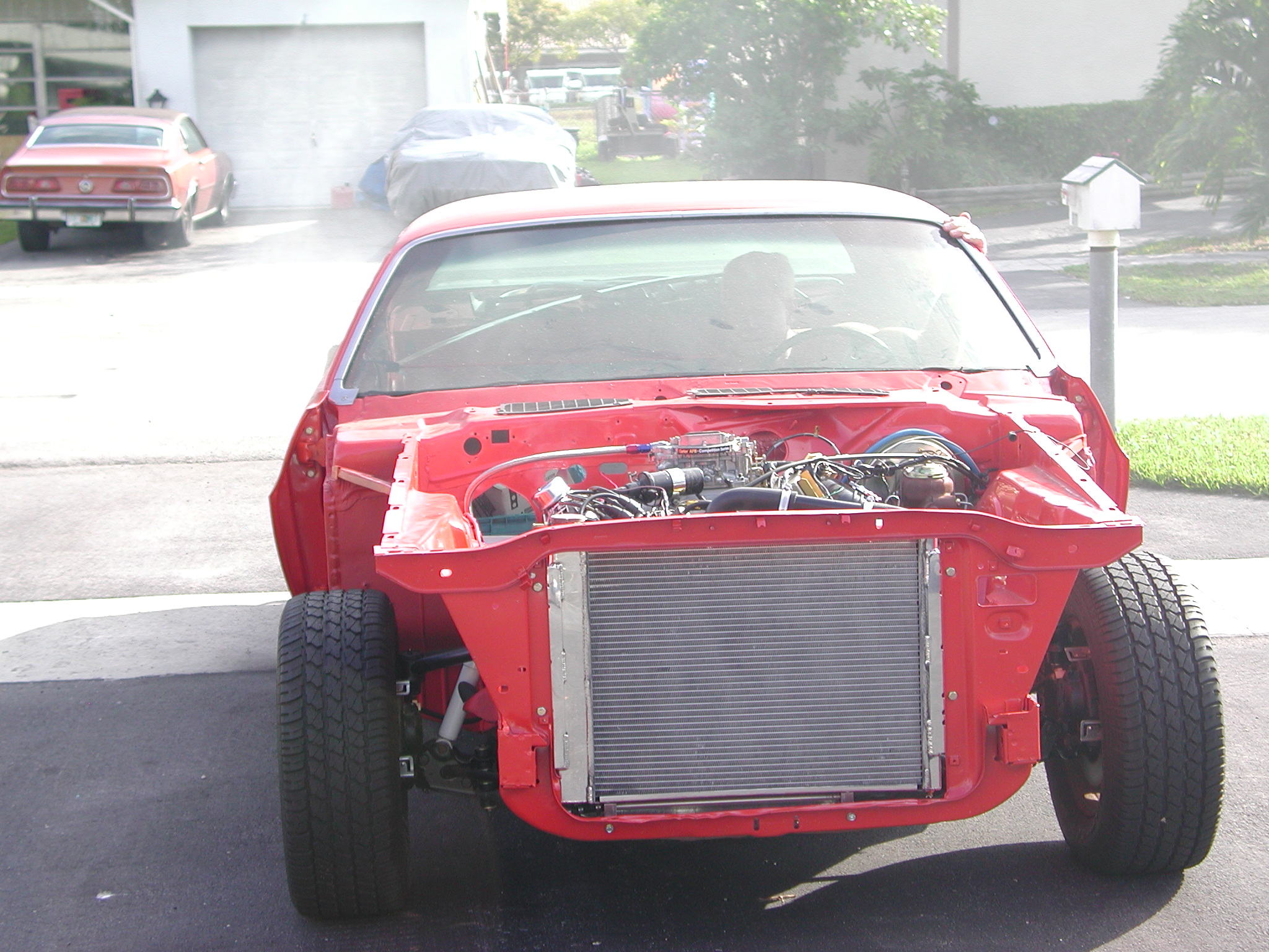

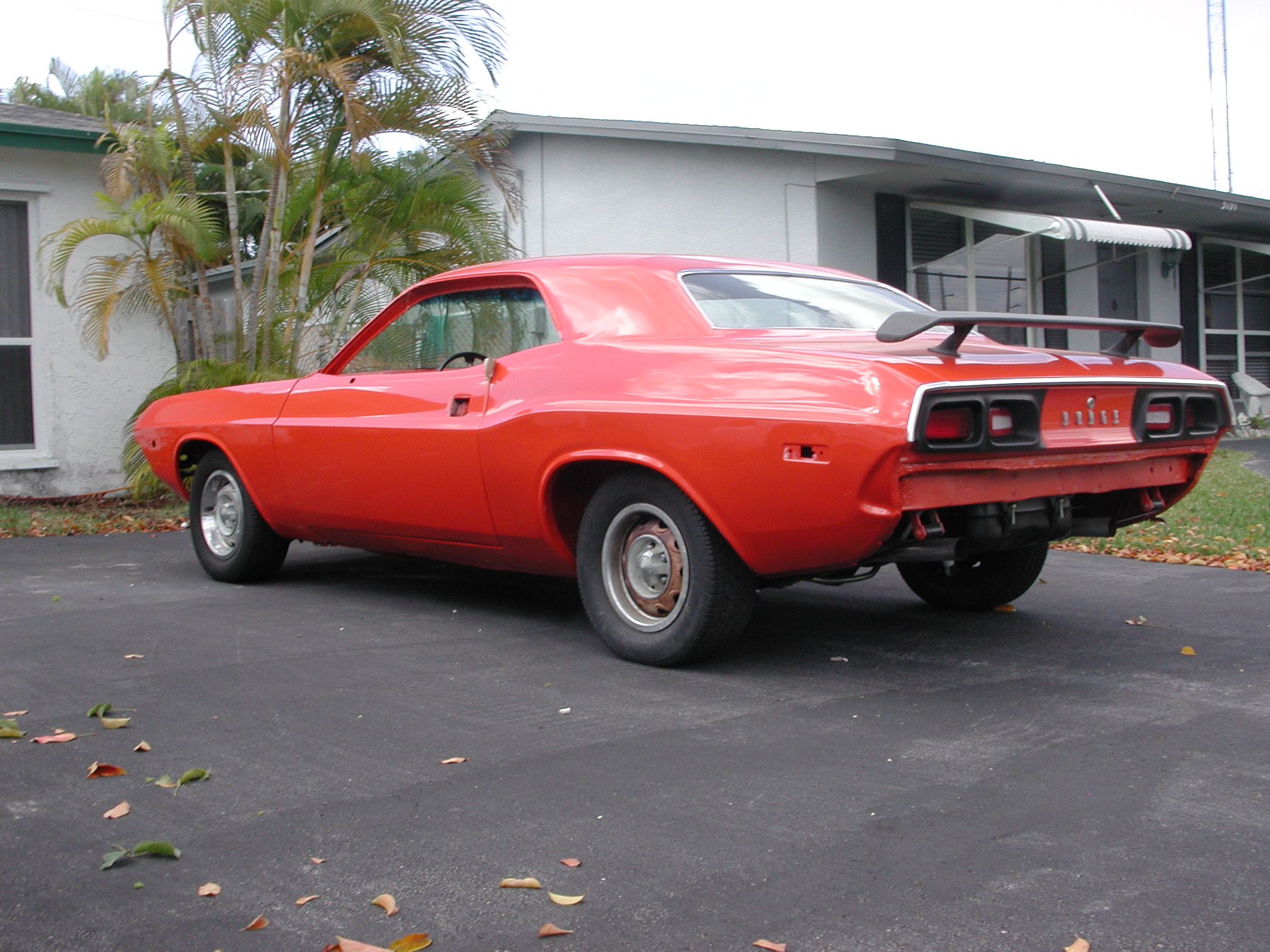

About 18 years ago I collected some parts and decided to build a car.

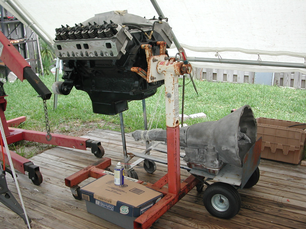

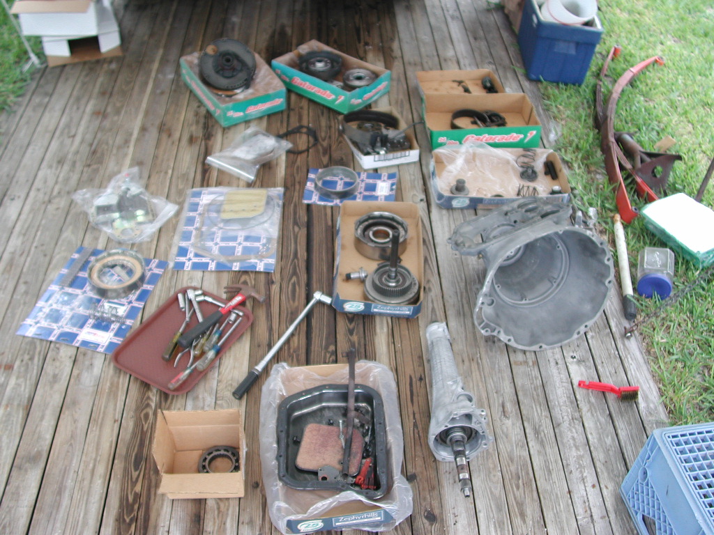

A well used and dead Torqueflite 727 Automatic transmission on the operating table. Some assembly required.....almost done....

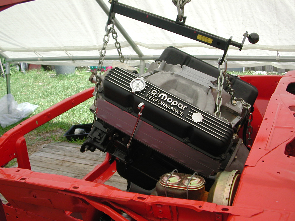

Add one 500+ HP 440 CID big block Mopar engine (bottom end professionally built due to necessary machine work and specialized tools) for loads of fun.
Open wide and say AH....Eat This! will it run?
Yes!

It's a 1973 Challenger that was originally grey and powered by a 318 CID small block. The 440 CID big block came out of a 1975 cop car as did the transmission.

I had a torsion bar let go on my '70 Coronet. When that happens, the flex line stretches and locks that brake full on. That was fun. So since we like you, please replace both on that nice rebuild. They let go without any warning at all.
Since I removed a small V8 and stuffed in a bigger V8 the torsion bars were replaced with larger units since they are essentially the springs in the front suspension.
Since the car was now heavier and faster than originally intended, the complete braking system was replaced with larger aftermarket parts. Braided stainless hoses were used.
