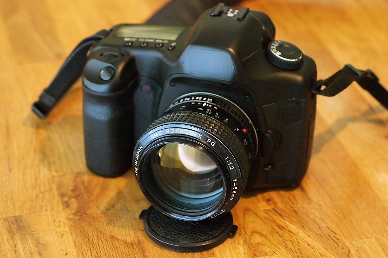

I used to buy "obsolete" film camera lenses and convert them to Canon EF mount to use on my 5D. My wife preferred to stick with autofocus.
By far my favourite lens to use on full frame digital is the Minolta Rokkor 58mm f1.2.
Here is one (of many I bought) mounted on my 5D after conversion:
attachment.php

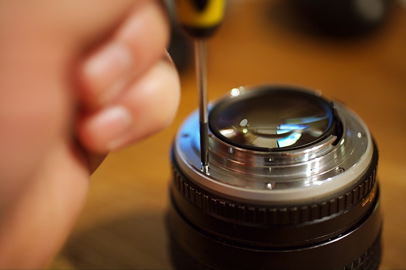

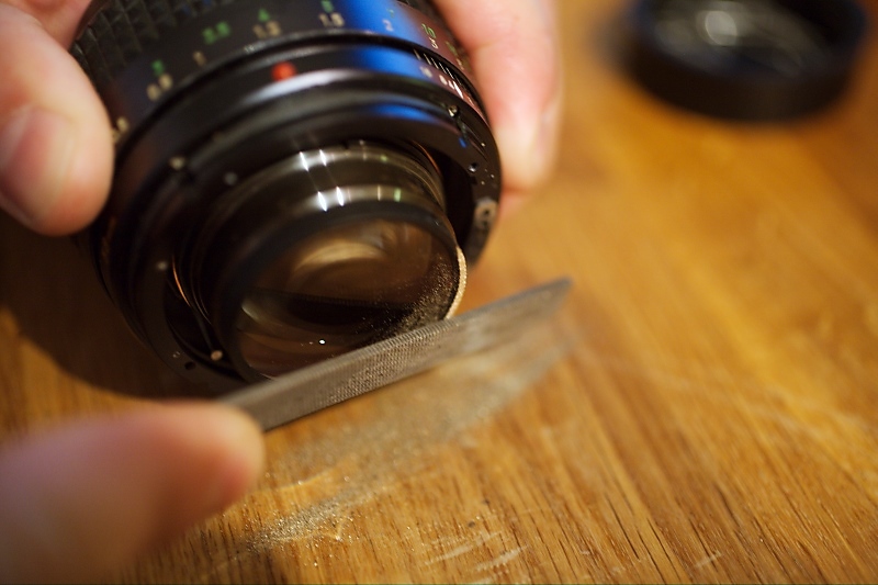

The conversion process was quite involved. Remove old mount, sand down the mount spacer to ensure infinity focus, then file off the edge of the rear element retaining ring, paint it, then drill holes in the new EF mount and install it.
Filing the rear element retaining ring was a sobering endeavor:
attachment.php

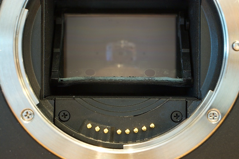

This works without issue on most crop sensor bodies, but to use it on the 5D the camera mirror needs to be shaved down to avoid collisions when the lens is focused at infinity. Another sobering endeavor:
attachment.php

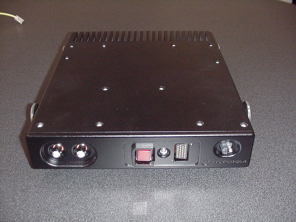

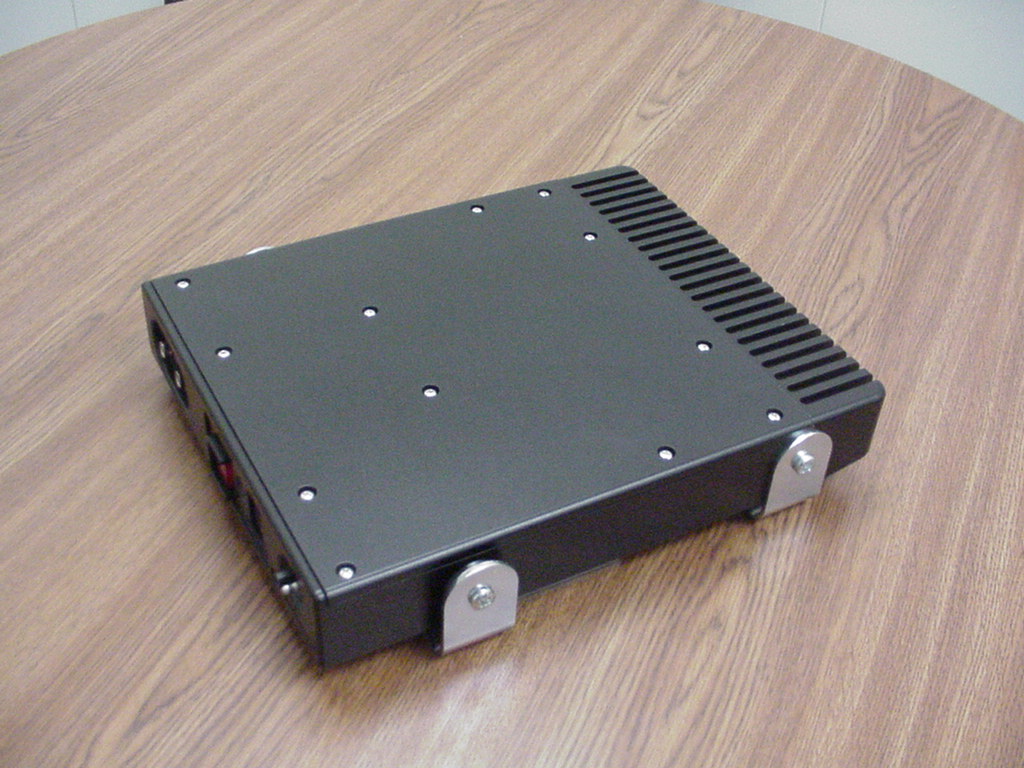

We had one of those at work. It squeezed 12 or 13 1024 X 768 pixel images onto a single 1.44 Megabyte floppy disk.....see included pictures
We had a management change in Chicago and the new regime did not know any of us in Florida, so we each had to prepare "justify your job" presentations.....layoffs to follow. While most of the big boys were making slick PowerPoint presentations, I simply stuffed a fresh floppy into the Mavica and ripped off a whole "roll" of pictures of my latest prototype. I added a short story listing my contributions to the 3 man project.
When winter came the "Suits from Schamburg" visited Florida, as they did nearly every year. Of course a "justify your job" presentation in person would be needed, probably on short notice. Panic struck the lab, most of the people started dressing like IBM (20 miles North) engineers. I was still a flip flops and t shirt kinda guy. The printer buzzed with PowerPoint slides. I did nothing.
When THE meeting came people were sweating, PANIC ruled the week. When I got called I simply grabbed this prototype radio and gave a 30 second presentation.....I designed the RF circuitry for this 100 watt data radio and the test fixture to test that circuitry without a controller board. I laid out the PC board, got them made, then got them populated in the SMD assembly lab. I tested all 10 boards and took data. I worked with a mechanical engineer to get this chassis designed and machined from a single block of aluminum, then built one prototype using the controller board from the digital guy, and the software load from the software guy......as far as I know Motorola sells radios, not fancy PowerPoint slides, someone needs to be the guy who makes a radio out of all of those slides, and I'm the only one in this department that does that. With that comment the 10 pound radio seen in these pictures hits the table and wakes all the suits up! I stayed in that department for the last 14 years of my career and actually liked my job.
The first 4 pictures are the actual images taken with that old Sony Mavica about 20 years ago.

I did get quite the reaction on the photography forum after I shaved my 5D mirror. This was a $3500 camera that I had to finance over 2 years. So yes, there was some risk involved.
The fact that I used the word "sobering" is appropriate on many levels, since it took me about 3 gin gimlets to work up the courage to do it. 🙂

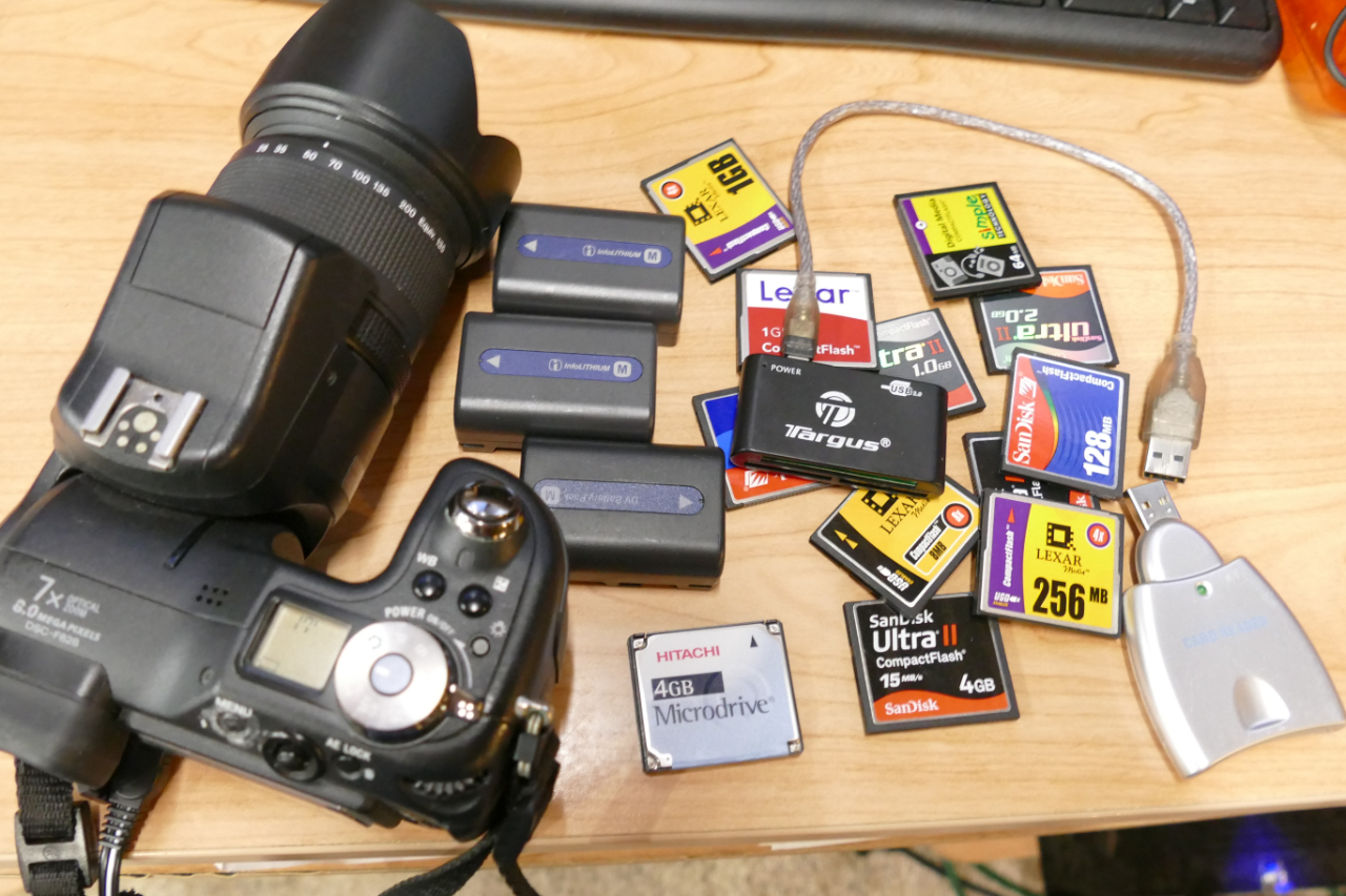

What did I buy today? Two batteries for my long forgotten Sony DSC-F828 camera and a 100 foot long ethernet cable all from Amazon.
This thread got me looking through my old stuff. Though all the film stuff including a couple view cameras was given to a collector long ago, I still have all the digital cameras except for the phones and a pocket Nikon that sucked so bad that I haven't bought a Nikon since.
My first real digital camera was a Sony DSC-F828. It cost nearly $1000 in 2003. I loved the "Sony color" oversaturated pictures that it took, reminded me a lot of Kodachrome printed on Cibachrome. I dug it out of the box it has been sleeping in and was pleasantly surprised to find 11 Compact Flash cards, 4 batteries, and a Hitachi MicroDrive, a 4 GB 1 inch hard drive that fits in a Compact Flash card slot. The old Sony was capable of 640 X 480 video, but only with the hard drive because flash memory wasn't fast enough in 2003. The SanDisk 4 GB Ultra II card (newest in the find) was bragging about 15 MB/S speed. 100 is average today.
Many pictures from that era were lost when I dropped my computer down the basement stairs during a house move. I spent the morning copying the card contents to my PC. The 15+ year old Microdrive wouldn't fit in a modern card reader, and my old reader won't show up in W10, but putting the drive in the camera and connecting it to the PC via USB 0.nuthin resulted in a connection and a nearly 1 hour copy time. Most of the videos are from drag races at the National Trail Raceway in Ohio, but there are several videos of me playing with automatic rifles at a club sanctioned range event.
So far 2 out of 4 batteries are useless, and the other two are probably also dead, but Amazon had "compatible" batteries for cheap. Two batteries and a charger were $22.
The Canon DSLR is a EOS Rebel XS. It's battery took a charge and the camera works fine. The last picture on the card in it was from 2016. I really don't remember why I stopped using it since I didn't get the Lumix DMC-FZ1000 until late in 2017.
The Lumix has 400,000 pictures on it. It has been dropped, rained on and frozen to the point where it's lithium battery died, yet it keeps on going. I have powered it from a phone charger power bank and left it taking 1 picture a second overnight twice......don't try that with a DSLR unless you can lock the mirror up.
