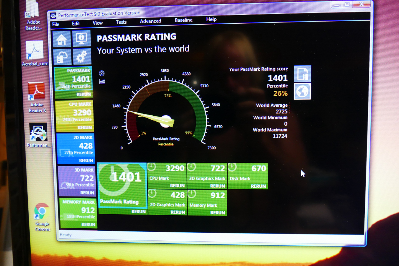

I grabbed an old PC from my collection that was originally built with left over / junk box parts, maybe 5 years ago. I tossed in one of those "Anniversary Edition" Pentium chips when they came out in 2016. They were well regarded as a good bang for the buck chip due to their overclocking performance. I used the machine for a while, then it wound up on a shelf where it has been for at least two years.
On paper it should be the worst performer I have despite being over clocked. It has no video card, only on chip Intel Pentium video, two old hard drives and an old Intel 180 GB SSD boot disk. There are two unknown brand DDR3 Dimms, but they do have fancy heat spreaders attached.....so what does it Passmark at?
The total performance is 52%, with a wide spread in the individual numbers. Passmark's "book spec" for a Pentium G3258 at stock speed is 3895. Mine with an unknown overclock (believed to be in the 4GHz range) is 4499, putting the CPU in the 38th percentile. The on chip 2D graphics are a respectable 91% while the 3D graphics score a blazing 29%. Memory is 85% while the aging SSD gets 62%.

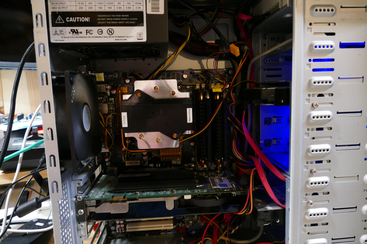

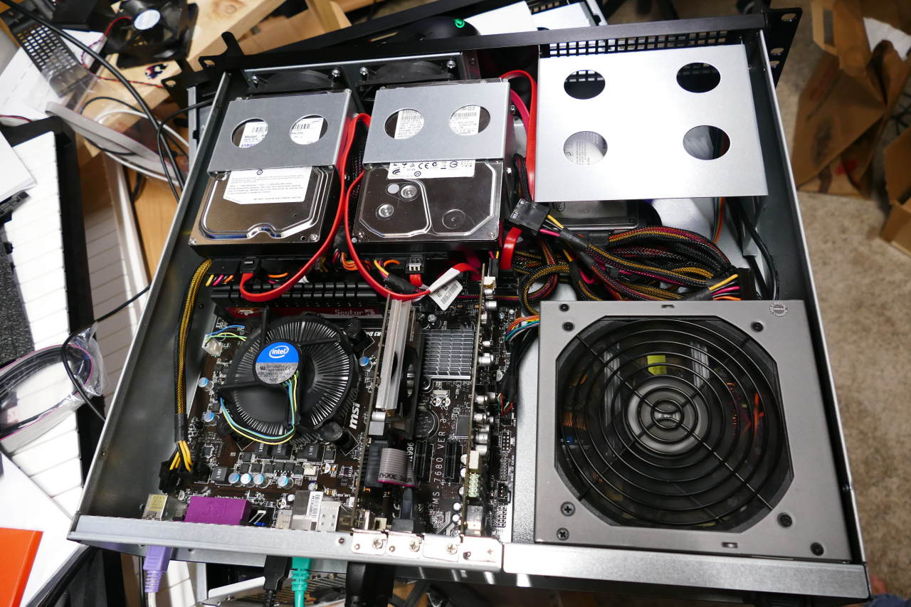

I popped the cover off and made two important observations. The MB had a PCI slot (not PCIE). That's why I saved the PC. I have a couple of old M-audio four and eight channel audio systems that work very well but need a PCI slot, and these don't appear on modern MB's.
It also became obvious that I could swap the CPU by removing only the ram and the top mounted cooling tower I used for the overclock. So.....time to play musical CPU chips....
Before cracking the case I opened the BIOS to crank down the CPU speed. It was set to 4.2 GHz with the 3.2 GHz Pentium chip. I set it at an arbitrary 3.8 GHz for the 3.5 GHz rated i5-4690K chip (my 5 to 10% rule).
The memory is Corsair "Vengeance" DDR-3 memory rated for up to 1866 MHz. It was set to 1600 MHz so I left it there.

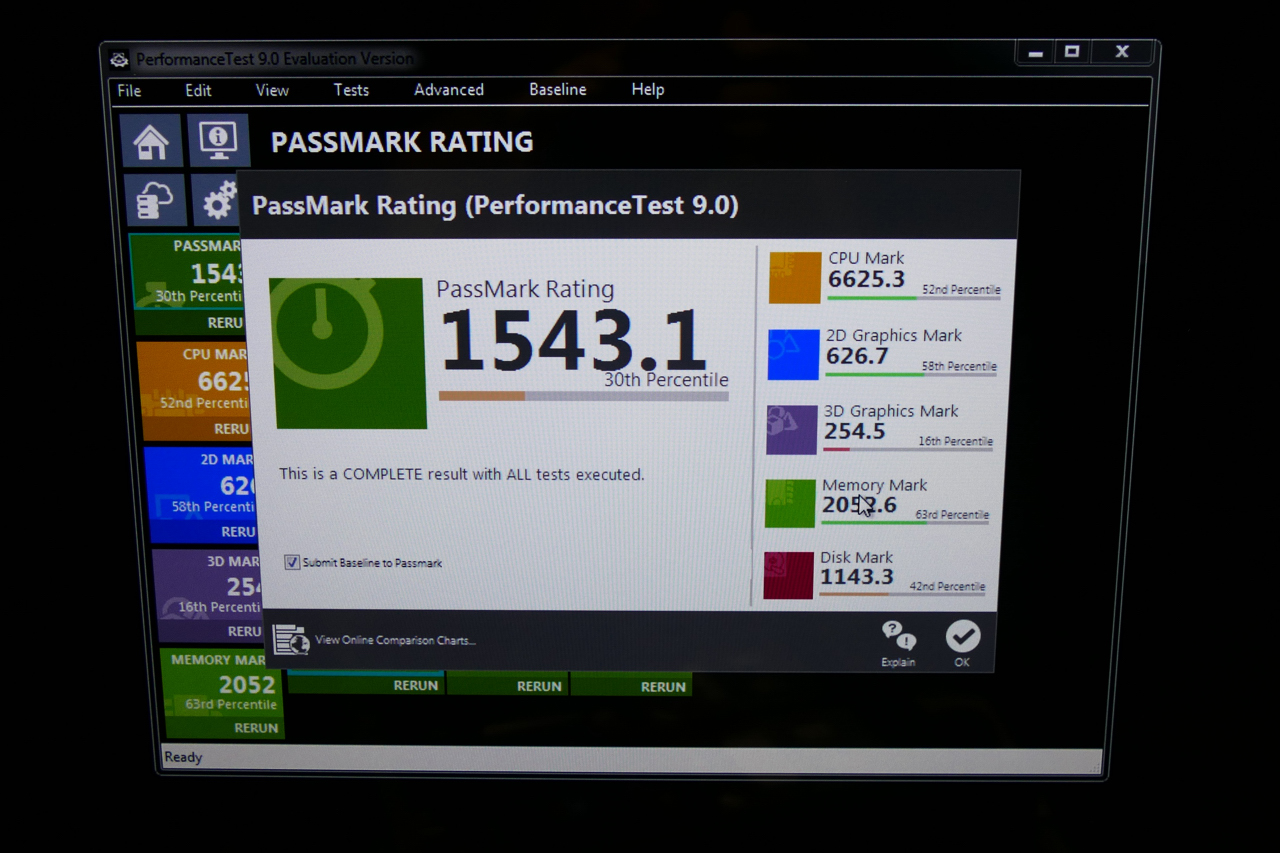

The new Passmark rating is 59%, a boost of only 7%. The "book" CPU mark is 7799. The mild overclock mark in this machine gives 8695. The graphics and memory scores went down slightly probably due to the lower overall chip clock speed. None of these specs matter for audio recording, but system stability does, so it stays at 3.8 GHz, or slower if needed.

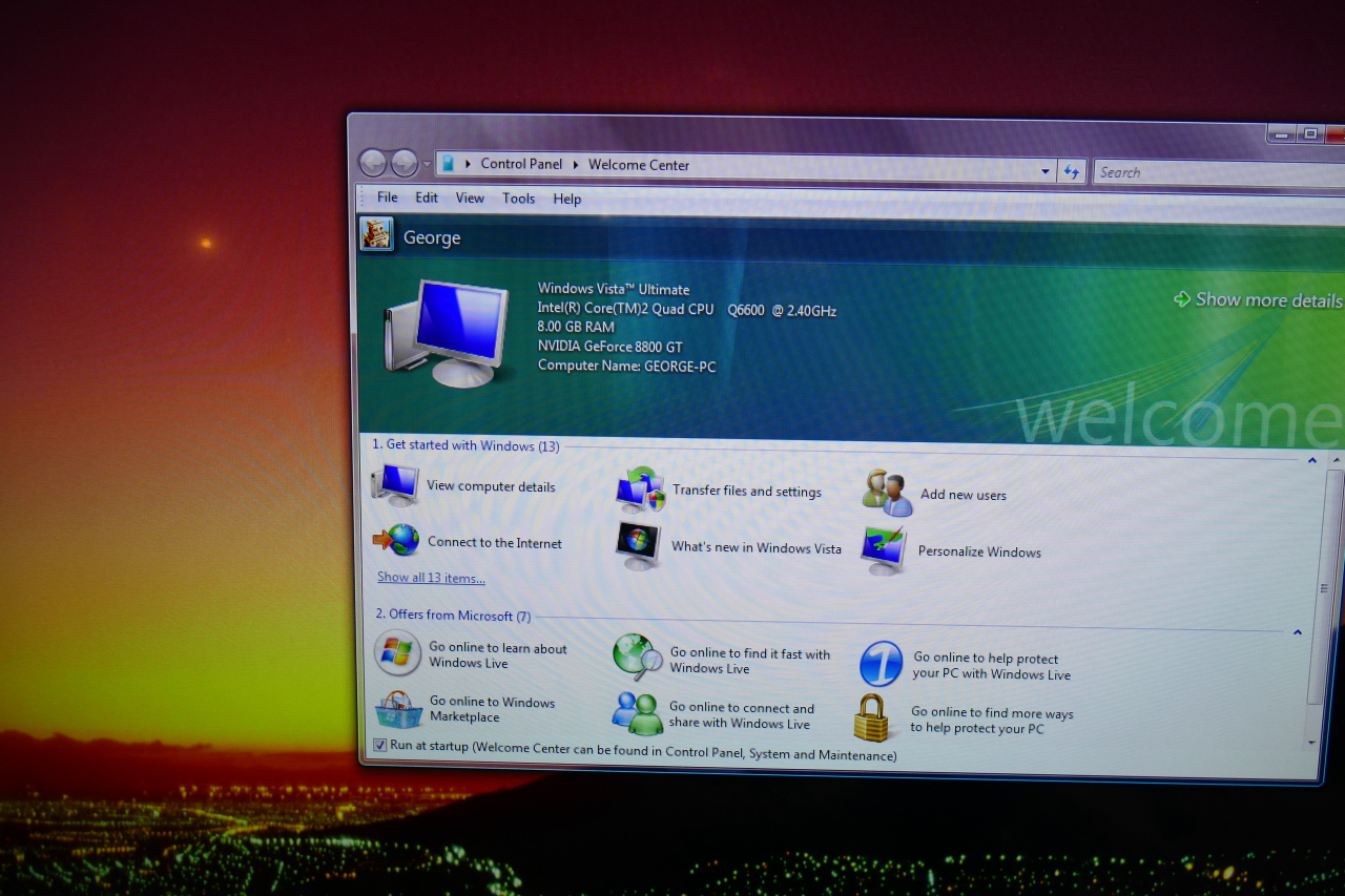

There was this big box sitting in "cold storage." Cold Storage is a derelict mobile home trailer that came with the property. it has no power, water or sewer, and it's falling apart, so it's classified as uninhabitable, and pays virtually no taxes. It is an 850 SQ foot shed, and is full of stuff like tubes, the bones of dead projects, and a couple of computers.
I remember building the Big Box when I had a good job with a fat paycheck, in 2006. It had the best of everything including a Core 2 Quad-6600 chip, and Windows Vista Ultimate. I had this thing hooked up to an Emu 1820 sound box that cost nearly $500 could record 8 simultaneous tracks and even had a built in phono stage for ripping Vinyl at 24/96. Unlike the XP machines in cold storage, this one was still intact, or so it looked.
I dragged it into the basement, hooked up and hit the go button. What seemed like an eternity went by but the only thing I saw was the blue lights from the fans and power supply, so I reach for the power cord anr prepare to yank it, when the Vista boot screen appears. This thing hasn't seen power since 2014 (last search for updates). Hitting the search for updates icon brings up a "Windows can not search for new updates" message......I guess that's what we will be getting with W7 soon.....so I spent a good chunk of yesterday letting some machines that had been sleeping for a while eat lots of W7 updates.
I forgot to do it yesterday, but maybe I'll run the benchmark on the Big Box.

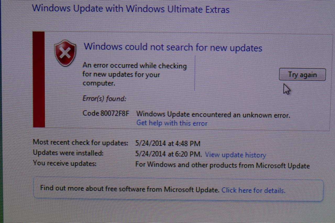

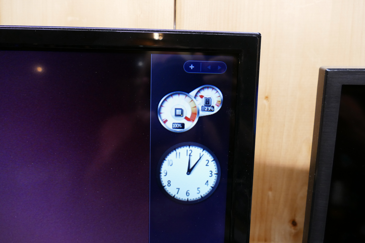

I fired up the old Vista box and ran the benchmarking software......what was probably in the 80+% range in 2007, doesn't cut it today. The CPU meter stayed pegged for most of the tests, but it only managed a measly 26%. The motherboard is a P5Q pro, which seems to be rather common among the Hackintosh crowd. Now if I can find a Core 2 Quad - 9900 cheap......

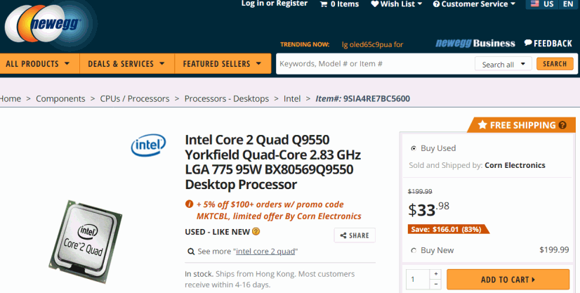

Core 2 Quad - 9900 ..... 9550?
I can't remember correctly from that long ago. I know that there were 3 possible CPU's for that board, one was about $300, another was about $500, and the third chip was over $800, I picked the middle chip.
A little Googling says that these would have been the Q6400, Q6600 and the Q6700.
