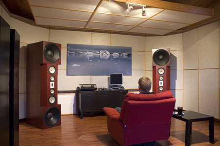

I run a pair of modified Altec A5s in my listening room. Altec's VOTT speaker for "Small Cinemas".
The stand about 5 feet tall, are 30" wide and 24" deep. The bass boxes have a gross volume near 15 cubic feet. I would have a hard time accepting anything smaller for serious listening.

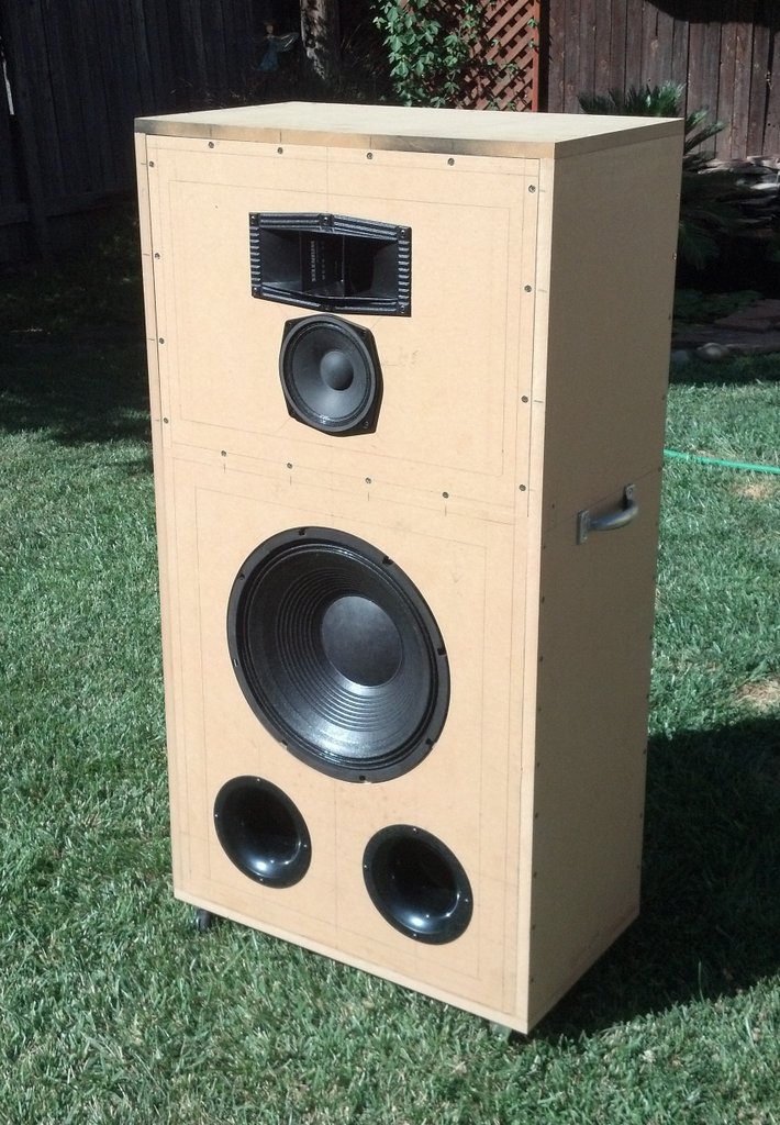

A picture of my test box. It is 48" tall, 25" wide, 15" deep...

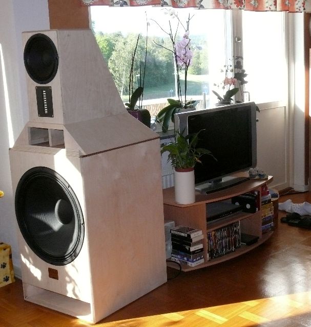

First try, turned out really ok, was this:
A tiny litle speaker that actually is allmost a 2-way design, the larger of the round parts is a Beyma 21L50, this ,unfortunately out of production, 21" driver is lowpassed at about 85Hz, the smaller round thing is a Beyma 10G40, only lowpassed at about 3k, firing backwards in what could be regarded as a TQWT but with exponential expansion.
The square thing is a Beyma TPL150, AMT driver, system sensitivity at around 100dB and fantastic low-level dynamics.
It moved furniture at pretty modest levels so the 21" was perhaps a bit too large for our livingroom.
