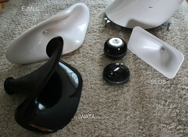

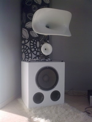

found a couple interesting sites i case you are interested.
wow, thats cool
I didnt know my own waveguide was a Iwata profile
or at least a 'look alike'
no wonder it sounds so good :)

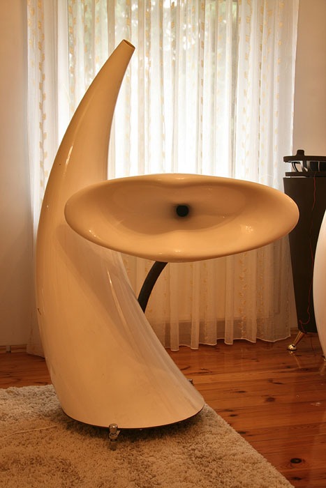

heres some pix I found to wet the appetite
To me the first pic of the E-JMLC-300 looks like a triffid that might swallow you whole if you talk while its playing! Im liking the JMLC-400.........
