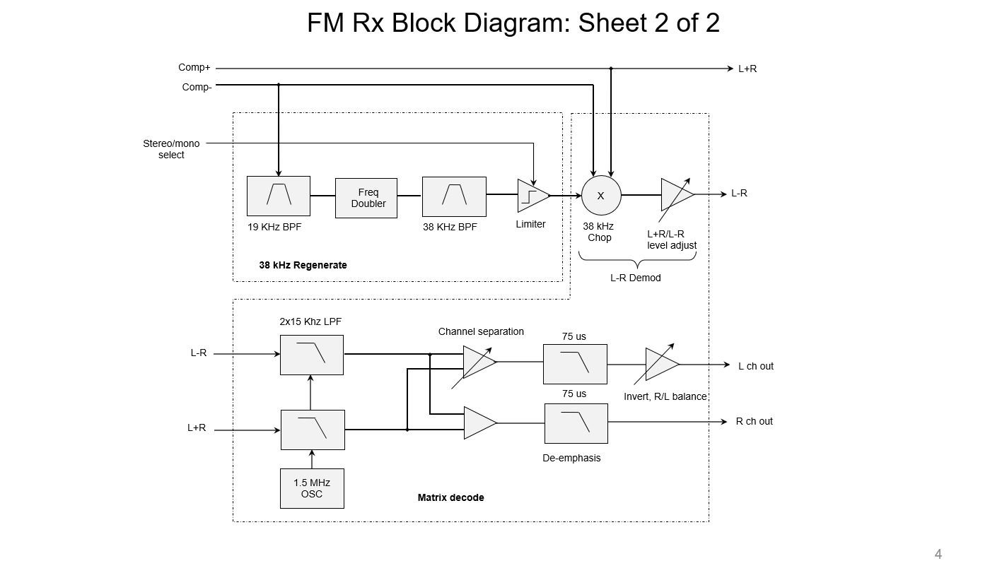

Has anyone considered designing and building an FM tuner? From an audiophile standpoint there is probably little to be gained thereby. In the USA, at least, with few exceptions, both the audio and aesthetic quality of broadcast FM material leave much to be desired. However, as an educational project it might be worthwhile.

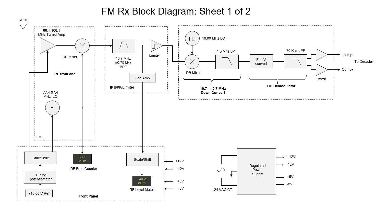

This design has, for the most part, been coded and verified in ADS and later in LTSPICE. The front end is a conventional 4-stage low gain tuned amplifier; low gain was chosen to avoid high level input overload and to avoid the need for AGC. The LO is a Vackar design and is buffered via a high speed comparator for isolation purposes. Down conversion to 10.7 MHz is implemented with a Mini Circuits DB mixer. Both the RF and LO stages utilize varactor tuning, where the tuning voltage is sourced via a precision 10.00V reference and is shifted/scaled to allow the RF amp and LO to track over 88.1-108.1 MHz and 77.4-97.4 MHz, respectively.
Demodulation is based upon a double conversion scheme, where the first down-convert is to 10.7 MHz and utilizes ceramic FM filters. The second down conversion to 1.0 MHz permits a low noise, low distortion delay line based demodulation to baseband. 1.0 MHz was chosen because it permits the use of easily implementable digital delay, and the carrier frequency is sufficiently high that recovery of BB signals requires only simple L/C filters. Subsequent stages regenerate a 38 kHz chopping frequency from the 19 kHz pilot tone and perform the filtering/matrixing to recover the L and R channels from the L+R signal. The front end sections have been built and tested, although I plan a redesign to implement some improvements.

What Kay said. All your image frequencies will be from 66.7 to 86.7 MHz which is occupied by analog TV channels 4-6 (think high power and broad band). If you go to high side injection, your image freqs will be mostly aircraft band (low power narrow band).
I don't think ceramic filters for the 1st IF will give you the adjacent channel rejection desirable; crystal filters will have better rejection and better group delay.
In addition, a LO frequency range of 98.2 to 118.7 Mhz means a ratio of 1/1.21, easier to achieve than a 76,8 to 97.3 MHz range with a ratio of 1/1.27. My calculations are based on a FM range from 87.5 to 108 MHz, as it is usual here.
Best regards!

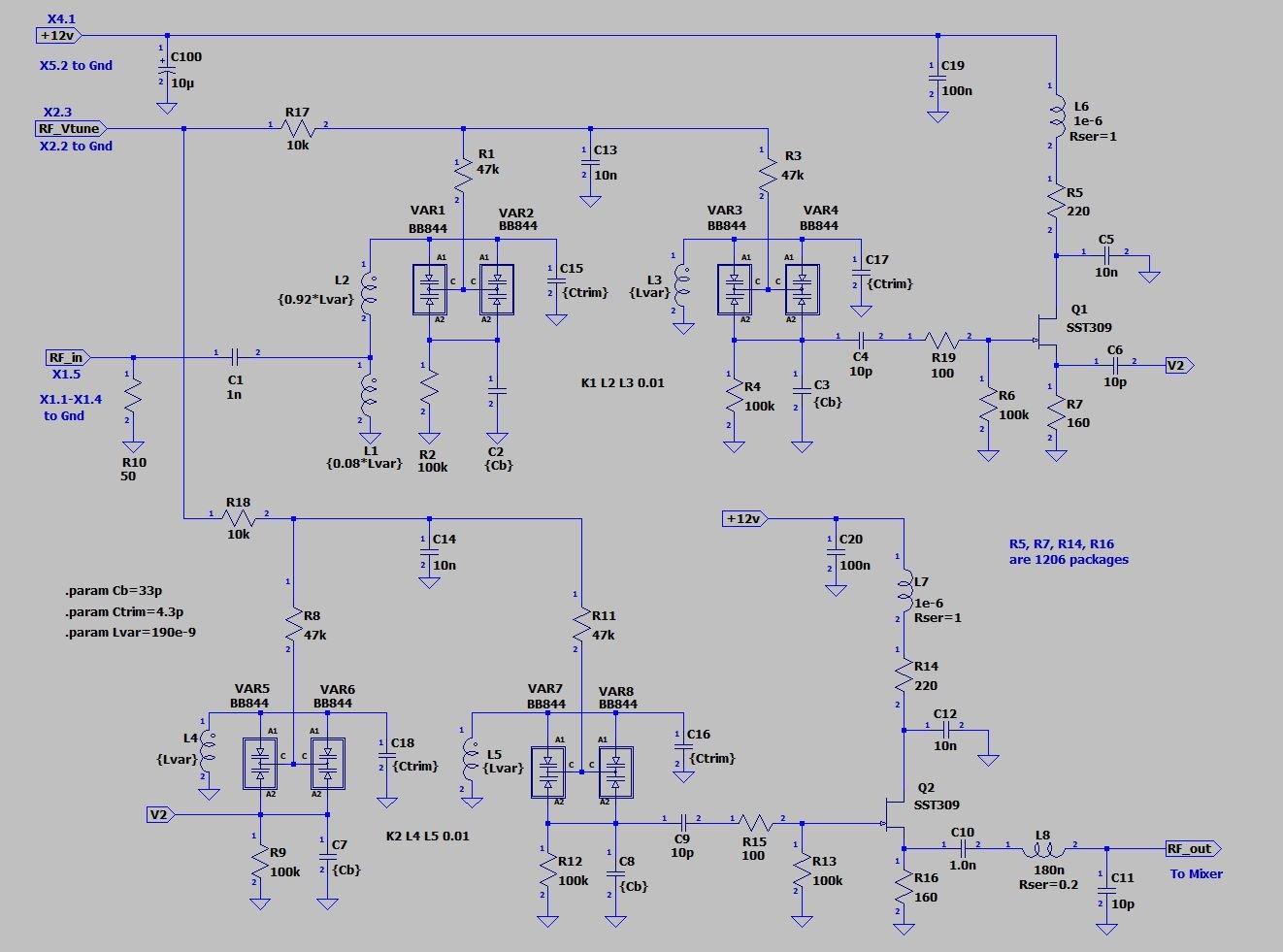

Actually, the components are not that difficult to obtain, at least in the USA, and the circuits are not that difficult to design and build. I searched around for single chip demodulator/matrix chips, but none appear to be available. Therefore I designed the demod/matrix circuits from scratch. Each of the tuner's subsections is housed on a separate PCB; this makes modifications and upgrades more feasible. Attached is the circuit for the RF amp. It has been built and tested. I will post additional subsections as they get designed as well as the names of component suppliers.

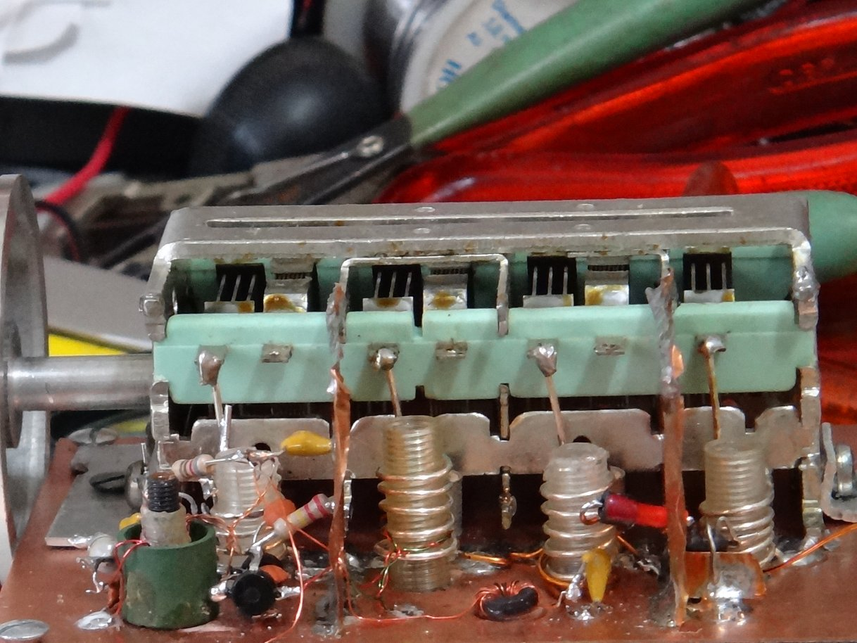

My FM receiver is under construction, the tuner (pic below) works well and has been canned. The IF was double superhet also but I'll change the 2nd IF from 340 KHz to 1600 Khz after a sim showed that a PLL at 1600 KHz can achieve both low enough distortion and good enough sensitivity.

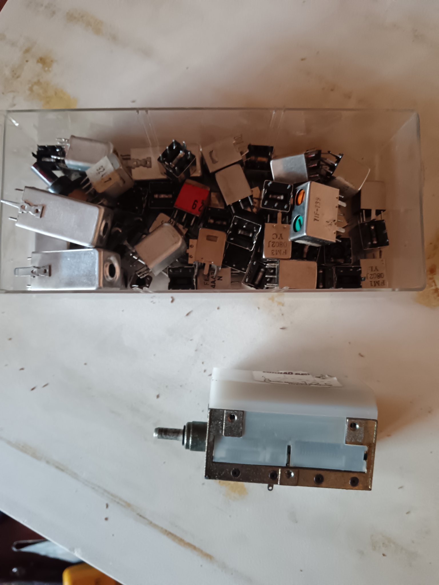

I happend to have some NOS variable inductor and one tuning capacitor. If someone wants them to built tuner at cost of p&p just ask.

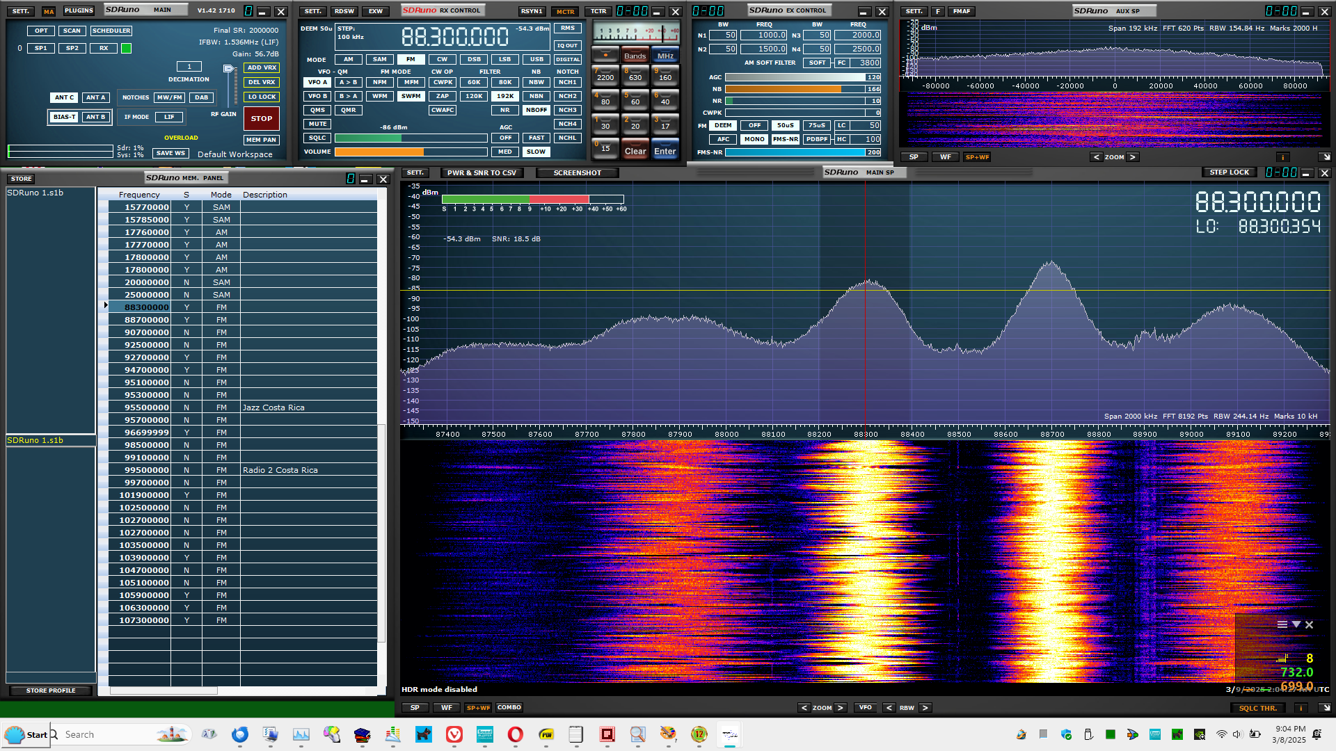

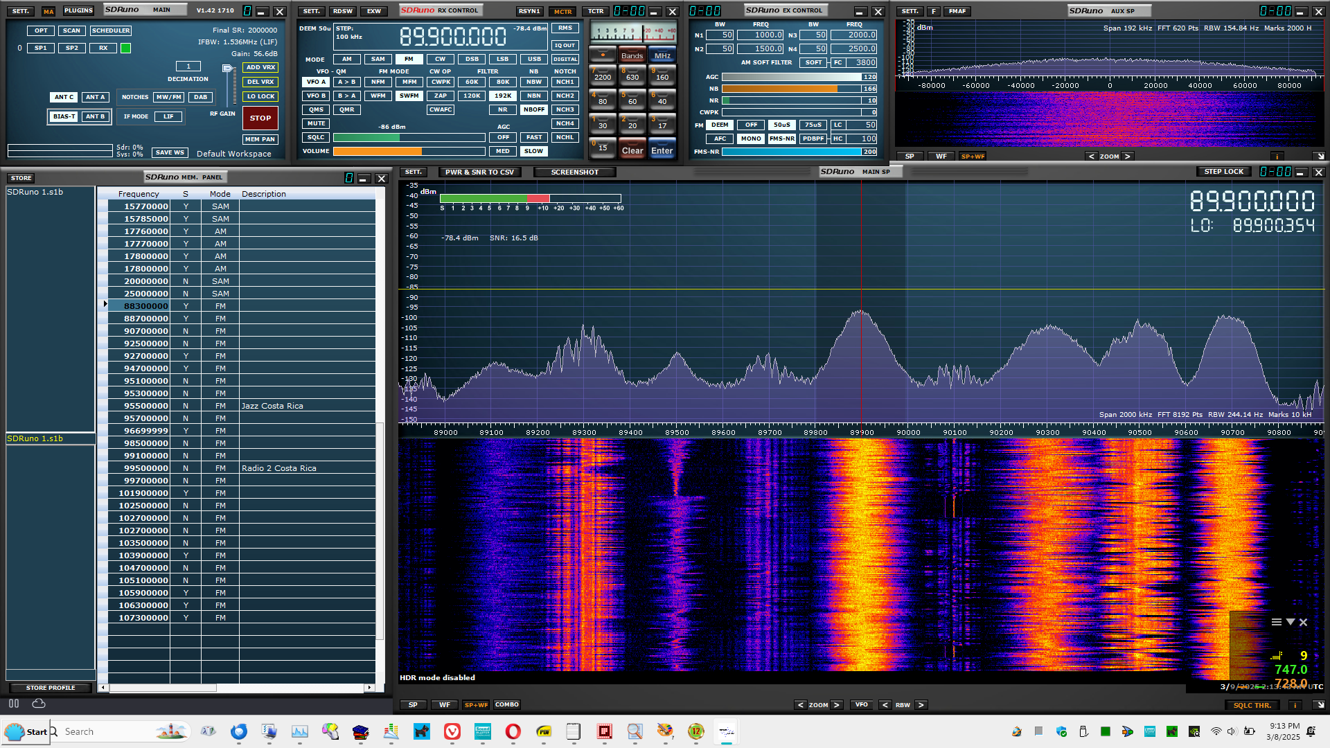

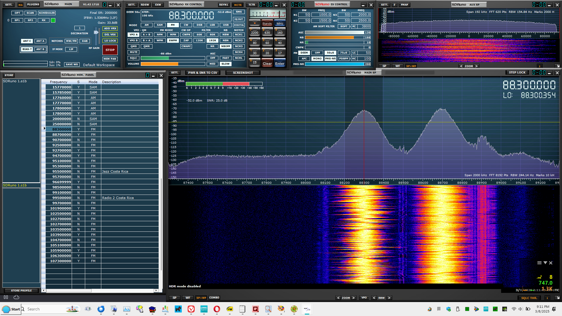

Nowadays even SDR can be fitted with varactor diodes, to provide higher sensitivity without broadband overload. However local stations still can cause overloading, preventing weak station reception on nearby channels. No such issues with variable tuning caps. The pics are self-explanatory (look at the overload indicator and tuning freq.

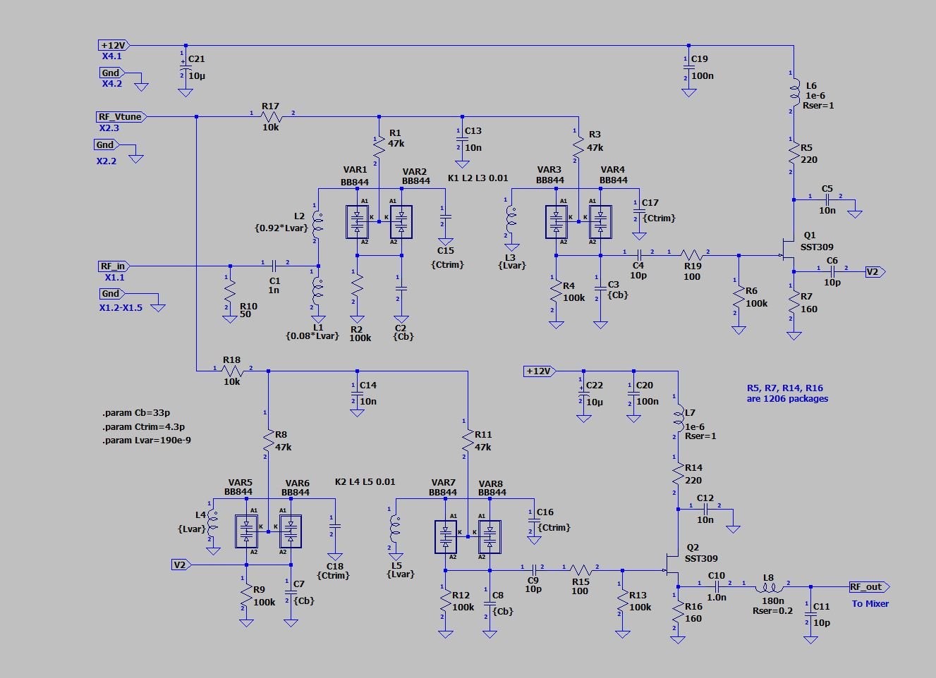

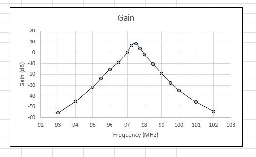

The design I am considering does indeed utilize varactor diodes. Here is the schematic for the front end RF amplifier stage. The only adjustments required for alignment are the 4 variable inductors. Gain is purposely set low at approx. 6 dB in order to avoid overload in the presence of strong signals. Attached is a plot of the front end selectivity. Most of the gain is provided by the IF and limiter sections, and per-channel selectivity is provided by a 4 or 6-stage (user selectable) ceramic filter IF stage.

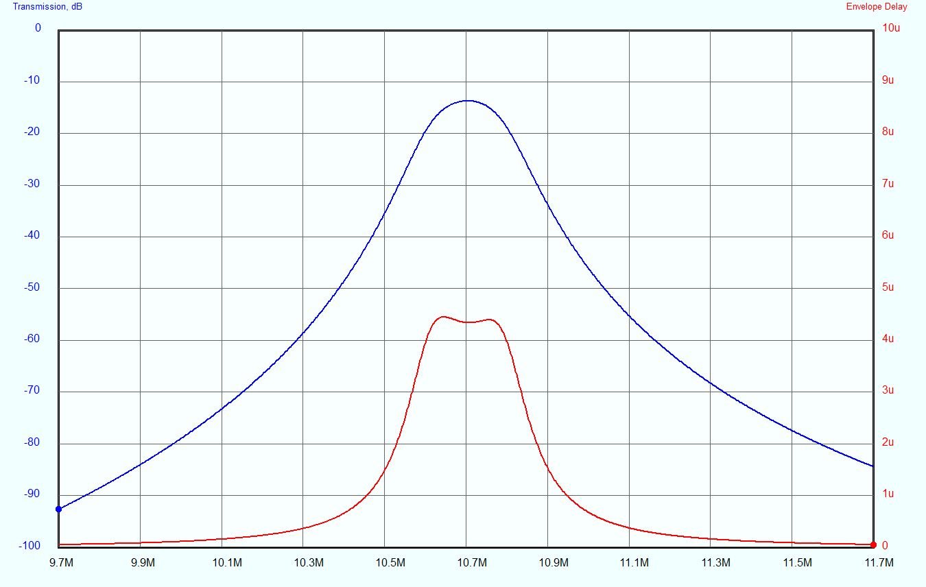

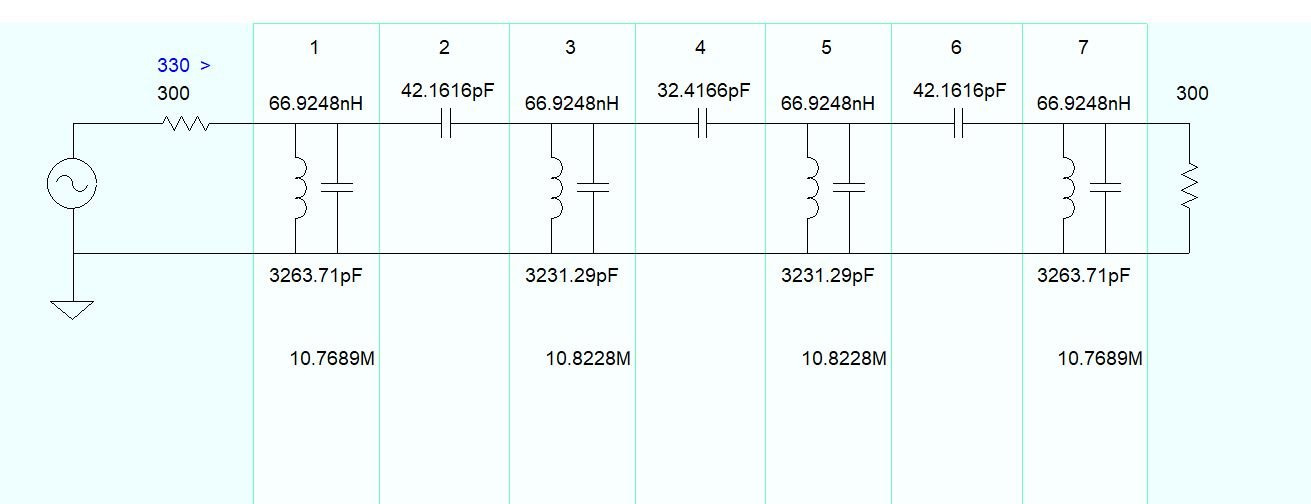

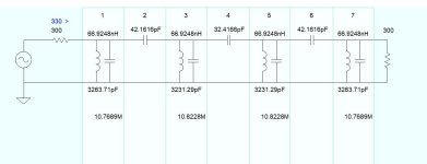

I have a bunch of Murata filters that have a reasonably flat GD response. However, it should be possible to construct L/C filters with better characteristics. The main problem is the sheer complexity of such circuits, not to mention the task of aligning them. Since both amplitude and phase (GD) must be measured it is likely that a VNA is required,
Attached is an example of a 4th order L/C filter. It has a passband of 150 kHz and good GD over that range. However, to match the selectivity of the ceramic filter IF stage would require up to six of these stages.
