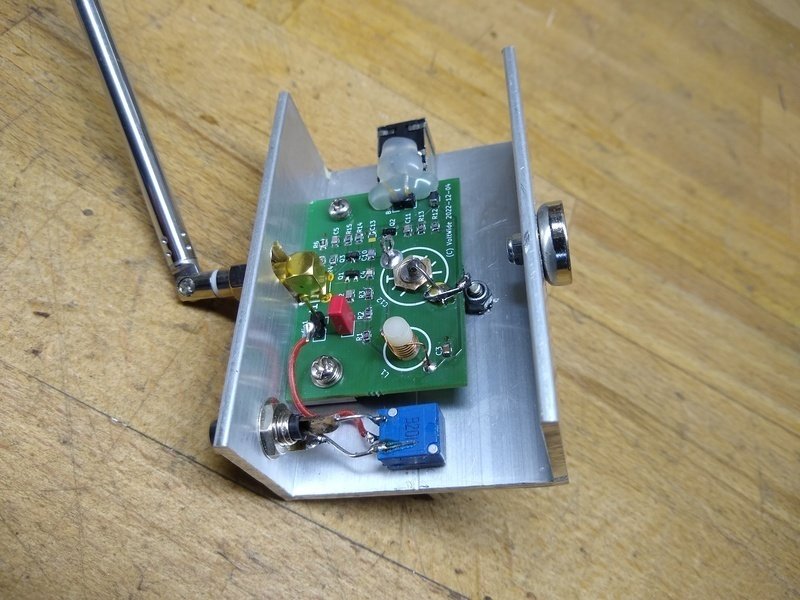

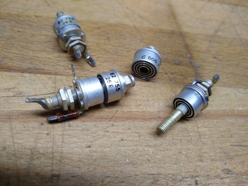

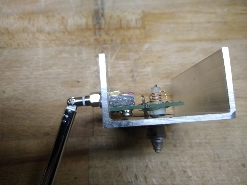

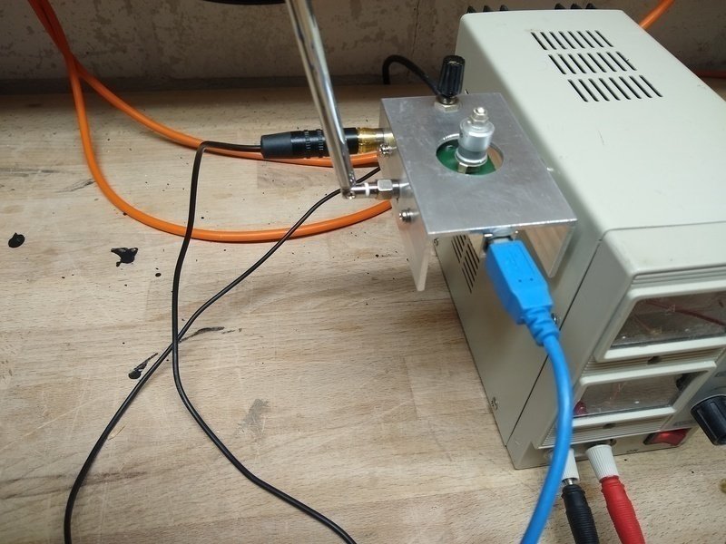

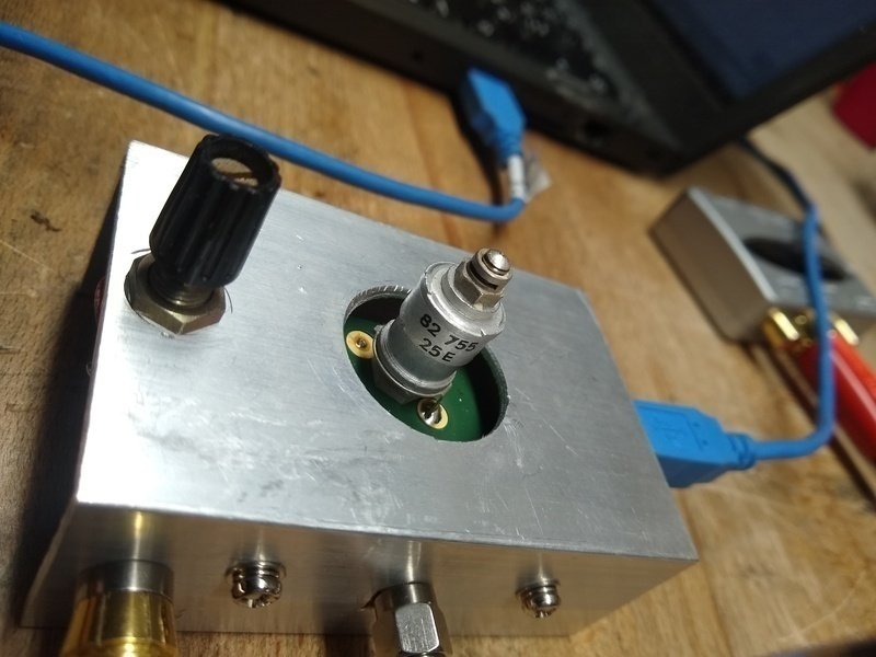

At the end you have to wobble to verify linearity. I did this using a free varactor tuner and modulating the control-voltage with some audio ac voltage. Together with a scope x/y plot the transfer curve could be seen. And this looked quite edgy with my Murata SFW 10.7 filters. Meanwhile I designed a test oscillator using actual standard smd parts. The tuning coil is based on a nylon srew giving best stability to fix the windings.
