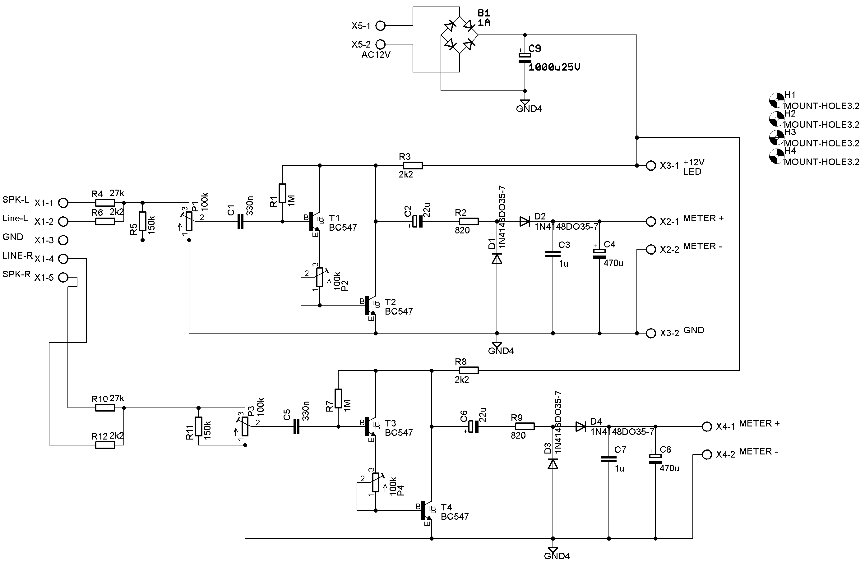

Thanks for the reply's you all,
I found an easy circuit, I've tested it and it works fine ! Circuits Online - Schakelingen - VU meter It seems to work from the line inputs.

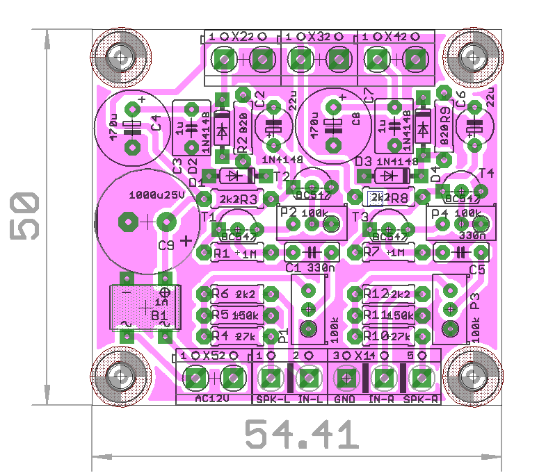

hi,
i am trying make a circuit based on the link you provided for stereo application and the same is attached. it would be nice if someone could comment on the same.
reg
prasi
