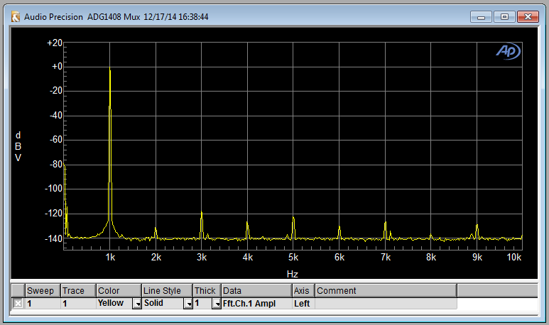

thanks for sharing. that IS lower than I would expect also!
if you don't mind, what were the test conditions of the circuit (load on the switch, signal levels, supply voltage, etc.)?

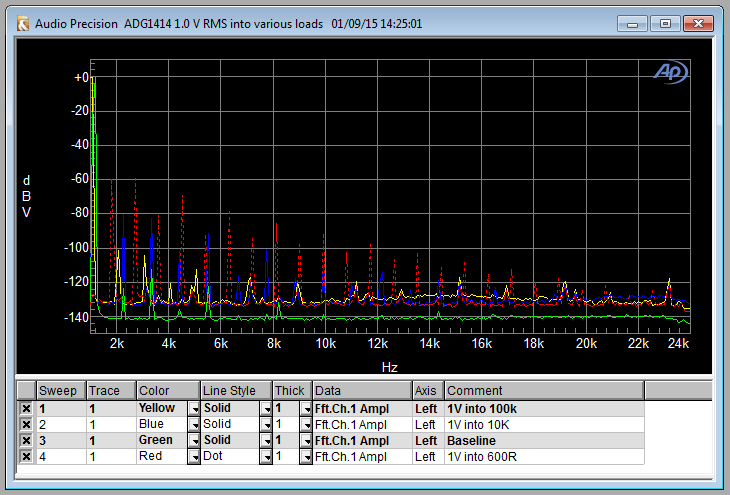

mlloyd1
The load was that of the analyzer -- 100k||100pF with a 1V signal. The switch is on a protoboard Arduino, just parallel loading the inputs -- input and output were 2.2uF polycarbonate caps.
Switch distortion is mitigated when the switch is in series with a high load impedance.
