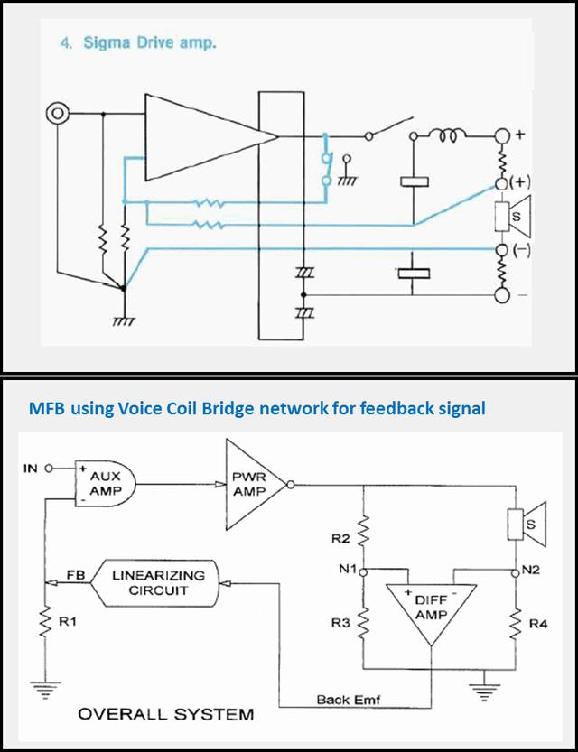

How can you make a voice coil pick-up using the same magnet system as the driving coil without having interference? Putting two layers on top of each other will make a transformer, putting them at other heights of the VC former will introduce asymmetry, and in both cases they could be affected by eddy currents. Will copper rings do the trick like the copper bases of accelerometers in MFB systems?
If you want to use VC feedback with a single magnet system and two coils, there will be inductive coupling as your describe. It tends to only come into play(ie be of significant magnitude relative to the desired signal voltage induced by motion relative to magnetic field in gap) at frequencies > 100Hz. The options are to use a separate magnet system for the sensor VC, or put the driven VC in a bridge arrangement to get the velocity feedback signal.
The apparent simplicity of the bridge arrangement is appealing. It can provide useful reduction in distortion with minimal circuitry. However, I was never able to achieve the high levels of stable open loop gain and distortion reduction that I could with an accelerometer.
The issues included:
- bridge imbalance(VC inductance function of VC position and current, VC resistance function of temperature)
- sensor distortion(BL variance with VC position, flux modulation from VC current).
My comment wasn’t meant to be scary. As you state, passive differentiation circuits can be made from a single capacitor and load resistor the response of which is a first order HP network. The trade off in the passive design is setting the roll off point. There higher frequency you choose(smaller capacitor) the more reduction in signal level…so lower S/N ratio. The lower frequency you choose(bigger capacitor) the more phase shift in the feedback loop...lower stability margins. All things considered, a bass boost EQ prior to the feedback control loop is probably the best approach.Scary as bolserst's implication of the need for calculus in "integrating" velocity into acceleration (or do I have that backwards?), we are only talking about adding a wee single capacitor into the feedback loop. That's the only difference.
The Sigma circuit does not connect the speaker VC as one leg in a balanced AC bridge for distortion reduction. Rather, the voltage is sampled directly across the VC to place the speaker wire impedance, protection relay, etc. inside the feedback loop. The result is increased damping factor, but no motional feedback.BTW, if you have a Kenwood Basic amp with the Sigma wires, you are doing it already.
The Sigma circuit was discussed a bit earlier in this thread(starting post #115)
http://www.diyaudio.com/forums/subwoofers/239941-analog-servo-sub-12.html#post3653431
Robintip - as far as I can tell, exactly the same functional benefits using a VC/bridge system as using an accelerometer. The bridge approach seems to me to produce a more perfect feedback replica of cone motion than a separate winding but I have no test experience with a separate winding. Yes, bridge feedback can be unstable and takes a while to sort things out - as is also the case with the sometimes elaborate circuits for an accelerometer. I suppose somebody could manufacture drivers suitable for MF.
bolsterst - yes, the Sigma circuit kind of looks like the hook-up for remote-sensing of a bench power supply delivery. But in the Sigma amp circuit, the speaker wires (but not the sensor wires) are part of the bridge if their resistance is non-trivial. Beyond my understanding to know the difference between current feedback (like in the Sigma) and MF feedback.

There is no way a bridge arrangement could ever work properly as a way of accurately sensing the velocity of the diaphragm because it relies on constant Bl and no voice coil inductance which are the very thinbgs that cause distortion in the first place. Also the balance of the bridge changes as the voice coil resistance changes with temperature and so goes out of balance quite easily. The bridge arrangement is a crude way of implementing motional feedback and if it was so effective it would almost be universally used since it would not require the use of an accelerometer.

You're right... but.
First, there are no non-crude ways to do MF. To this day, there seems to be no way to commercialize an MF system that has big enough feedback to improve a good driver but is also not on the verge of instability. And that's because Rice-Kellogg cone drivers are a lousy engineering concept, barely limping along after 100 years to produce good sound.
You can balance a bridge to any degree of precision you want. In any experimenting I did (long ago), I found it wasn't helpful to simulate the driver with endless niceties within the bridge. And that is because the imbalances you are concerned about have little or no effect on the basic operation of the feedback loop. Basically, you just want to grab the back-EMF feedback and the factors you mention just are slight trimmers on the amount of feedback. In any case, I like to focus on the big effects before sweating the small (and sometimes just theoretical) stuff.
If you are saying your VC isn't good enough to provide accurate feedback, you are saying your VC isn't good enough to provide good music without feedback either.

You are missing the point. The parameters you are trying to correct such as Bl non linearities are the very things you are relying on to provide accurate feedback of the diaphragm. There are no benefits to using a bridge arrangement because it is only linear at low power and cone excursion where the distortion is low anyway. At high power and high cone excursion is where you need it to be accurate and it fails dismally at those extremes.
The only real and small advantage of a bridge circuit is to approximate constant velocity vs frequency operation and with a suitable bandpass shaping filter you can then arbitrarily determine the low frequency cutoff point but this could equally be achieved using a linkwitz transform eq circuit so no cigar on this one.
Also the voice coil inductance will cause havoc and create a peaking in the response at the mass/inductance resonant point if it is not taken care of.
