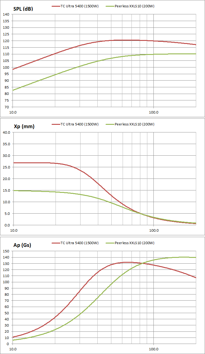

Just curious, what woofers and how much power do you generally use for your MFB designs?
The reason I ask is that I easily exceeded 100G peaks with Peerless 10” and 12” woofers driven with 300W BASH plate amps using the ACH-01 sensor. Is it possible you are thinking of RMS rather than Peak acceleration?
I know I had posted these figures before somewhere so apologize for the repeat, but can’t seem to locate them.
The first compares SPL, excursion, and acceleration for a 15” woofer driven with 1500W and a 10” woofer driven with 200W.

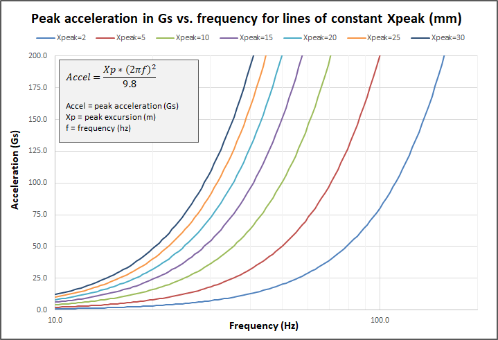

As you mentioned, it is not at the lowest frequencies that you run into high Gs, but at the upper range of the subwoofer. This is because peak acceleration is proportional to peak excursion times the square of the frequency. The second attachment provides some acceleration trends lines for a range of peak excursions. For the 50Hz example you mention, with peak excursion of only 5mm you would already be bumping the 50G limit.

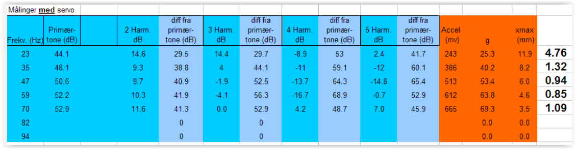

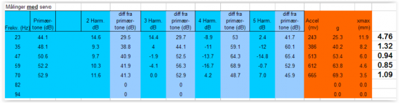

Attaced is measurements I did on a Peerless XLS 10" with 30V RMS (225W) at various frequencies.
At 47Hz I passed 50g and at 70Hz I had 69g. Above that I ran into problems with the coil rubbing into the magnet because I mounted the sensor on one side of the voice coil without any counter weight on the opposite side. The remaining THD is on the left of the table. 1,32% is down from 8,4% with the same signal without servo.
So 100g is absolutely something that can be neccesary. But I totally agree that if the design goal is less than 50g the ADXL1002 is a better choice.

Attaced is measurements I did on a Peerless XLS 10" with 30V RMS (225W) at various frequencies. At 47Hz I passed 50g and at 70Hz I had 69g.
Thanks for sharing your measurements…a nice match with simulation from the values I calculated assuming free-air operation of the XLS10. Those are RMS values so the 69g would require 98g peak capability from the sensor, correct?
It is 10 years since I did those measurements, but if I recall correctly the g's in the table are peak.

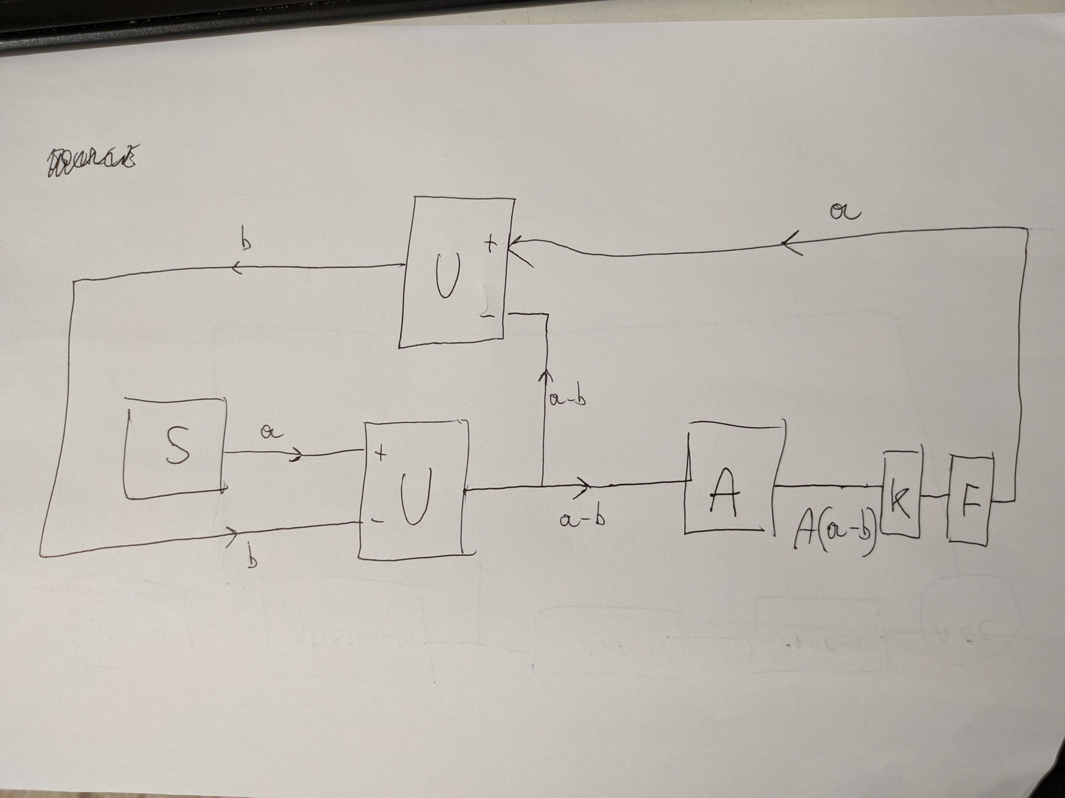

Hello everybody,
I hope you don't mind if I reissue an old thread.
I have been thinking about the implementation of the motional feedback, and i didn't completely understand the circuit shown in the 1st page 😕
when i don't understand something after many tries, usually I try to rebuild it from scratch, and so i did.
I designed a schematic and I simulated it with LTspice, and here i propose you a block schematic of what i simulated: it seems to work.
Is it the same thing of the schematic shown in page 1 but made a different way? do you think my schematic makes sense?
Here is a legenda:
U is a voltage difference amplifier circuit (the typical one with an opamp)
S is the signal source
A is the power amplifier
K the speaker
F is the accelerometer + its gain stage.
a is the musical signal,
b is the distortion that the speaker tries to introduce
a and b are visual supports i used to visualize the concept: In my LTspice simulation basically i introduced a series high frequency sinusoidal voltage source instead of the blocks A, K and F
do you think this makes sense or did i miss something?
Sergio

Nice thinking, though note that A, K and F have a frequency dependent transfer function and can exhibit nonzero phase. Then both reasons cause the subtraction in (upper) U to become incorrect.
MFB typically uses the tried-and-true negative feedback schema with an open loop gain that peaks to 20..30 dB.
Thank you for your input TBTL,
actually i didn't introduce a sub-like phase-dependent transfer function for K in my simulation, but now, thanks to your suggestion, I added it in the last model.
Anyways, do you specifically refer to stability issues?
Can you please share a block schematic or explain me another way the 30 dB open loop gain thing?
In my second-last model, I used an active low-pass and an active high-pass filter at the output of the accelerometer, and when there, i added the phase shift of the speaker, i had the sistem to oscillate.
without the low pass filter, it's stable again.
Thank you,
Cheers
S.
