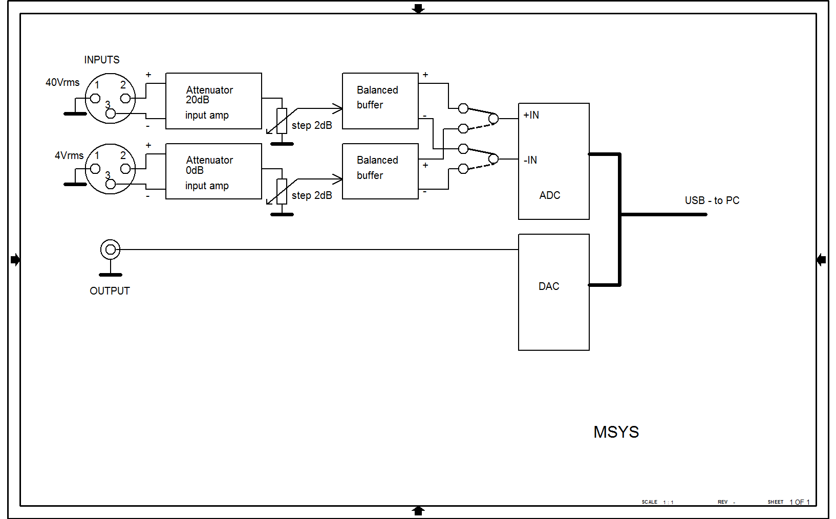

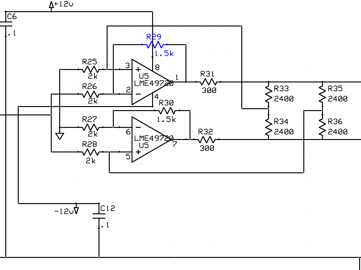

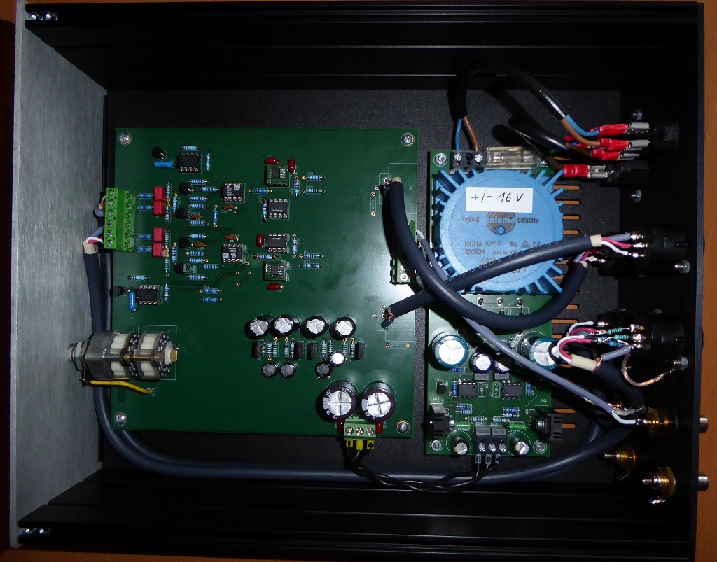

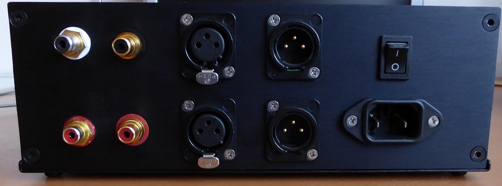

I was tired to solder divider diy patches every time I needed to measure power amplifiers with a soundcard, and also by investigating how to avoid groundloops and mains related interference spectral lines. So I decided to design and build a fully balanced universal analog interface that would change a soundcard to something that resembles an audio analyser like AP, or maybe rather like QA401. I started with using such thing a year and half ago and after getting good results, I decided to make a stand-alone instrument like this. The interface, called MSYS, has 2 channels, one for low level signals up to 4Vrms, second for high level signals up to 40Vrms (at least). The gain and sensitivity is controlled by DACT stepped attenuator. Block diagram is attached, circuit diagram is attached as well, and a photo of the instrument and its rear panel. The circuit uses OPA314, AD797, OPA627 and ADA4898 chips. Dynamic range is high, distortion very low and it makes a useful tool from a conventional soundcard. Balanced input is a must if we measure a power amplifier.

  • msys_sch.pdf
    msys_sch.pdf

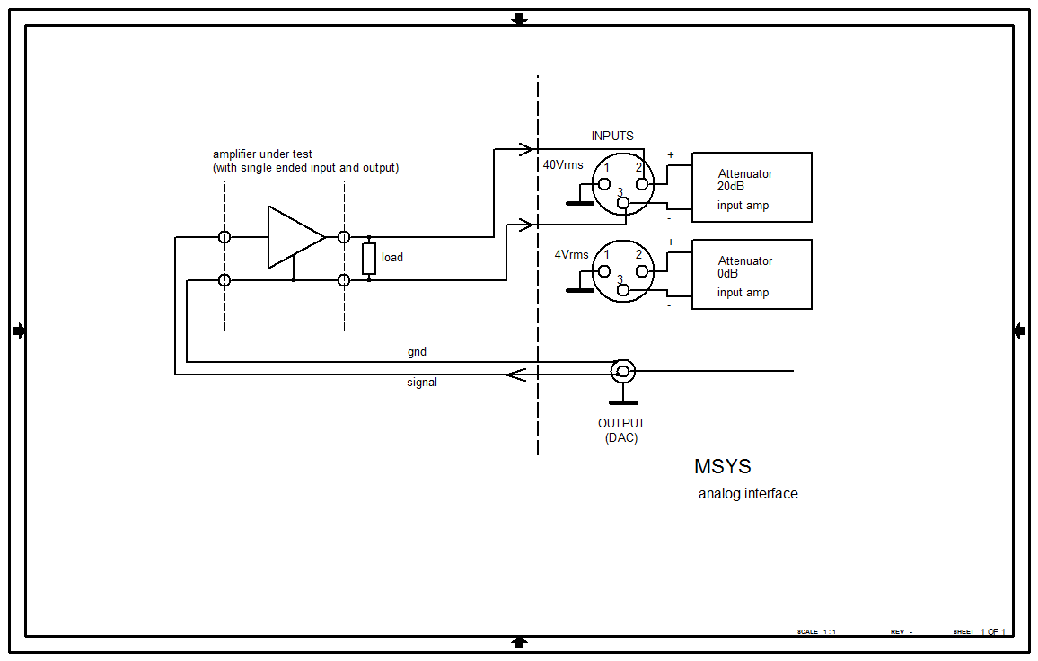

The attached image shows the MSYS analog interface used for measurement of a standard power amplifier with a single ended input and speaker output with one terminal at analog ground. No measuring ground loop is created, because of balanced input of the system.
The unused channel may serve as single ended to balanced converter, in case that the power amplifier has balanced input and soundcard used has only single ended output.
Rule of thumb: never create a loop from analog grounds, especially if one of the signals is single ended. Balanced inputs and outputs help to get rid of this common issue.

Yes they do. However, it is possible to get rid of signal ground loop quite effectively by using only one reference ground. Attached is the schematic when I connect the MSYS interface to a soundcard which has only SE I/O. Second channel of the MSYS acts as a SE/bal converter to measure power amplifier with balanced I/O. SE out from the soundcard is connected to MSYS balanced input, no ground, just shielding. Reference ground is the output connection. No loop.
