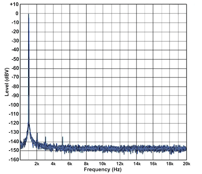

Thanks for sharing the filter designs.
According to the filter response for the BP filter, shown in post #1, the harmonics at 2 and 3 kHz should be attenuated by around 47 and 57dB respectively.
But the distortion at 2 kHz is almost unchanged compared to the generator signal of the AP555, shown in post #15. Perhaps a reduction of around 3dB with an input signal of 0dBV.
The level at 3 kHz seems to be reduced by around 15dB.
That points towards a relatively high distortion in the filter itself. Do you know if this is caused by the op-amps, capacitors, layout or resistors?

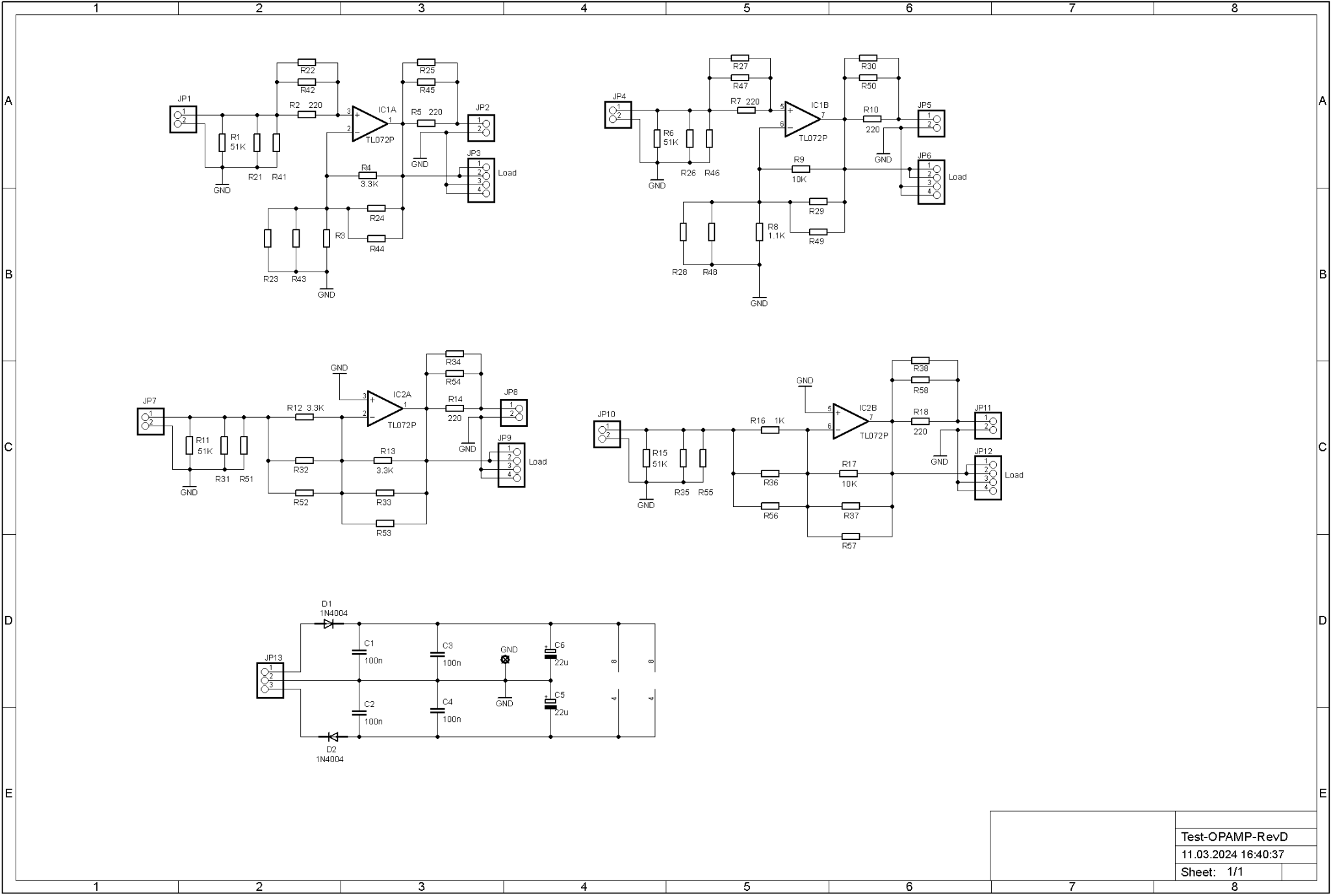

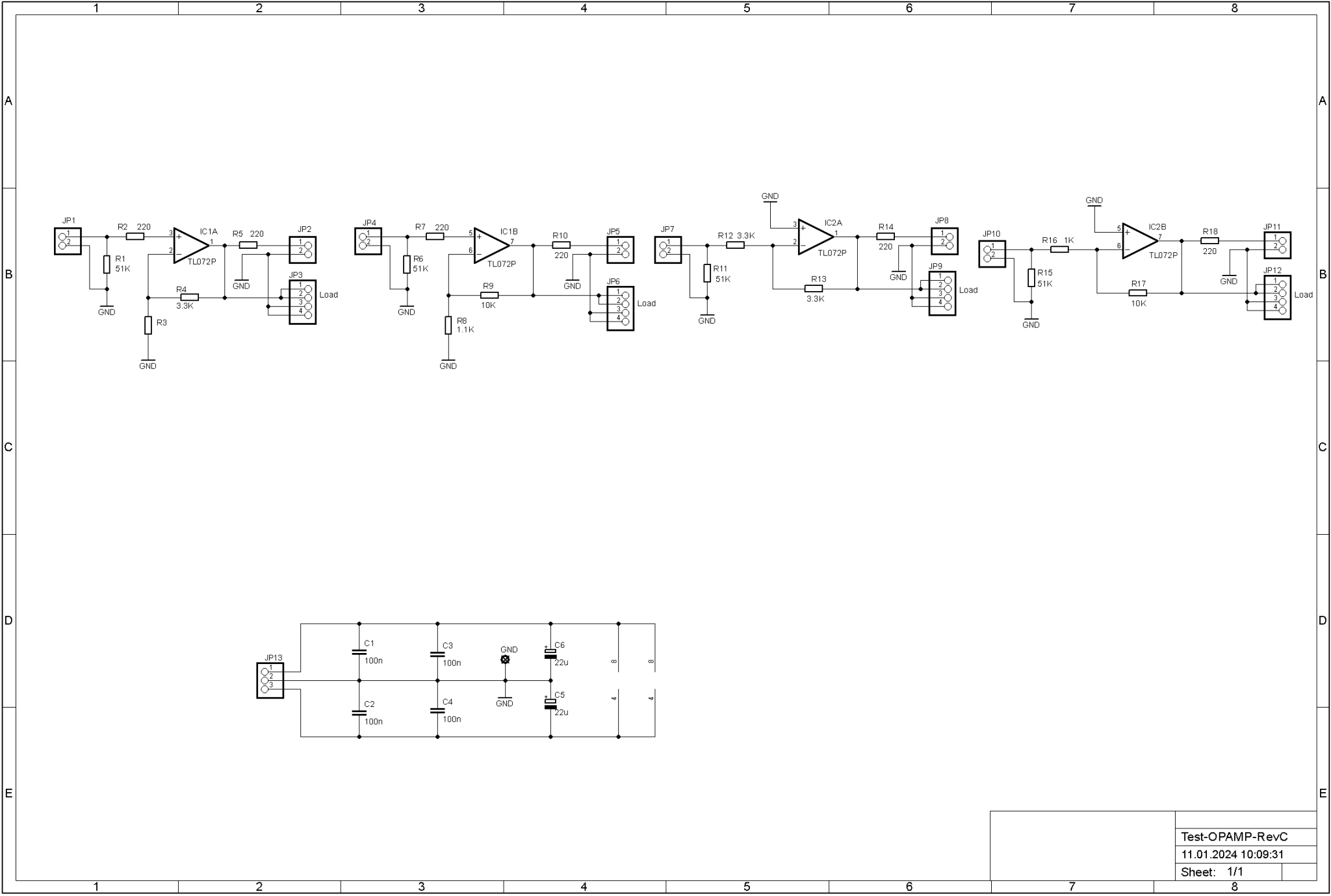

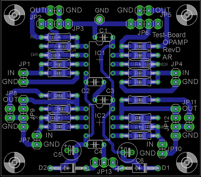

Just got the PCBs for my OpAmp test board. It helps to test different OPs in the same environment for THD and SNR.
Different gain and load.
DIL or SO8 on adapter.
Attached the schematics, layout and picture of the blank board.
Blank boards available.

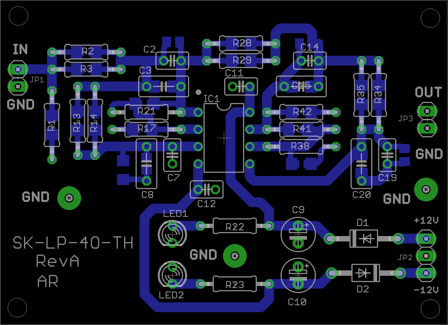

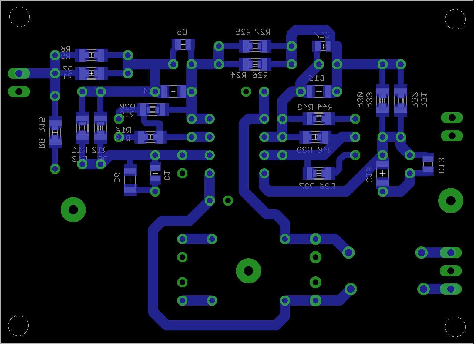

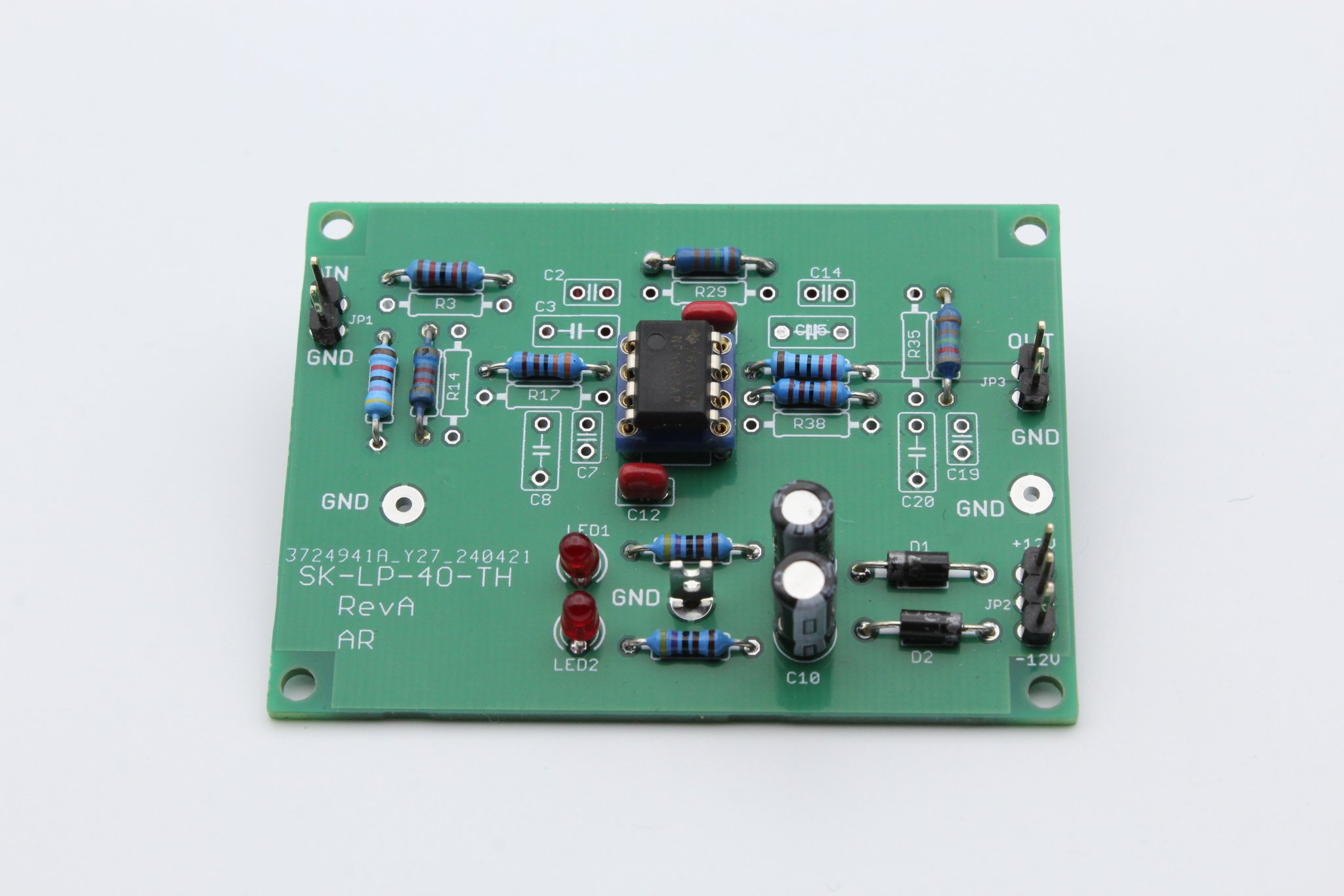

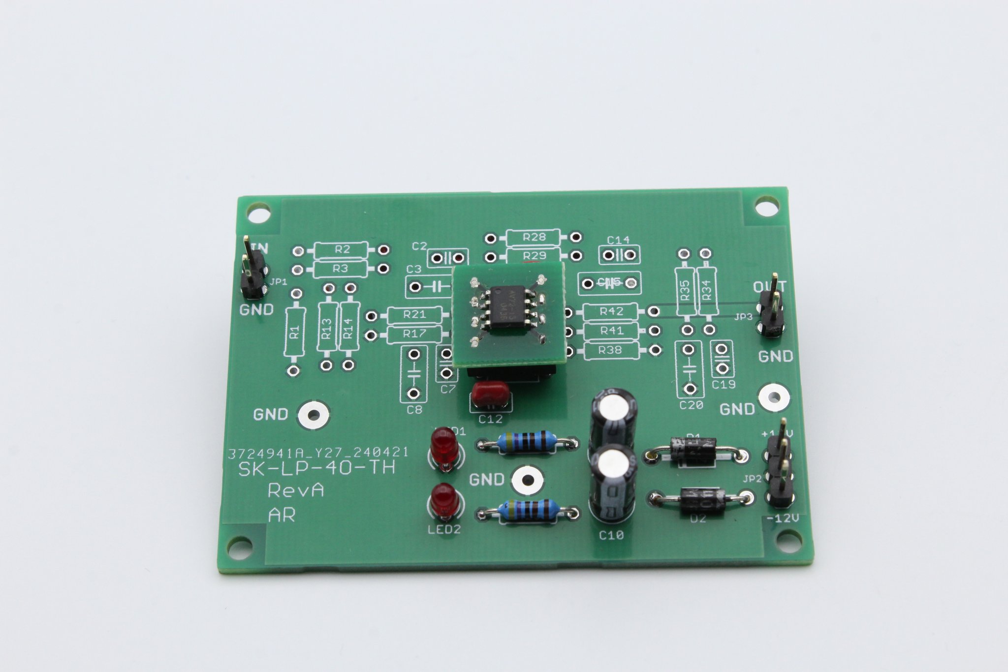

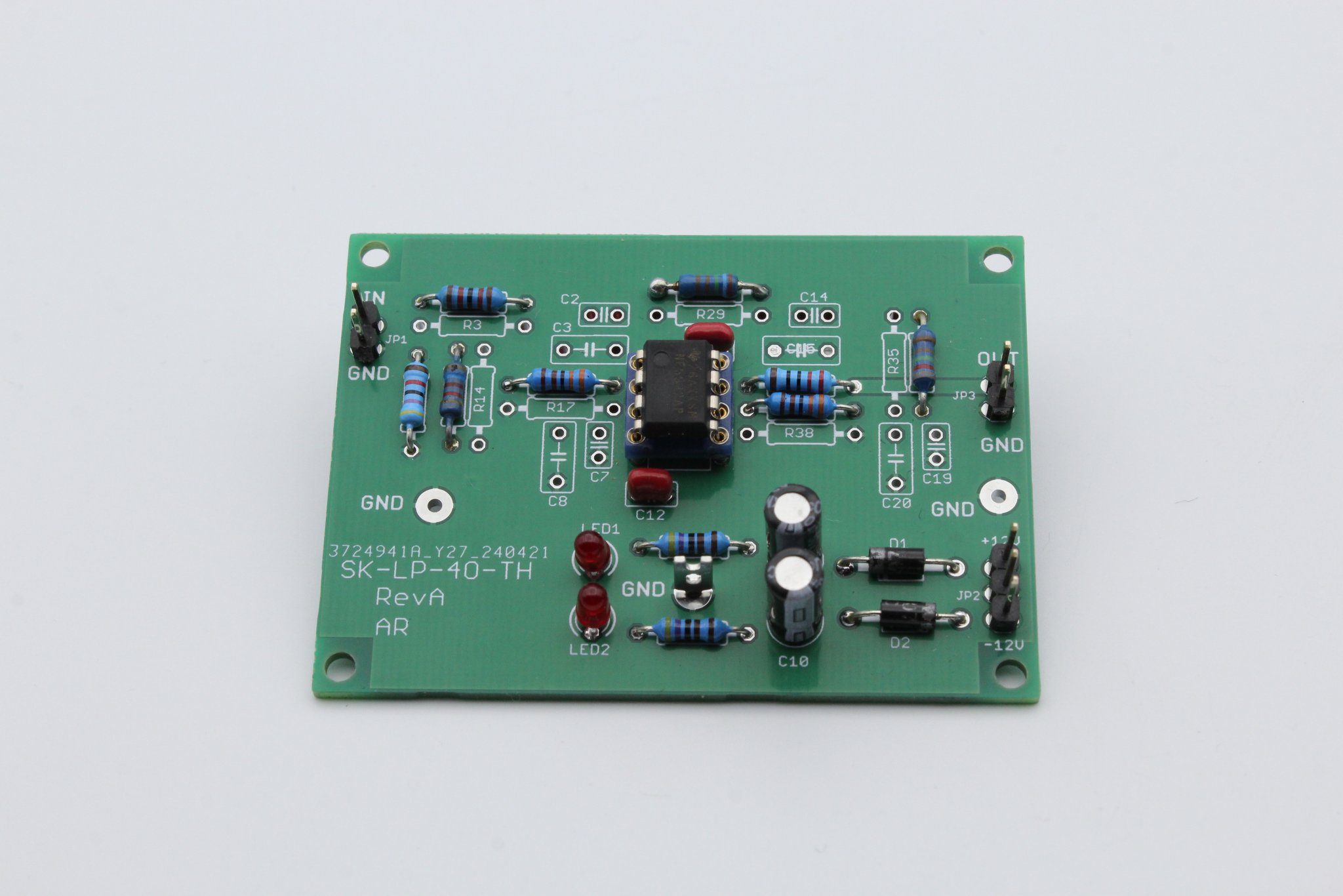

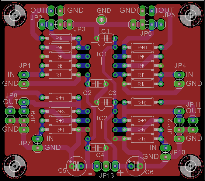

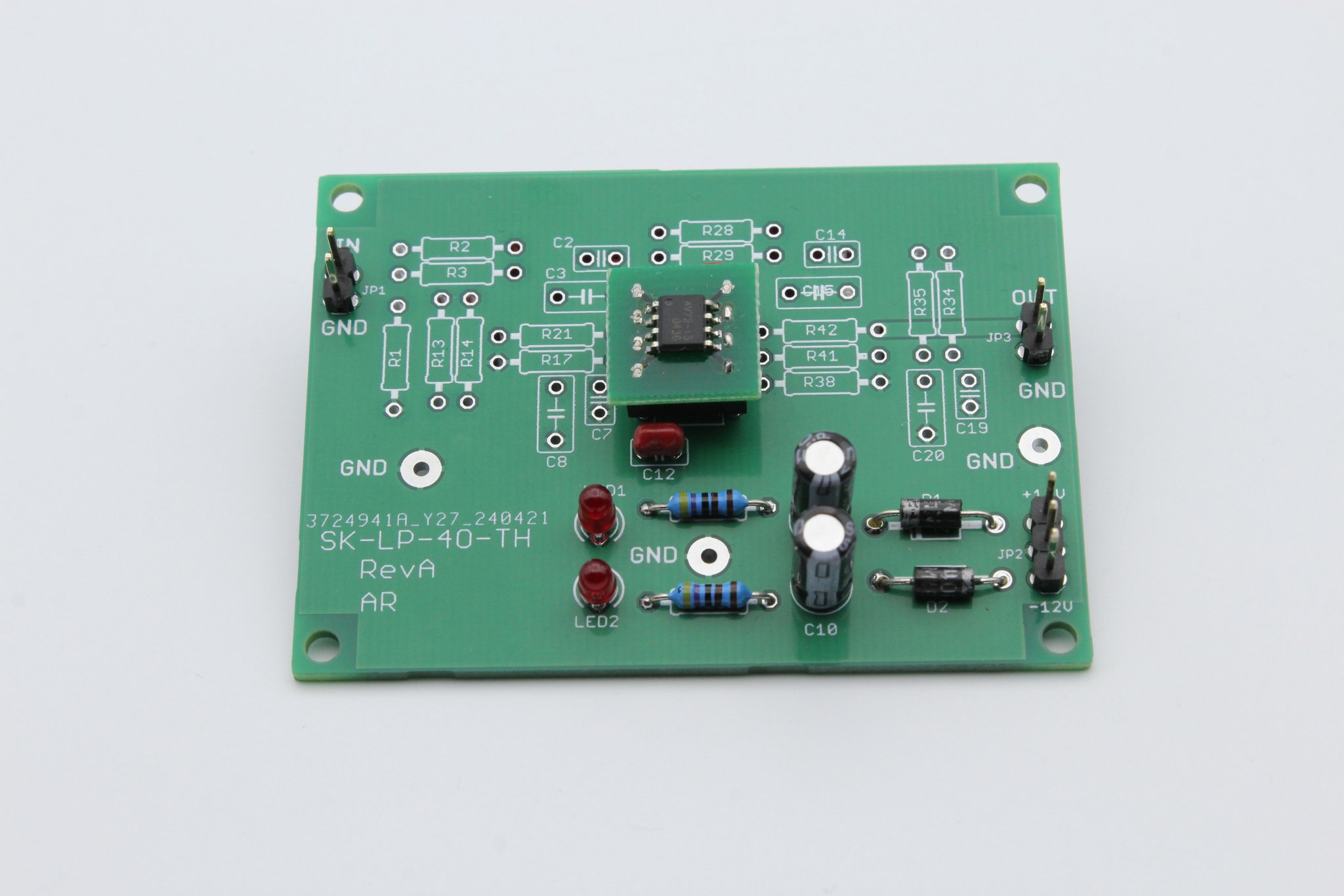

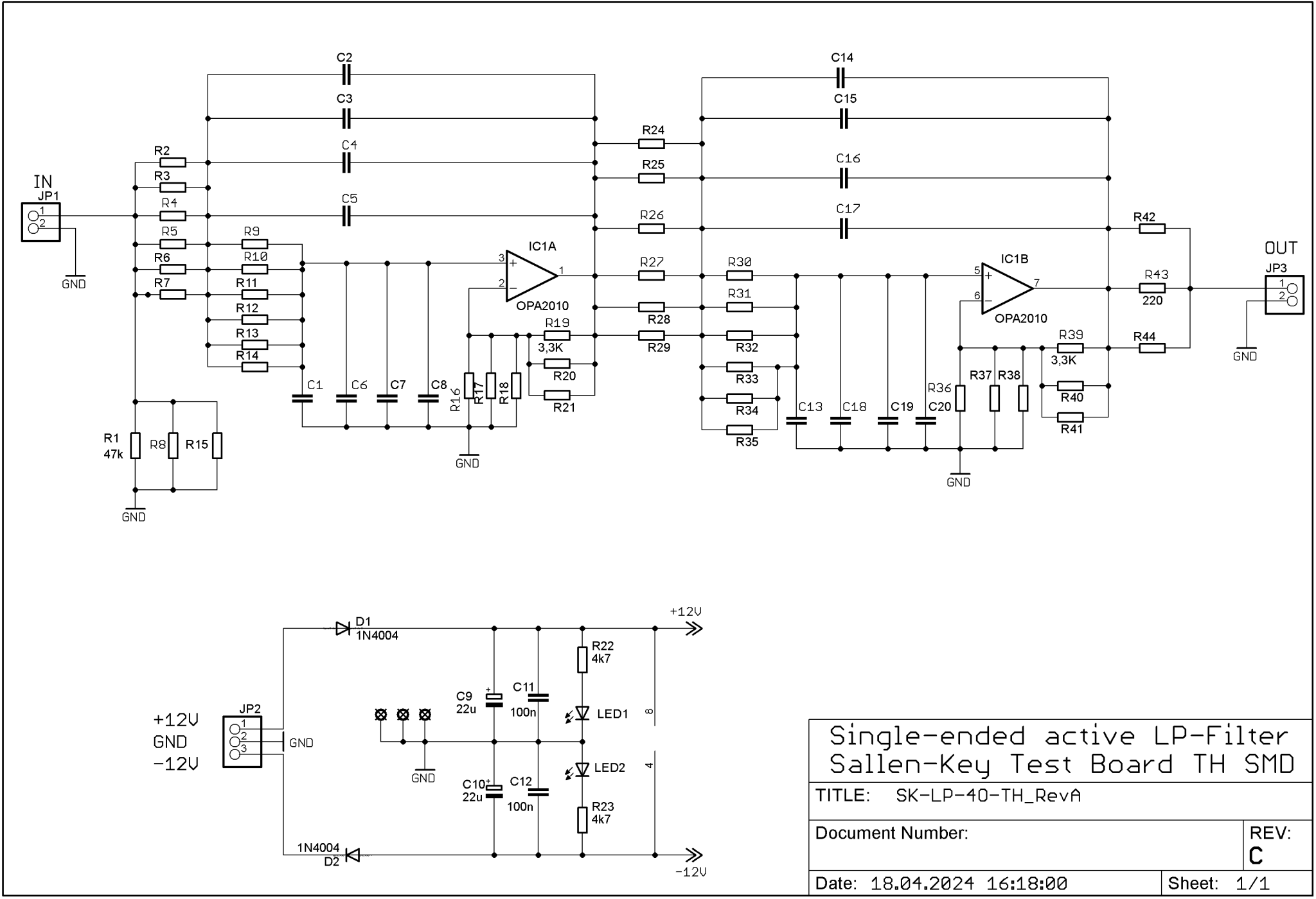

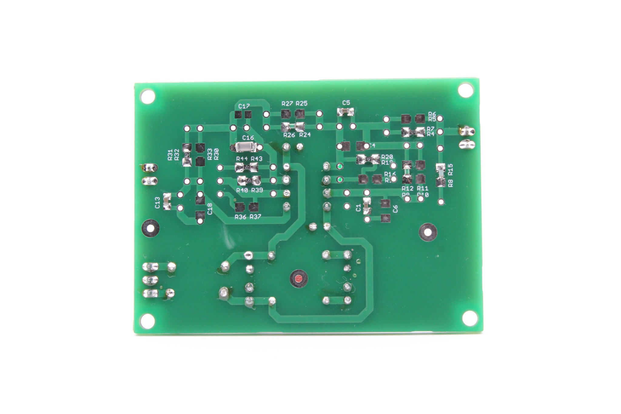

The latest PCB is a Sallen Key Low Pass filter forth order. In contrast to my other filter PCBs it can be loaded with through hole resistors on top or 1206 and 0603 SMD on the bottom side. Same is true for the caps. Please find attached the schematics, layout and some pictures. Some blank boards available.

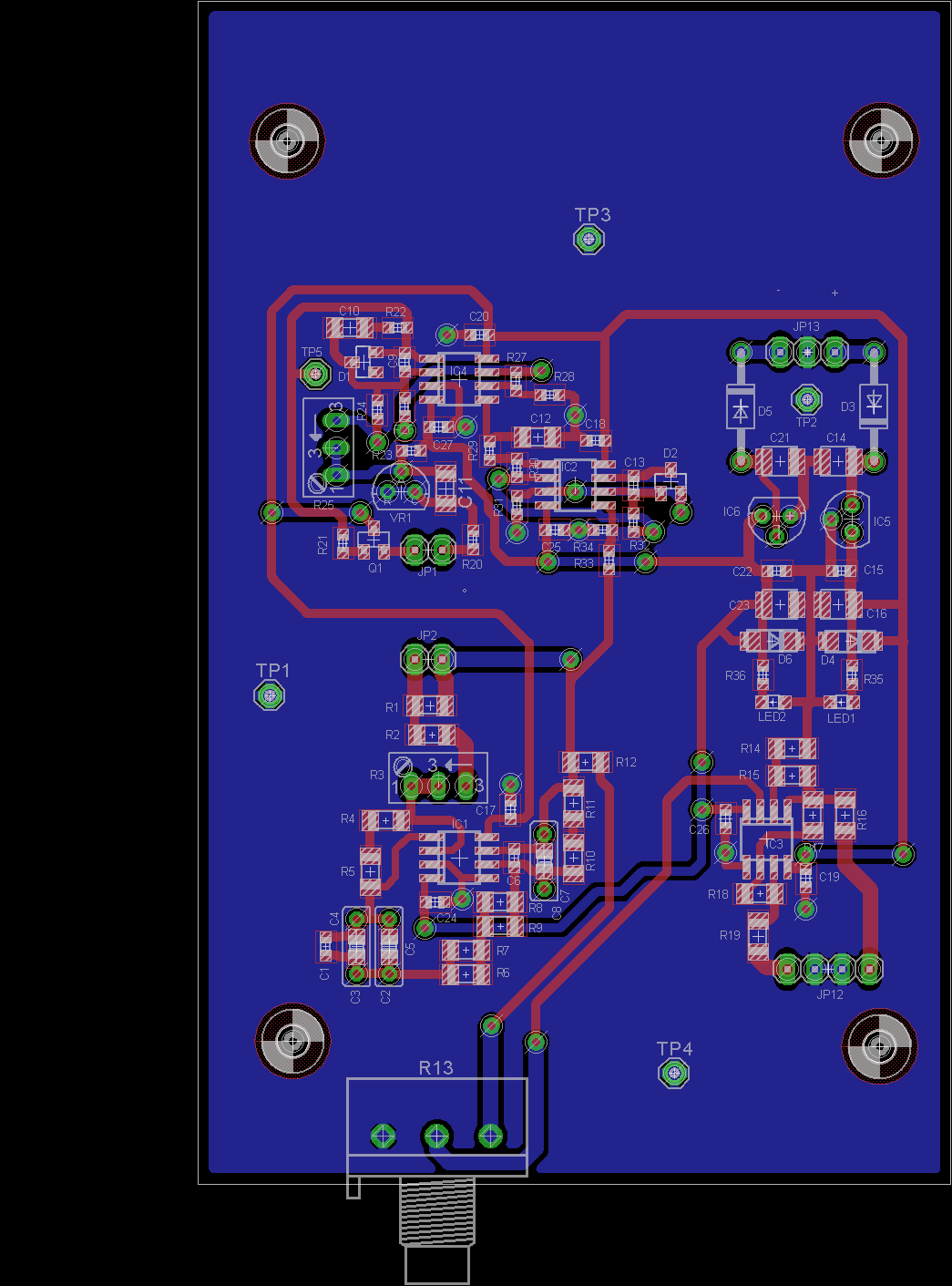

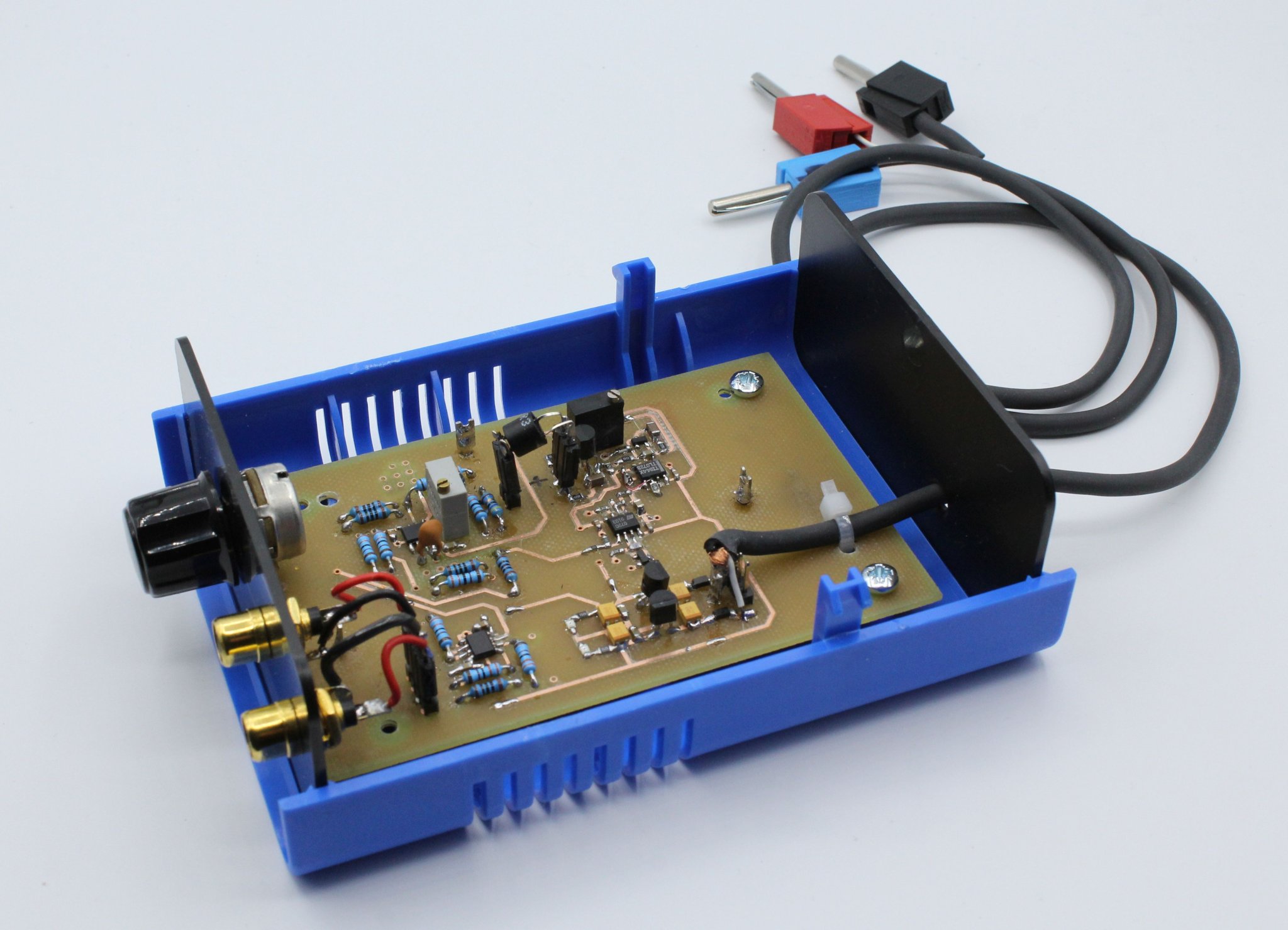

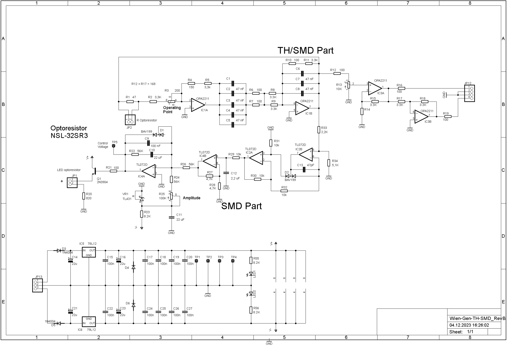

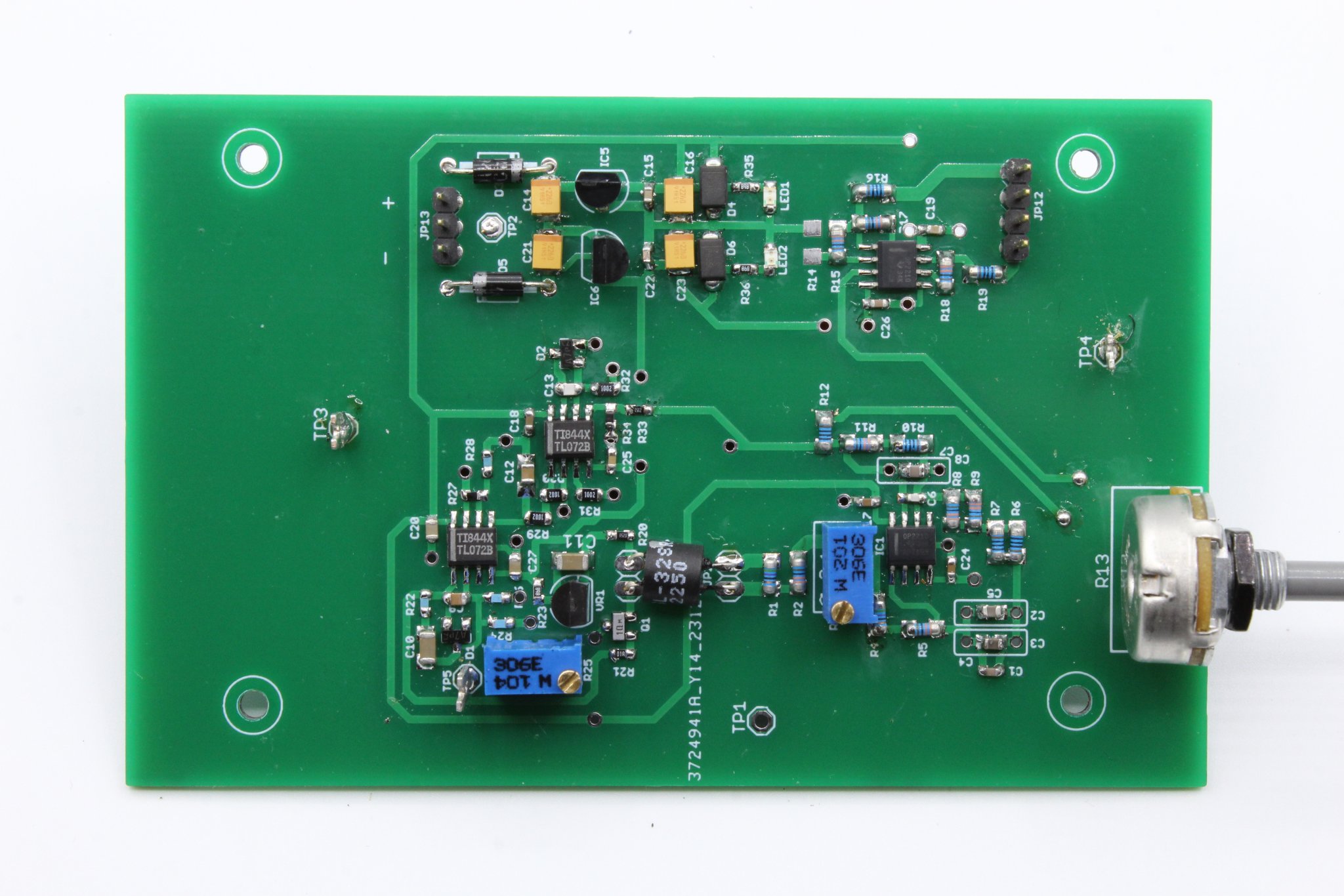

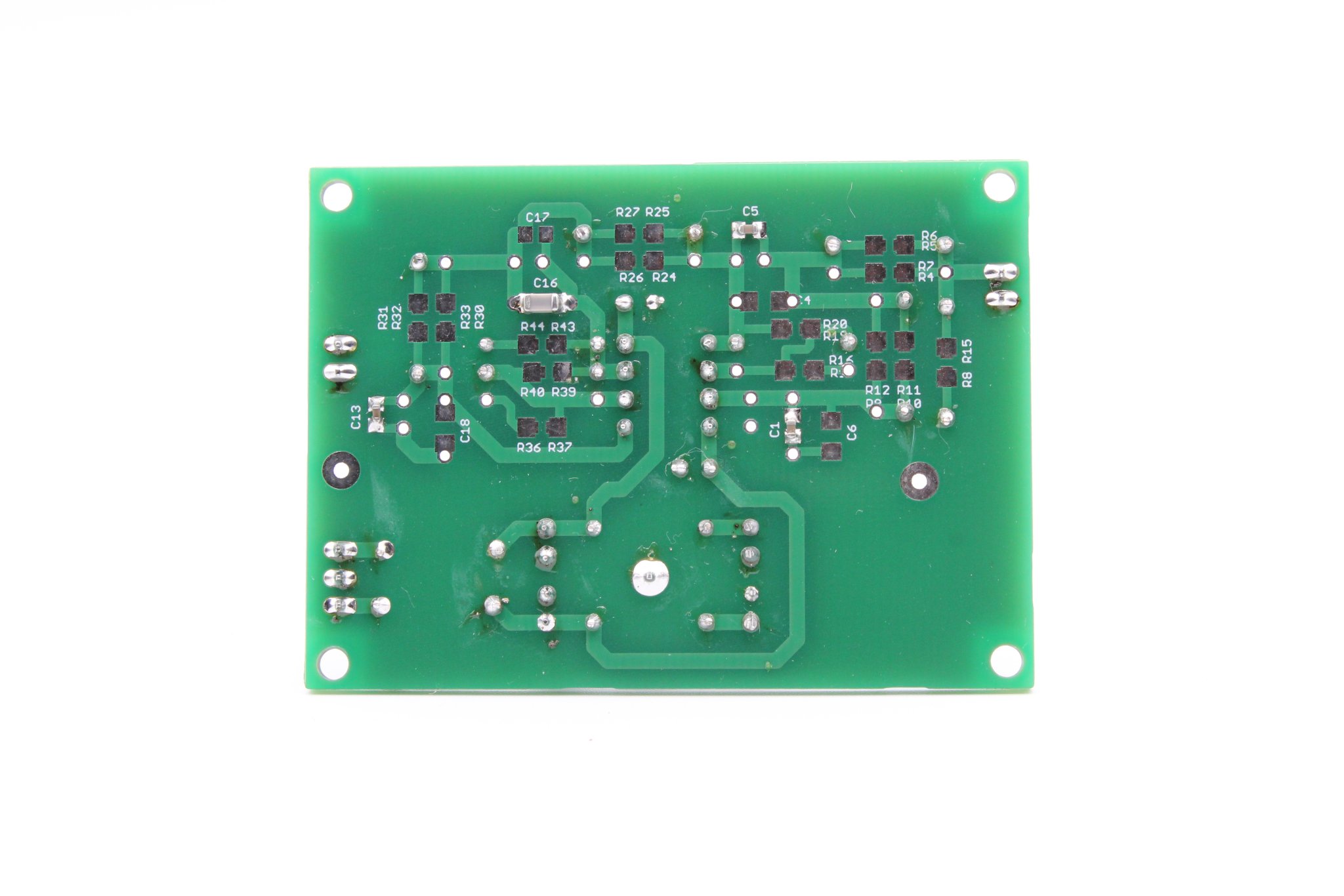

See the latest Elektor issue to find my new "Analog 1 kHz Generator with low distortion":
https://www.elektormagazine.com/magazine/elektor-346/62910

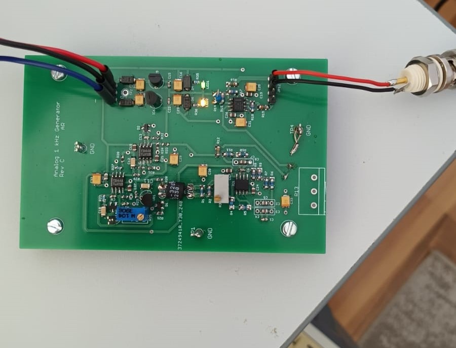

Here are pictures of the schematics, layout, prototype and measurement.

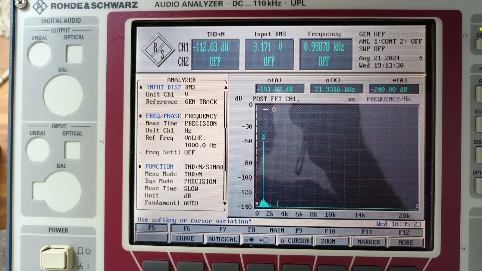

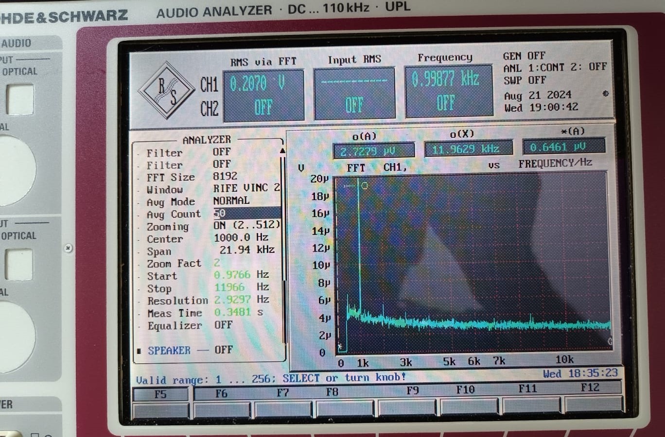

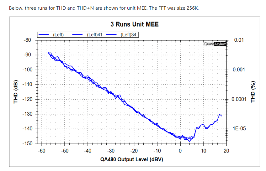

Hello,
I tested the "Analog 1 kHz Oscillator with low distortion " from Alfred Rosenkraenzer. The output voltage of the oscillator was 3.171V RMS and the THD was measured with a passive Twin-T notch filter. The notch filter is followed by an amplifier with a gain of 51 (34.15dB). The output of the amplifier was connected to my audio analyzer R&S UPL. The FFT function gives the following values:
k2 (2kHz harmonic) = 5.5uV, k3 (3kHz harmonic) = 4.5uV, k4 (4kHzharmonic) = 4.0uV
THD von k2 is 5.5*10↑(-6)/(0.3511*51*3.171) = 9.686*10↑(-8) = -140.28dB.
THD von k3 is 4.5*10↑(-6)/(0.5547*51*3.171) = 5.016*10↑(-8) = -146.00dB.
THD von K4 is 4.0*10↑(-6)/(0.6839*51*3.171) = 3.617*10↑(-8) = -148.83dB.
The total THD is then
10*log(10↑(-14.028)+10↑(-14.600)+10↑(-14.883)) = -138.80dB.
That was the worst THD value I could measure. Often the harmonics have almost completely disappeared into the noise. Then the THD is below -140dB.
The Oscillator frequency is very stable and has not changed -998.77Hz-. The output voltage is also very stable.
I measured the THD+N with my UPL and it was -112dB. However, the board was not installed in a shielding housing. The THD+N value would then improve even further.
In summary I can say:
Inexpensive, good circuit with very good measurement results
Helmut Sell

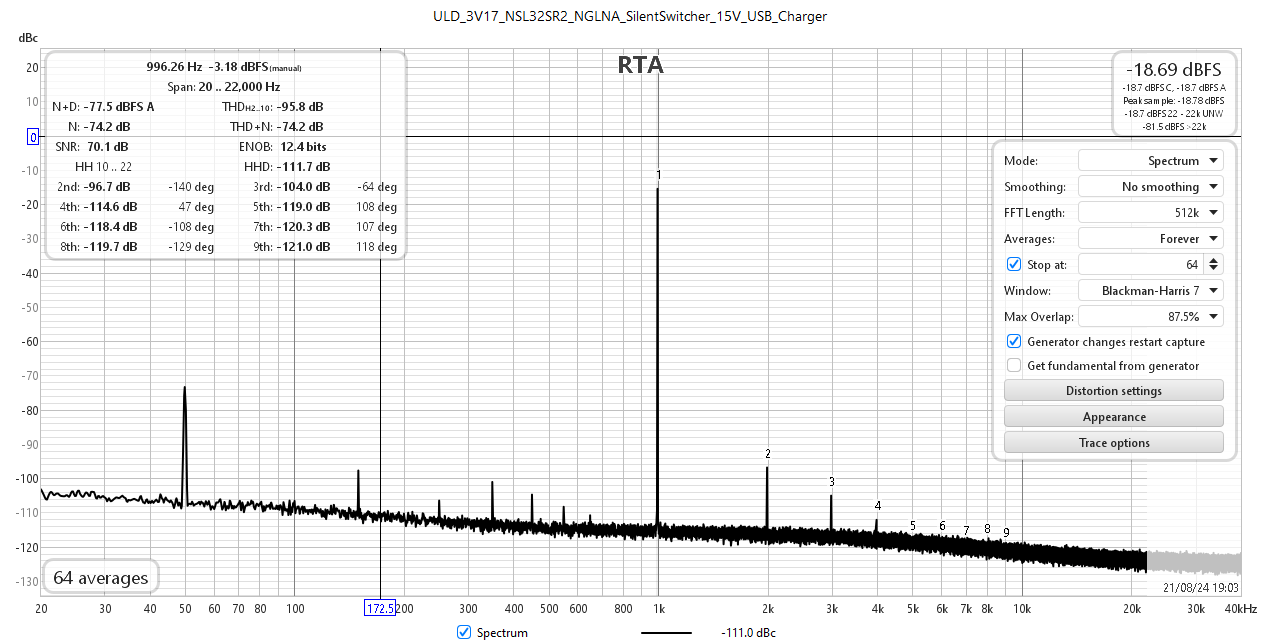

I wonder why you multiply the log function in your last calculation by 10 - you are dealing with voltages, not power.
To me, the THD based on your harmonic's RMS values would be:
THD = 20*log(sqrt(5.5**2 + 4.5**2 + 4**2)*1e-6)/(51*3.171)) = -145.9dBc
This is the value I also measured with my build of the Janaczek oscillator coming from an open source project on GitHub:
https://github.com/mpinese/electronics-uldosc
Referring to the spectrum attached, the 2nd harmonic is at -96.7dBc, but since I used a notch filter and an LNA with 60dB gain, the true value is (-96.7 - 50) = -146.7dBc because my notch filter attenuates the 2nd harmonic by 10dB.
The other two harmonics have little influence on the THD, and can thus be ignored in the first approximation.

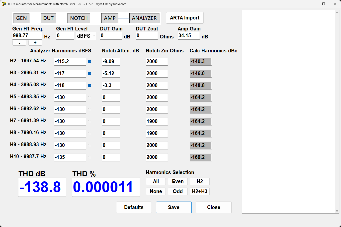

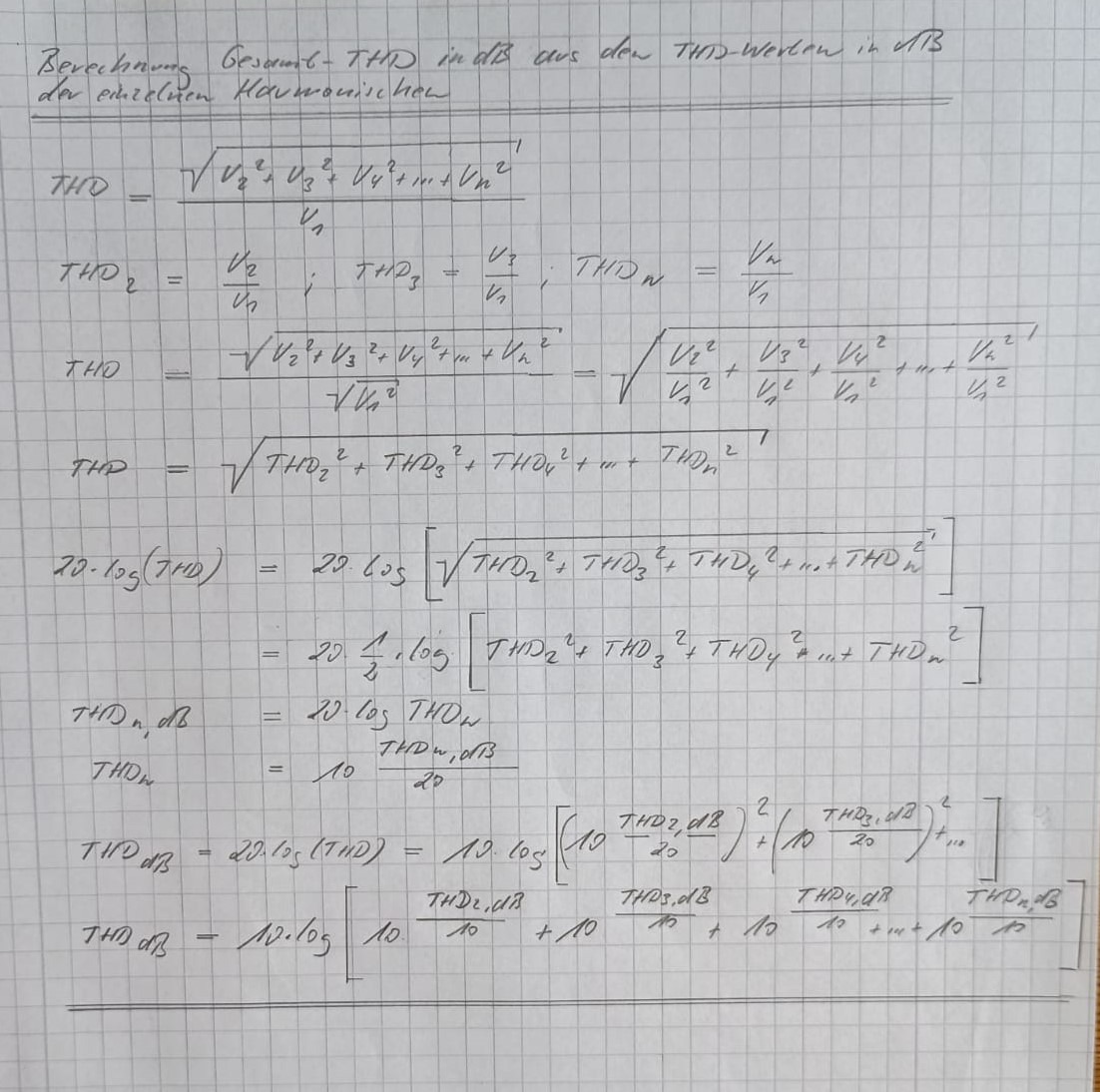

Hello DNi,
When calculating the THD, you must take into account the values of the transfer function of the notch filter. These are :
0.3511 (-9.091dB) at 2kHz
0.5547 (-5.119dB) at 3kHz
0.6839 (-3.300dB) at 4kHz
You can't simply ignore the values for 3 and 4kHz .See THD calculation.

Hello Helmut,
Thank you for your explanation.
My mistake was that I assumed your harmonic's values in uV to have been already compensated for the notch filter attenuation.
Your THD calculation is then correct, although a little complicated for my taste.
BTW there is a neat THD calculation tool in this forum:
https://www.diyaudio.com/community/threads/low-distortion-audio-range-oscillator.205304/post-7018477
I applied it to your measurement, the result is in the attachment.
Re. neglecting the 3rd harmonic in my measurement results: the difference between the 2nd and 3rd harmonic is 10.7dB (notch filter att. taken into account), so the 3rd increases the THD by only 0.3dB, and the 4th has no practical effects.
I would expect a bit better performance from the oscillator you measured in comparison with my build because the PCB design forced me to use 0603 SMD parts throughout (except the capacitors, where I used Wima FKP2), which is suboptimal for measurement circuits.
