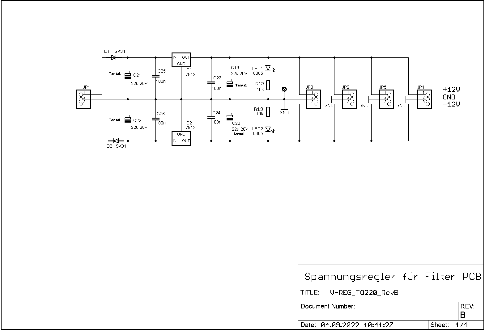

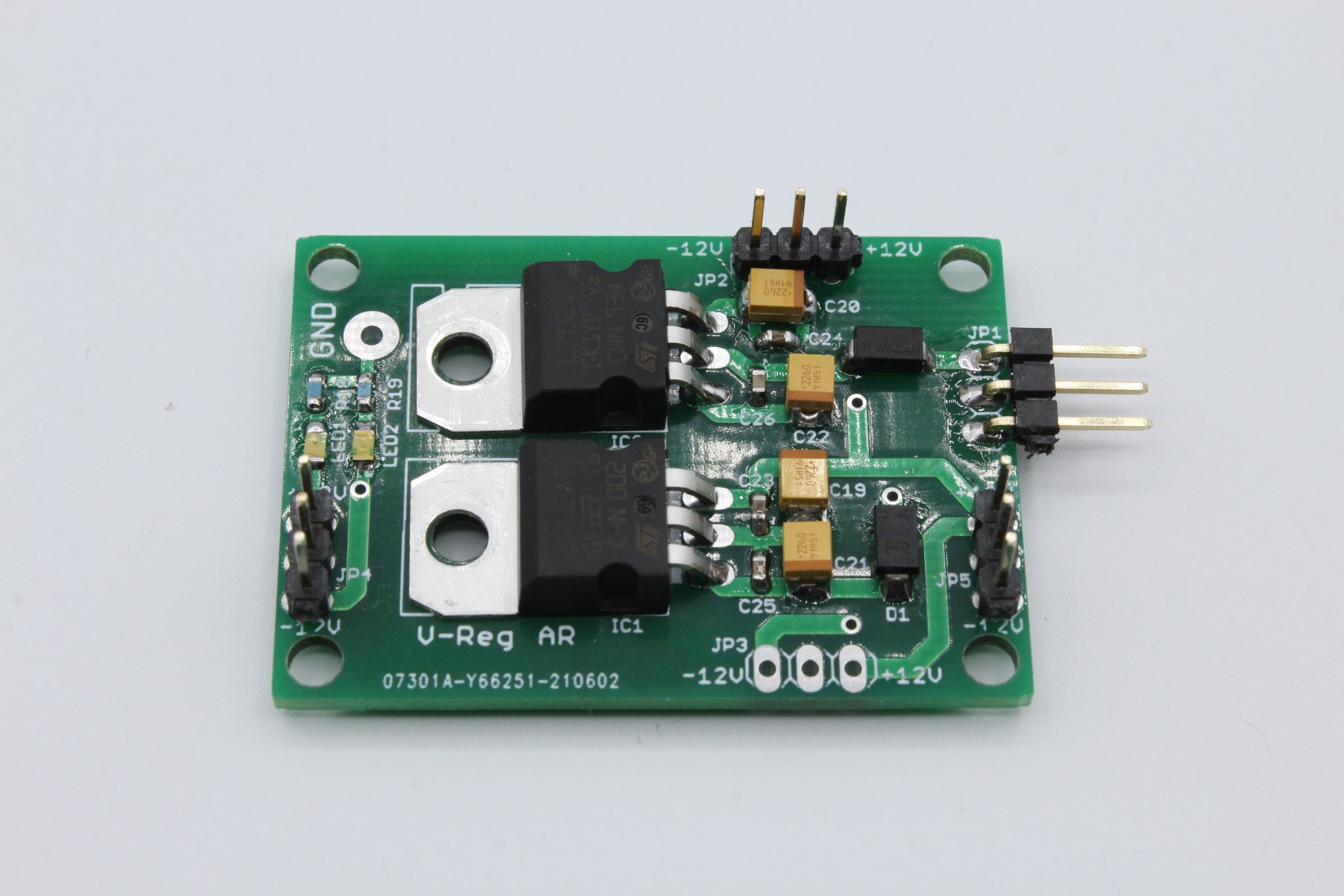

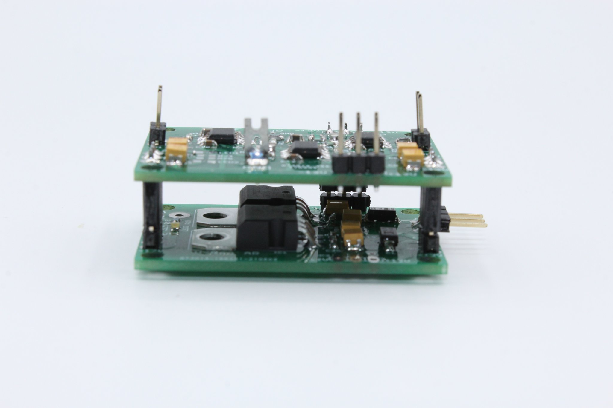

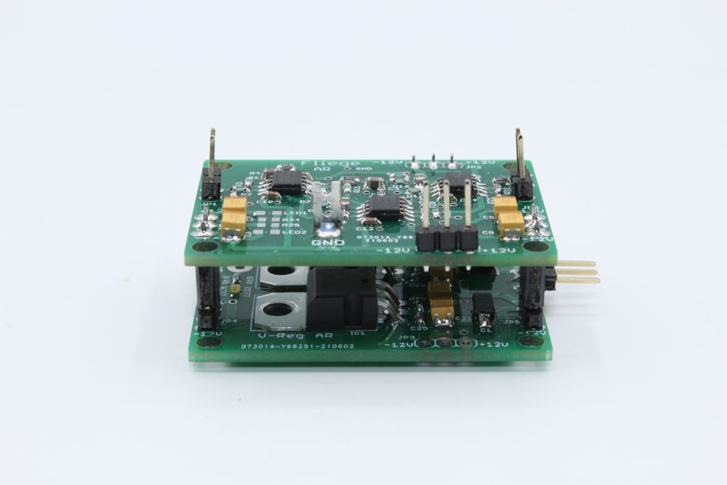

Most of my filters have the same size of 32 by 45 mm. Input connector is left, output on the right side. Power connections on all four sides. So it is easy to put them in series or in parallel for multi channel setups. There is also a voltage regulator board which can be stacked up on a filter.
This picture shows the dimensions:

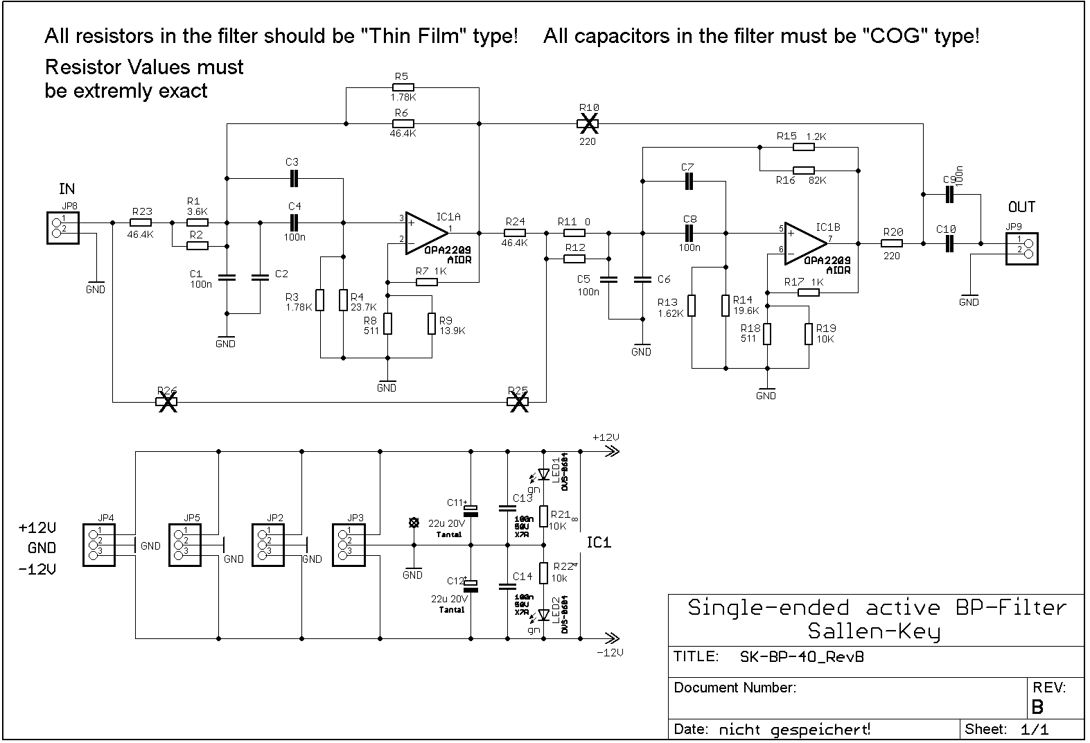

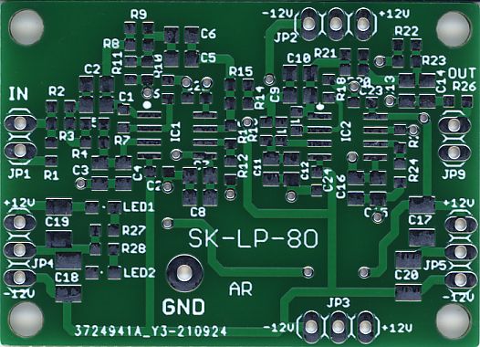

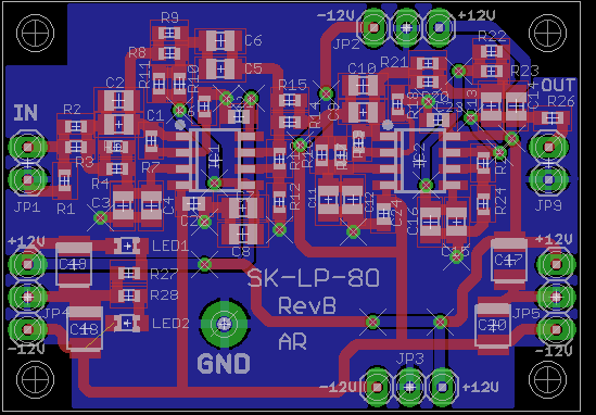

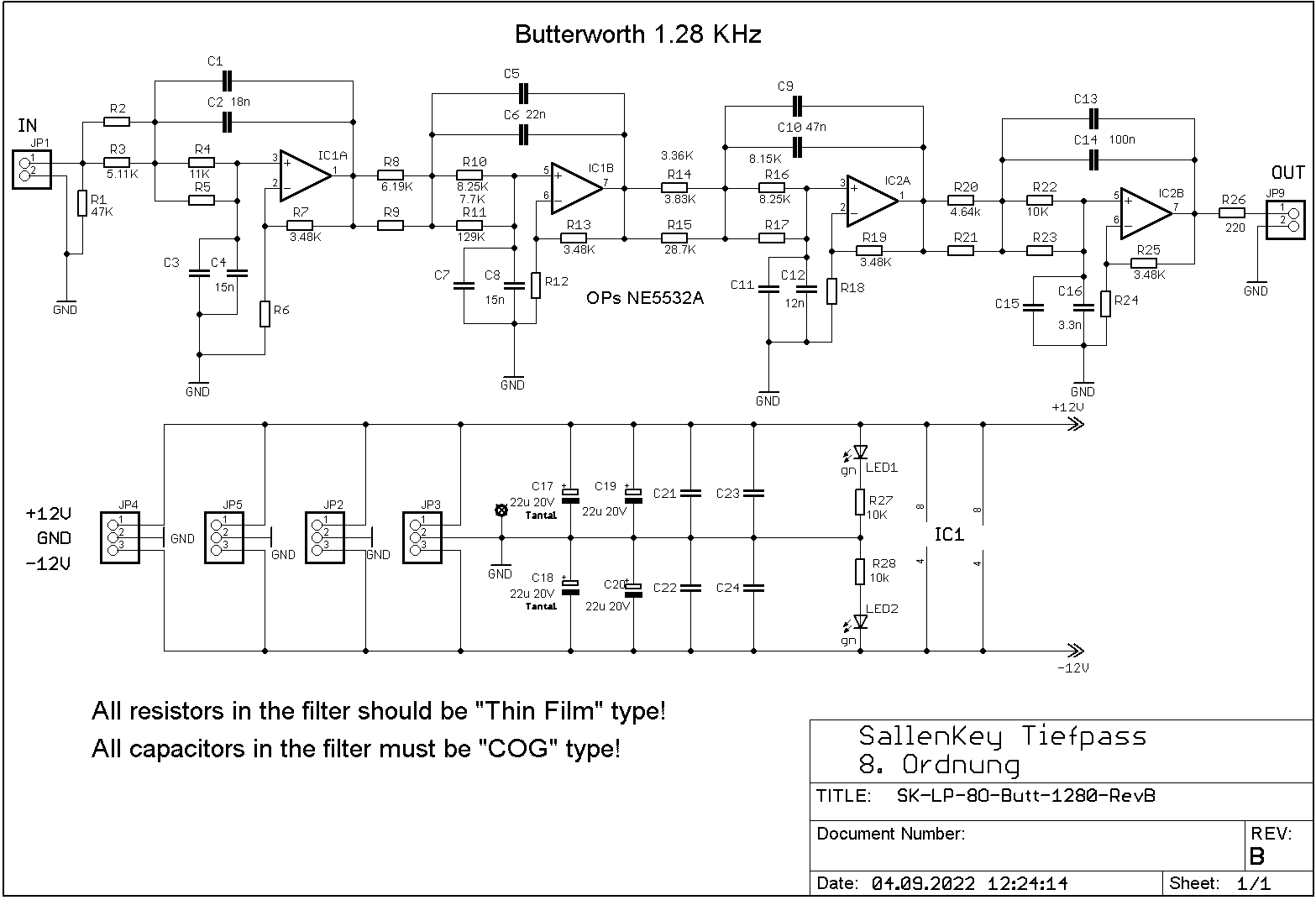

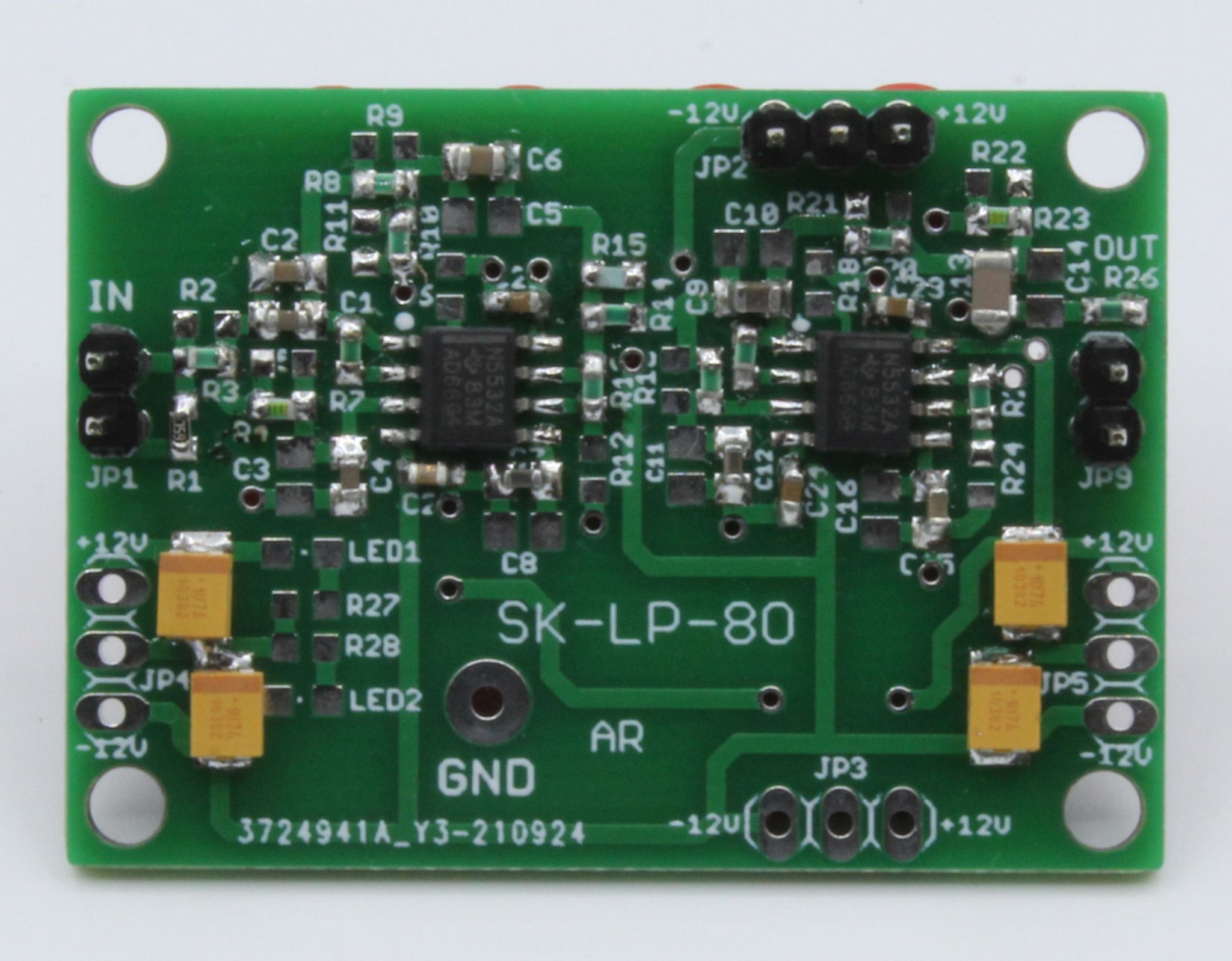

I did a Sallen Key low pass 8. order and a 4.order bandpass filter mainly to clean a 1 kHz test tone coming out of an audio interface. They were described in Elektor 5/2023.
Attached are pictures of the schematics, layouts, samples and measurements.
If you like to get more info, just ask!

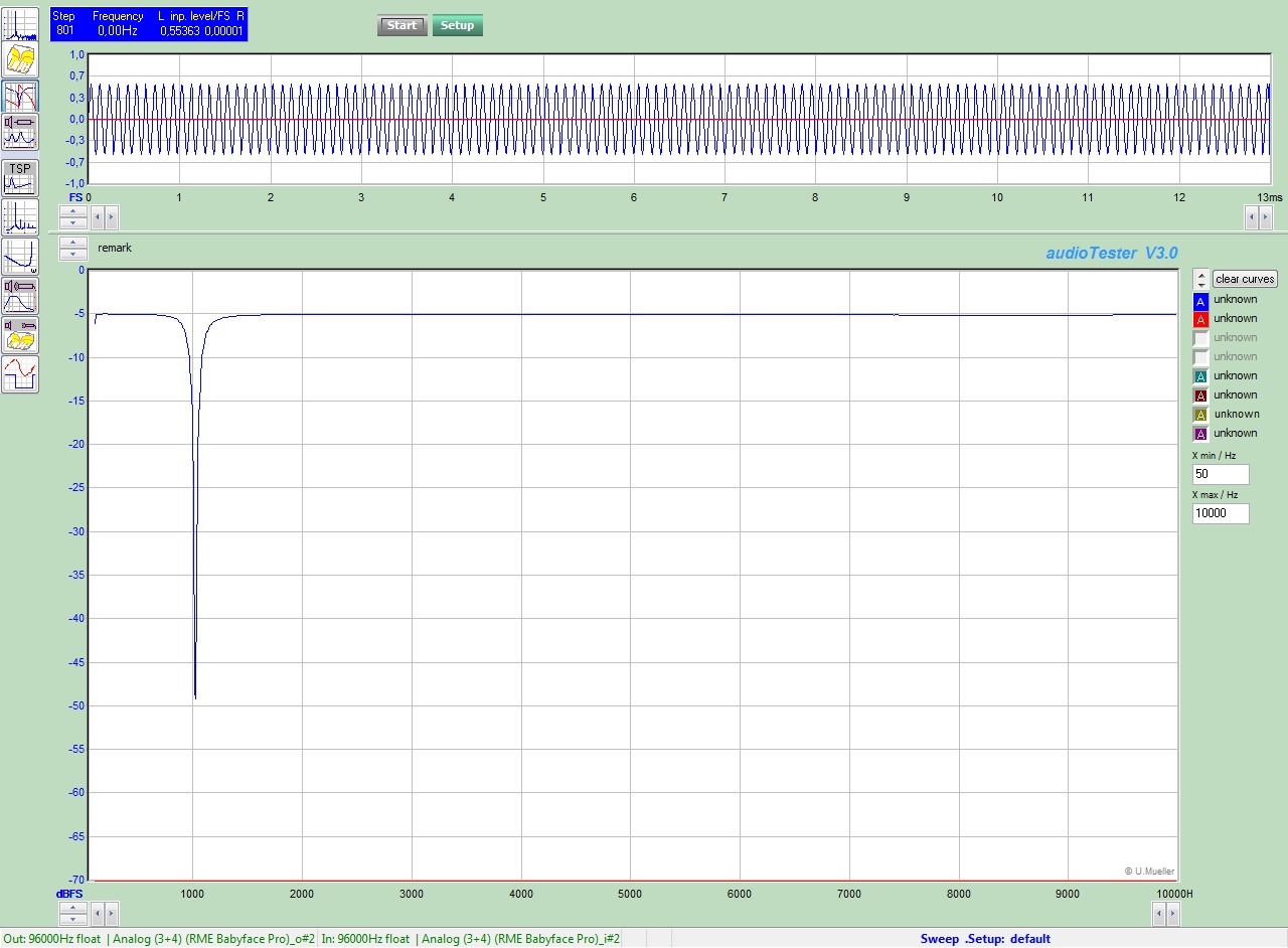

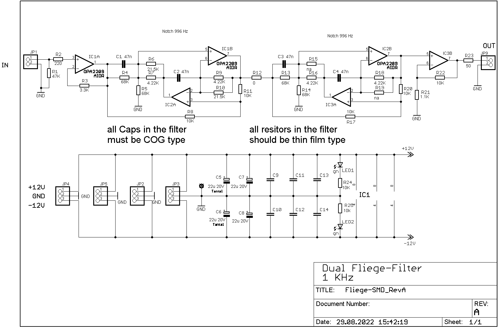

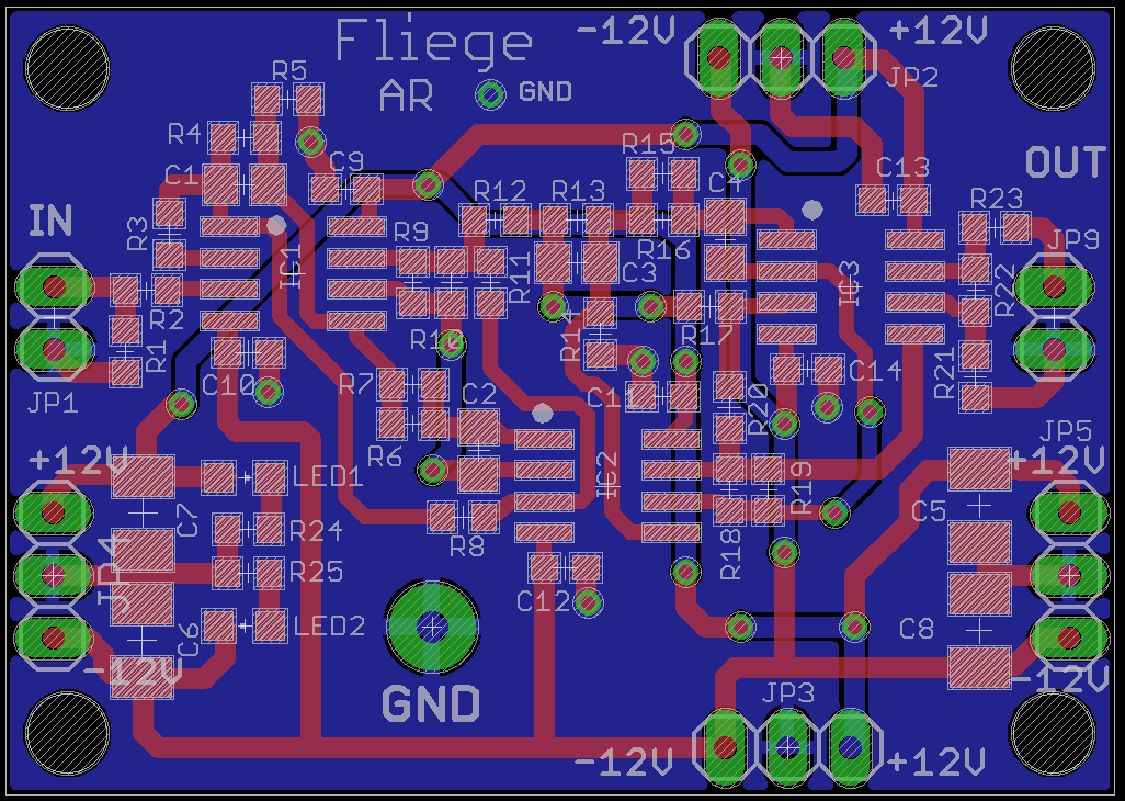

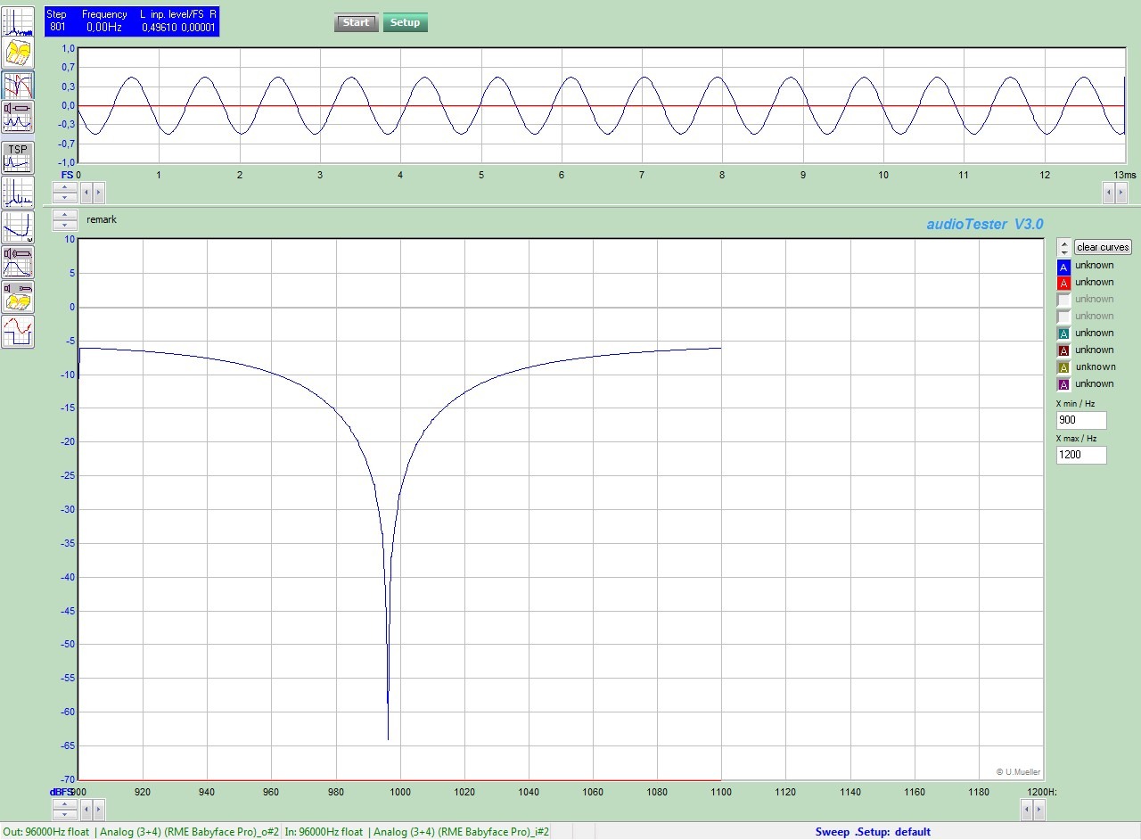

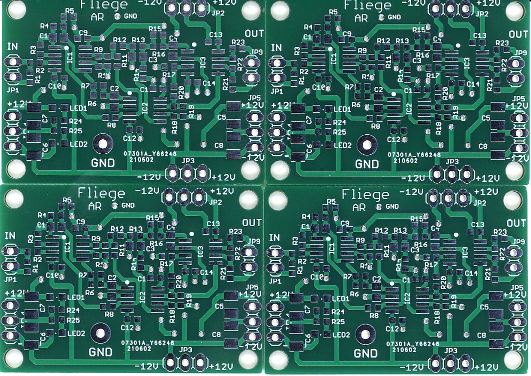

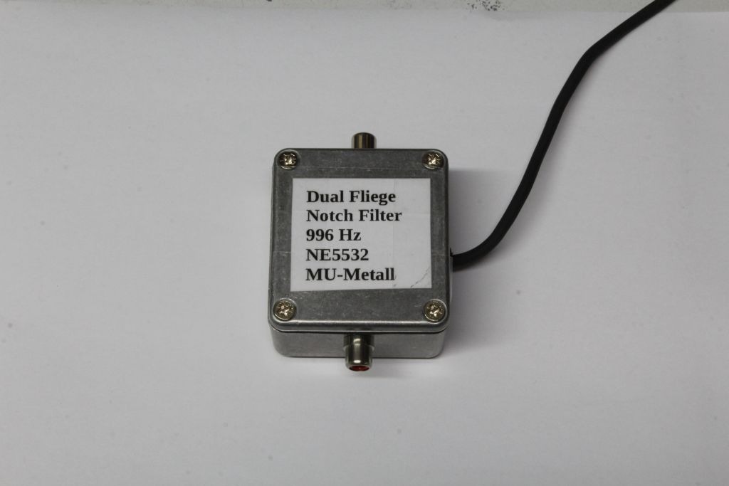

Now I like to talk about my Dual Fliege Notch Filter. There is an article about it in ELEKTOR September 2022.
Here is the schematics and layout.
Layout:
The frequency response:
and a zoom out:
More pictures attached.

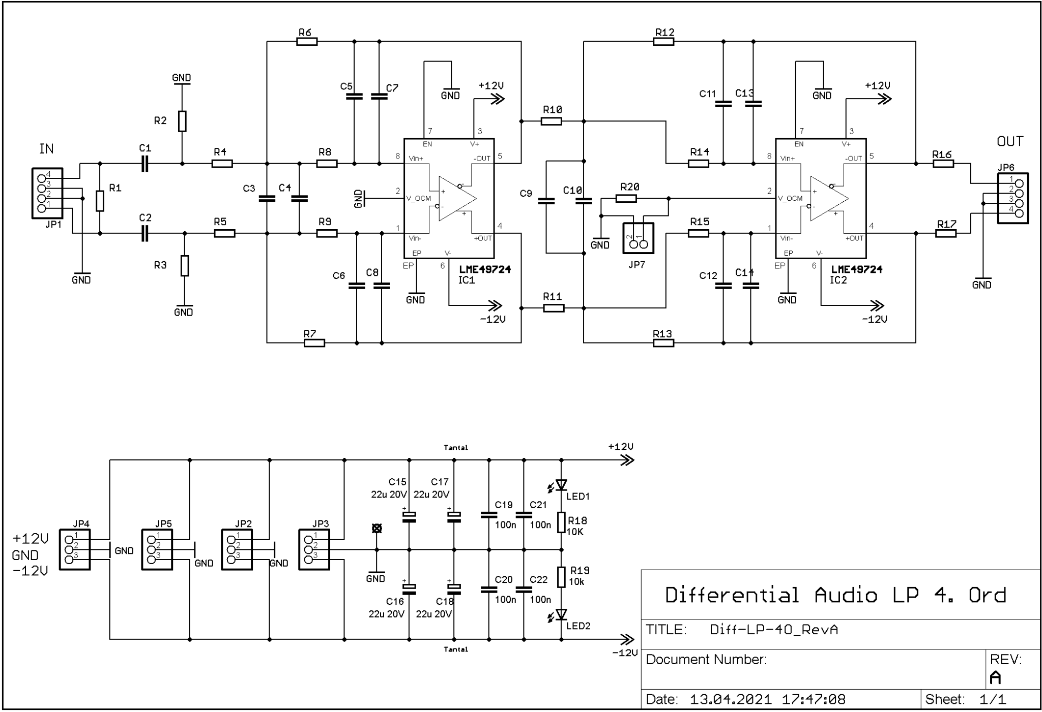

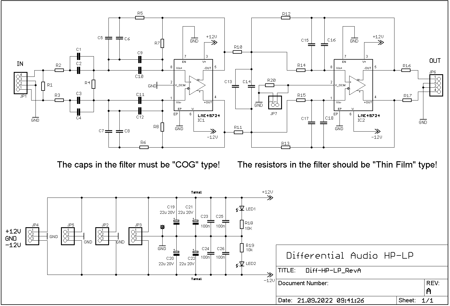

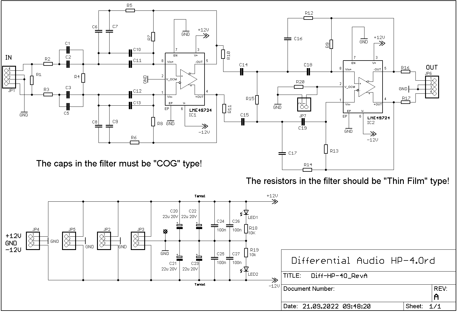

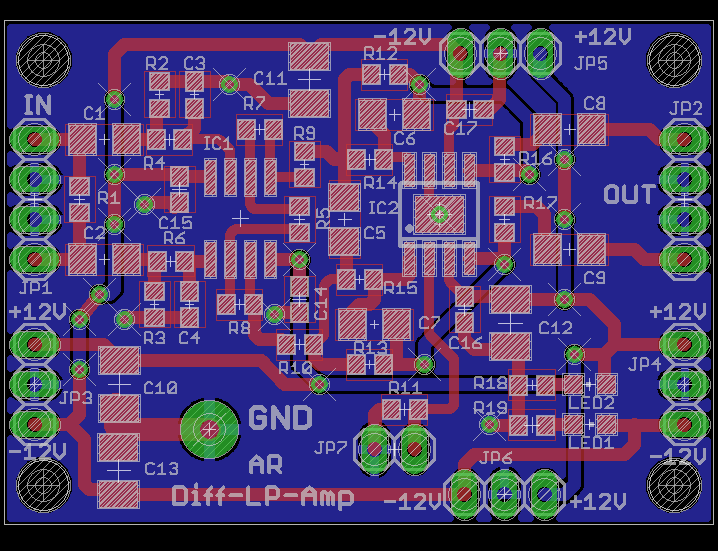

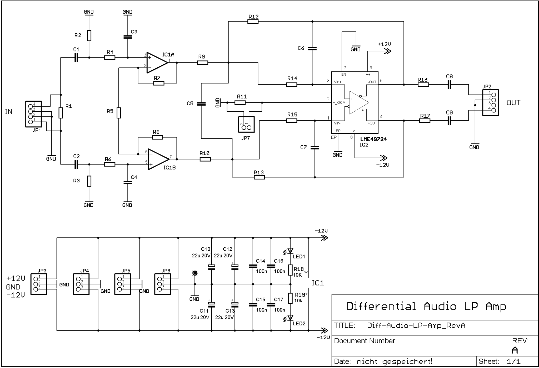

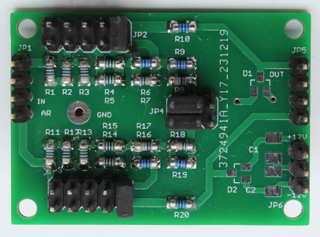

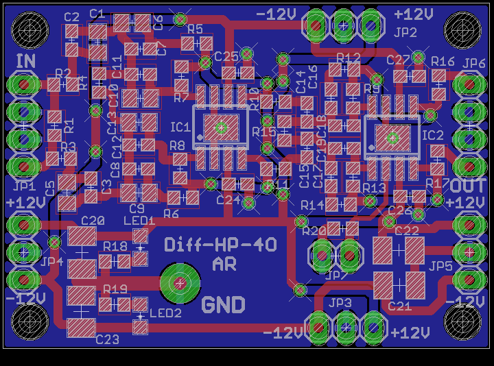

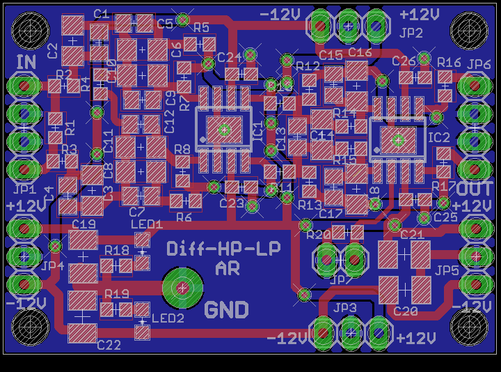

Today I will show my fully differential filters. I did 4.order low pass, high pass and a combination of low and high pass.
Finally a board with high impedance input and a 2. order low pass. At the final stage a common mode voltage can be added.
Here is a schematics:
And the layout:
All boards have the same size.

What's the thought behind fully differential filters except for the input stage for an ADC or (maybe) output stage for a DAC?
Maybe as a single pre-stage for a fully balanced power amplifier with a bridged output (= also balanced).
Within a circuit itself the common mode noise is basically none existing?
Or very easy to mitigate.
Which is basically the only reason to go for differential signals.
Let's assume an instrument with differential inputs and a differential ADC at the end of the signal chain.
And a filter in between (for whatever reason).
If you change to a single ended filter after the input stage and then again to differential for the ADC you need a factor of 2 more gain
since you are not using the second output of the input stage (assuming it is differential).
This might lead to more THD and also SNR might be worse compared to a fully differential chain.
Reactions: dkfan9
you can tell the filter SW to use ESeries cap values, but the real caps normally have 5% tolerance or even more.
With the second cap in parallel you can compensate it. The higher the order of the filter the more sensitve it is to value variations.
It is a good idea to measure the caps values before you load them.
On the diff-to-se side you half the gain, so it kinda crosses out with each other.
(especially the SNR).
If it's just one simple (or maybe two) stage, I agree that it might not be worth the trouble.
But in a sense of an entire (crossover) filter, it's just not worth all the trouble (and additional costs)

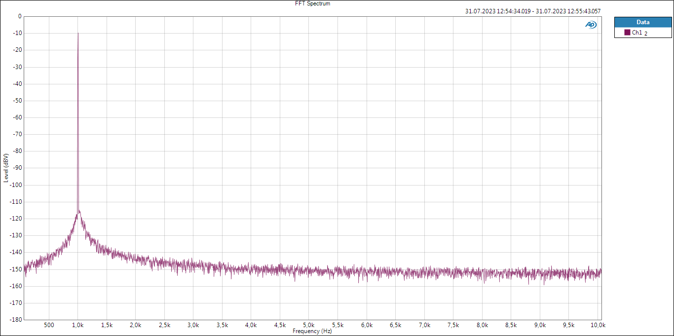

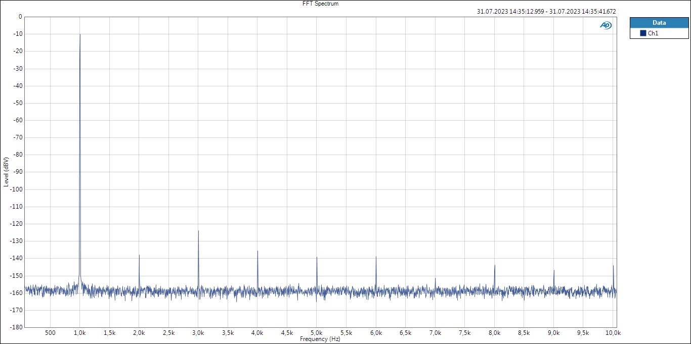

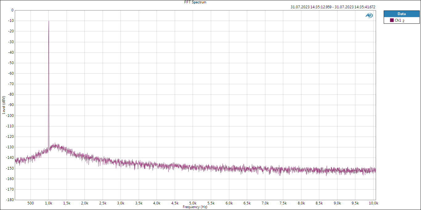

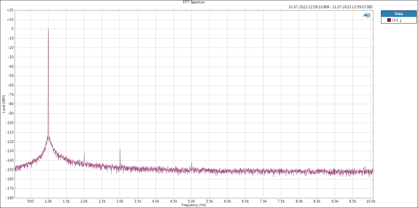

@alfredr Makes total sense, thank you. Interesting circuits. Have you measured distortion/noise, particularly for the post 2 circuits?
Yes, I have quite some measurements. You can read the whole story in Elektor 5/2023. But you need to invest "fistfull euros". Please understand that I am not allowed to share the article.

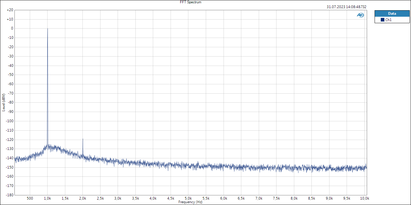

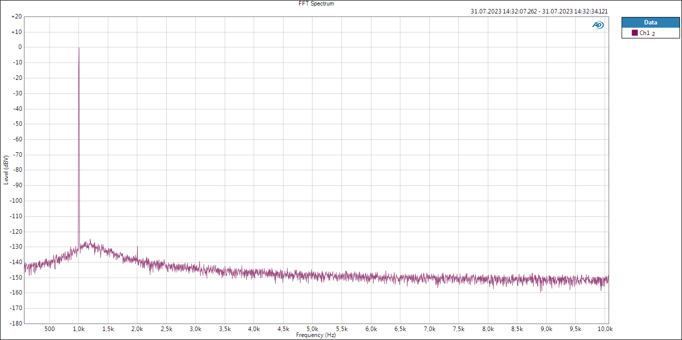

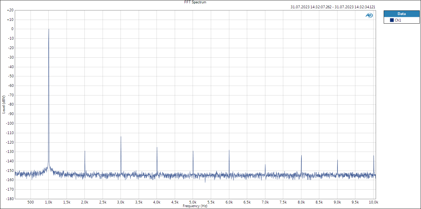

Some time ago I was lucky to get acces to an APx555, the best instrument money can buy.
Here is a loopback of the digital (DAC) generator and the digitizer of the APx555 at 0dBV, not filter.
You can see quite some harmonics.
Now with the SK-LP-8.order with OPA2209 OpAmps. Not that bad, or?
Most of the harmonics disappeared. One left at 2 kHz and -130 dBc. There is some additional noise around 1kHz, but this is according the simulation.
At -10dBV level it looks like this.
During the chip crisis the OPA22xx were not available, so I started with the good old NE5532. Here a picture with 0 dBV level.
The second harmonic is about 10 dB higher.
Pictures of the band pass will follow.

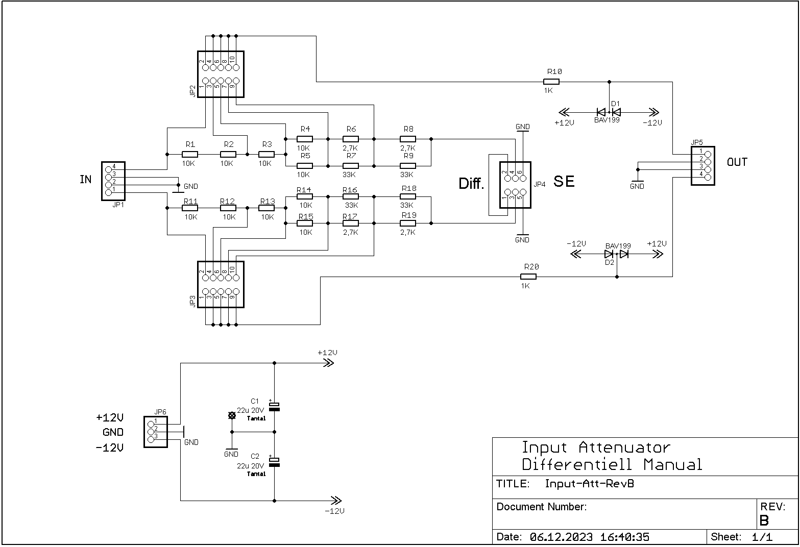

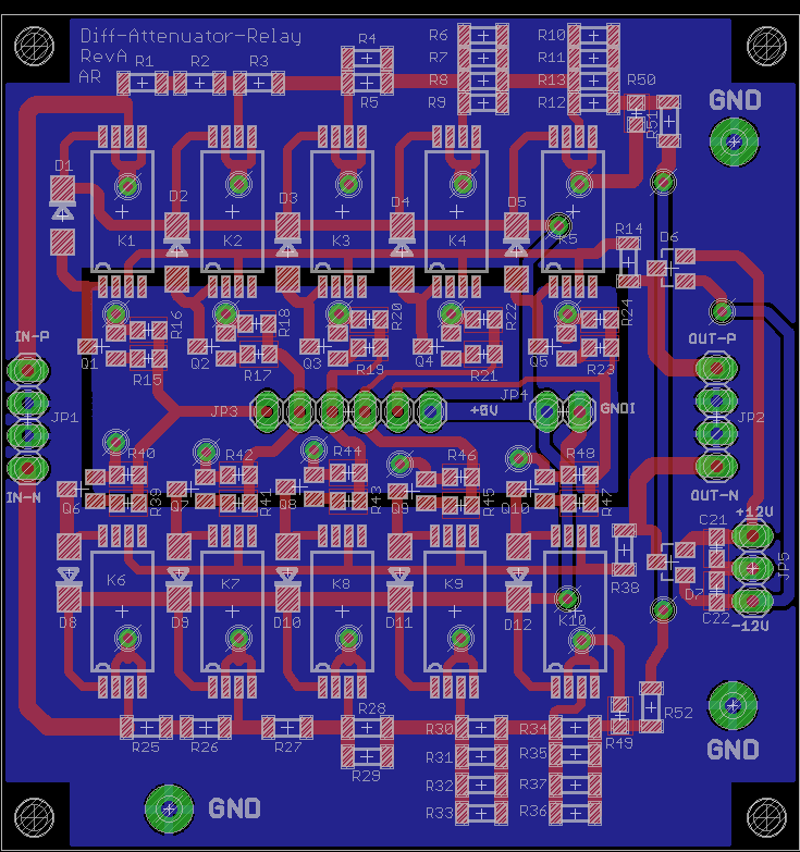

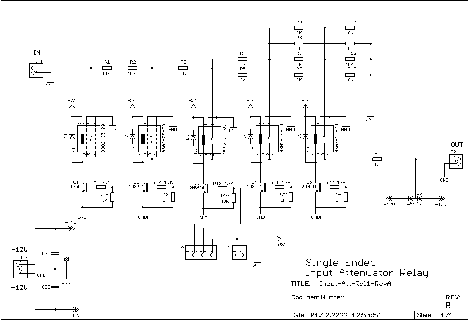

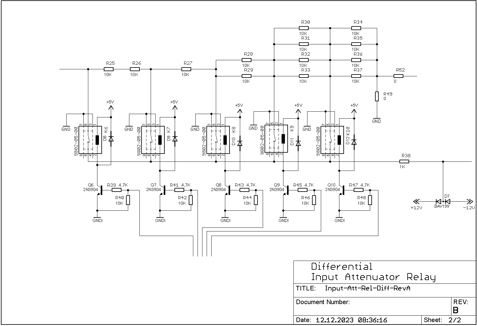

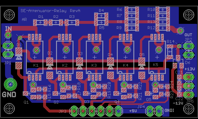

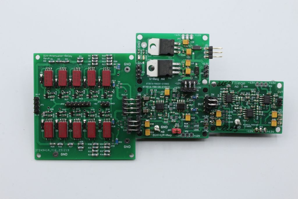

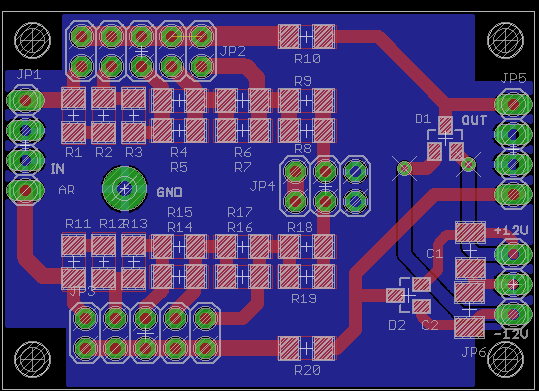

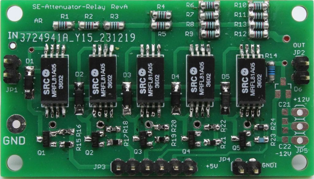

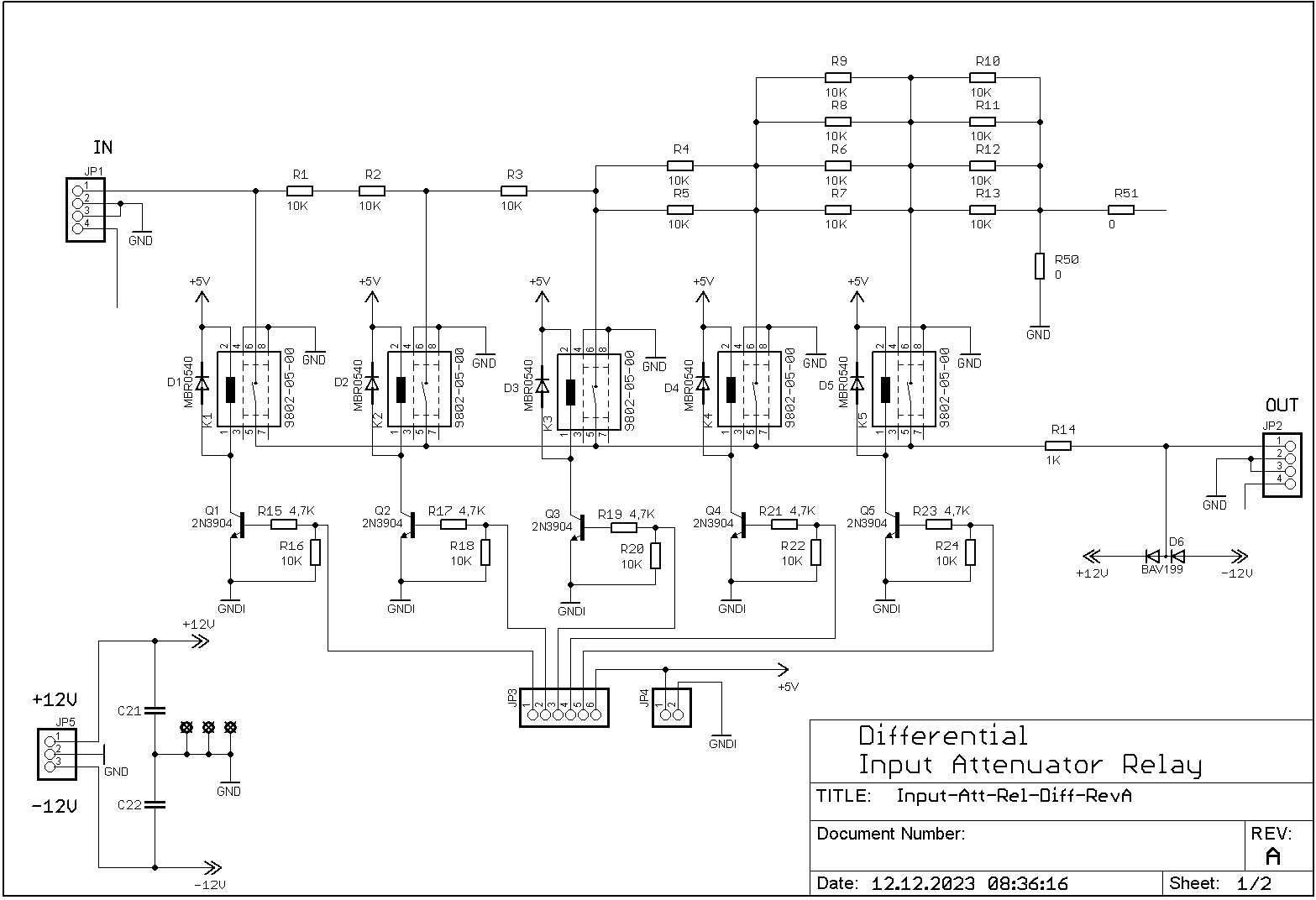

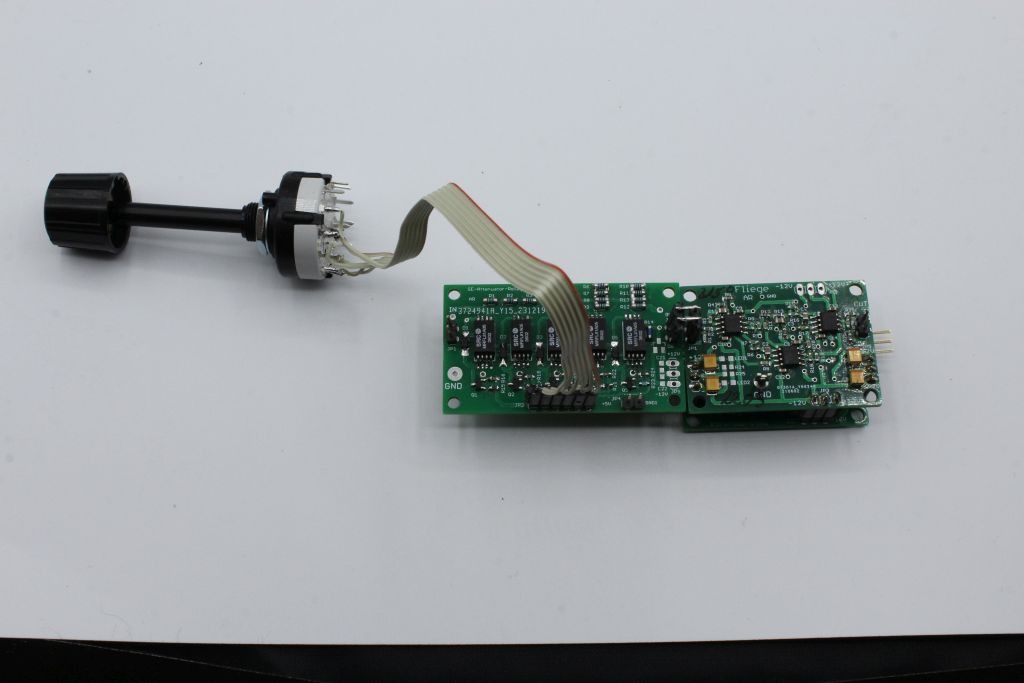

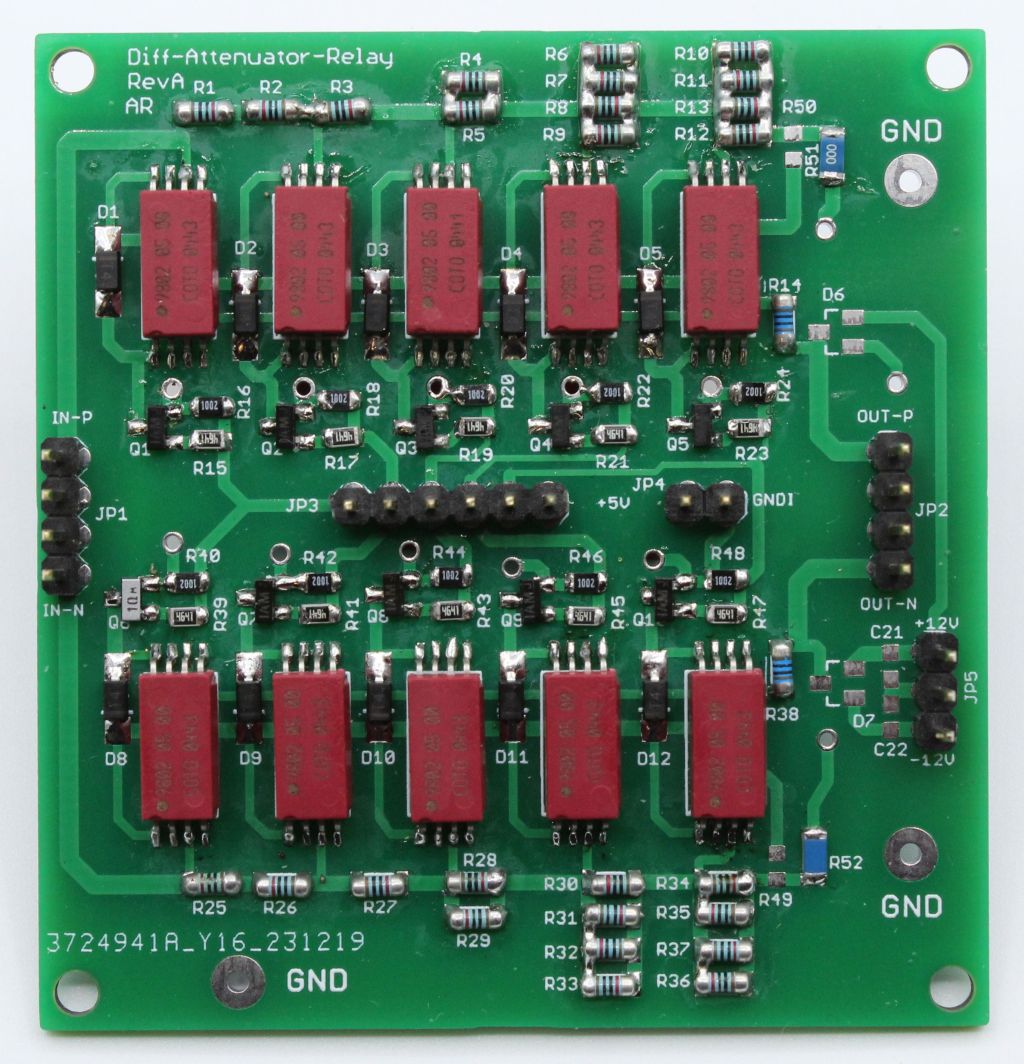

Today I like to show my attenuantor boards:
This is the manuell version. Two times single ended (stereo) or one times differential.
This is the single ended version using relay to switch. Can be controlled by a rotary switch or a controller (Arduino, ESP etc)
Now the differential one with relay.
This is how the SE relay attenuator may be connected to my dual fliege notch. The voltage regulator board is under the notch.
Finally the differential version. From left the diff attenuator, fully differential amp, dual notch filter. Above the amp is the voltage regulator.
Put it in a box with some switches and connectors and you get a nice instrument.
If you like to get some blank boards, just ask.
Attached the schematics and layouts of the attenuator.
If you have questions, just ask.
Alfred

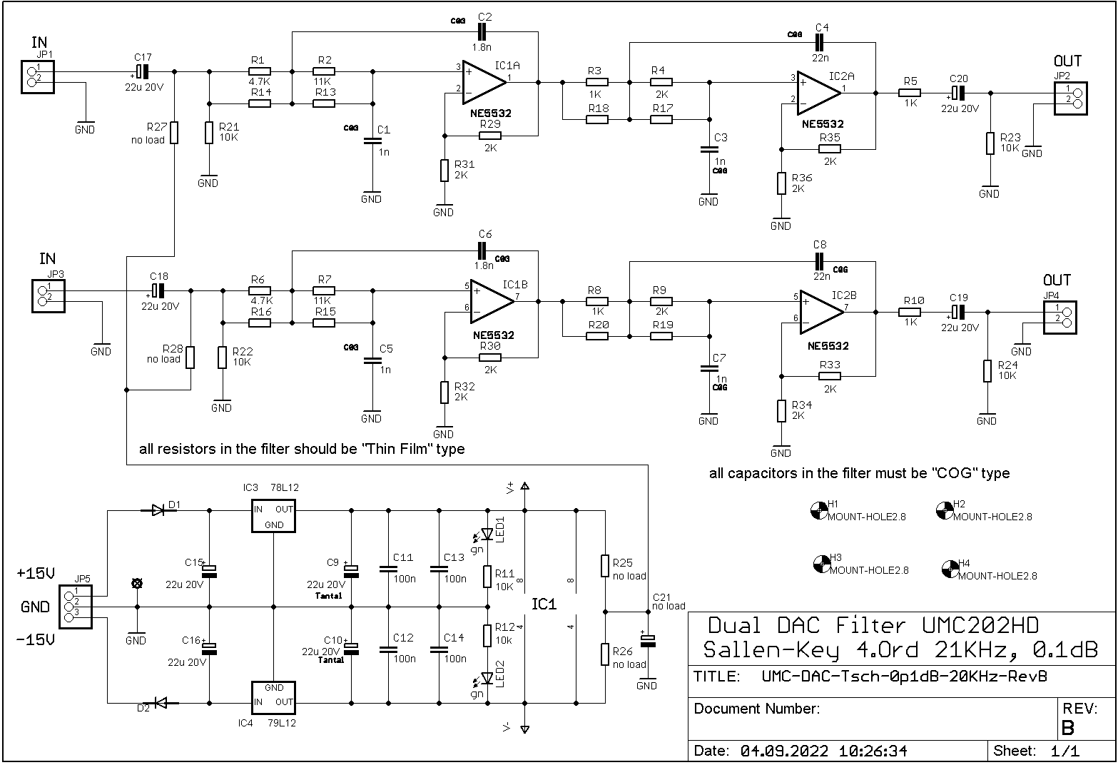

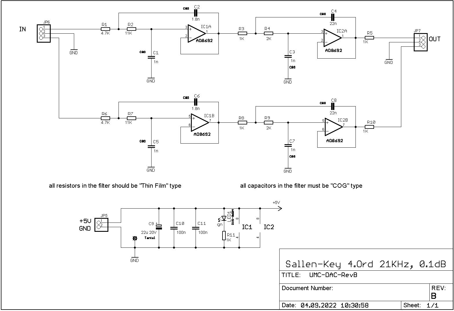

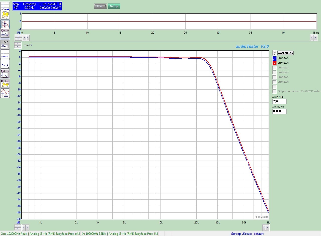

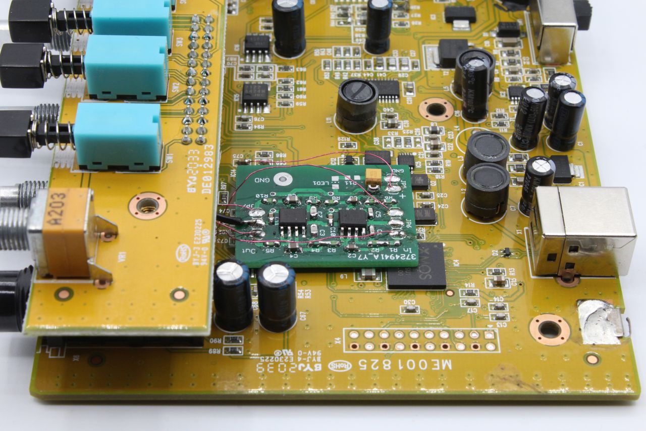

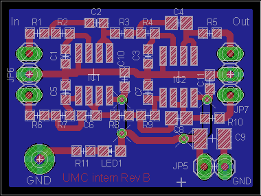

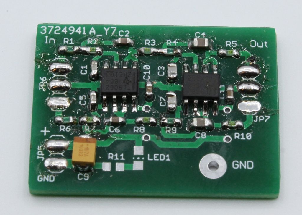

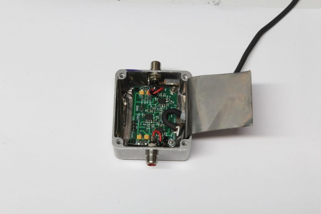

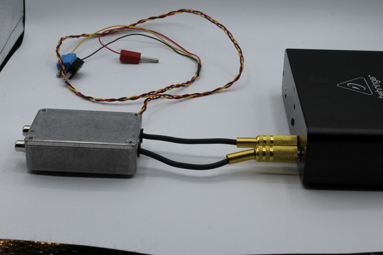

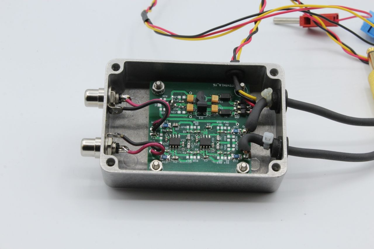

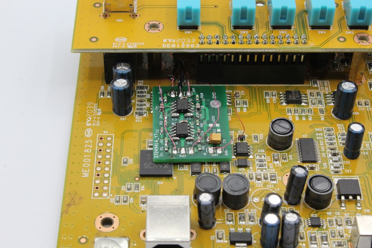

I also did a filter to be build into a Behringer UMC202HD. (or other audio interfaces)
It uses the +5 V power supply of the Behringer.
Here is a picture of such a filter inside the UMC:
Schematics and layout attached.

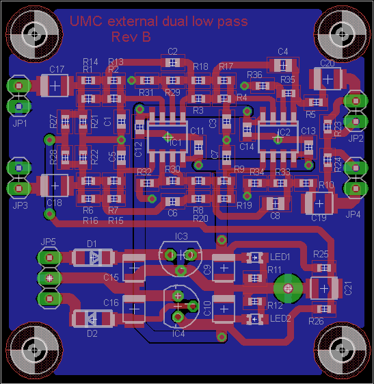

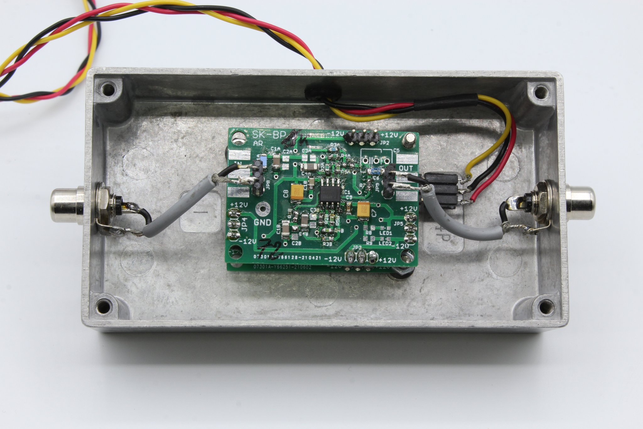

If you do not like to open and modify your Audio Interface I did a dual external low pass filter with voltage regulator on board.
It fits in a alu box from hammond. Power supply is +-15 V.
Attached are the schematics and the layout.
That's it for now. More to come in the future!
I have blank boards for most of the filters left in case someone is interested.
