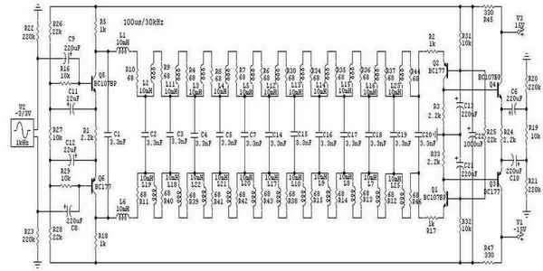

OK, now we buy five 10mH chokes for 45µS delay at 1Khz. That would require fourty 1mH for 8Khz, and we need about 3mS, so we would only need about 666 of the 1mH chokes.
It works the same way as the opamps.
If you were to optimize the choke and capacitor values you will still need 84 sections for 16Khz bandwidth.
Yes, indeed. Have to study if those mini-inductors of 10mH/45mA/60ohm used in LC filters for power supplies are good for this.
Anyway, seems to be more do-able than using same number of CI's. I just modeled an 90 inductors filter which can delay 900mS till 5kHz, may be used for delaying a mid horn.

I can't read the x-axis properly but it seems to be 100 us ub to 30 kHz, is it ?
This delay can be done with a Bessel ALL-pass using a total of five opamps.
Regards
Charles
