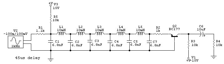

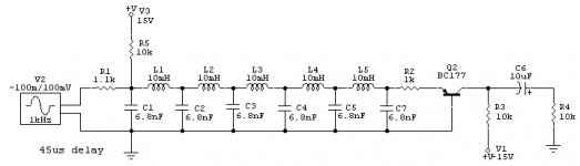

That's how it was done at the BBC for matching the stereo delay of land lines that weren't co-routed. I remember using lumps about 120 x 150 x 250 (mm) packed solid with Vinkor inductors and Suflex polystyrene capacitors. I think only two delay equalisers were made that could give 2ms each.
Nice to know that some pro guys did a 2ms delay using lumped L and C. 2ms is exactly what I would need to delay mid&hi horns against my 70Hz basshorns. Maybe one day I will be so crazy to try it (I have ~400 mini-inductors of 10mH and don't know how to spend them)...
If you do, please be sure to make and publish accurate measurements of the transient response, and more importantly IMO the attack / decay through the circuit. I have a suspision the attack/decay is where such a circuit would really show degeneration, materializing as a 'muddying' of the sound.DorinD said:

Compared to delaying the tweeter against the midrange the delaying of the midrange against the woofer is almost a non-brainer.

"1. is the speed of sound in the horn the same as or different to sound in free air? or, to ask the question another way is the required delay to match the distance difference i.e. (340m/s)/path difference (m)? Is it something to do with pressure wave to velocity wave?"
Same
"2. can you delay by the equivalent of 600mm (2ft) and retain quality?"
Not with that many capacitors in the circuit
"3. can you physically move the drivers/horns to achieve actual sound path equality? no electronics required!"
No
"4. does bass phase being delayed by the physically longer path matter?"
Yes, the transient response will be a lot better, and the perceived 'depth' of the music will improve.
In the mid 30s the movie industry realized what an improvement reducing the time delay between drivers could do. Despite being in the depth of the Great Depression they spent the money to develope and upgrade systems.
A new standard of zero path length difference was then developed, but WWII delayed the upgrade until after the war.
The instruction set for time alignment of the later system requires reversing the phase of the HF, then moving the HF horn back and forth for the greatest null, then restoring correct phase. A difference of an inch or two is measureable in the depth of the null (this distance is obviously variable with the crossover frequency, the higher the frequency the less offset is acceptable).
Comparing an aligned system with an un-alligned one generally produces comments on the order of 'how could I ever have listened to it without alignment'. This presumes the crossover and delay are of sufficient high quality as to not 'fog' all the detail. Inexpensive pro sound components will require upgrades for people with better associated equipment.
