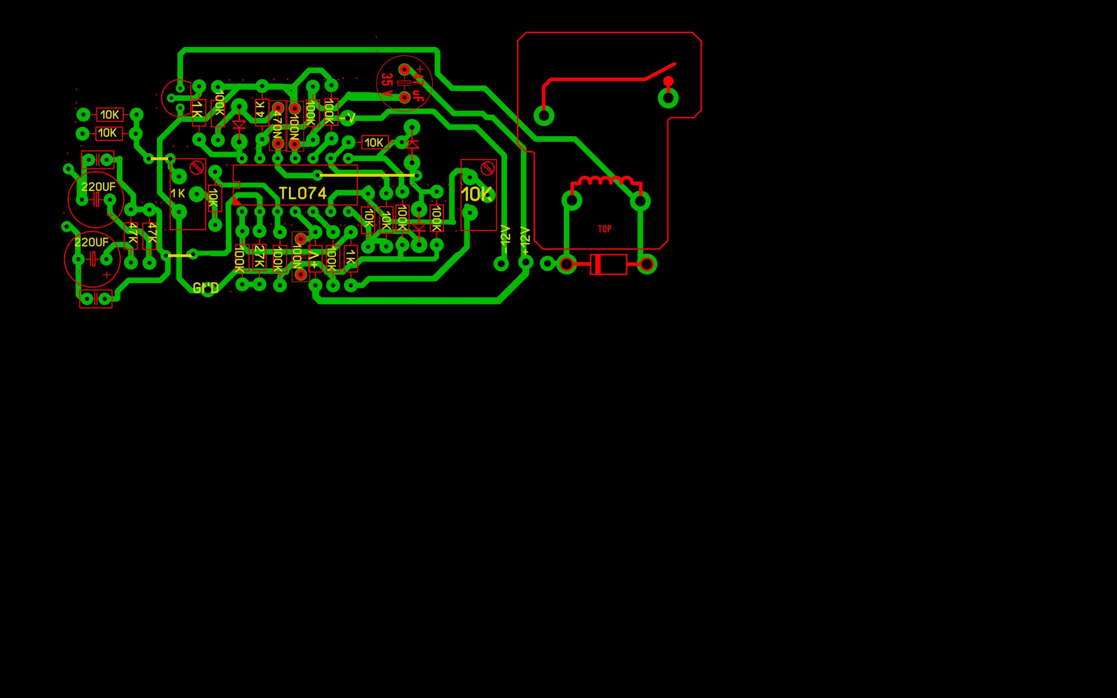

greetings just want to ask you diode mur160 is ok for protection
just trying to make a rough pcb once protection is working will
try with faster OPA ics is for a pa amp this protection amp is
robust 1 ohms load it can play first time i make pcb so if you
feel its not good for testing let me know pcb still unfinished

No problem, but you could use 1N4448 as well.Hello Esperado
Nice one.just trying to make a rough pcb once protection is working will
I think so.is for a pa amp this protection amp is
robust
???1 ohms load
Never tried such a low impedance !!!
(I had no time yet to verify your board. Anyway, try to use the same Relay in the BOM of the big board, 2 paralleled contacts. And if this protection is supposed to work on stereo amp, use two of them with two transitors.
Too, no need of a 10 turn adjustable for the 10K.)

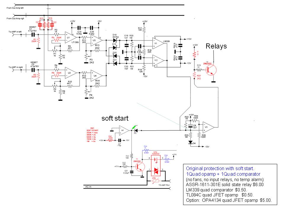

Would there be interest in a small PCB with the original, tested, high accuracy sense/channel ckt, plus the soft start comparator ckt?
1--- LM339 quad comparator $0.50.
1--- TL084C quad JFET opamp for control functions $0.50.
-----Option: OPA4134 quad JFET opamp $5.00.

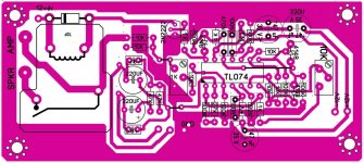

greetings if possible please can you check pcb and component
layout if possible as its the first time i have designed a pcb
if everything works ok will try with faster opa ics 12 volt +/-
regulated supply is on a another pcb its just a test run

Do-you feel-it necessary ? The big board exists, and you can populate what you want in it. It was done in this spirit.Would there be interest in a small PCB with the original, tested, high accuracy sense/channel ckt, plus the soft start comparator ckt?
Give me a little time, i'll do-it. Thanks for your interest. I insist on the relay: please, chose the one in the BOM of the big board.can you check pcb and component
layout

greetings thank you for taking interest in my pcb please can you give relay
number for testing on pcb is a 12 volt 30 ampere relay next step is a mosfet
relay for faster switching and high amperes as i have tested 3 short circuit
protections with very good results so please tell me what relay to use yes
i know mechanical relays are not good
warm regards

A speaker's resistance can vary from 120-ohms at resonance down to 3 ohms in the pass band. A 200W woofer on one amp channel can have 4mH of phase-shift inductance, while a 20W tweeter on the other amp channel can have 0.004mH of inductance. A bi-amp crossover circuit will dramatically shift phase and power between channels. Large variations in resistance and power, impedance and phase between the two amp channels. If you sum them together at one opamp input, it looks like a very coarse detection-level is necessary to avoid false triggers, or dead speakers from the requirement to save a 20W tweeter on one channel, with a 200W woofer booming on the other channel. The original, tested, high accuracy, sense/channel ckt should allow more accurate triggers, .....with about the same cost and PCB area.
For just basic error detection, the cost and area of the power supply and relays dominate. The original sense/channel uses just 1_quadAmp + 1_quadCompare. I think more customers would purchase this design.

andrewlebon , Your board looks OK. Found only 1 little error of marking.
Cap 330µF marked 47µF.
About Relay, the ones in the BOM is:
2T 16/20/30A
12V < 250mA Finder 62(65) .32-0300
You'll need two of them for two channels, in order to keep the 2 contacts // for each one.
And two transitors (one for each).
2T 16/20/30A

ONE Bi-Amp is put behind each speaker, with one channel going to the high power woofer w/Xover, and the second channel going to the low power Mid+Tweet w/Xover. It is common for channel_1 to pump 200W+ to the ported 4mH woofer with a Xover circuit creating the 180-360 degree phase shift, while channel_2 drives a 40W sealed 0.5mH MT with a 90 degree phase shift crossover circuit.
A single summation opamp would need to be set coarse enough to allow large woofer transients, and also sensitve enough to avoid high frequency tweeter kill.
