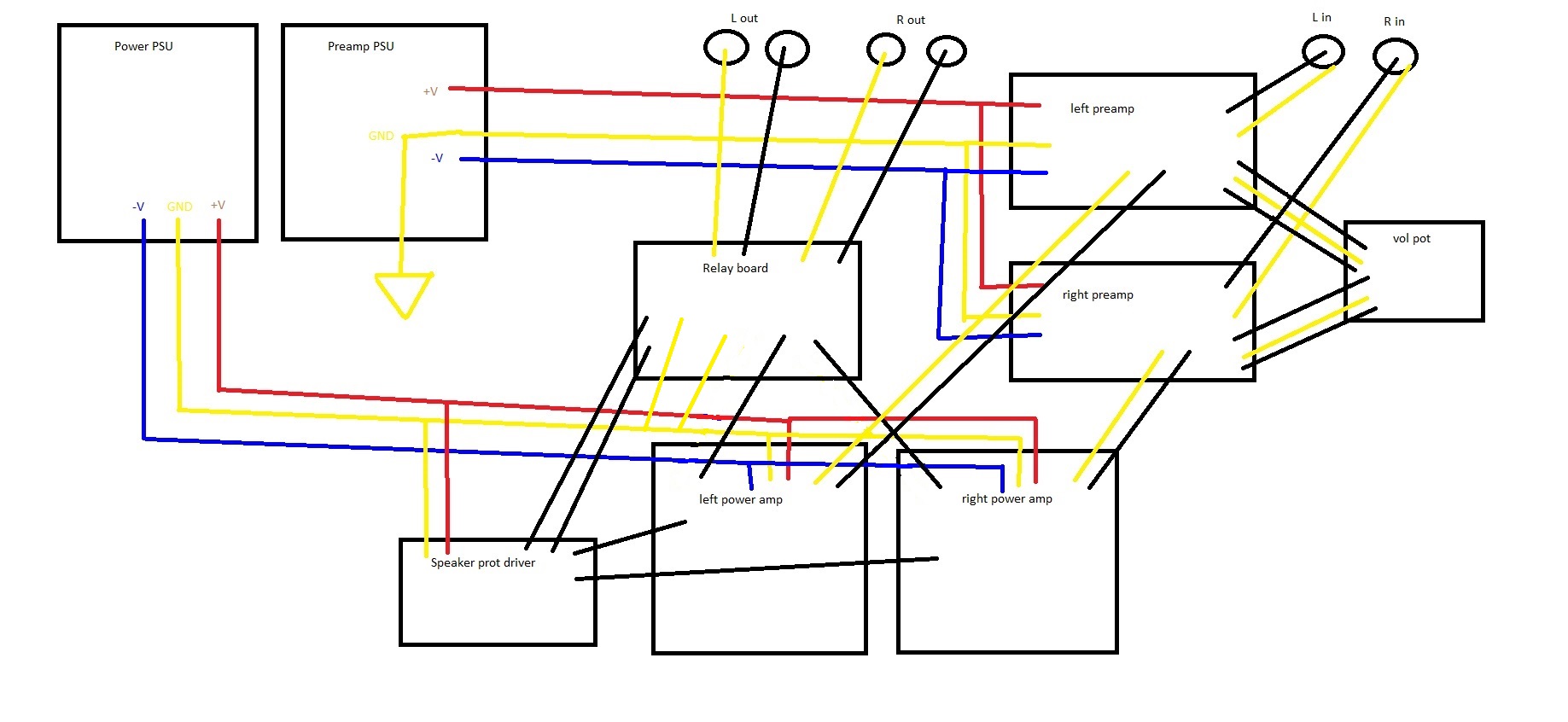

G'day Mate,
I had no such issues with these boards, they worked flawlessly for me right from the get go.
I would hypothesise that it will be a grounding issue or an external noise issue.
Is the amp inside a metal box? or simply an open testing rig?
If not then you might find that putting them inside a (preferably) mild steel box gets rid of the noise.
The more likley cause is a grounding problem.
Are you able to draw us a block diagram of your wiring scheme. MS paint is fine.
Please include all grounds, signals and power supply connections.
Here is an example from my most recent amp which in fact used these boards.
