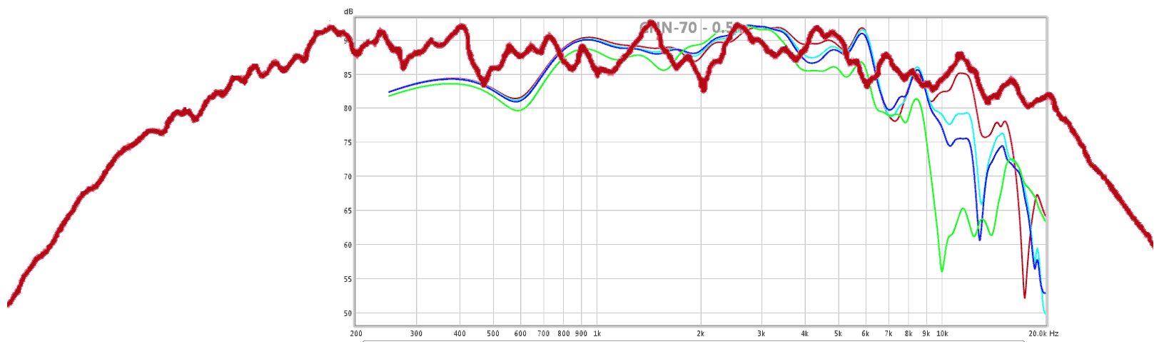

For CHN-70. Factory data (Earthworks M30 in anechoic chamber on IEC baffle using LMS) scaled and laid over top XRK's

Understand you defend one of yours preferred brand but.

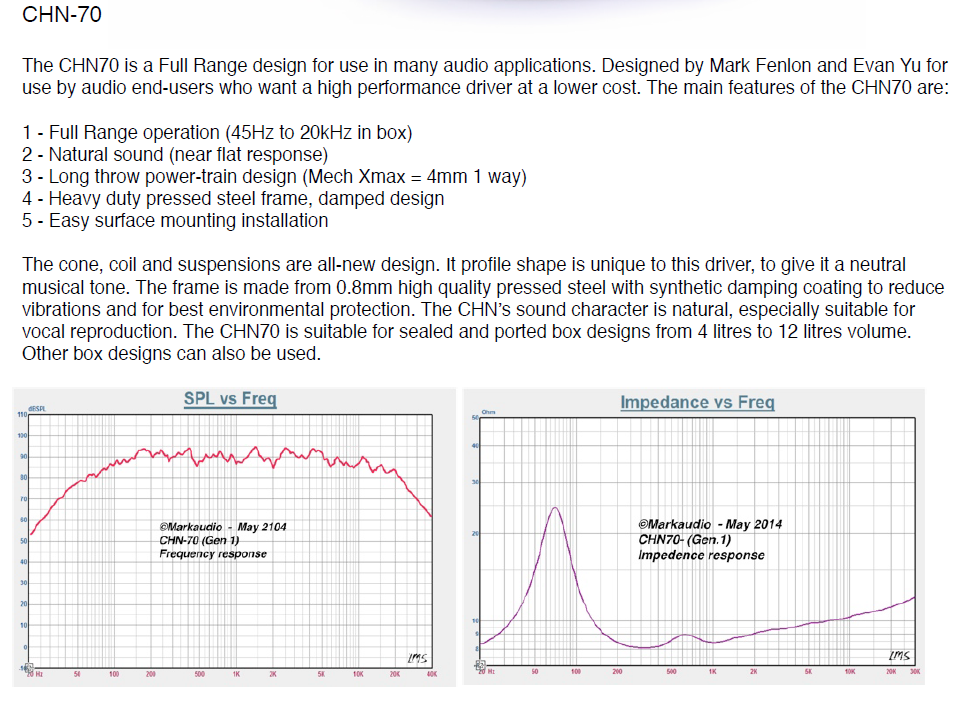

Where did that factory data come from planet10, it's certainly not the same as in datasheet attached below.
By showing these data as credible is a statement you also approves the data measured on this thread, which you else has struggled a lot against :scratch1:.
In datasheet nothing written about specific niche and the new factory data plot doesn't reflect point 2 see below, the old one do :scratch1:.
Extracted from datasheet, see attached picture:
use by audio end-users who want a high performance driver at a lower cost. The main features of the CHN70 are:
1 - Full Range operation (45Hz to 20kHz in box)
2 - Natural sound (near flat response)
3 - Long throw power-train design (Mech Xmax = 4mm 1 way)
4 - Heavy duty pressed steel frame, damped design
5 - Easy surface mounting installation
.....Since it is now well established that the CHN70 was designed for a specific niche in the Japanese market, and Mark Audio has canceled their diyAudio account, isn't it about time to drop the issue?

When reconstructing data pulled off a log graph with a 120dB vertical scale, and photoshopping it to overlay with data on a graph with a 45dB vertical scale, one has to wonder what the errors might be in such an operation.
The data is the data. The only error using Photoshop to stretch the MA chart over yours is that the line of the curve becomes fatter.
Gaving been taken in an anechoic chamber using a mic with greater dynamic range and better electronics will give the MA graph higher signal-to-noise.
That it is so ragged is down to being raw data with no smoothing.
Here is the MA data on the 120dB scale with 10dB divisions - the scaled data from above doesn't resemble this factory data at all:
The curve i used is from that graph that i already had on my computer. If you'd like i can take the exact curve from the above posted MA graph and do it again in case the version of my factory data is not the same version of the graph. It is time consuming thou and i'd rather not.

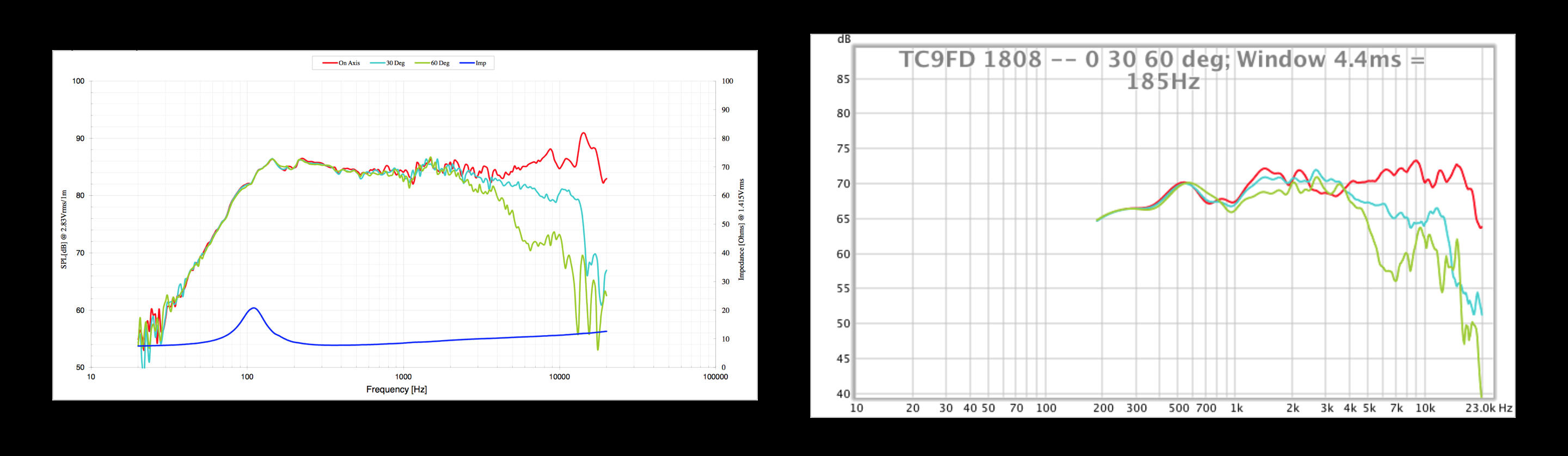

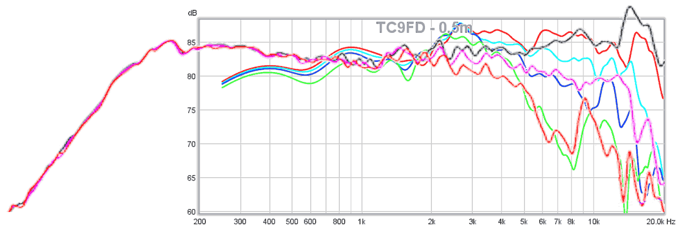

Not at all. I don't care about the data. But i do care about XRK using the argument that except for the CHN, his data mirrors the factory data so his must be right. I have done CHN and TC9D so far. IMO neither show XRK's data mirroring factory. I will slowly do the others tosee how they fair.
You can judge for yourself.
