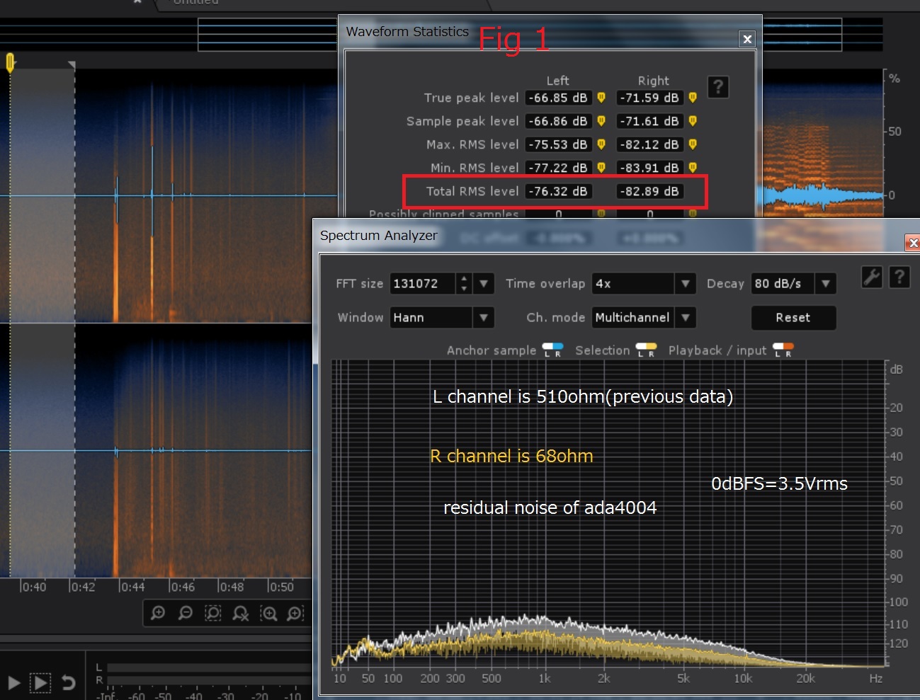

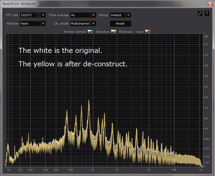

This is a little bit off the thread. I was under the impression that I used a small value resistor for MC head amplifier and could neglect Johnson noise. But in fact, it's not true like the attached. The Rg(R2) of the previous post is 510ohm(3.2nV) which makes unneglectable noise. I replaced the Rg of R channel with 68ohm(1.2nV). Now, L and R have the same gain and input impedance with different noise power.
The result is Fig 1 and Fig 2. Vinyl is another 180g which is better than before by 1dB(L channel). R channel with 68ohm is better than L channel(510ohm) by 6dB when measured only in residual noise. Fig 2 is residual noise and surface noise. It luckily happens to prove post #41 by MarcelvdG.

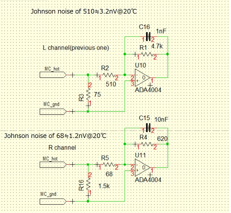

I made a simple calculation about input Referred Noise of ADA4004 on the condition where it comes from voltage noise of ADA4004 and Johnson noise by Rg(R2 and R5). The total gain to the input is 76+67-2=141dB. 67 is the gain of the amplifier. 2 is compensation of A-filter(2 is usually for a DAC. Vinyl may have another value). From the 0 dB value of 3.5Vrms, you can get about 310nVrms. But I think another compensation is needed for input Referred Noise because of RIAA.
I estimated the value as 0.57. I calculated the square root sum of RIAA from 100Hz to 20kHz by 100Hz step(200 points). If it has no frequency response, the value is 1, no need to compensate. It becomes below 1 because RIAA suppresses high frequency. I don't have enough confidence about 0.57 but anyway use the value.
The input Referred Noise of 510ohm is 540nV, and those of 68ohm is 270nV.This means 3.8nV/sqrtHz and 1.9nV/sqrtHz in 20kHz bandwidth.
The conclusion is below.
3.8*3.8=3.2*3.2+2*2 where Rg is 510ohm
3.8nV comes from 3.2nV of Johnson and 2nV of ADA4004(1.8nV).
1.9*1.9=1.2*1.2+1.5*1.5 where Rg is 68ohm
1.9nV comes from 1.2nV of Johnson and 1.5nV of ADA4004(1.8nV).
I'm not sure the compensation value 0.57 is correct. I need to measure the value on a real circuit. But the conclusion does not require an imaginary number for the equation. It apparently looks fine.

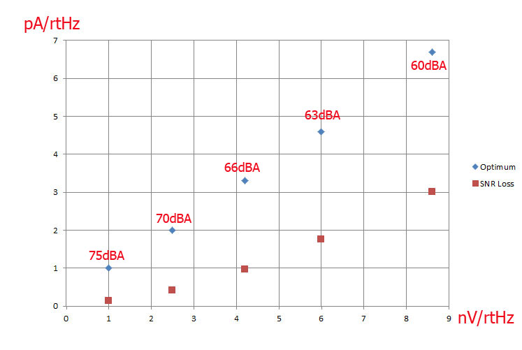

A small contribution to visualise things a bit clearer, specifically for the design in this thread.
In the image below, I have visualised what Op-Amp specs will have to be used when accepting a certain noise contribution from the Phono stage to the surface noise from the platter.
I have made a number of not too stringent assumptions.
For the MM, L=600mH and Rcart=800Ohm, Rin=47K, Cin=125pF
Sensitivity is 5mV@5cm/sec/@1KHz
For the MC, Rcart=30Ohm and Rfb=50Ohm, where Rfb represents the equivalent noise value of the resistors around the input Op-Amp.
Sensitivity is 0.5mV@5cm/sec@1KHz
SNR ref 1KHz@0dB from an LP is 60dBA
The five points in the image are from L to R resp. for a Phono stage with a SNR of resp 75, 70, 66, 63 and 60dBA, in all cases giving the same SNR for MM and MC.
As an example: when allowing for a Phono stage giving 1dB SNR Loss to the 60dBA from the LP, an Op-Amp having 4.2nV/rtHZ and 3.3pA/rtHz should be selected.
In that case, the Phono stage will have a SNR of 66dBA for MC and for MM.

Posting 45 mentioned that going from 68 Ohm to 510 Ohm resulted in a SNR Loss of 4.1 dB.Now I'm confused; where does that 4.1 dB in post 45 come from?
In posting 50 the accompanying SNR figures were given, being resp. 64.9 and 60.8 dBA.
Hans

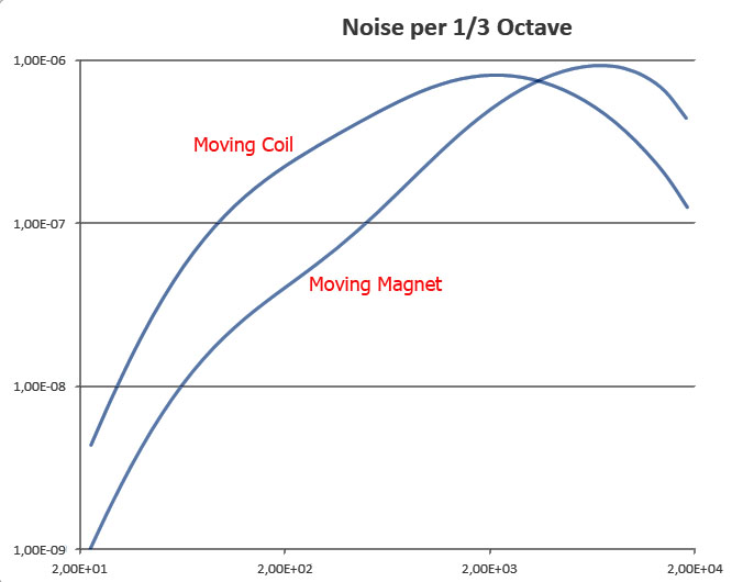

In posting 50, SNR for a certain point with specified nV/rtHz and pA/rtHz is made the same for the MM and MC setting.
However dBA is just one cumulated figure of all A-Weighted noise and tells nothing about the nature of the noise.
That's why I have included the image below, to show the spectra of the noise for MM and MC, in both cases for 66dBA, ref 5mV and 0.5mV resp.
So the area under the curves is the same (the MC amplitude has been multiplied by a factor 10) but the curves are rather different.
Peak in frequency for MC lies at 2 KHz and for MM at 6.5 KHz.
The noise from an MM will therefore sound more like a hiss.
So far the differences in noise production between both.
Hans

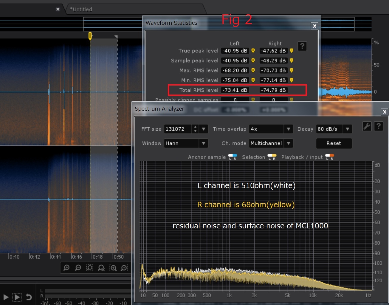

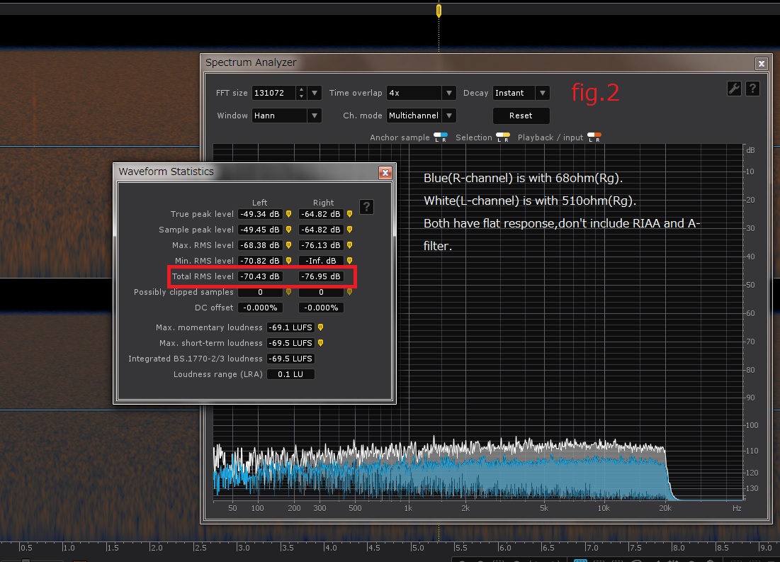

the measured data
I measured real noise power of ADA4004. My post #42 used estimated data for RIAA compensation(0.57=5dB). My SIM was 7dB because of 2dB for A-filter and 5dB for RIAA. That was almost correct like fig.1. The true value is 6.4dB(76.8-70.4=6.4). The more precise input Referred Noise of ADA4004 is below.
3.6nV/sqrtHz with 510ohm(Rg) under 20kHz bandwidth
This may be from 3.2nV of Johnson and 1.6nV of ADA4004 because 3.6*3.6=3.2*3.2+1.6*1.6.
1.8nV/sqrtHz with 68ohm(Rg) under 20kHz bandwidth
This may be from 1.2nV of Johnson and 1.0nV of ADA4004 because 1.8*1.8=1.2*1.2+1.0*1.0.
The difference between 510ohm and 68ohm is 6.5dB like fig.2.
ADA4004 has 1.8nV(typical value) residual noise. It may be a little bit high performance to have 1.0nV with 68ohm. But I'm sure this is correct. Because this is calculated by three parameters, FS of the ADC, noise power and the gain of the amplifier. I measured them and calculated the value. If you can use the measured value of 0.5nV opamp with 68ohm, you can get 1.3nV residual noise(1.3*1.3=1.2*1.2+0.5*0.5). This can be probably available but over performance for vinyl recording, IMHO.

De-noise is effective only in small amplitude while de-construct can process both large signal and a small one. It probably deconstructs the input into signal and noise. Then It reduces only noise spectrum before It reconstructs the original. That's why signal spectrum is almost same while noise spectrum is less than 6dB before processing.
Surface noise to human perception deeply depends on frequency. As far as I have experienced, from 1kHz to 8kHz is the most important. If you decrease this by 3dB, you can feel enough improvement. If you get a 6dB decrease, you can feel surface noise has almost gone. De-construct can decrease noise spectrum only without unexpected sonic side effect. I'm very satisfied with this. The disadvantage is cost. RX4 with de-construct is a little bit expensive.
So is me before I know the second generation(de-construct).
