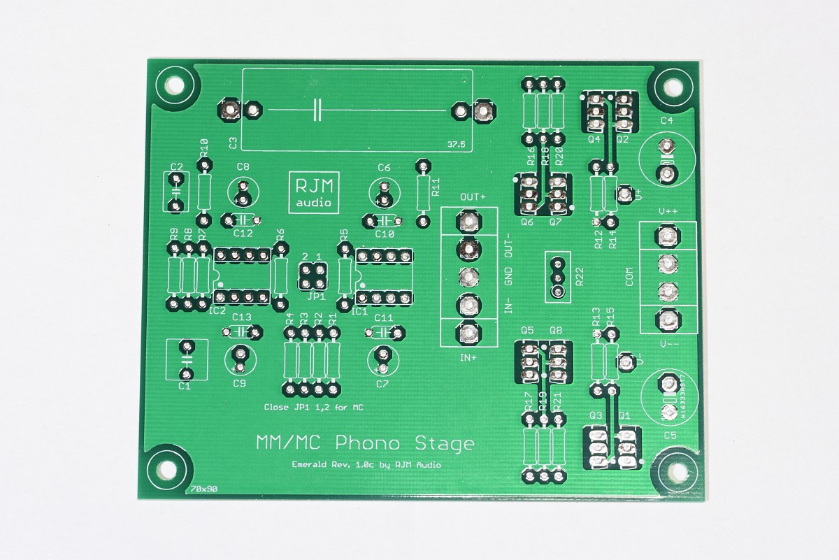

Am I correct, that the positive shunt regulator's output voltage is (VBE_Q7 * R20 / (0.5*R22)) = +14 volts?
And if Q7's VBE varies by -2.2mV per degree C, then the regulated output voltage varies by -44mV per degree C. Is that correct? So a temperature change of 10 degrees C causes a supply voltage change of 0.44 volts.
I would imagine it's a good idea to thermally couple Q7 and Q8 so their junction temperatures track each other. This would help ensure that the regulated V+ and regulated V- tracked each other.

Yes, the regulator output is referenced to the emitter diode drop of Q7,8 multiplied by the ratio of R20 or R21 over the relevant section of the trimmer R22. The output tends to be about 12-13 V.
It would be a bad design choice if a) the currents were variable and/or sufficient to raise the temperature above ambient or b) we were concerned about the exact voltage seen by the op amps.
In practice the output voltage may vary a few hundred millivolts depending on ambient room temperature, but this does not influence the performance of the circuit. Positive negative tracking is largely obtained already since the current draw is the same, and the ambient temperature also.
(Or, short answer: there is no advantage to put Q7,8 in direct thermal contact since neither transistor gets warm during operation.)

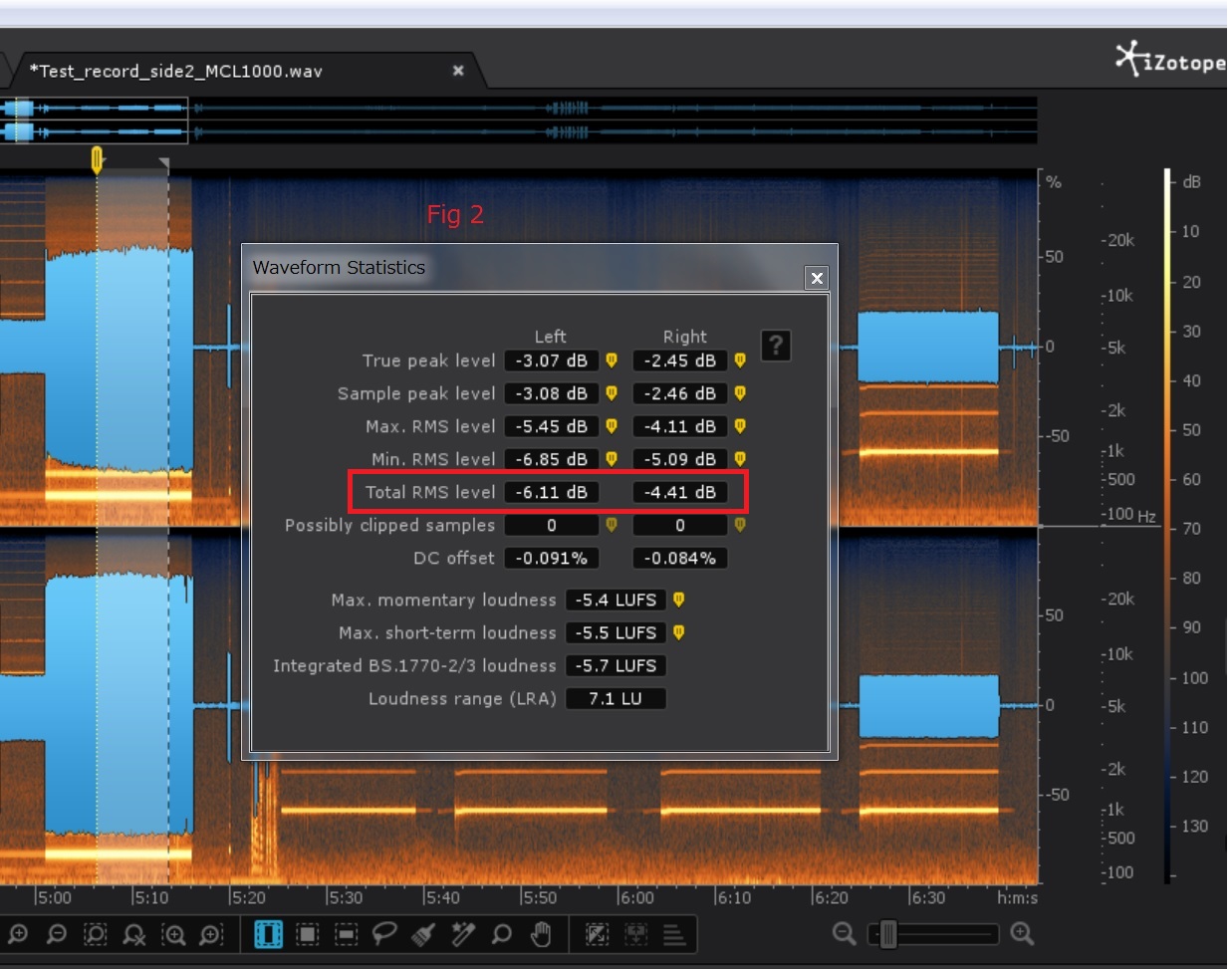

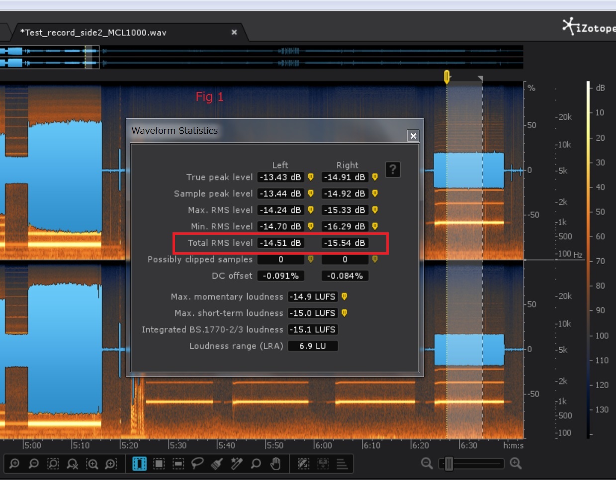

This is the reference for those(including me) who are interested in vinyl. The attached is the measurement of MC cart without playing(amplifier noise only) and with playing(surface noise included).
This is simple MC headamp and equalizer. MC headamp is ADA4004(1.8nV/sqrtHz,3.5pa/sqrtHz) with 20dB. Equalizer is also ADA4004 with 34dB. MC cart is MC-L1000(0.3mV). Vinyl is a good condition like new 180gram. The maximum amplitude depends on the recording time of vinyl. 60 minute one has almost half than 30 minutes one. The maximum amplitude of 30 minutes is almost 0dBFS in this measurement.
The White waveform is residual noise,-75.6dB. The yellow is residual and surface noise,-72.5dB. Actual SNR of this circumstance can be 72.5dB with A-filter. But surface noise itself is probably 72.5+3=75.5dB because -72.5 includes both residual amplifier noise and surface noise.
Acoustically speaking, 72.5 is considerably good. You can hardly listen to the surface noise. If you use "deconstruct" process to digitally reduce noise level from 2kHz to 8kHz by 6dB, you can forget the existence of surface noise. 72.5dB is such level.
The blue waveform is the real waveform of MC cart. You can see click pulse.

SNR was not proper expression in this case because the signal level was not identified. The full scale of many ADCs is 10Vpp(3.5Vrms). The residual noise of -75dBFS means almost 0.62mVrms. This is the correct value. But the signal level usually doesn't mean 0dBFS for vinyl recording by ADC.
Fig 1 is 1kHz of 4.7cm/sec from test record. It shows almost -15dB. If you regard this as the maximum signal, SNR is -15+75=60. But the same test record has larger signal than this like Fig2. The right channel(-4.4dB) is a little bit larger than the left(-6.1dB). Another person who measured DL-103 says MC cart could be larger than 5cm/sec by 10dB. MC-L1000 is same as DL-103.
Digital recording has no margin above 0dBFS. It means you need to have enough headroom below 0dBFS. That's why my 0dBFS is relatively high. I don't want to discuss the definition of SNR. If the traditional definition is based on 5cm/sec, there is no problem to subtract 15dB from the noise level.
What I want to emphasize is that the surface noise of MC-L1000 is almost same as the residual noise of ADA4004. I measured total gain, headamp, equalizer and SE to DIF converter. It's 67dB which means input Referred Noise is 0.62/2200=280nVrms. Additional 2dB is necessary for A-filter compensation. I guess it results in about 330nVrms. This is a little bit good value from 1.8nV/sqrtHz of ADA4004 under 20kHz bandwidth because Johnson noise must be added to the value. I think this comes from equalizer amplifier which suppresses high frequency.
