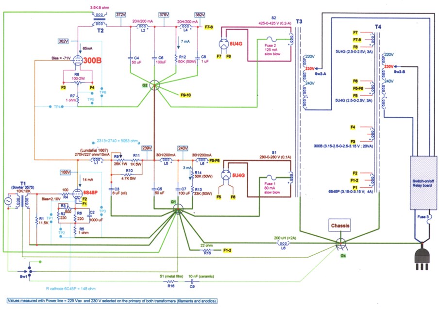

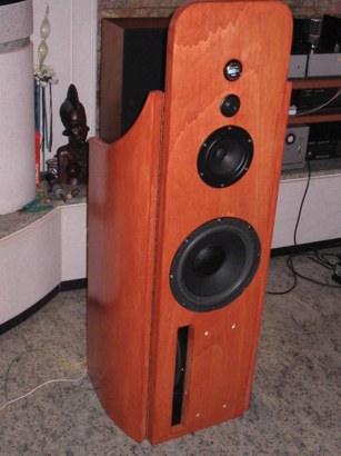

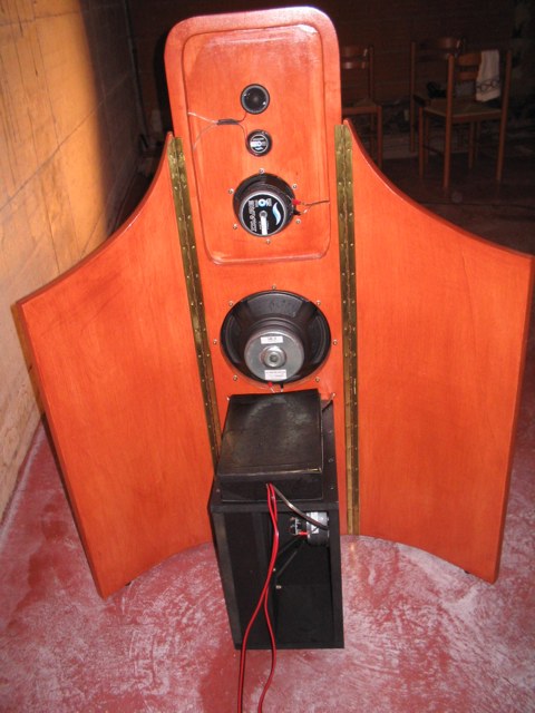

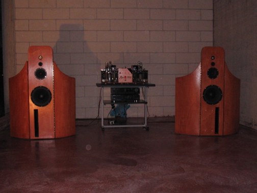

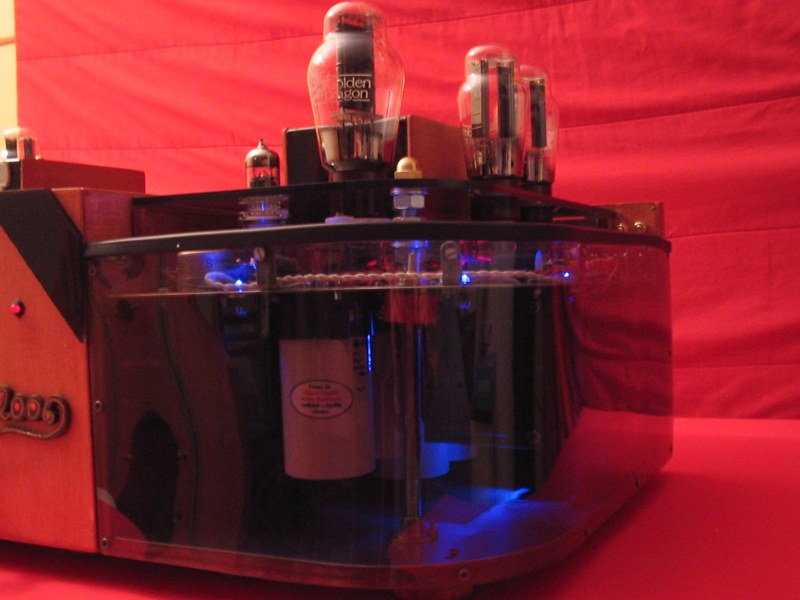

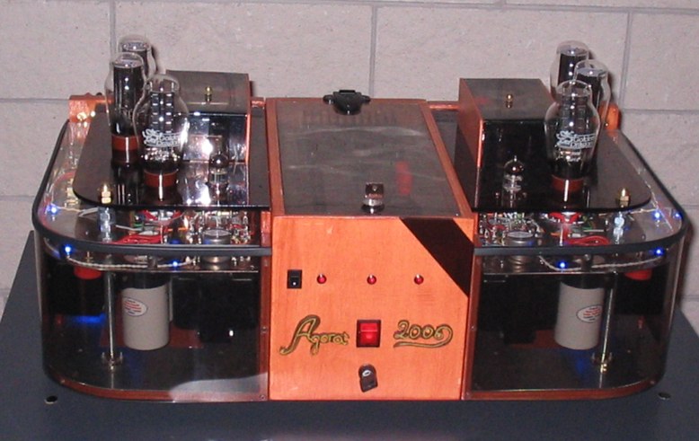

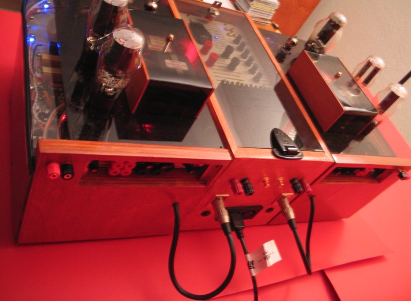

An intriguing 300B SE-direct-coupled-amplifier
We have finally finished our HiFi system.
It consists of a 300B SE direct-coupled (two stage) amplifier + a couple of dipole speakers (with integrated ripole subwoofer).
It is simply fantastic ... as well as the authors of it (16 children of 10-13 years old).
Associazione Agorà Lesina (FG) - Italy

P.S.
Some measurements: -3dB at 5 Hz and 81.000 Hz (!!!).
