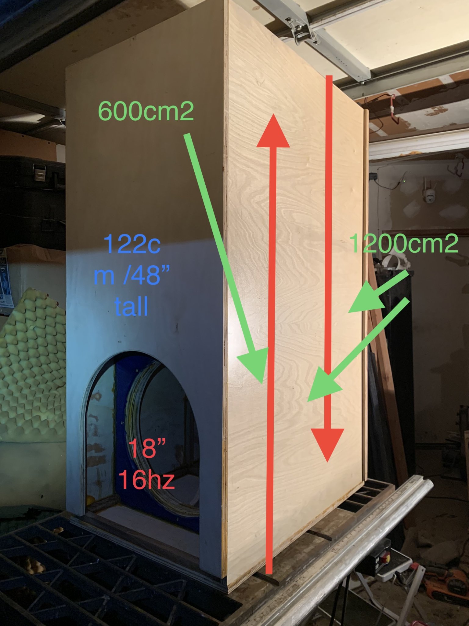

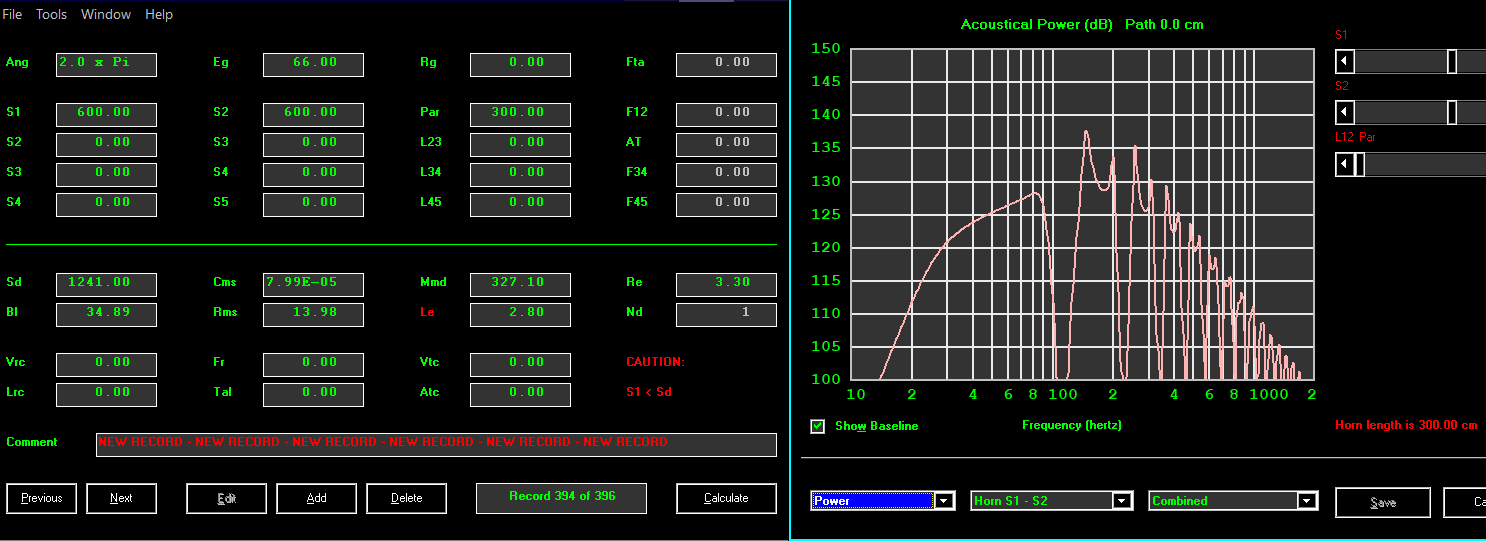

An Improved Transmission Line Alignment
I honestly DONT understand all the hype(?) about ‘standard’ transmission lines unless they’re honestly compared to the exact same box volume in other configurations (apples/apples) ??
Why add the extra pipe resonance and offset driver position to help fix it(white graph verses green)
I questioned a TL a few years ago and it gained performance when the same enclosure was changed to a standard BR enclosure by removing an internal panel or 2.
i think(??) the generic ‘best’ design for dumbies like me is the long bass reflex hybrid ? (Assuming you want a vented sub box with a nice flat response and had to ‘choose’ ? )

Unless I've misunderstood the drawing, couple of points there. Firstly, that looks like the cross-section of a [simple] DSL style double-tapped horn / Jensen Transflex rather than a 'standard' TL (whatever that is -we're not likely to get much agreement 😉 ) as it's exciting the line at two acoustically different locations. Secondly -you're not necessarily going to get a meaningful, or at least a particularly revealing apples / apples comparison just by keying off the same Vb, unless you're assuming they are all sharing the same Fb and alignment, which isn't necessarily going to be the case, or even likely since a well-designed TL will probably be starting out with a larger Vb in the first place & the designer will have been aiming for a different alignment, for different purposes also.

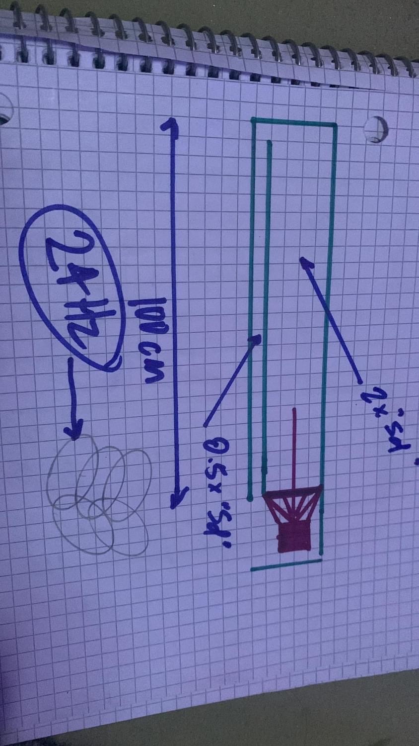

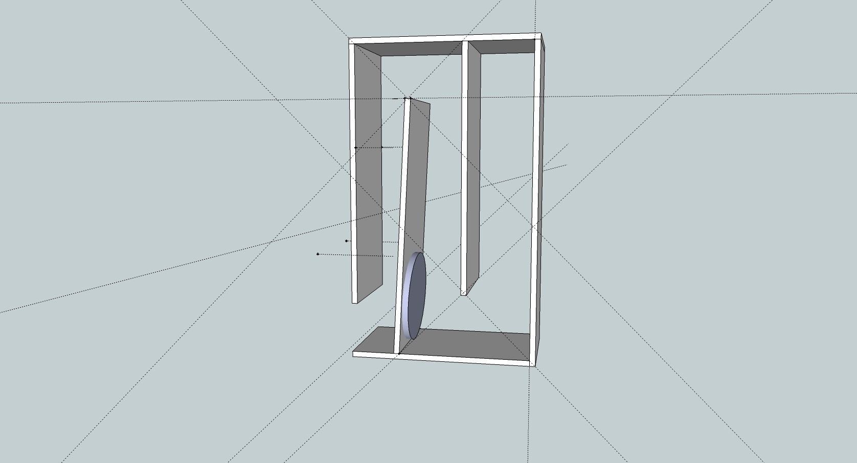

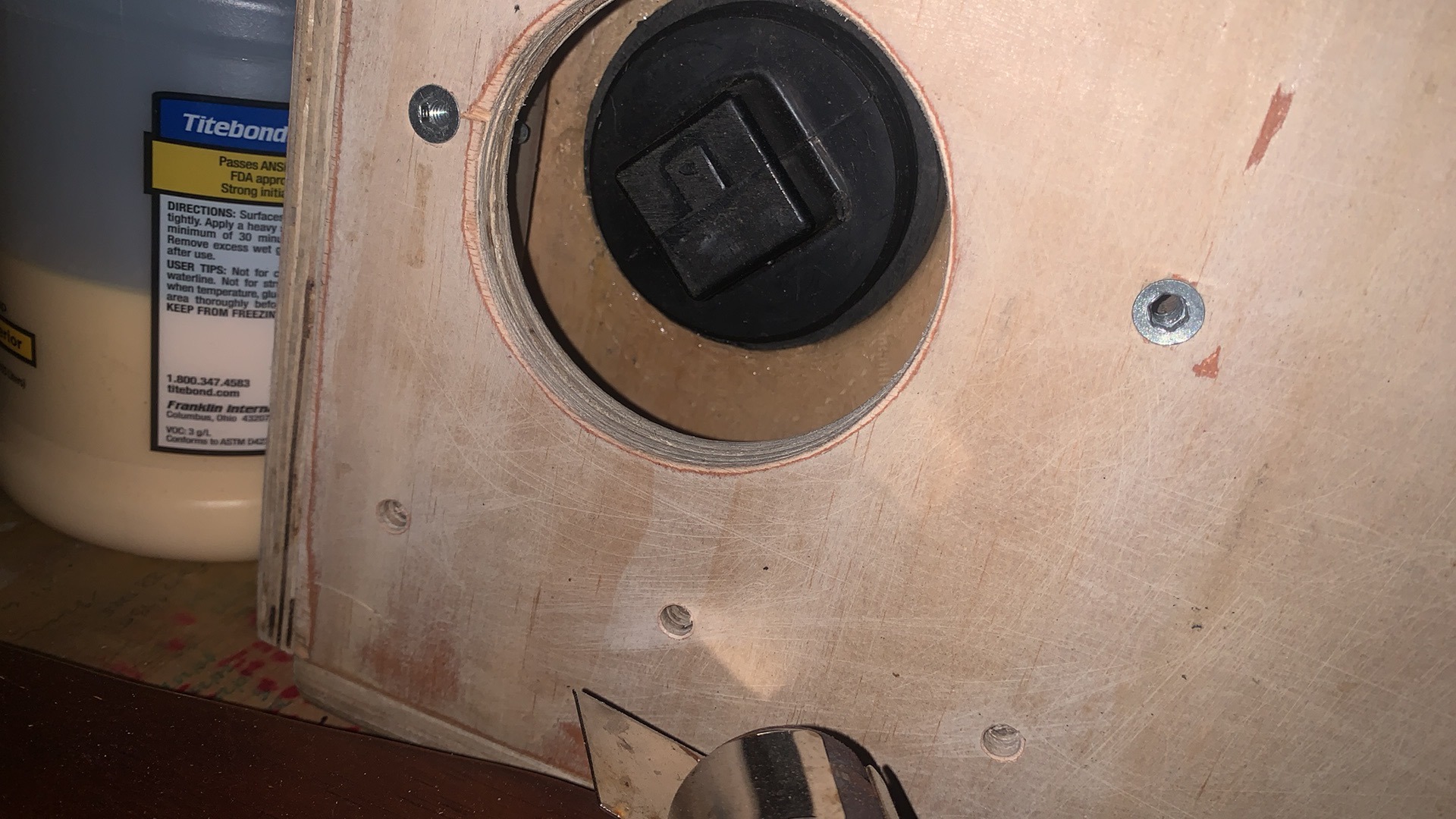

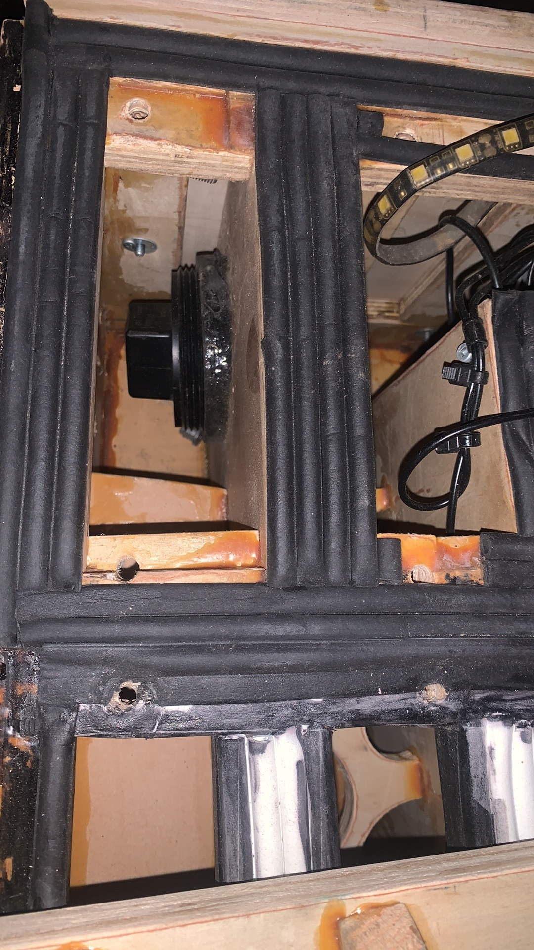

this pic is probably what I should have used , Scott/Bp1
(i just cut a cheesy ‘bypass’ hole in a closed end of a ‘perfect’ OD TL faking the same )

I'm not sure that's faking a DSL style double tapped horn, if I'm understanding you correctly and you've simply cut a hole in one of the internal panels. It will certainly alter the resonant behaviour, as is sometimes done with induction / exhaust design, likely raising the fundamental, but it's not quite the same thing as driving the line at two physically (& significantly) different locations, as is the case in a Transflex or Tom Danley's inadvertent variations of Novak's old Jensen cabinet.

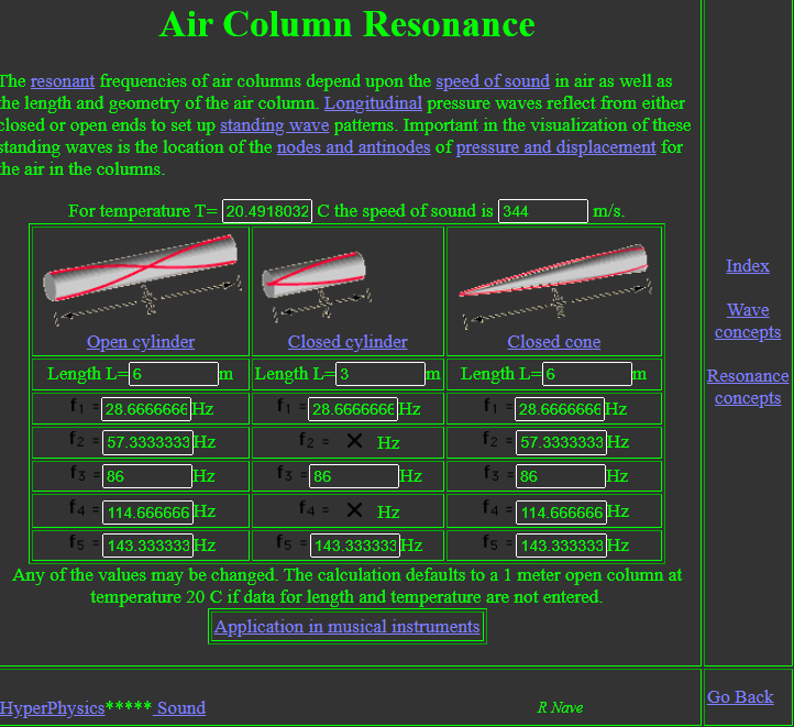

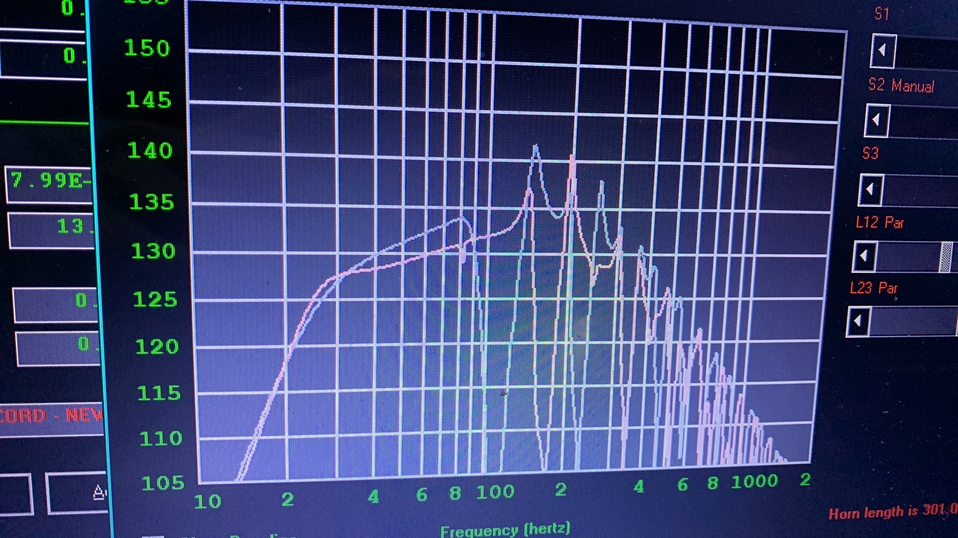

What if we use this picture, but we move the driver to 66.66 cm (~.second pipe resonance) from the closed end (and 33.33 (further away from the 4x the ‘Z’ 1/4 wavelength freq of cancelation) from the vent/exit).
(ignore that little rear chamber)

I’m quite aware of what they are and have built several of each? The second pipe resonance shifts a bit further down it seems?

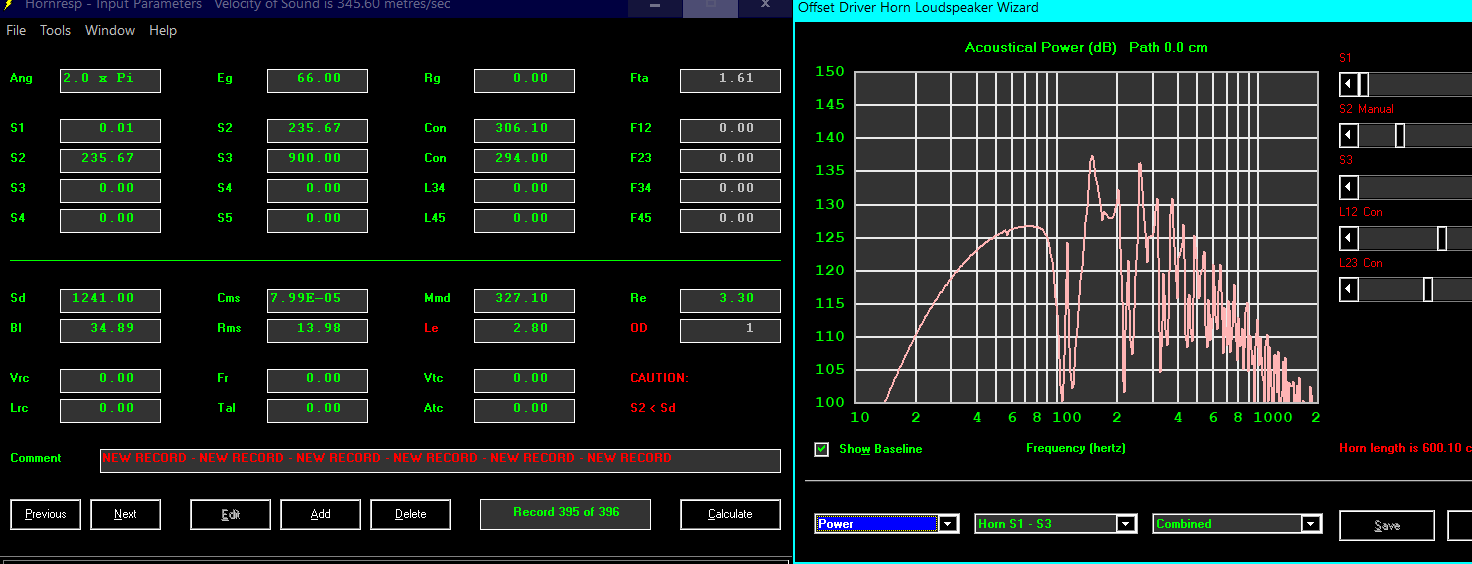

Yes sir. (Like the offset driver @ ~0.35 instead of @ the closed end) that all shifts further down (just like if i shoved the speaker vent in the corner or a car )
tapped pipe is just a tighter boundary condition initially If it’s not a substantial legth/girth from driver output to exit ?
