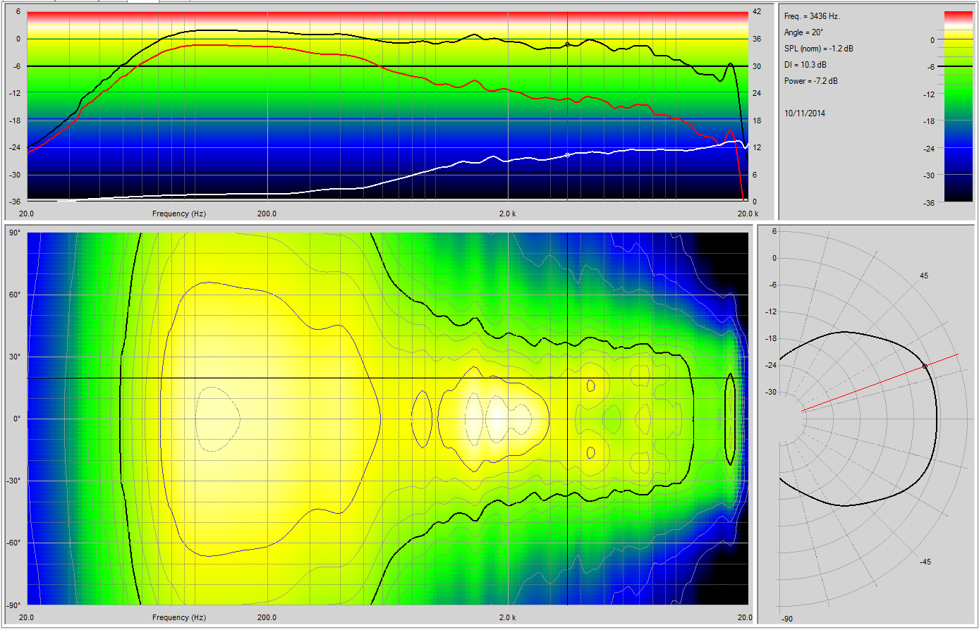

Notice how horizontal directivity is lost below 1500Hz now but vertical is sharp to 300Hz.

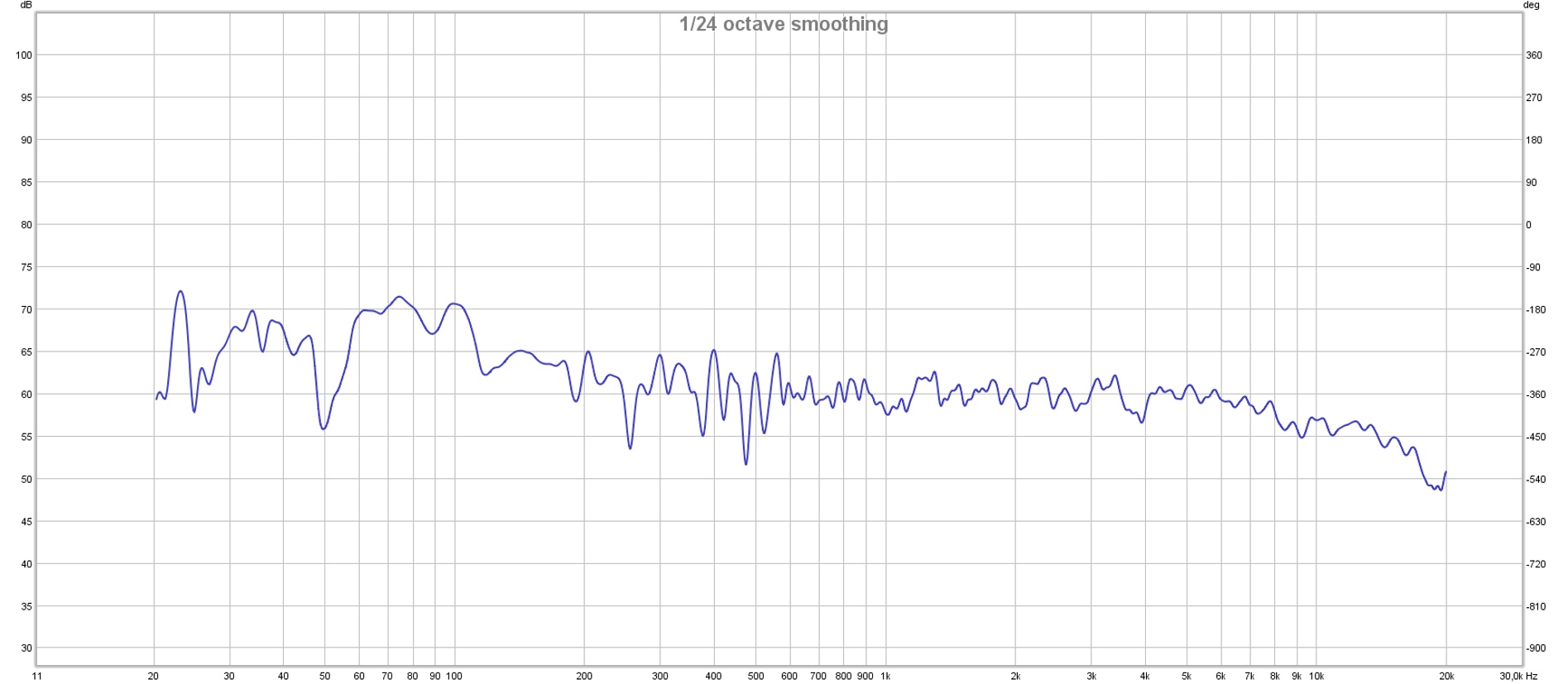

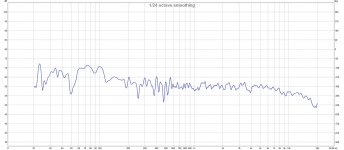

The graph was from a 60-65m2 L-shaped room with sloping ceiling. The speakers were placed diagonally in the room; so side wall reflections were minimized. But there were reflections from an angled ceiling. No treatment in ceiling or on side walls. Wooden floor.
Here's a frequency response with the same placement (with non optimum EQ/shelving).

Thanks, this helps put together a total picture of that ETC plot. I'd like to ask for more and more, just because I'm curious.
It's also why I try and share everything, because if we all did this we can learn more from each other's experiences. I'll withhold spamming this thread with my own measurements (lol). They are not that hard to find elsewhere.

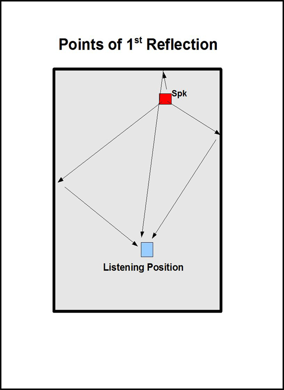

You are implying that horizontal reflections do not affect the sound field since the CBT has many more horizontal reflections, even below 1 kHz, than an Abbey. CBT's may be CD below 1 kHz, but at an extremely low DI, This means that they are more affected by the room than an Abbey, not less. Simply stated, your claim sounds like a Trumpism to me.
Floor and ceiling reflections do have tonal effects, as Earl has noted, and they are pretty hard to treat in normal listening rooms. This is what the CBT and other home line arrays address. Reflections from walls are much easier to treat and control.
But treating the side walls kills the spaciousness, while killing the floor and ceiling do not. One can hardly call these two things equivalent.
Whether people want side wall reflections or not may be a matter of taste, the room geometry and what music material one is listening to. ... And lateral contribution is basically desired if they are delayed sufficiently.
This is correct, there is no perfect situation for all genre of music. I have talked about this to great extent. But, if you consider the fact that about 95% of all recorded music today is studio work, not original venue, then it becomes obvious what direction is best for most. High spaciousness helps to mask the inadequacies of two channel for live venue recording, while high directivity (high DI) brings out the imaging aspects of studio work. CBTs have very low DI, while Abbeys have a higher DI - throughout their entire bandwidth!
So with a traditional CBT speaker, the closest side wall reflections would in most rooms be best to treat. While the opposite side wall reflections can be used as a lateral contribution if desired. The spectral content will be very similar to the direct signal.
I'm telling you what the practical result is. The CBT measures much flatter below 1KHz than what Abbey does. I've seen this in several rooms with different placements. I've never seen a very flat response from Abbey below approximately 1KH, which is due to its collapsing polar. CBT on the hand is constant much lower in frequency.
The side wall reflections do affect the sound with the CBT, but the coloration is far less because the directivity is uniform. Plus it completely avoids floor reflections and greatly reduces ceiling reflections. The result is a speaker that both measures very flat and sounds natural even with added side wall contribution.
