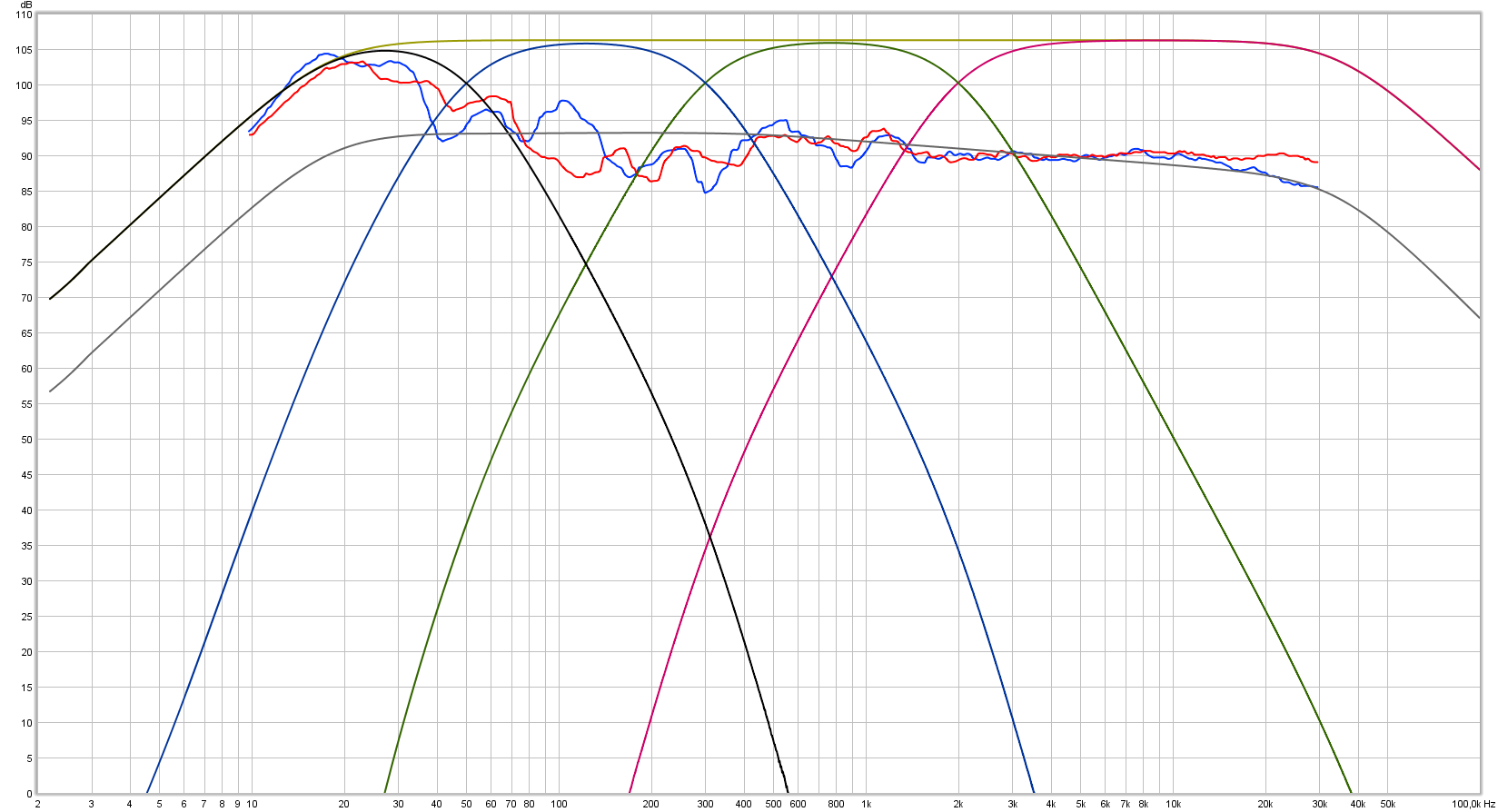

1. attachment show overlay these 4 times textbook bandpasses including also the two stereophile curves and because real world its so hot in lows think its fun look at black bandpass and see how it nearly follows the hot live measurement.
2. attachment show steps where red is with FIR XO points and gray have IRR XO points for a system bandpass 18Hz-35kHz including a B&K curve. Comparing gray curve to stereophile's looks like some weird regarding time or polarity is going on between tweeter and mid section, maybe as mitchba write its the sacrifice/tradeoff with respect to beam steering.

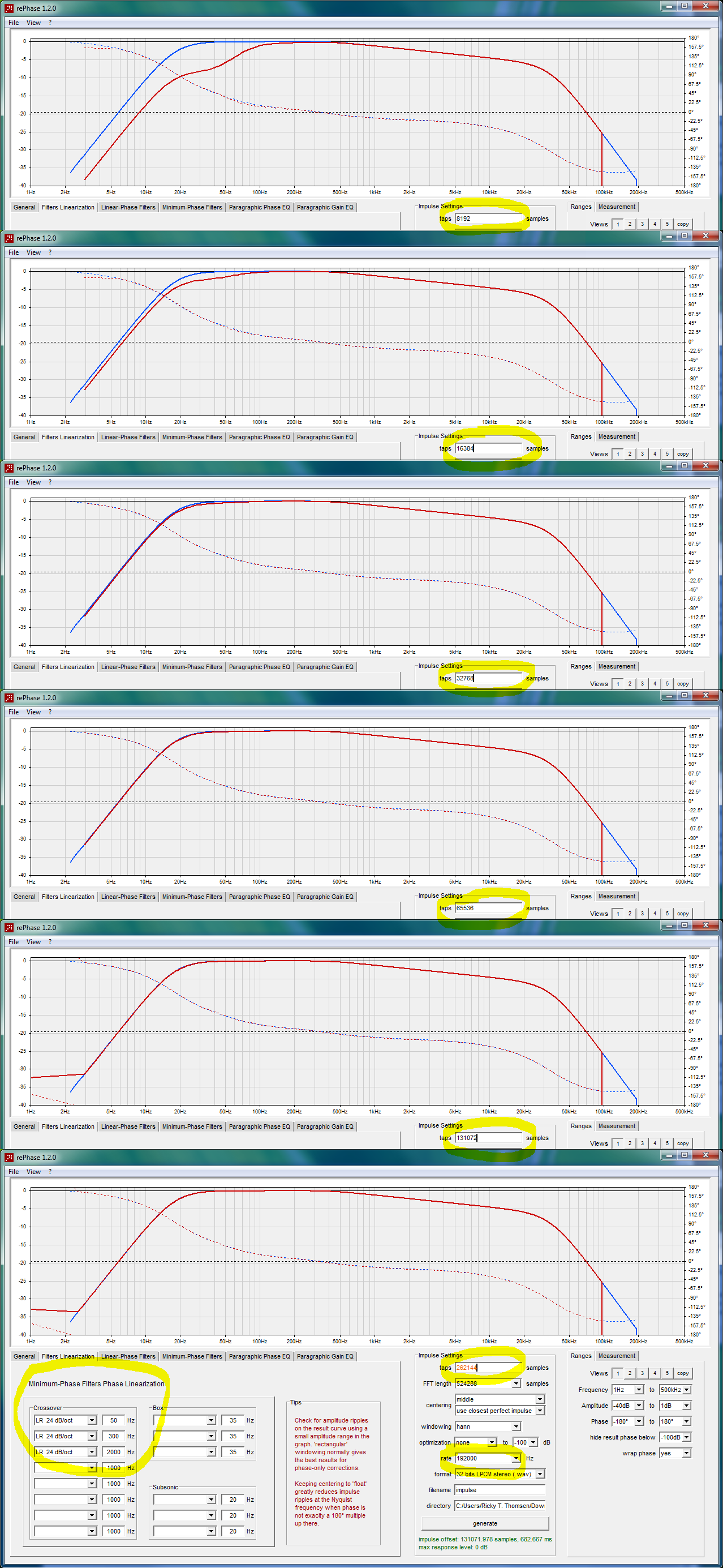

3. attachment is a Rephase exercise to see how many taps it takes to linearize phase turn from XO points used into this exercise and it looks like it takes 65536 or more to get it okay if DSP engine run at 192kHz sample rate.

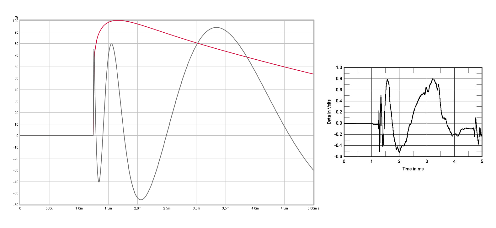

I'm guessing that tweeter array is messing up the top part of the IR output because of a wrong distance to speaker where the measurement took place. I doubt B&O were seeing that in their anechoic room. The latency introduced by optimisation towards time coherency would not be acceptable for them.

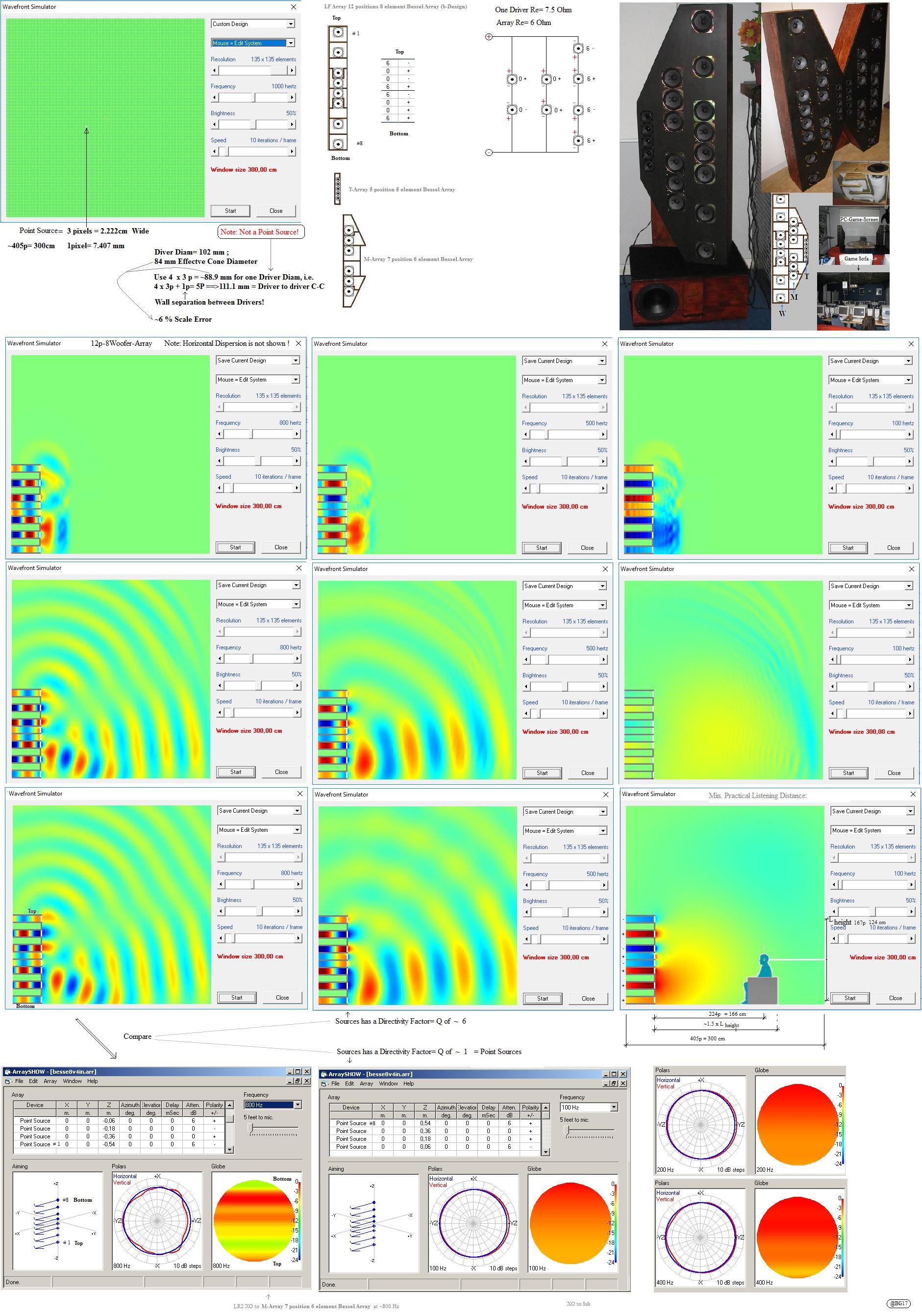

Hi Patrick,All

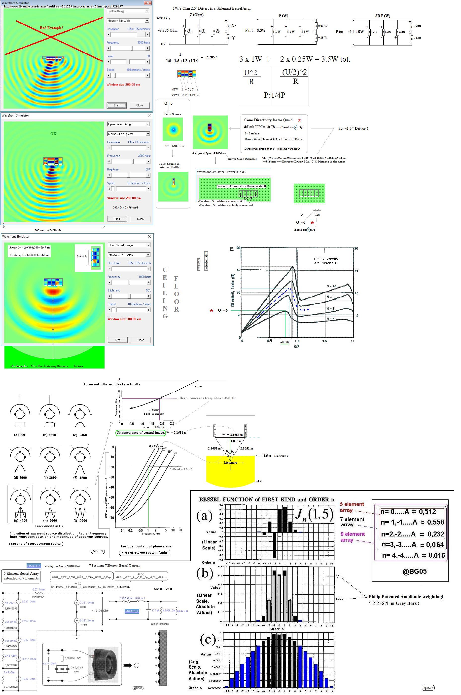

FYI:Examples of Bessel Arrays and some IMO Mandatory (Pixel) Calculations in order to make the HR Pictures more clear and interpretable.
