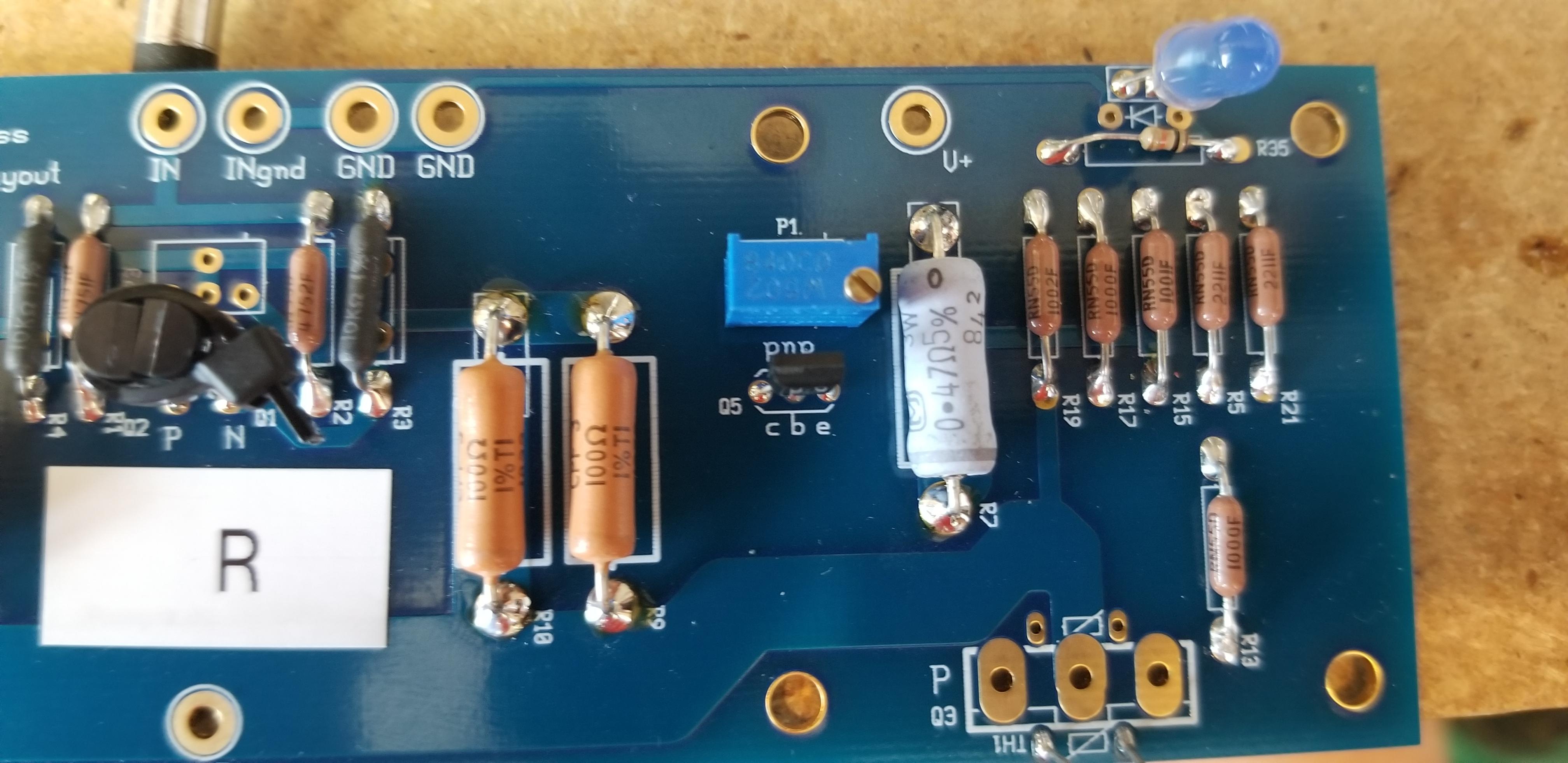

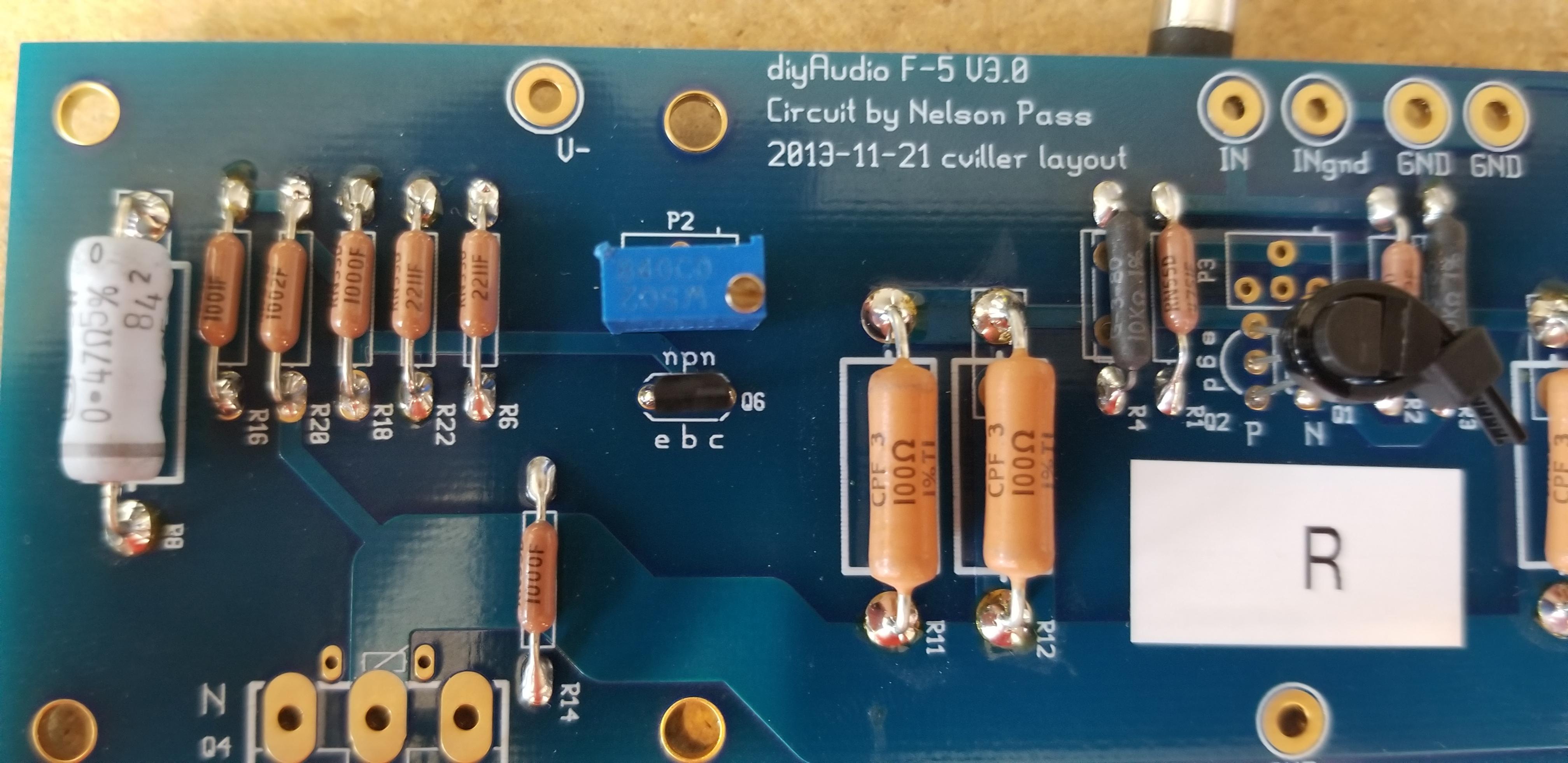

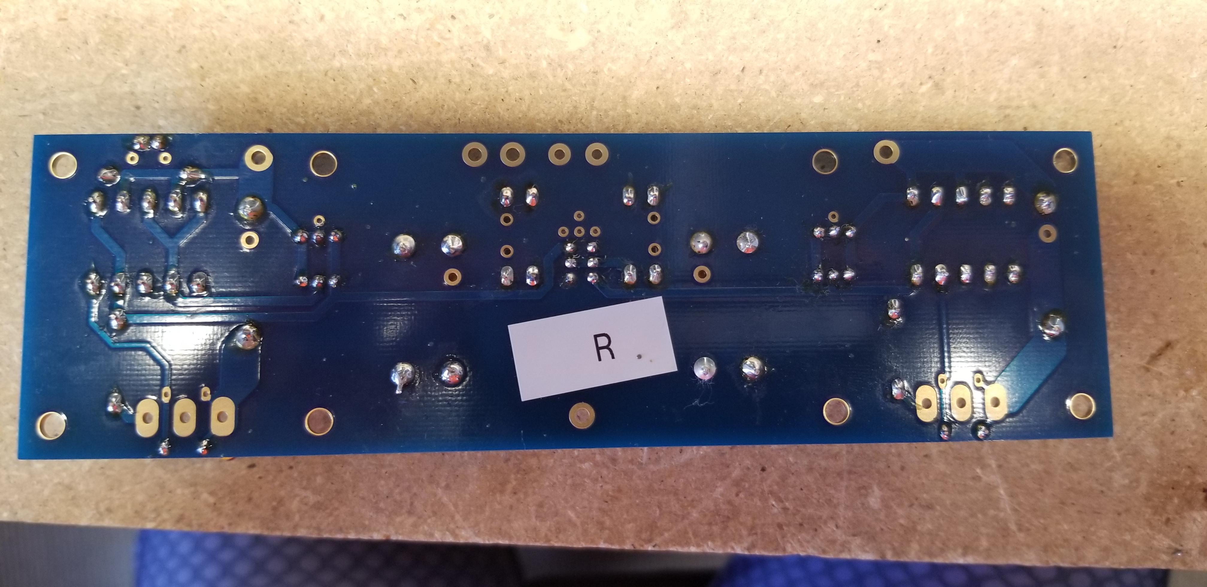

I’m ready to bias my right channel.
My PSU passed the dim bulb test.
The right channel passed the dim bulb test.
I adjusted P1 and P2 without unit plugged in to 0.0 to -0.1 range.
I’ve read several different direction sets on how to do this and I’m using cubincher’s guide from Another F5 Build post 106 and 109 as it seems the most detailed step by step to guide me. Thanks to A321Dryr for pointing me to it.

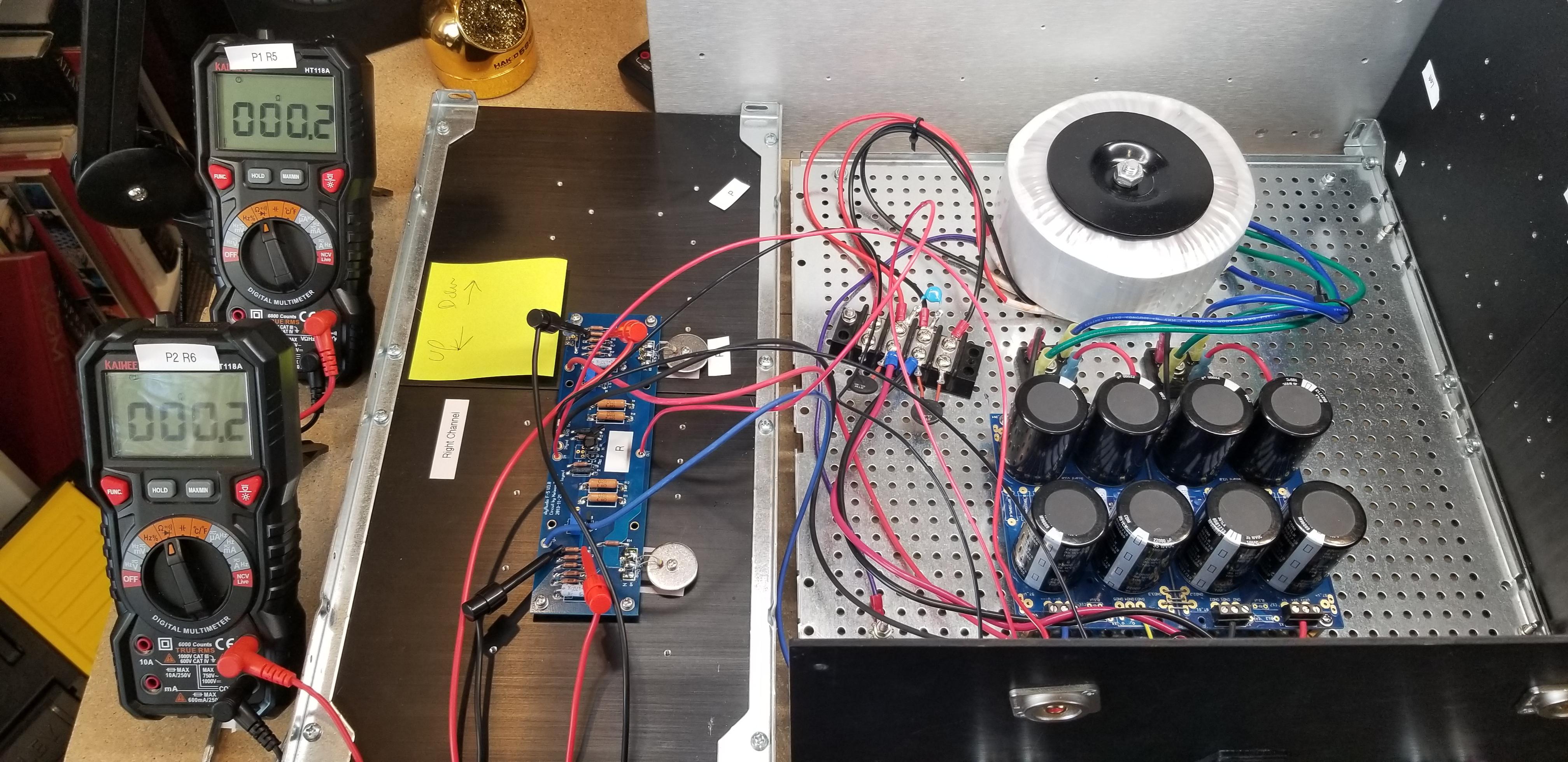

I’ve set up my 3 DMMs:
1. Loudspeaker output – set to mV
2. R8 mV
3. R7 mV
I turned the amp on and all three DMMs show 0.0 mV.
I’m ready to:
Turn P1 slowly [very] till the DMM shows 0.1 to 1mV
Same for P2.
The output DMM should not exceed 50 mV.
Then adjust P2 till offset at output is close to 0 mV.
Wait till offsets stabilize.
Here is where I’m unclear:
Turn P1 a little bit higher till offset at output is at 50 mV, then turn P2 a little bit higher till offset at output is close to 0 mV again.
If I’m turning both pots up, how can I lower the offset back to 0 mV? I think that is the magic of + and -polarity?

The idea is that the difference in current through the two sides show up
as the dc offset.
So you can turn up both sides, and as along as their currents are close,
the dc offset should be low.

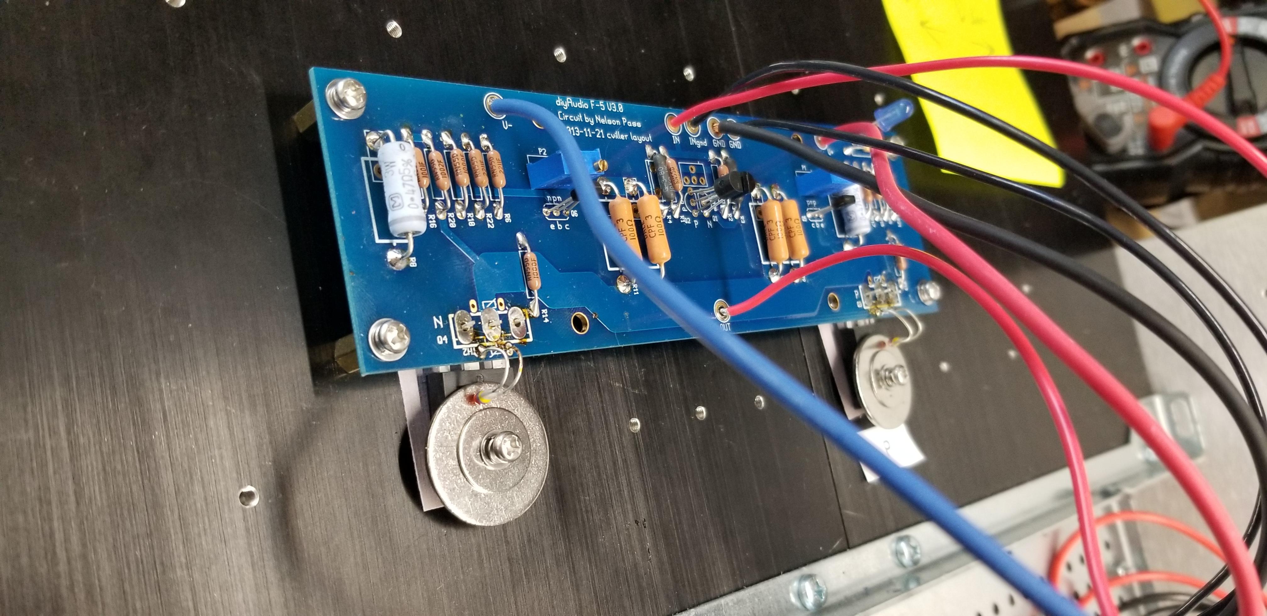

Chiptech - Please move the thermistors so they contact the plastic case of the MOSFET, not the metal fender washers. They are known to short out when contacting metal to ground.
