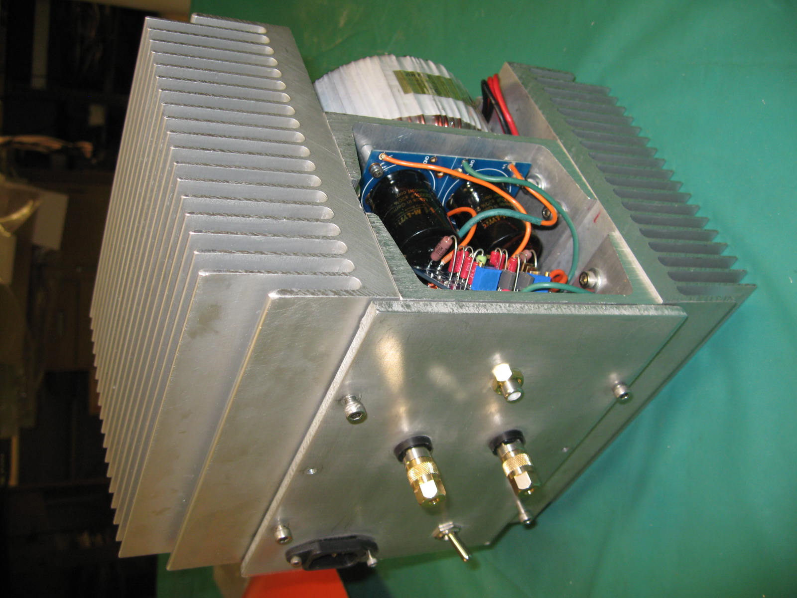

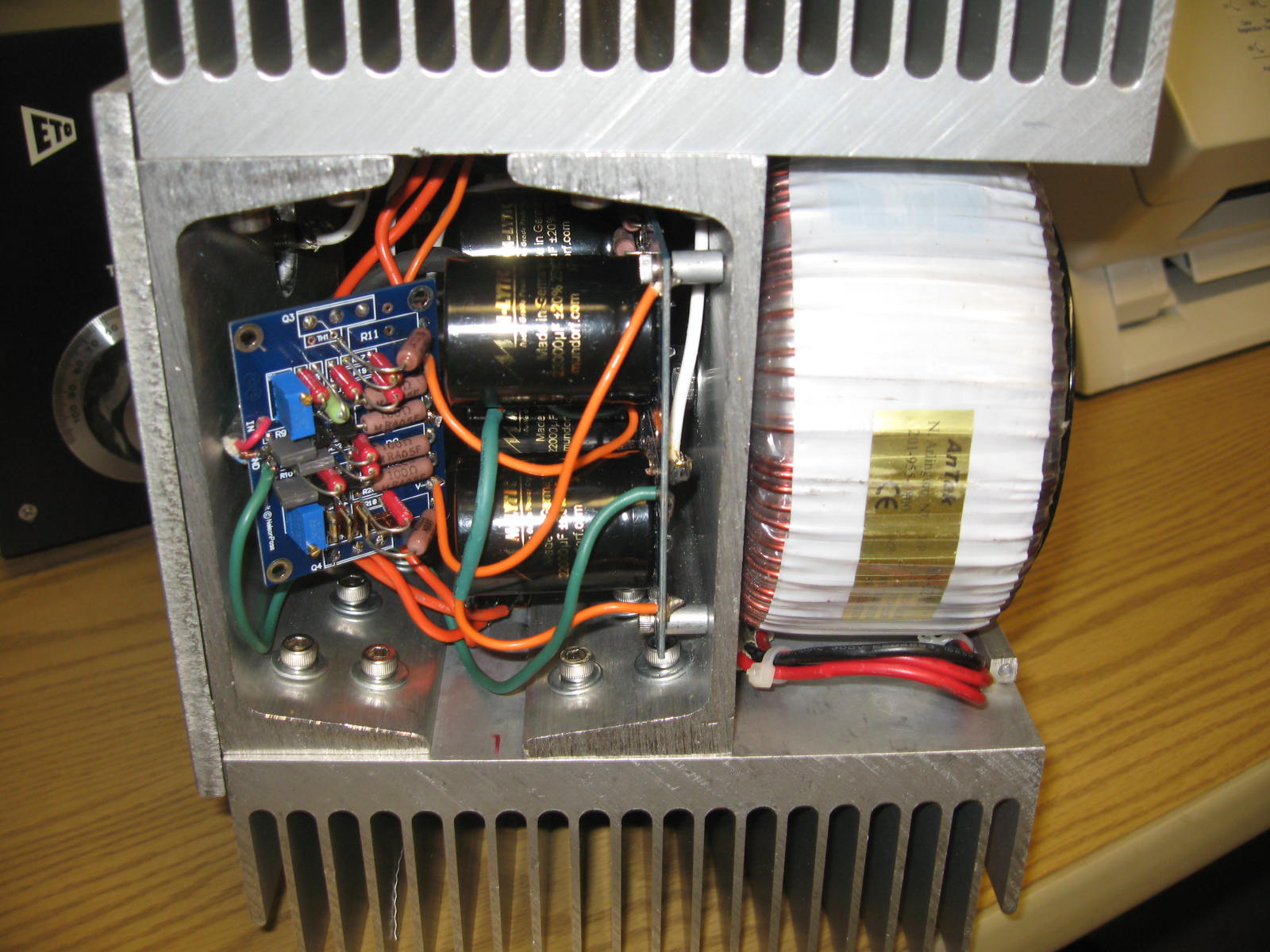

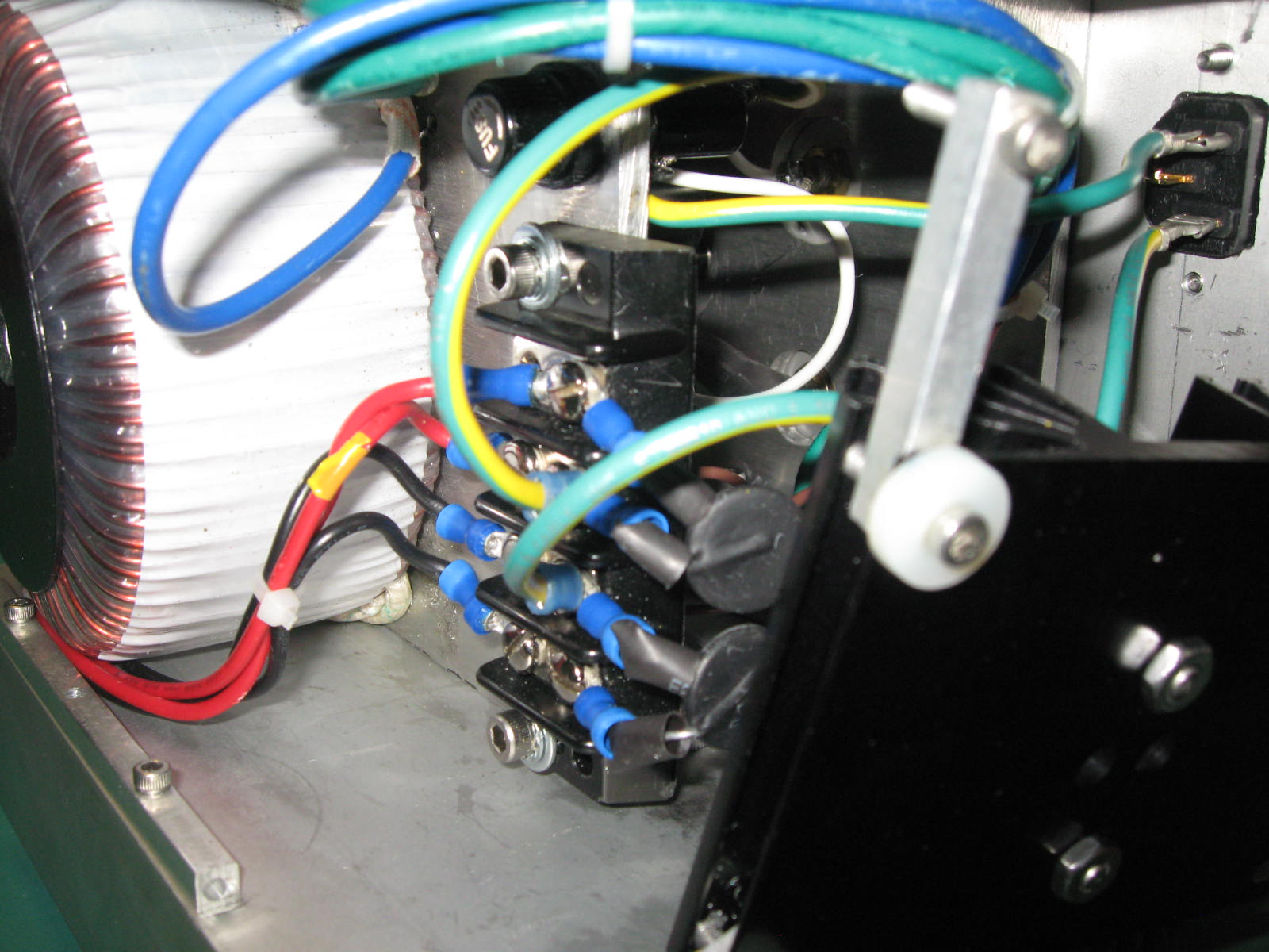

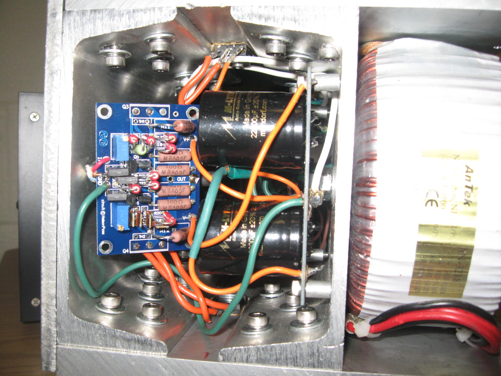

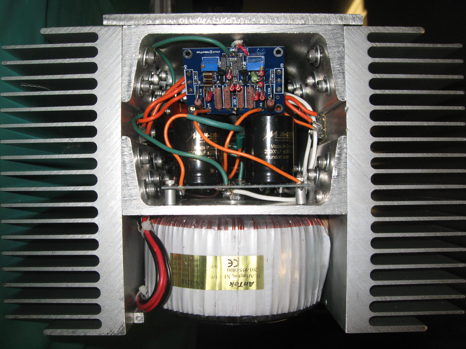

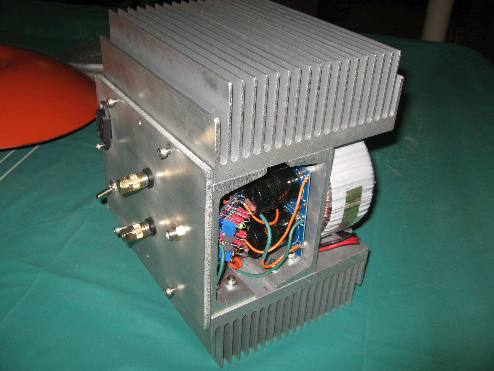

I built a new board as the other was mangeled from being pulled in and out oft he enclosure. All the voltages seem to check out, however I am still unable to draw current through R11 &12. I am not sure what to do from here.....
