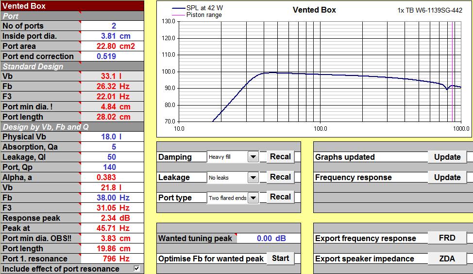

Can you hint me how to use the 1139SIF in a modest size cabinet (Say - 12 - 16 liter) to go down to 30Hz?
Keep in mind I'm just starting out - I fired up WinISD for the first time just 2 days ago 🙂
I'm still at the point where every hour I learn more about what I *don't* know :-/
Right now I just entereded "12 liter" in WinISD and tried to get as low as possible using LW xforms, which is probably the completely wrong way to go about this..
On the other hand my point still stands - with current events it's really easy /cheap to just throw class D amplifier power at it.
..and if that works, why would it not be a proper (modern) solution?

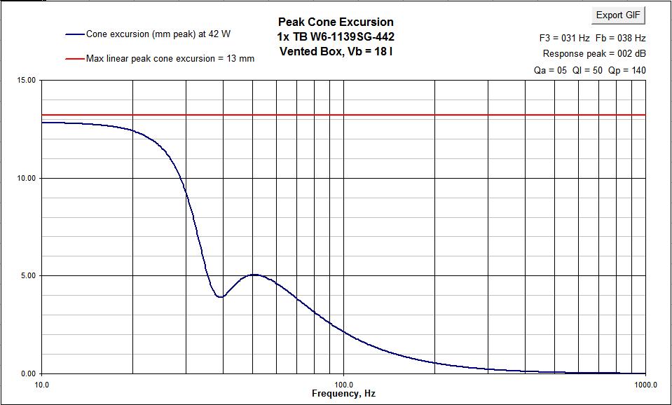

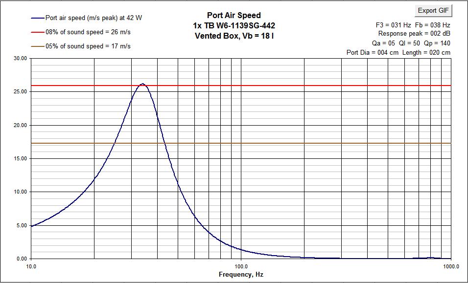

How about 18 ltrs for 30 Hz?
Using 2x 1.5"D ports, 8" long, tuned to 38Hz and yields an F3 of 30.48Hz. Use about 3/4# of stuffing, and flare both ends of the port if possible. This yields about 98dB before the port starts to chuff a bit. You could likely face them toward the rear and never hear them.
No need for boost. See below...
Wolf
Wolf
That sounds good, thanks!!
