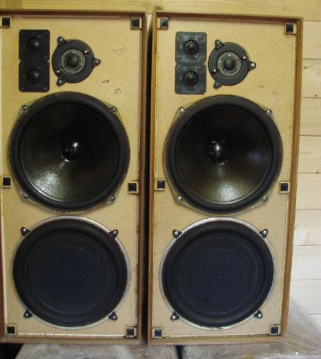

Short of a WMTMW design, you can get away with a single woofer,
Overall, I think you should double up the little mids. Then it should be doable. Because of the 6dB SPL gain from doubled drivers, distortion is less.
Wharfedale E70:
Celestion Ditton 25:
