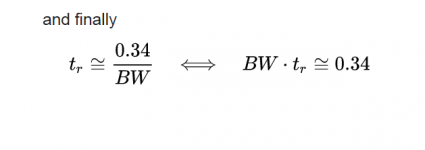

Read the Wikipedia article entitled Rise Time. You'll enjoy their derivation of the formula (Bandwidth x Risetime) = Constant.
Since a circuit which produces an "electrically TRUE square wave" is required to have a risetime of zero femtoseconds (in order to be perfect), it must also have a bandwidth of infinity. Which is not possible currently with the devices we have available.

I will do so. That is again exactly along the lines of what I was trying to explain to my friend. But, discussing 'zero femtoseconds' and an 'infinite bandwidth' wouldn't have gone well. (grin)Read the Wikipedia article entitled Rise Time. You'll enjoy their derivation of the formula (Bandwidth x Risetime) = Constant.

I would also add that a square wave with zero rise time would be "dirty" (i.e. rich in harmonics) to the point that there could be EMC issues with nearby electronics such as receivers and other sensitive components.
Some systems implement slew rate limiting for that very purpose.
