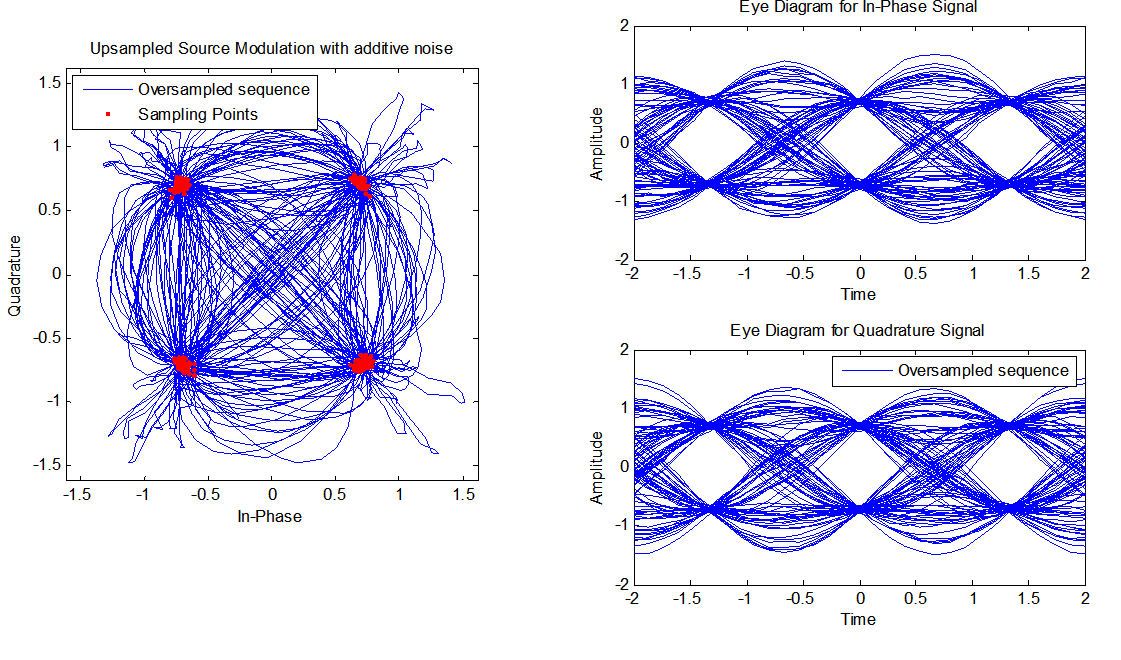

I was going to mention the "perfect square waves" as seen in so many eye diagrams, but I see people have already posted several such images.
If we on Earth were generating such perfect square waves, the UFO aliens would have contacted us or done SOMETHING to stop it, as the harmonics would go through the hundreds of gigahertz, the light band, ultraviolet, x-rays and gamma rays that they likely use to communicate, thus interfering with them ordering their cosmic pizzas.
