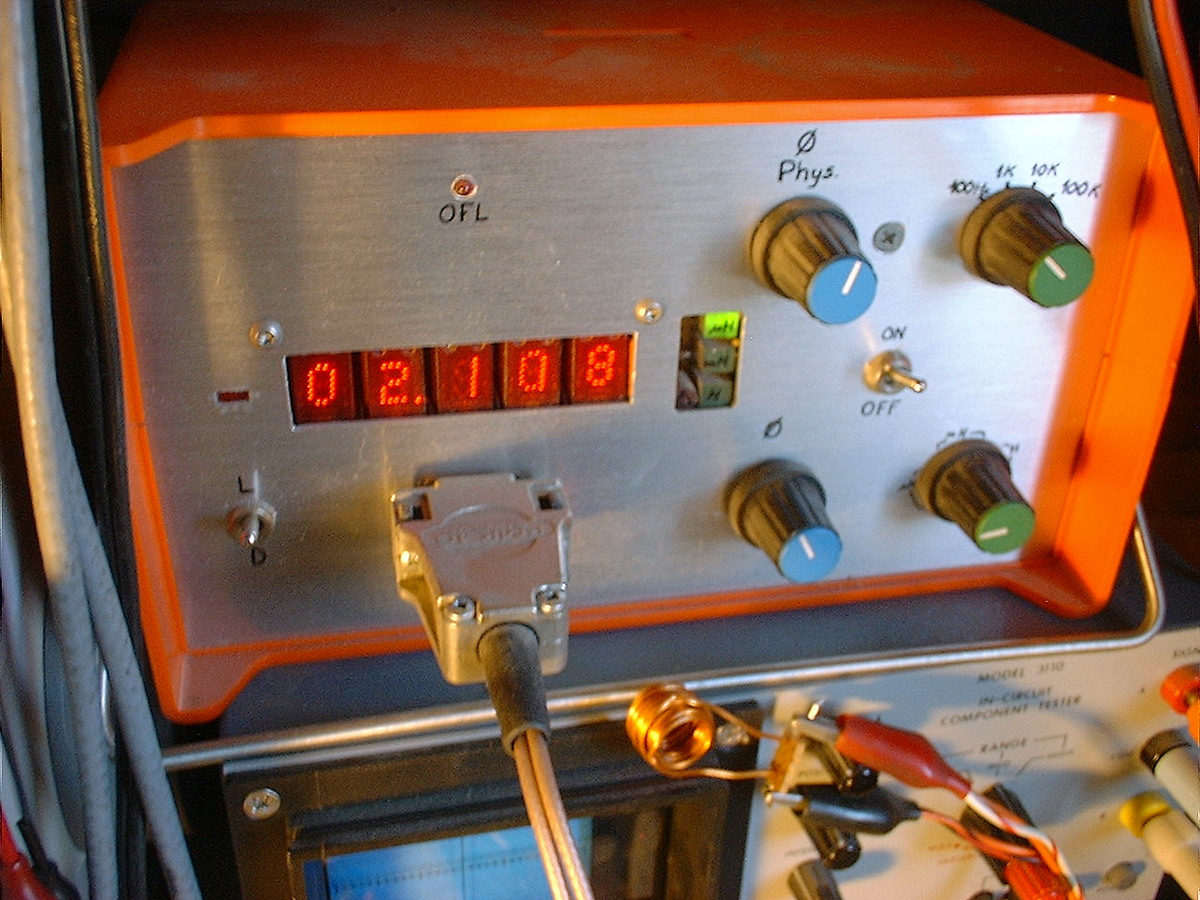

And here is my version of the ZLCR meter (fully configurable).

Elvee, is your ZLCR meter using soundcard? If so, which software works with it?
I must say I am impressed about mine, now that is in the box and layout cleaned up. Very stable, consistent and accurate, does not get thrown out of balance with switching back and forth between C and L. I did not use voltage converter as I hate to see yet another cable going to the PC, I simply inserted 9V battery in the box with virtual ground.
It works with the visual analyser.
I noticed yet some other quirky behaviour: it seems difficult to measure high quality inductances, because when the total voltage across the component is too small, it indicates underrange, even though the value is well within the range.
A work-around is to add a resistance in series with the coil, but it's not very elegant, and it certainly degrades accuracy.
The tare function seems to work very erraticaly: at times, it is unavailable, with the button grayed out, and other time, when it works (sort of), the tare value is completely random and changes each time you refresh it.
Not sure what you mean by "high quality" inductors. Low parasitic resistance? I was measuring air cores (2mm wire) and ferrite bell core (1.4mm) ones, all spot on; 0,82mH and 1.80mH respectively.
I have seen random graying out of the buttons too, so that's a bug. Also, it seems to refuse to attach itself to non-default Windows sound device.
Elvee
Have you tried to fiddle with the zero tare? I mean 56 uH is not much. I have not my unit connected ftm. but I will test this next time. 🙂
I did try, but one time it's 0.000µH, the next time 0.3154µH, then 0.3462µH.....
it seems completely random.
I've also noticed something else (not in the ZLCR): the frequency values in the spectrum display are incorrect: the fundamental at 1KHz f.e. is OK, but the harmonics are shifted, and the higher the harmonic, the larger the shift is: 150Hz at 2KHz, 300Hz at 5KHz, etc. Strange.

Within limits, I found the ZLCR meter to operate reasonably on this aspect.
Radioman:
1µH isn't nothing: one of my home-made inductance meter has a resolution of 1nH at 100Hz (100fH at 1KHz), yet it isn't a lab instrument (except for my own lab).
But of course, with a sound card the limit is 16bit, which is rather crude compared to an instrument having a fully analogue front-end.

But it isn't about the 1nH 100Hz, which is fully correct. I meant 100pH at 1KHz, not 100fH (I have also built a femtofarad-meter, which is why I was confused)
Can you mention a single instrument in the world with more then 24bit
An HP3458 has 8.5 digit, which is over 27bit, and unlike your 24bit, they are fully exploitable (within certain conditions, of course).
My humble inductancemeter has a resolution of 1nH @100Hz but it is far from a 24bit equivalent: it only has 5 digits.
It is difficult to compare these kind of things: a good old analogue bridge has no digits or bits at all, yet it is capable of resolving microvolts or even nanovolts, and nanohenries or picohenries of inductance.
How do you f.e. null the measuring device with such resolution? Is it a work of your own?
It is obviously a permanent 4W device, and before any sensitive measurement, a null has be performed.
It is far from a very high tech or sophisticated instrument, it is based on synchronous measurement techniques.
I'll try to make a scan of the schematics one of these days, if i'm able to locate them.... Not a big issue, really.
