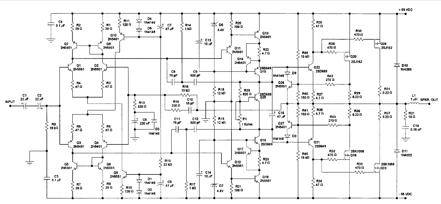

Firstly let me say the Slone circuit does work, most of the time. I tried it and it worked fine but with a vas current of 38mA; Douglas Self tried it and it worked fine but with a vas current of a few hundred microamps; others have had various degrees of success plus a few total meltdowns along the way. The point here is that the circuit is not capable of replication with a defined vas current - sometimes you're lucky but more often you're not. The root of the problem is that the voltage at the junction of Q3,Q5 collectors and Q12 base is indeterminate ( original schematic parts numbering ). There are various ways of fixing this problem but they all involve impressing a known voltage at the junction mentioned above, directly or indirectly. The schematic shown below is a direct method which involves least change to the original schematic and pcb. The voltage impressed on the key junction must be greater than 1.2V, but not too much greater, to turn on the base/emitter junctions of Q12 and Q18. Replacing D1 and D2 by a red led provides a source of 1.7V and this is impressed on the key junction via R40 ( 10k). Adding R41 (51R) in the emitter of Q18 will result in a well defined vas current of about 10mA. This arrangement will cause a tiny imbalance in the Q5/Q6 current mirror but not enough to have any noticeable effect. Needless to say this arrangement must be mirrored in the upper half of the schematic. I changed the value of R21 to 2k as 100R seemed brutally low. I also changed the value of R10 to 200R to keep the ltp current source delivering 5mA. I have used this arrangement in real life amplifiers so I know that it works. On a more general point, discussion of this Slone amplifier, its topology, and related topologies has cropped up many times, over the years, on diyAudio. Maybe one of the moderators might care to look into the possibility of a sticky post on this topic, in order to ameliorate constant reinvention of the wheel?

First reaction from post #1 - it should not work. Q13/Q18 complementary VAS have no means of limiting the current other than short circuit protection.
Bad design/
Recommend eliminating one half of the circuit as posted by peufue in #23 with one of the VAS transistors turned into a current source.

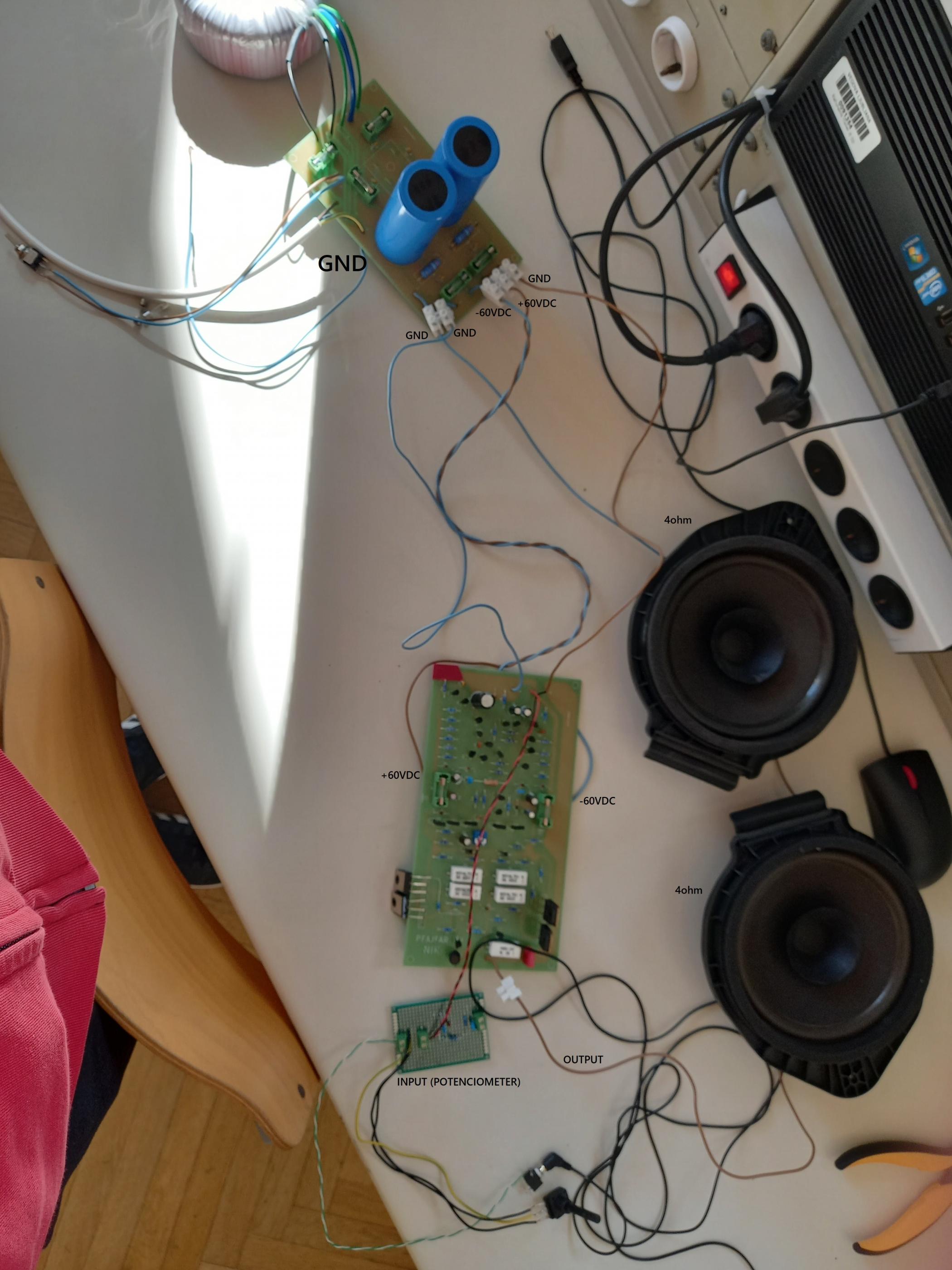

I get a really loud high pitched sound from the speaker as soon as i turn on the power supply do you have any odea how i could eliminate that?

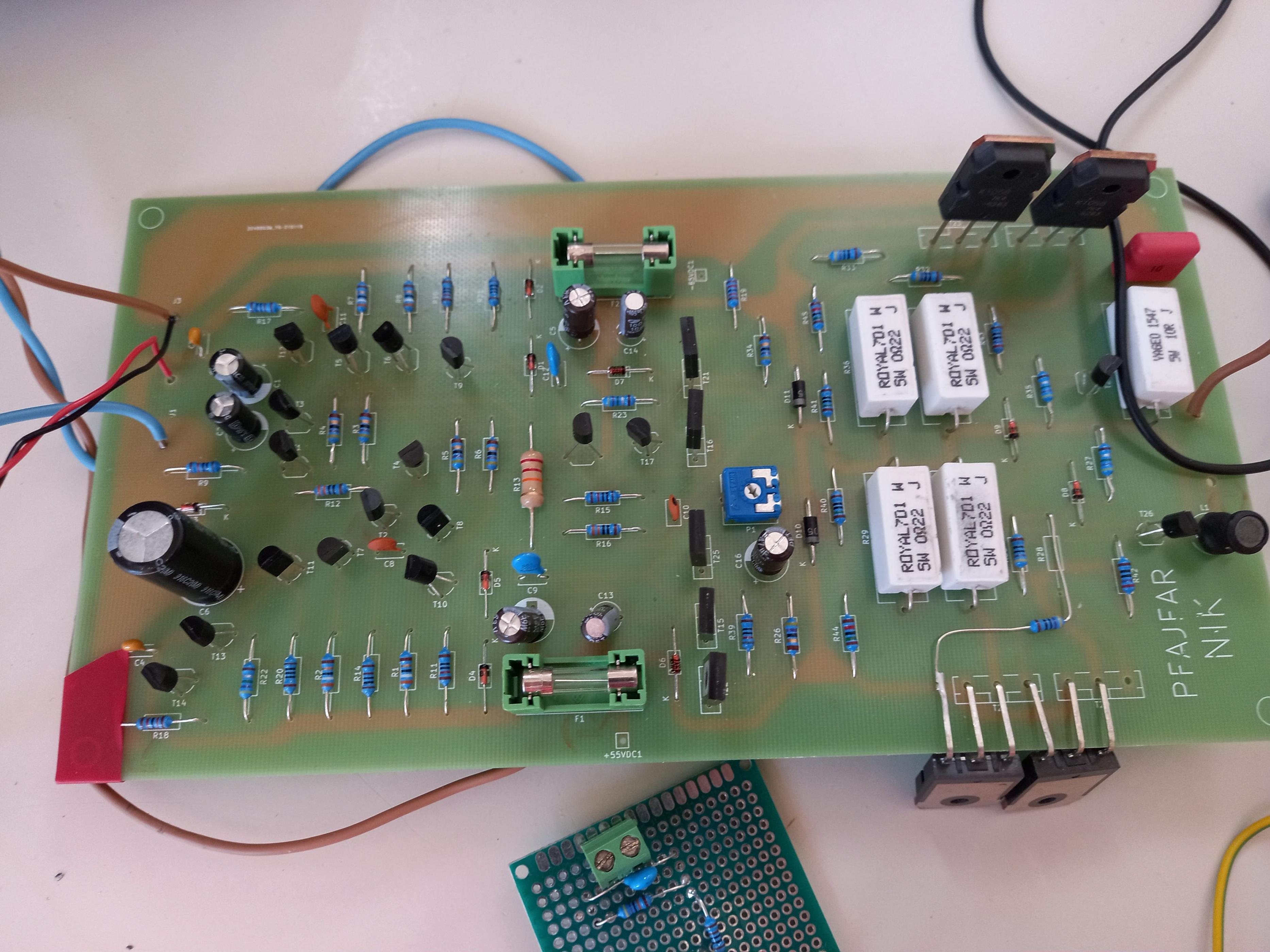

I realize you have moved on to a new design but in looking at your original amp, the placement of the TO-92 transistors looks suspect unless the ones you used are not "CBE" lead placement. The PCB silk screen is for CBE.
What do you think about this schematics is it functional, has anyone built it, do you have any recommendations on what would you change. I pretty much gave up on the initial circuit utillizing mirror image input stage with current mirros, sience I tried most of the fixes people on this thread have recommended and it still doesnt work as it should. I just get a load beeping sound from the speakers.
Now I want to build a simmilar circuit so I can recycle components and the power supply. I am wondering if this circuit has any problems that I should look out for. Firstly I can see that this circuit still uses current mirrors I suppose that they must be stable with the use of matched transistors.
Other than that I could use some grounding tips and would like to know if the supply rails can be increased to +/- 60V.

The layout on your board looks exactly like the schematic, which is not a good idea for a power amp.
For example you want the power input wires near the output transistors, so the high current doesn't run through the whole board. Due to common impedance coupling and magnetic coupling, this can cause all sorts of problems like high distortion or even oscillation.

Do I connect the signal ground seperatly or together with the rest of the grounds. Do you maybe have any good examples of star grounding I dont quite understand how to implement it onto the PCB.

Not a beginner amp, lots of parts, complicated, and there is a joke in the output stage.
Why CFP output stage btw? You like the sound of crossover distortion?
That amp already has catching diodes across the rails to ground. It does not have any gate protection diode networks however. That Slone amp is not a good one for beginners. It also can be unstable and layout will affect that.
