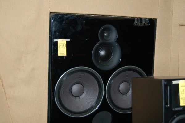

Also I hope that you will find helpful this and that.:)

Thanks for the links and pics Salas. Lots to look through there.
I'm feeling that my next loudspeaker will likely be something along those lines with eye towards corner placement. Sort of build the cabinets into the corners and bridge the gap with the baffle.
