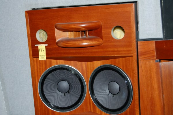

salas said:
That is what they do in some studios Shin. Flush custom built speakers or special tailored wall nests for commercial models. 2 .
I've seen soffit mount installs but didn't realise they removed all corners of the front of the room and installed drivers directly into that. More forward thinking from the pro audio guys.
Got any images I could take a look at please?
