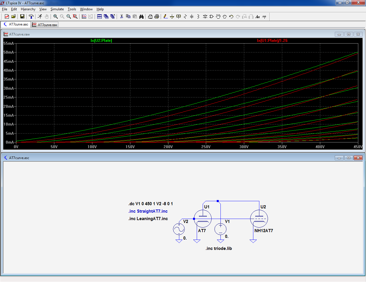

Anyways, in the spirit of friendly nitpicking, I'm working on
that compelling example thing you asked for. Here's what I
got so far (This is the dumb model, pure Child-Langmuir):
.SUBCKT AT7 PLATE GRID CATHODE
.param MU=60
.param PERVEANCE=.0221
G1 PLATE CATHODE VALUE=
+{PWR(PERVEANCE*(V(GRID,CATHODE)+(V(PLATE,CATHODE)/MU)),1.5)}
R1 PLATE CATHODE 999G ; prevent floating nodes
R2 GRID CATHODE 999G ; pervent floating nodes
.ENDS
Then later (maybe lots later) I will attempt to fake the real curves by
parallel internal paths, rather than Koren's more efficient methods of
fudging the equation for lean...
Note to future self:
I need to limit this .model to keep it from going silly beyond cutoff.
RE: 45
There is only one or two tubes in this scheme, not 555 or 1110!
RE: Elvee
P-chan C-Vac
I assume the actual output there would be from the "ground" terminal, with a fixed total B+ for a set of N-Chan and P-chan C-Vac's stacked up for a P-P output case. (So that the tube(s) see the variation of output voltage on it's plate(s), to maintain triode-like behavior.)
Something to still consider would be if it is practical to make the control input to a C-Vac emulation P-chan like also.
A differential pair (CCS tail) of tubes at the "pilot" position, or a differential pair using a Fet and a tube maybe. Tube on one side of the differential gives a P-chan input emulation of the tube, and swap the two in the differential pair to get an "anti-triode" tube emulation. "Pilot" tube (or the "anti-tube") gets its plate current monitored, like in the P-C-Vac. Kenpeter will have more to say on the concept I think.

This for me, was not the quickest nor easiest way to model a triode.
But it does prove my insane method and lame reasoning behind it.
You only need parallel Child Langmuir to explain lean, nothing else.
If we extend the parameter spread across hundreds of unmatched
triodes, the lean could only increase. How much? I don't know. If I
knew (which I don't), I'd hazard a guess that a carefully selected
spread of just two already leaning triodes could probably fake it.
Not that further spreading the parameters is desirable, only that
is required if you wish to sound like the parameter smear of 555
unmatched triodes, which we probably don't.
So, anyways. This is a simulation of a theoretically pure AT7 curve
set of one Child-Langmuir law, then a spread of 10 subset-triodes
that have been empirically chosen to lean like the spec sheet.
Enjoy, and "reload plot settings" if you want the scale to look like
the spec sheet, for easy side by side comparison...
.param MU0=35 PV0=.00015
.param MU1=40 PV1=.00016
.param MU2=45 PV2=.00018
.param MU3=50 PV3=.00020
.param MU4=55 PV4=.00025
.param MU5=60 PV5=.00030
.param MU6=65 PV6=.00035
.param MU7=70 PV7=.00040
.param MU8=75 PV8=.00045
.param MU9=80 PV9=.00050
G1 PLATE CATHODE VALUE={
+MAX(0,PV0*PWRS(V(GRID,CATHODE)+(V(PLATE,CATHODE)/MU0),1.5))+
+MAX(0,PV1*PWRS(V(GRID,CATHODE)+(V(PLATE,CATHODE)/MU1),1.5))+
+MAX(0,PV2*PWRS(V(GRID,CATHODE)+(V(PLATE,CATHODE)/MU2),1.5))+
+MAX(0,PV3*PWRS(V(GRID,CATHODE)+(V(PLATE,CATHODE)/MU3),1.5))+
+MAX(0,PV4*PWRS(V(GRID,CATHODE)+(V(PLATE,CATHODE)/MU4),1.5))+
+MAX(0,PV5*PWRS(V(GRID,CATHODE)+(V(PLATE,CATHODE)/MU5),1.5))+
+MAX(0,PV6*PWRS(V(GRID,CATHODE)+(V(PLATE,CATHODE)/MU6),1.5))+
+MAX(0,PV7*PWRS(V(GRID,CATHODE)+(V(PLATE,CATHODE)/MU7),1.5))+
+MAX(0,PV8*PWRS(V(GRID,CATHODE)+(V(PLATE,CATHODE)/MU8),1.5))+
+MAX(0,PV9*PWRS(V(GRID,CATHODE)+(V(PLATE,CATHODE)/MU9),1.5))}
.ENDS

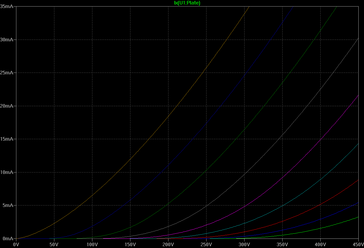

The modelling used by Duncan for example is quite different (and more complex), and it gives more realistic results.
Here the sets of curves are adjusted for the best fit, but severe discrepancies remain.
Oh yeah, there are so many more things to adjust for an accurate model.
And best fit behavioral equations like Duncan's are totally the way to go.
I didn't bother with grid current, or Miller, and whatever makes the 0
line bump up I couldn't even begin to guess the math of those things...
Koren said, "New equations for tube characteristics are phenomenological
equations, that is, equations model the behavior of physical phenomena
using a reasonable number of parameters, but are not derived from
fundamental physics."
I was only concerned to demonstrate convincingly the leaning behavior
of parallel triodes is likely a feature aggravated by unmatched set size.
And I believe what I'm showing about sets might be the actual physics.
I acknowledge the discrepancy you point out as real, no argument...
The important things here are the respective importances of internal variation (micro-tubes inside one tube) vs the external variation from tube to tube.
From what I see, you had to resort to a ~3:1 parameter variation inside one tube. Would the parameter variation from tube to tube be on the same order? I don't think so, unless the tubes are different types, like I did in my quick and dirty example.
