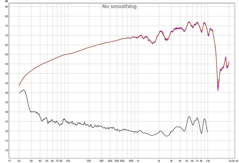

The next day I mounted the membrane A3 and did a measurement, and the response was upward of approximately 5 dB from 40 Hz to 1 kHz
Unfortunately it was late and I did not save the measure promising to do it again the next day.. The result, to my surprise, was this
At this point I realized that it is a problem of polymerization of polyurethane, or because I used solvent, which is not provided in the data sheet, or why complete curing, solvent-free, it has after seven days, or for some other reason I will investigate later.

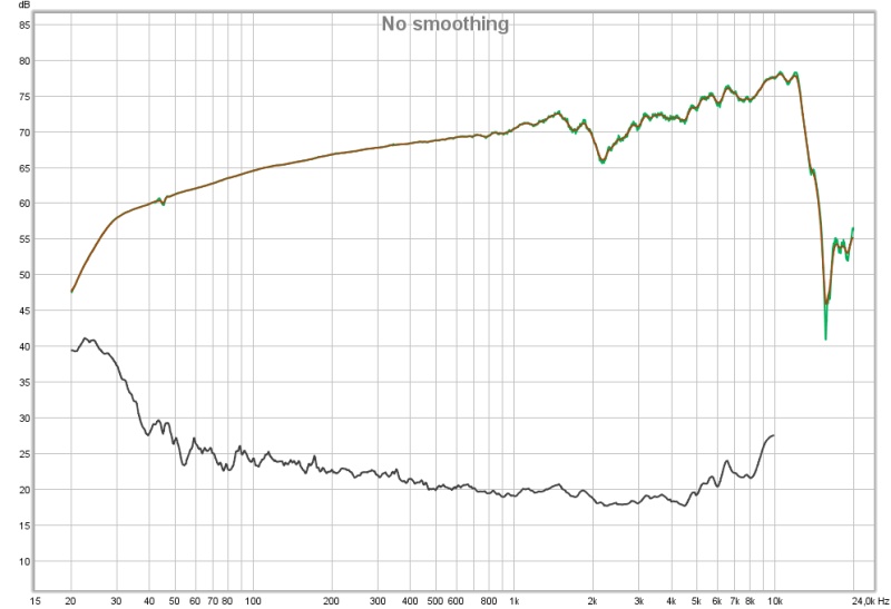

By the time I wanted to see if by washing of the membrane something changed, and I got lucky: I washed the membrane first with alcohol and a soft brush, then with water, dried and then I put on the hot plate at 100 ° C for 1h. Then I left to rest after 5h and the result was this:
During the 5 hours I did other measures and I could see that the curve is straightened a little every hour.

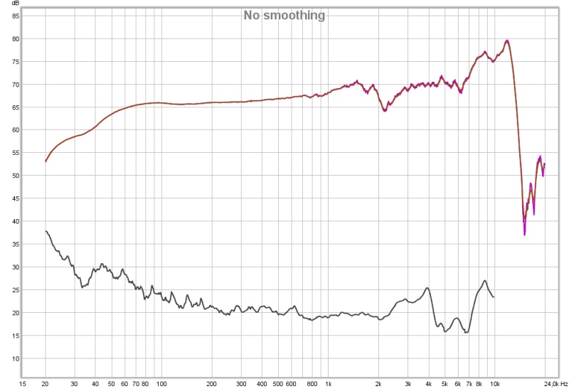

To be sure I have found the cause of the changes of the responses I have adopted the same washing for the previous membrane (A2), and the behavior is the same. In fact, as you can see the response came back similar to one of the first measure

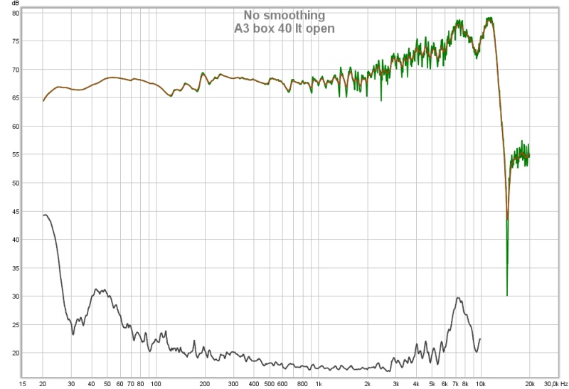

However I was able to listen to music with the driver with the membrane A3 put in a box of 40 liters with open back. I am reluctant to praise what I do, but I must say that the work I did was worth it. This is the response with mic to 1 cm. I tried with mic 50 cm but there are too many resonances of the room. When the time comes I'll put some absorbent panel.
Bass was outstanding. On the high range I heard something better, like spatial effect, only with a driver electrostatic; someone has noticed this difference between AMT and eletrostatics?

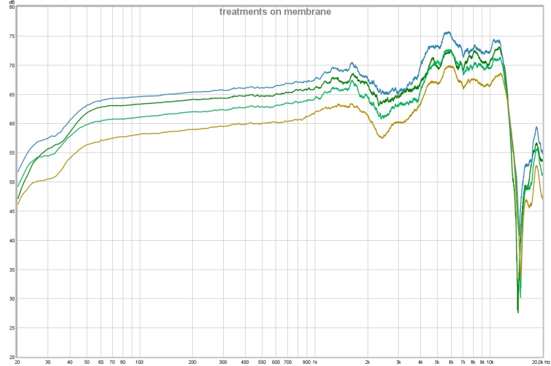

Finally they came to light the reasons for those seemingly random responses. As I used a new material I was convinced that he was the problem, but I found that it does not.
The fault lies with the microphone, which is affected by ambient humidity (RH). The microphone is part of the instrument TECHNICS "audio frequency analyzer SH 8000", and is the version A. The following measures summarize what I tested (the curves are shifted a little for clarity):
The first figure summarizes the tests made on the membrane: Before treatment (dark green line), cooling to -22 ° C for 15 '(blue line), heating at 100 ° C for 10' (light green line), water atomization directly on the membrane and drying the droplets (light brown line).

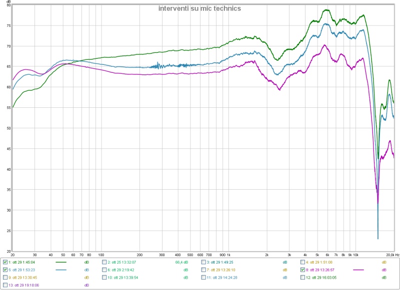

Having checked the small influence of the treatments on the membrane I passed to check the microphone:
The second figure summarizes the treatments made: Before treatment (green line), the flow of hot air at about 70 °C for 5' on the top of mic (blue line), drying for 1 night with silica-gel (cyan line).
During this time the environmental conditions (temperature and RH) Have remained fairly constant, and therefore had no impact on the other components. It 'clear that the humidity has a major influence, and when I have time I will see why. For now I'm going to keep the mic in a dry place and pull it out only when I need it. The variations of the response in still air are rather slow, and for a period of one hour I can feel comfortable. I am convinced that the right response is that in dry air because I made comparisons with other 4 microphones, which are economic, but until a few KHz gave all the same trend of the technics dried.
In conclusion, I withdraw all the reservations I had done on this polyurethane rubber. Moreover are many years which is used in various applications.
