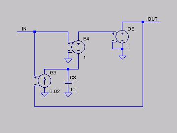

As I see it the Hawkfords error correction is a kind of feedback. But since it measures the error across the output stage, inverts it and adds it to the input it still has some advantages compared to regular NFB. It´s correct that NFB divides the distorsion, but the Hawkfords EC cancels it if the measured error is added in exactly the correct amount. Thats the hard part, since this amount is probably frequency dependant, temperature dependant and so on.
Still, getting rid of 90% of the output distorsion or so, makes it much easier for the global NFB divide the remaining distorsion.

Rikard Nilsson said:As I see it the Hawkfords error correction is a kind of feedback. But since it measures the error across the output stage, inverts it and adds it to the input it still has some advantages compared to regular NFB.
Hi Rikard. Do you mean like the circuit below?
Yes, in the sense that the global loop needs less feedback loop gain to get the distortion to the target. Of course, the total loop gain of the amp needs to be the same, if you will. So the decision is where to apportion the feedback.
The other advantages like improved PSRR is also nice.
Is this not a consequence of floating the psu of the correction circuit, tying it to the output signal, rather than the type of feedback?
Brian
The circuit you attached above is what I mean. Cancelling errors. Very smart, very fast. And I also mean that only because an amp might have EC in the output stage, there is no reason to lower the global NFB simply because there is less distorsion coming from the final stage. For my own amp I plan to keep using a fairly ha NFB as well.
Rikard Nilsson said:The circuit you attached above is what I mean. Cancelling errors. Very smart, very fast. And I also mean that only because an amp might have EC in the output stage, there is no reason to lower the global NFB simply because there is less distorsion coming from the final stage. For my own amp I plan to keep using a fairly ha NFB as well.
Ok, I understand. The circuit I show is entirely a negative feedback circuit and is identical in operation to HEC except that it needs no tuning. I shall coin this "Brian's Error Correction".
Of course, I believe it is commonly referred to as a servo.
I agree that one might as well have as much global feedback as is healthy, all things being equal.
Brian
I prefer not to use the term "cancel" with any feedback circuit as the actual behaviour is asymptotic reduction of error. A feed forward circuit, on the other hand, really does do cancellation in a mathematical sense.
