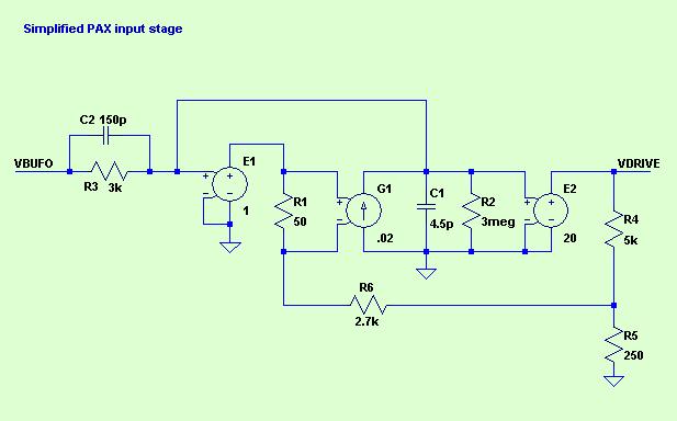

I post the simplified diagram of the PAX error correction (feedback) diagram
Regards ;) Lineup from Sweden - a very clever man, if you ask him

This is sort of feedback
Hello,
I have been reading about all this Hawkford style error correction a lot because I was interested in that Pax amplifier. My conclusion is that it is a feedback loop. In classical feedback you have gain in the forward path and no gain in the feedback loop. In this error correction type you have no gain in the forward path but gain in the feedback loop. It's not so different, except that the feedback in the Pax can be negative or positive. And in the Pax the feedback is also local and not global. There is still no way of total distortion cancellation (contrary to feedforward technology) and the problem of high frequency instability. In fact, just this instability problem is the testimony of the feedback principle of this design.

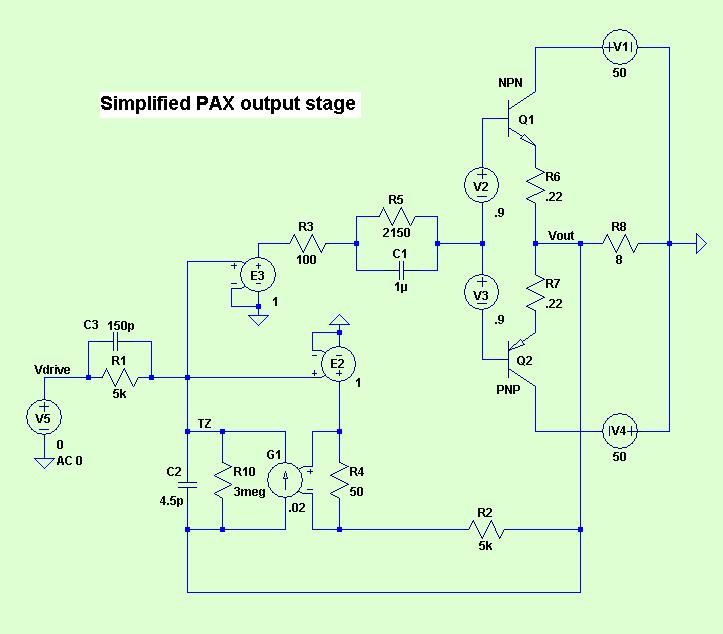

Am I missing something?
I count at least three or four feedback paths in that schematic:
1: The overall feedback path back to the input of U4, polarity is uncertain and it appears to possibly be current mode.
2: The emitter resistors R64 and R66 provide local feedback around the power transistors by effectively adding IR drop to Vbe (in addition to that caused by the inherent Re value of those parts). This is effectively current mode feedback.
4: I assume C7 and C8 are pole splitting caps (which implies negative feedback at high frequency).
3: The bootstrap caps C11 and C12 provide audio frequency voltage feedback (positive) but the gain should be very low.
I am concerned by the lack of output filtering which potentially allows RF picked up on the speaker leads back into the input of the amp via the overall feedback path, and the lack of short circuit protection could also be a problem, albeit one easily rectified.
I must be missing something if this is a design without feedback, because it seems to have loads of it to me.
An explanation would be appreciated.
Regards, Dan.
Re: This is sort of feedback
darian said:
Hello,
ABSOLUTELY CORRECT :yes: :yes: :yes:
Thank goodness there are people in this forum who understand control systems.
Jan Didden's Pax was discussed here on the forum, giving the conceptual schematic
http://www.diyaudio.com/forums/showthread.php?postid=1513779#post1513779
(see also following post numbers and several ones before. EDIT, here the thing started: http://www.diyaudio.com/forums/showthread.php?postid=1472359#post1472359).
Of course, from my view also, this qualifies as feedback (as something is feed back to an earlier stage), but it not of the traditional type -- a semantics "problem", in the end.
Perhaps we should make the circuit in question clearer. This is a simplified diagram of the PAX output stage.

I carefully read the introduction of the Elektor article again : the editors do not speak of the Pax amp as a non-feedback amplifier. They even say that EC is an other way to implement feedback.
