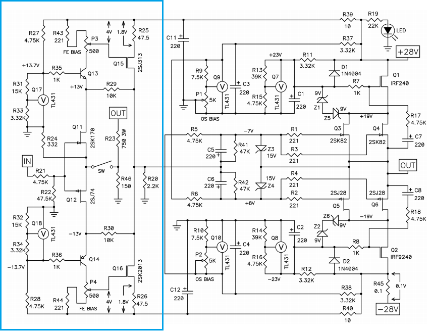

I have some K1530/J201 I bought long time ago (supposedly matched but not sure how well). I also have some K2013/J313 as well as some papa's j favorites 170/74. I have been mulling putting all of these to a good use.

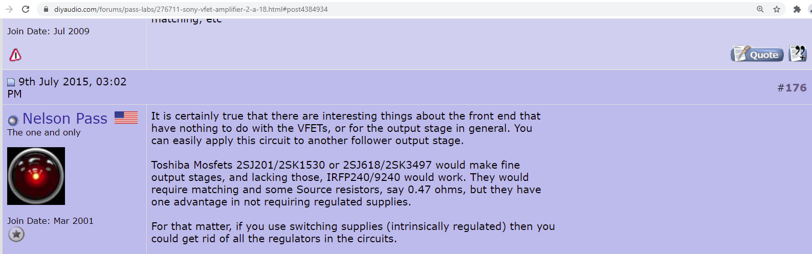

While sort of keeping an eye on what amp could use these I seem to have missed a nice pointer from Papa himself that the front end of the Sony VFET 2 could drive these nicely.
Please check out the Vfet front end schematic and Papa's comments. I am far from an expert: it sounds to me the FE could be used to drive something like an F4 output stage? just drop the buffer. Did I get that wrong?
Could maybe someone draw up or sim what this should look like with say 2 (or 3) pairs of K1530/J201 per channel and which values would need adjustment? maybe estimate a few starting values if the rails were at +/-28V shared with the FE? Thanks a lot. Your help is much appreciated.

that's BA3 FE
now that you mentioned it does look familiar (and I already have BA-3b mono blocks with F4 OS). how funny is that? 😀 not sure what Q13/14 are in the Vfet FE though and the rest of the fine differences.

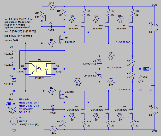

If you don't mind an input coupling capacitor, I have CFP Toshiba MOSFET @ 28V biased M2 style in archive, similar to a Stasis OS but with MOSFETs.
- 40W into 8 ohm, 75W into 4 ohm.
- Very low ppm level distortion.
- Damping factor 664, 12 miliohm output impedance.

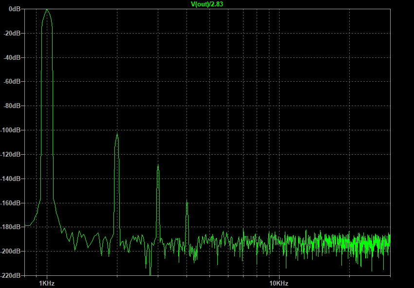

Log file @ 1W into 8 ohm load:
Code:
N-Period=all
Fourier components of V(out)
DC component:-0.00186744
Harmonic	Frequency	 Fourier 	Normalized	 Phase  	Normalized
 Number 	  [Hz]   	Component	 Component	[degree]	Phase [deg]
    1   	1.000e+03	4.000e+00	1.000e+00	    0.02°	    0.00°
    2   	2.000e+03	2.871e-05	7.177e-06	   45.58°	   45.56°
    3   	3.000e+03	6.726e-07	1.682e-07	   -0.61°	   -0.63°
    4   	4.000e+03	6.676e-07	1.669e-07	 -176.37°	 -176.38°
    5   	5.000e+03	5.100e-07	1.275e-07	 -179.74°	 -179.76°
    6   	6.000e+03	4.236e-07	1.059e-07	 -179.99°	 -180.01°
    7   	7.000e+03	3.645e-07	9.113e-08	 -179.97°	 -179.99°
    8   	8.000e+03	3.180e-07	7.951e-08	 -179.93°	 -179.95°
    9   	9.000e+03	2.823e-07	7.059e-08	 -179.93°	 -179.95°
Total Harmonic Distortion: 0.000718%(0.002688%)
Please note that M1 and M2 do not have source resistors, and other source resistors are intended only to mitigate Vgs mismatch between parts. Bias is determined by R6 and R7.
C4 and C5 are needed to ensure HF stability, but smaller 39pF - 82pF can be used.
LTspice asc and associated include files are zipped together.

Posted in SERFE - a Single Ended Rush Pair Front End. Please note Attachment #4,6,7 of the first post.
One of my business acquaintance has thousands of 2SJ103GR in stock, I'll be happy to send you a few matched pairs in case you have difficulties in getting them. The 2SJ103 can be substituted with LSJ74 but then you may need to compensate for HF stability.

As for F5 mentioned above: I already have it with the IR parts and do not feel like changing the devices only (well maybe eventually; the footprint does not fit the board and more holes in the hsink would be required). But this amp is apparently one of the best applications for K1530/J201. Here is what Nelson commented at one point:
https://www.diyaudio.com/forums/pass-labs/313569-baffle-spend-toshiba-2sj201-sk1530.html#post5215161

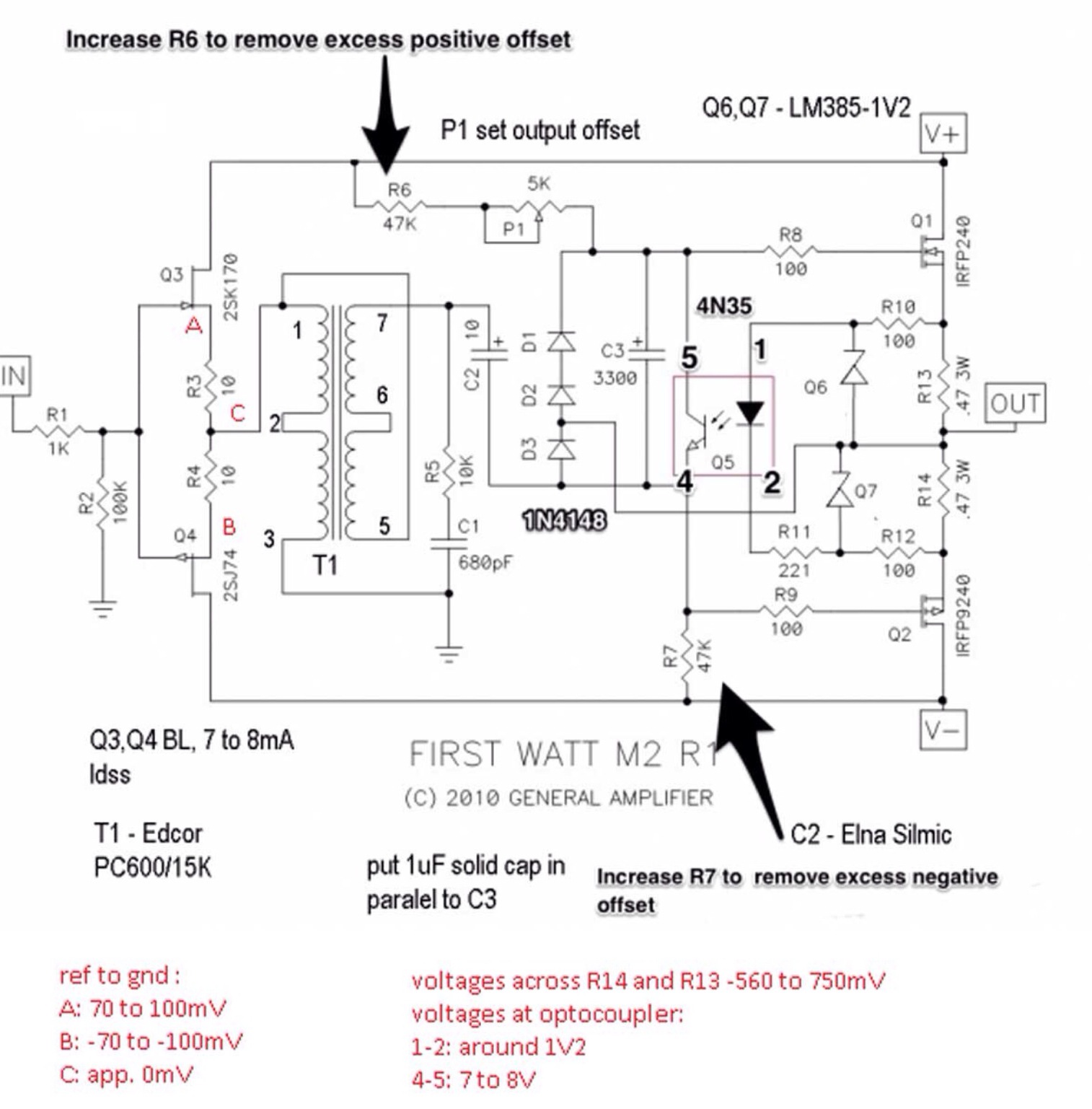

I have built my M2 as an all Toshiba amp ... 2SJ201 and 2SK1530 in the output stage, and 2SJ74/2SK170 input.
Only changes to attached schematic are (following guidance by Zen Mod and Generg):
- change source resistors R13/R14 to 0R33
- replace R11 from 221R to 0R (jumper) to bring bias down again after reducing source resistors had raised bias
My M2 runs at +- 24V rails and 1.8A bias 😀
