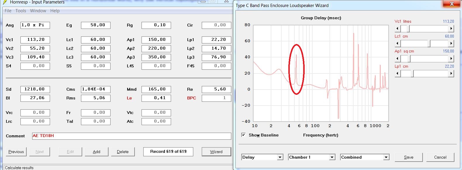

I really don´t like to criticize other peoples designs and there are already too much of nitpicking criticism in this forum, but your design makes me a little perplexed.

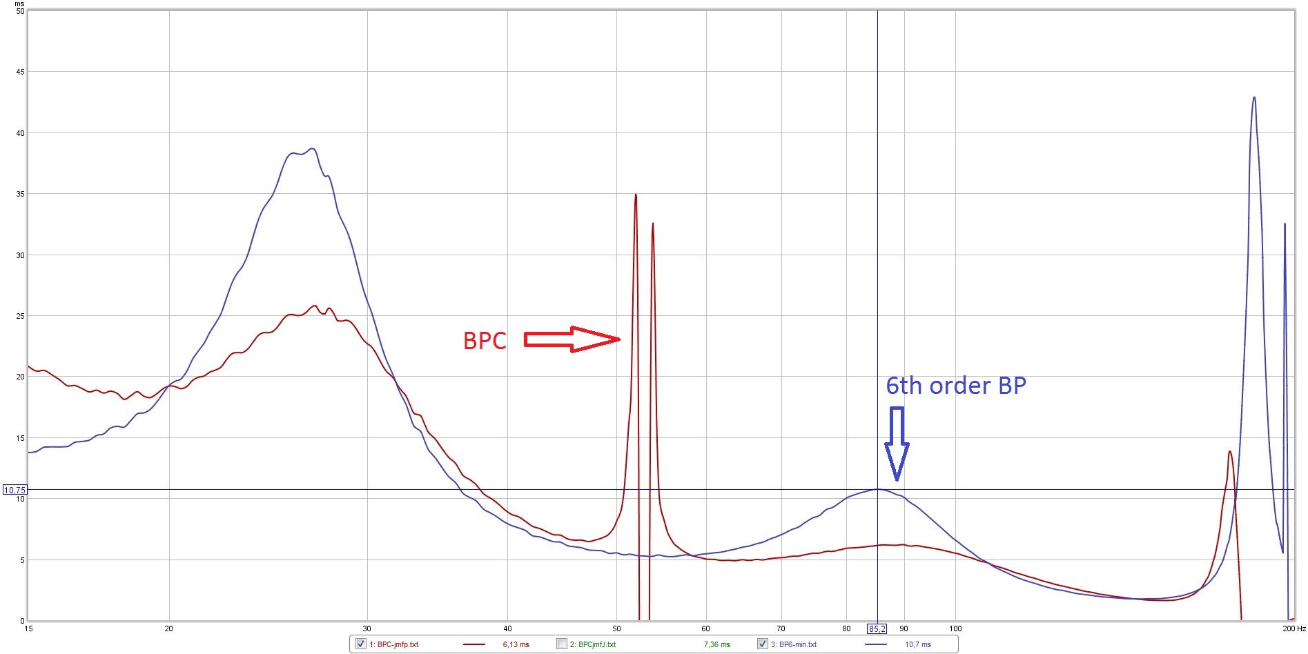

You call this "somewhat cleaner and smoother" yet you have a large high Q group delay peak in the middle of the passband and the internal port velocities have huge peaks in the middle of the passband.
I guess you have some kind of though behind this. I am all for improvements and I want to encourage people to better my designs. I am just a happy amateur with Hornresp on my computer and 50+ basshorn/tapped horn/bandpass builds behind me so I am sure most of my design can be improved upon in many ways.
But in this case I don´t understand what you are trying to achieve?!?
The spl curve of my 6th order series tuned BP is not an accident. I made it that way as it makes for a great sounding BP. I prefer a somewhat accentuated midbass peak bring some needed "life and vividness" back to the sound character to compensate for the with falling frequency increasing room gain profile of most listening rooms. Many simulated "flat" designs tend to sound to bottom heavy in a normal indoor listening environment, and 6h order BPs tend to exaggerate this "bottom heavy - lacking punch and drive" character even more. Add a large 18 inch driver into the mix and the 6th order BP playing bass indoors is almost guaranteed to sound overwhelmingly heavy and lacking punch and attack without these tricks.
Large internal ports that keeps air velocity low combined with a huge exit port that couples well to the listening space, a touch of positive acoustic and mechanic feedback and a somewhat accentuated midbass peak makes for a fun BP that sounds punchy with a great attack in my experience.

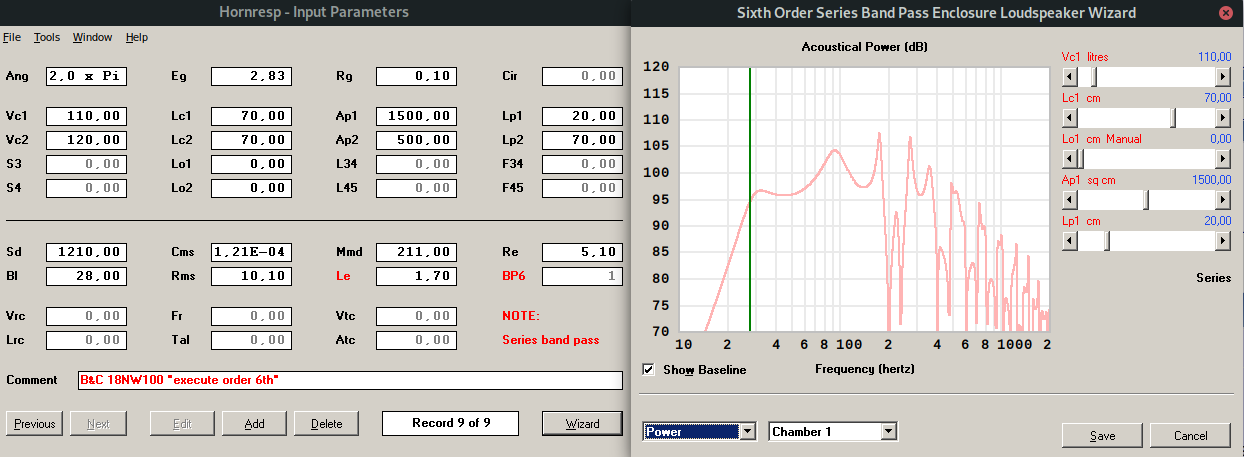

I tried to make a BPC more to my liking. This is my preferences and my ideas and not automatically better.

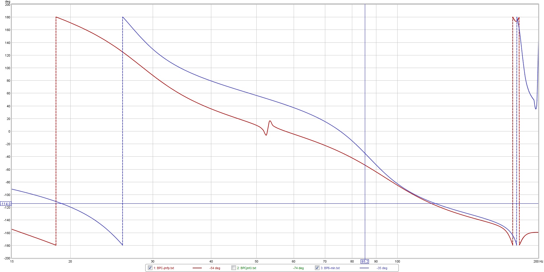

I don´t like the jagged kinks in the phase, GD and port velocity graphs. They indicates a messy mix of different responses trying to cooperate but not really having the ability to do that in a orderly and smooth way.
This problem will be exacerbated with increasing port velocities, nonlinear waveforms and hard real life use, and I have a parallel tuned 8th order BP that have a small kink in the GD and phase graph in the middle of the passband. It does sound really nice if crossed over below that kink, but it sounds horrible whenever allowed to play music around that frequency.

Why to add a "midbass peak" (at 90hz ?...) on a 25-90hz subwoofer. It make it somewhat impossible to crossover with mid-woofer way. Or it is a way to volontary add H2 distortion around 45hz ? This could be a really interesting effect, but it can be explained as simply as it, and that can explain your feelings. If one want to add nice H2 harmonics on subrange, there's others ways, and electronic ones that can be switched on/off.

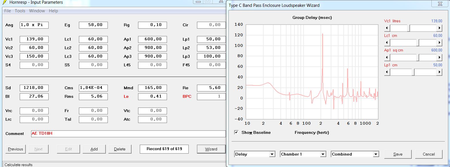

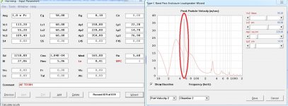

Yes, i did a 10 minutes weird design sim, just to play with hornresp . The reaaaally high Q peak comes from a funny tuning compensation tweak found unvoluntary between reflex chambers. I like this arrangement, and it work like a charm in this case. Easy to tune with simple plumber pipes, and very little stuffing in last chamber, this artifact can be nulled, it is easy to see playing with sliders in hornresp.
It is a design that allow build margin with 3 pipe that can be tuned (slot cannot be tuned easily), and need really little stuffing if not a all to be clean. Since we're discussing in this thread about bandpass boxes, it was only to show what bandpass out of band rejection can be expected with same size/spl, even at lower order (so lower group delay once substracted time delay involved). But of course, real bandpass involve low level of harmonic, and so lower effect.
There's no better, or worst. It is all matter of compromise. But it is wise to know what are the compromise.

About the peak, i already answered. In your design , the different path, as shown in spectrogram, don't even try to cooperate if i use your words
Come on, do you try to convince us that you have not any in room null and resonnance so that this become a bigger problem ? Or maybe you live in a mattress shop, but i become sarcastic, sorry, it is just that i feel you try to defend yourself as if you were attacked, while it is not at all the case. We're totally autorized to disagree, without need to mix everything to prove a point. And still, i agree, there's a peak on the sim "something that try to cooperate". This would be worrying, but it can be tuned to disapear, to make stuff "cooperating"/nulled.I have a parallel tuned 8th order BP that have a small kink in the GD and phase graph in the middle of the passband. It does sound really nice if crossed over below that kink, but it sounds horrible whenever allowed to play music around that frequency.
"Order" only define slope. The higher order, the slopper the slope, the more the group delay increase. In fact, higher order for sub is generally a compromise to get more efficiency, in exchange of size/bandwith/group delay.Large 18 inch driver into the mix and the 6th order BP playing bass indoors is almost guaranteed to sound overwhelmingly heavy and lacking punch and attack without these tricks.

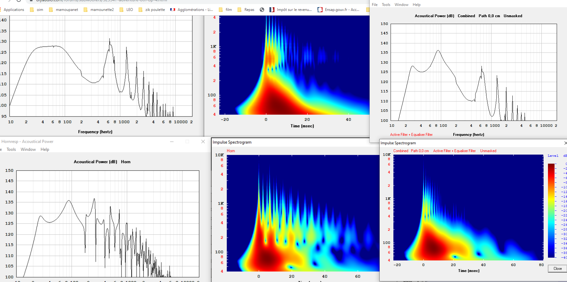

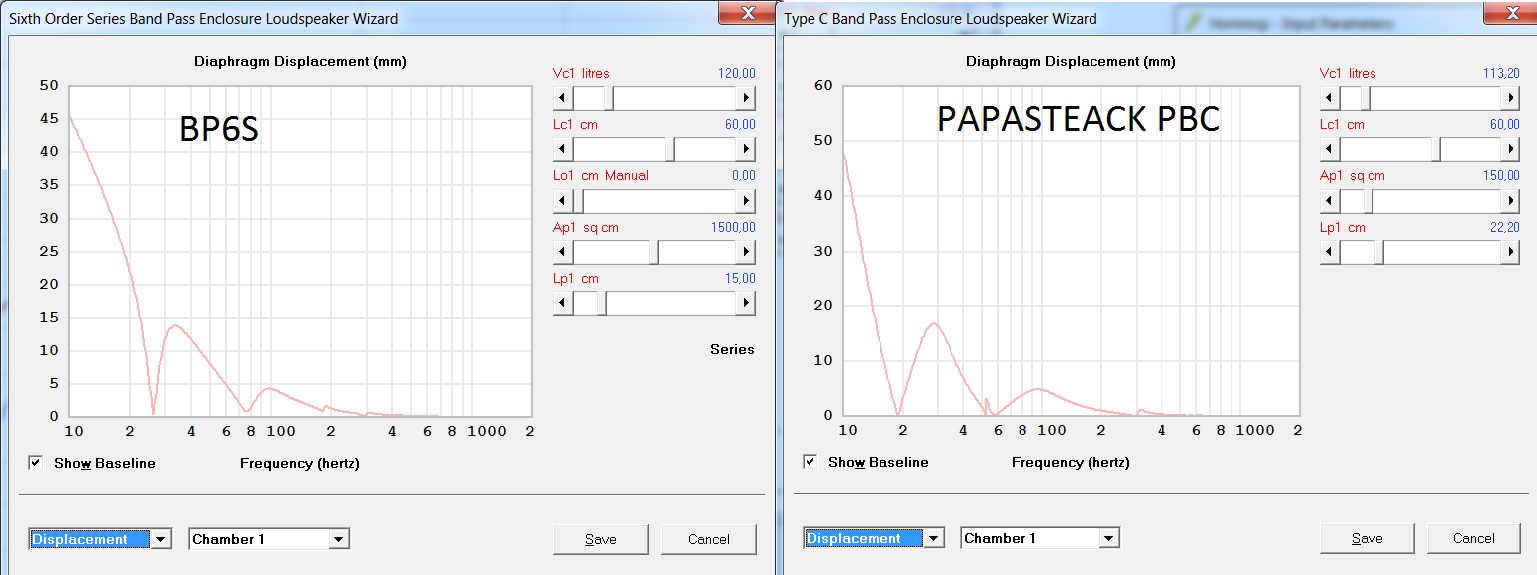

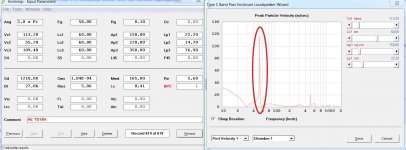

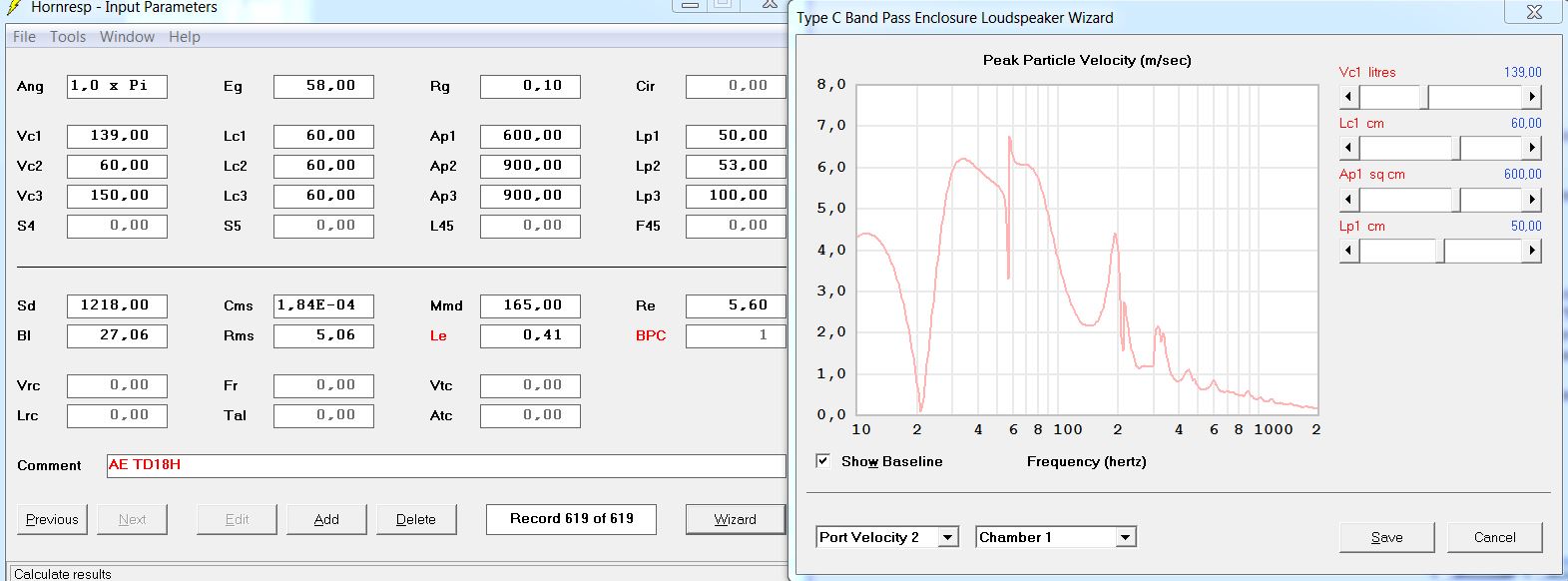

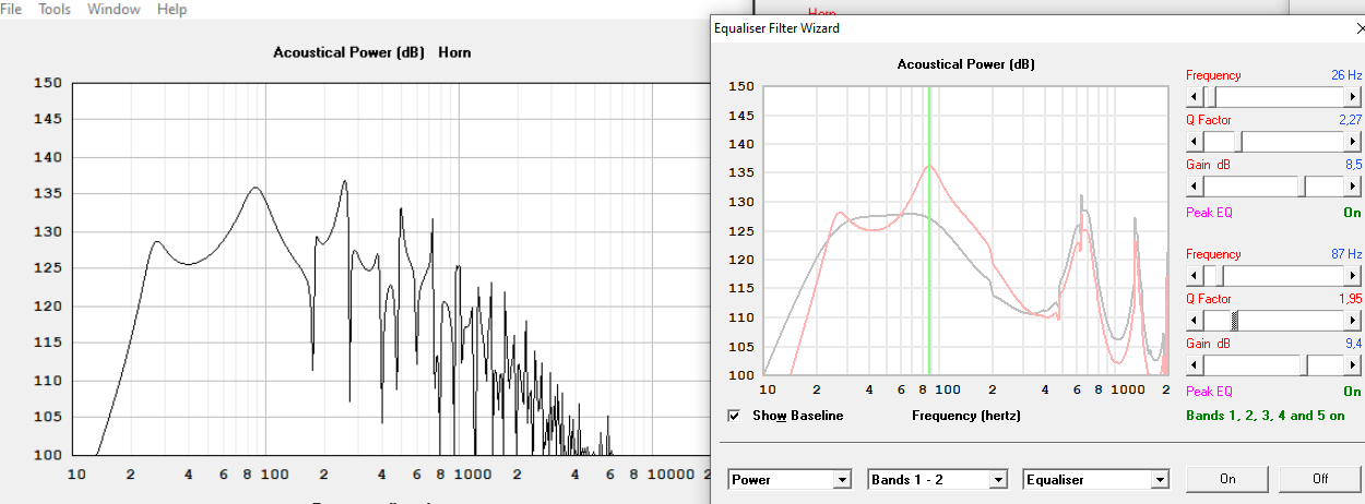

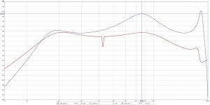

Just to show that it is all about EQ, it EQed my ugly sim, to the same response <150hz as Johannes sim. I did it with 1 high pass, 5 peak eq.
Picture 1 show before/after Equing the Front Loaded Dual Bass Reflex Chamber (FLDBRC) as Jonannes 6th (on the left).
Picture 2 is somewhat...hard...
Column 1, response of FLDBRC and Jonannes's 6th without EQ.
Column 2 their spectrogram.
Column 3, EQued FLDBRC <150hz as Jonannes's 6th, and it spectrogram.
So, EQuing => same result < 150 hz (the two spectrogram downward)....=> this mean same group delay of course.
>150 hz, the FLDBRC got more bandpass effect that reduce distortion.
This is all about EQuing...
About the "huge exit port that couples well to the listening space" that is non-sense, this is pressure variation at those frequencies. Room should be considered as part of the enclosure. From there, about "touch of positive acoustic and mechanic feedback" , the two "outputs" of the FLDBRC, or other 2 output design, can be blended as well in room.

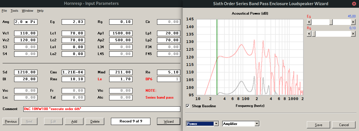

My 6th order BP is up to 7,3 dB more efficient at the very important mid bass centered around 80 Hz then your BPC.
I prefer to EQ away 7,3 dB in the mid bass where most of the energy is centered in modern music. All that power is better used where it is needed more (for example in the low end of the passband).
7,3 dB more output from roughly the same cone displacement in the mid bass translates into less distortion, less inter-modulation distortion and a subjective better sound quality. Once again considering that the energy content is centered around 80 Hz in modern music, then a 7,3 dB reduction of power will keep the voice coils much cooler or you can play a lot louder with the same level of thermal compression.

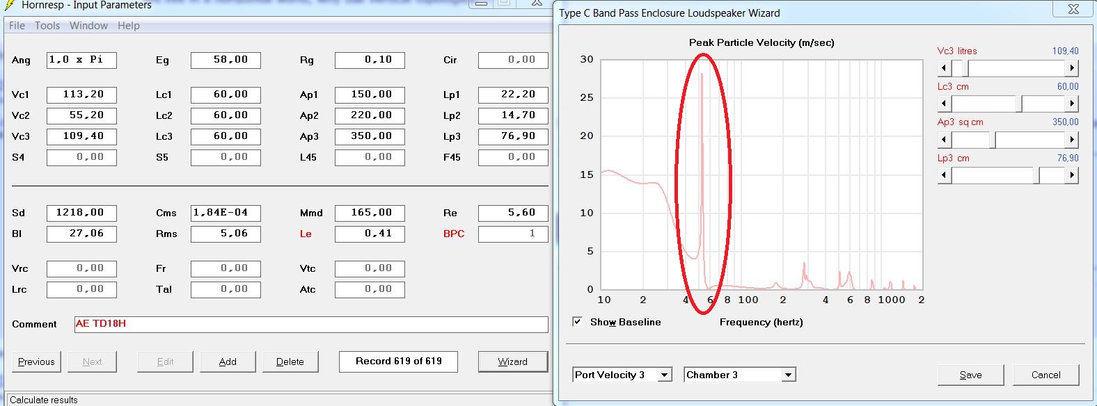

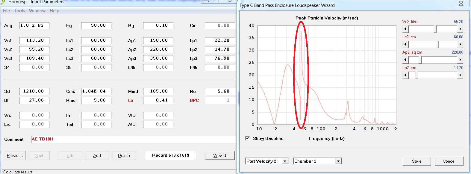

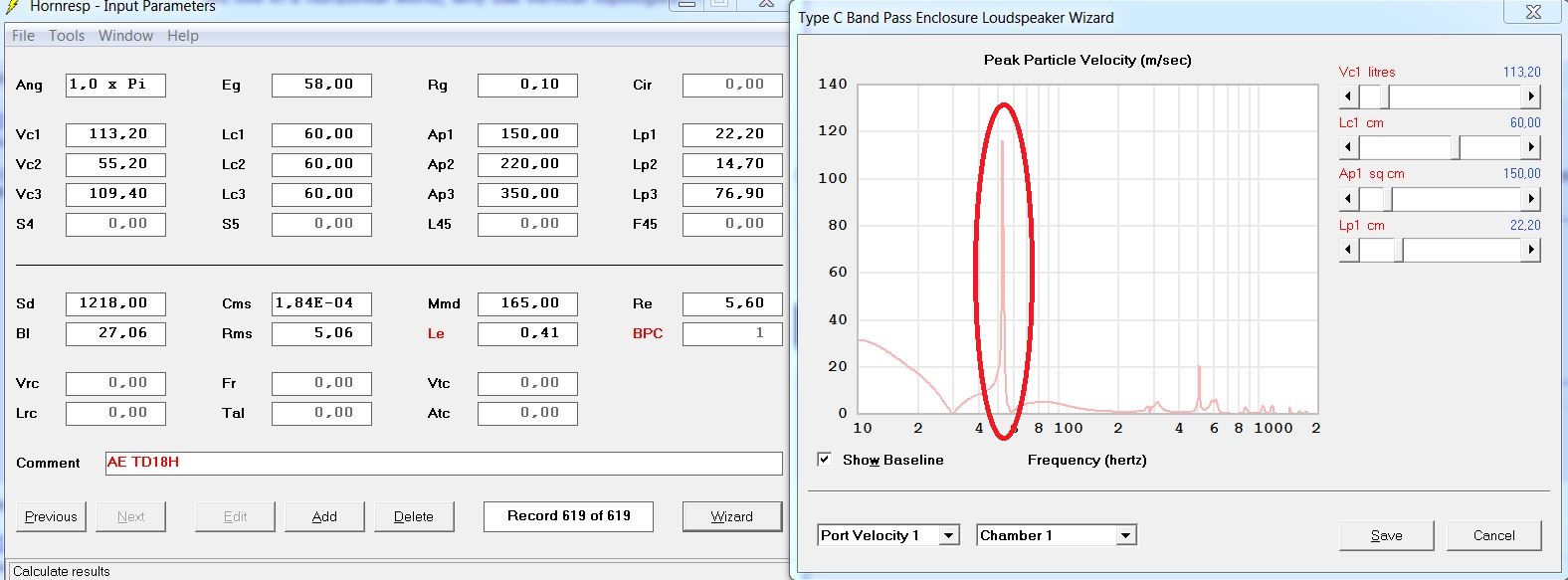

I have intentionally disregarded the 115 m/s peak in the port velocity graph, but I suspect that it will not add any positive contribution to the perceived sound quality of your design.

Of course, you got lower displacement, high pass slope (order) is not at all the same. I pretty agree. And don't forget that i do not say my design is better. I just used it as example of bandpass rejection effect, and i should add, better damped response.
About the bump, I can admit this is can be a good idea on paper, if suitable crossover is doable. But as show in post #50, it gives lagging response at the concerned frequency, a typical underdamped response.
About the peak at 115m/s, it's a kind of artefact on 1-2hz large bandwith. It can need tuning if one want to build something like this. And we cannot add damping in hornresp in bandpass wizard to damp the sim. This design is just a crash test to question yours about compromises dones.
I was talking about phase/group delay.
Sharp high Q kinks in the phase and GD response is often more detrimental to SQ then soft low Q peaks (in my experience).
I know you can flatten these curves in Hornresp with careful adjustment of the port lengths. But in real life where port compression and turbulence changes the tuning in a nonlinear amplitude dependent manner this problems will be very audible.
Forget about my stupid sim. I was just trying to figure why you choosed this kind of response, while you know well how to play hornresp. You've answered. No offense. The biggest point of you design is it folding. If it work as it sim, it's really interesting. Personally I prefer having tweaking margin for building with port and lower order but this is just my own preference of compromises. I'll build a 35-150hz sub with the shown topology, but this is probably not before next summer. We should see how it turns about this peak that worry you so much. Nulling and damping is exactly what TL design are about. This works fine. And port compression/turbulence s can be really well limited with curved input/output. In fact hornresp yet suppose one of the two port is somewhat flared (I expect David not to come to say I didn't understand ! ^^). In hornresp this "End correction" explain the variation of a enclosure simed with bandpass wizard compared to when simed as multi segment design.

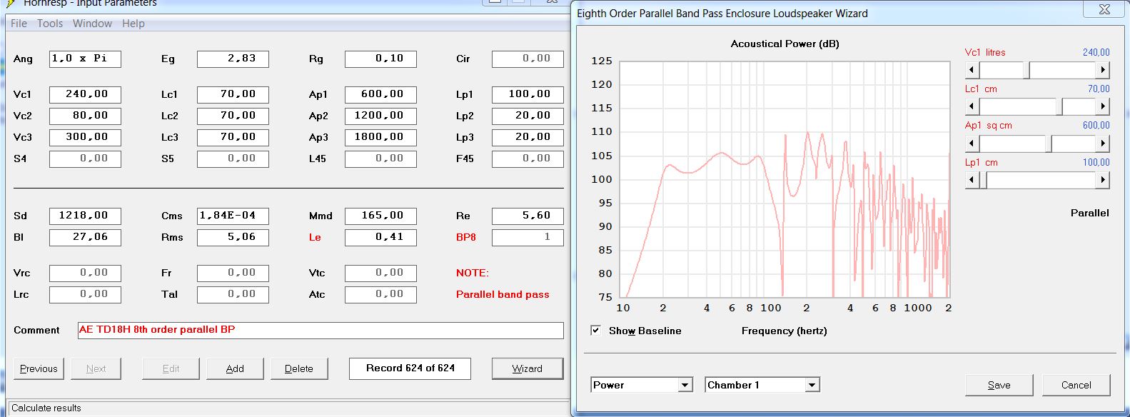

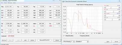

This is the reason I would not recommend the AE TD18H in an 8th order BP.
Even though this might be quite fun once built!!!

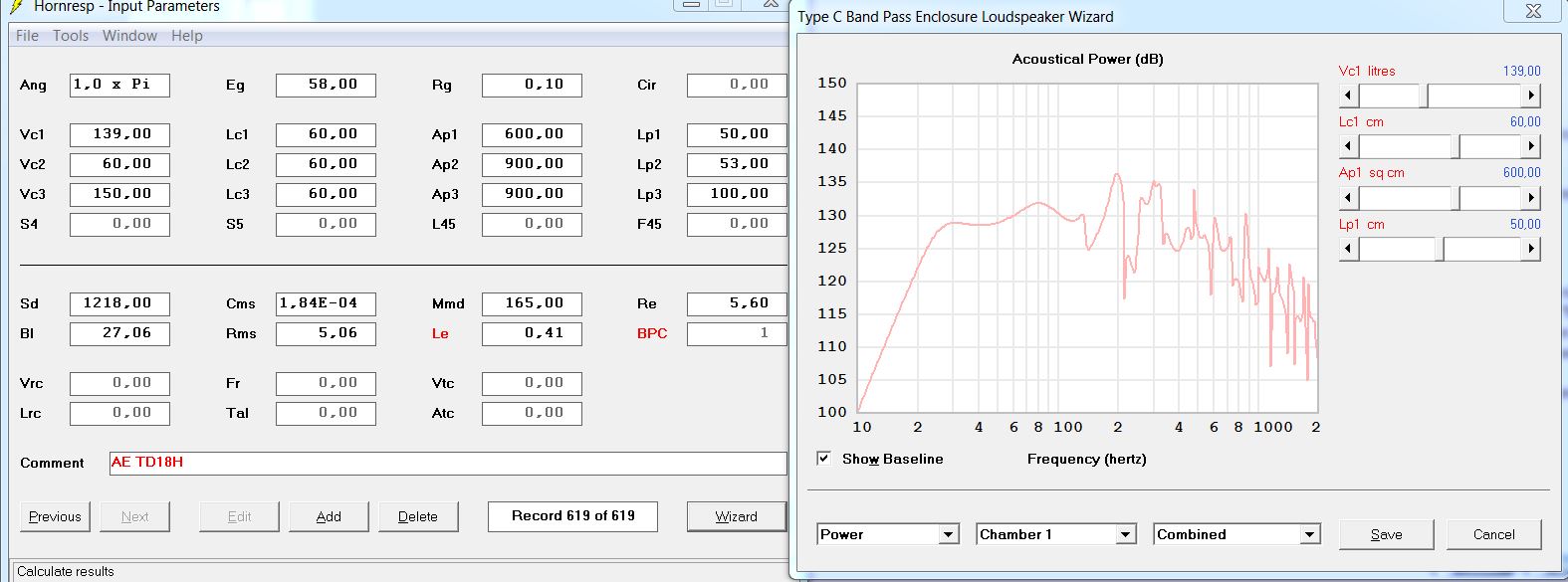

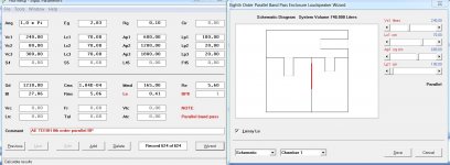

This is not optimized in any way. It is a fast and not thought through example of what range of enclosure sizes we are talking about.
If built out of 36 mm birch plywood with lots of bracing (to keep the huge panels reasonably stiff) then I guess we are looking at something quite close to a cubic meter.
A very fun and capable home theater sub if someone has the space and love buying birch plywood in bulk.
