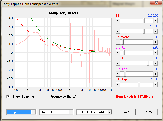

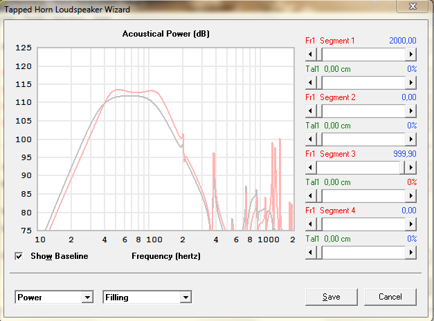

I didn't save the svs sim, but just look at this sim : the same kind of loading, the same amount of stuffing, no matter how you call it, with/without damping, it keep 40hz at 110db in this case. But group delay became really good, and excursion better controlled...
Bjorno has posted here about this subject some years ago, adding damping to get low Q. Personnally, i just add extra neo magnet around ferrite to lower QES.

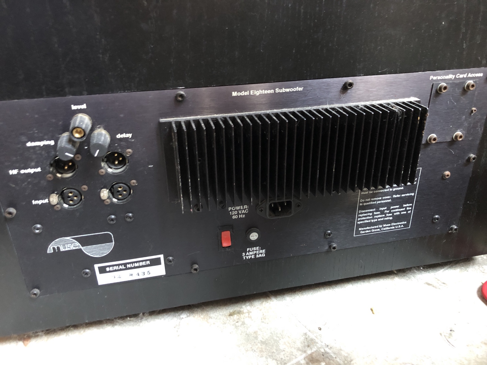

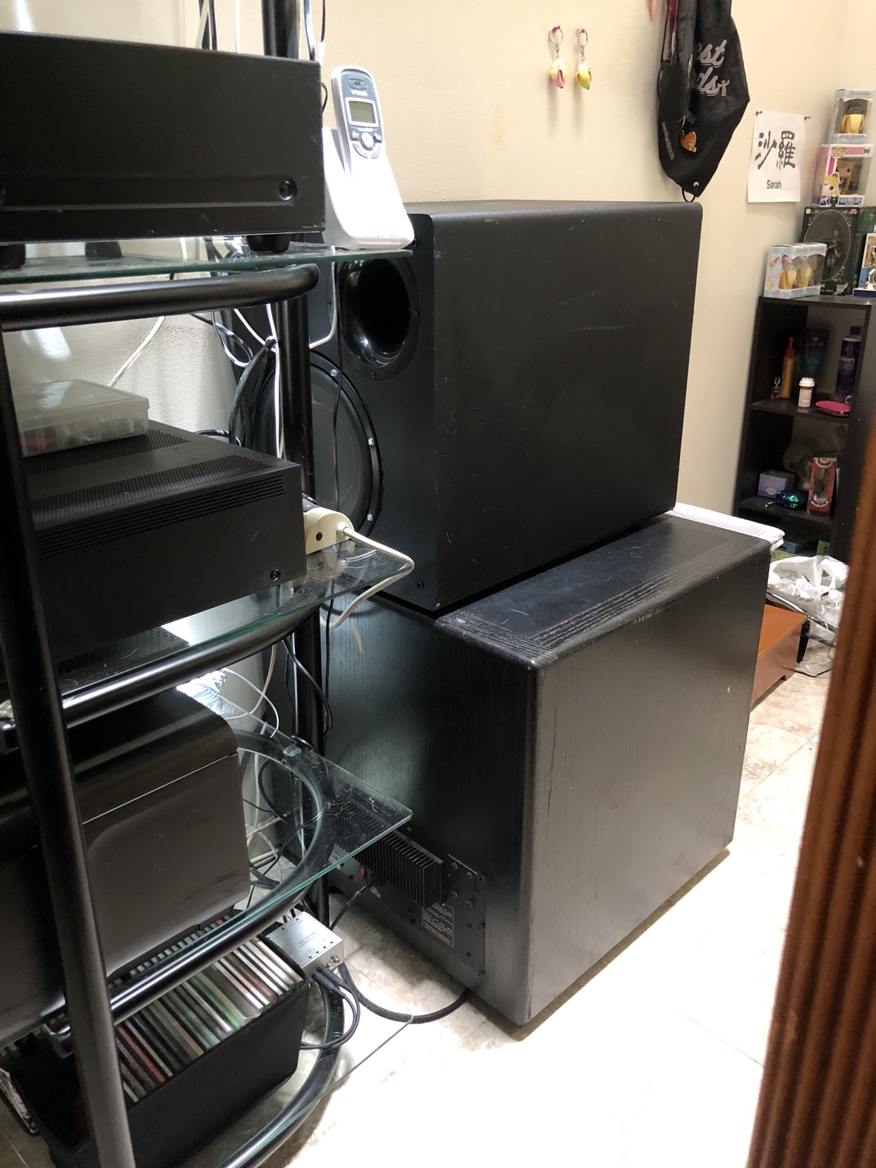

Have any of you seen the muse model18 sub? It’s a 6th order bandpass box. It’s very large at something like 26”x26”x26 and 155lbs. I have one here in my house and really don’t use it much. Something wrong with the amp. When I turn it off it makes some very nasty pops and crackle sound
Is the muse anything like what you guys are talking about?
It’s the one on the bottom, the top is a SVS 12” ported model. A very old sub
View attachment 694250View attachment 694251
Dual reflex and triple-reflex bandpass boxes were protected by a Bose patent for as long as I can remember.
Due to this, most of them are Bose.
The Muse Model 18 is a slot loaded sub box, as the pics above illustrate. It's two 10" woofers firing into a slot.

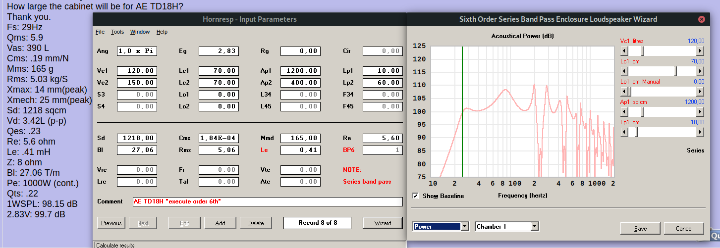

How large the cabinet will be for AE TD18H?
Thank you.
Fs: 29Hz
Qms: 5.9
Vas: 390 L
Cms: .19 mm/N
Mms: 165 g
Rms: 5.03 kg/S
Xmax: 14 mm(peak)
Xmech: 25 mm(peak)
Sd: 1218 sqcm
Vd: 3.42L (p-p)
Qes: .23
Re: 5.6 ohm
Le: .41 mH
Z: 8 ohm
Bl: 27.06 T/m
Pe: 1000W (cont.)
Qts: .22
1WSPL: 98.15 dB
2.83V: 99.7 dB
I would not build an 8th order BP due to the large VAS, low Mms and Qts and high Bl (all indicating a very high efficiency driver). A series tuned 6th order gets a large enough bandwidth and high enough efficiency in a slightly more usable box size.

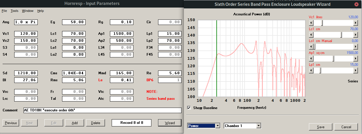

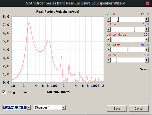

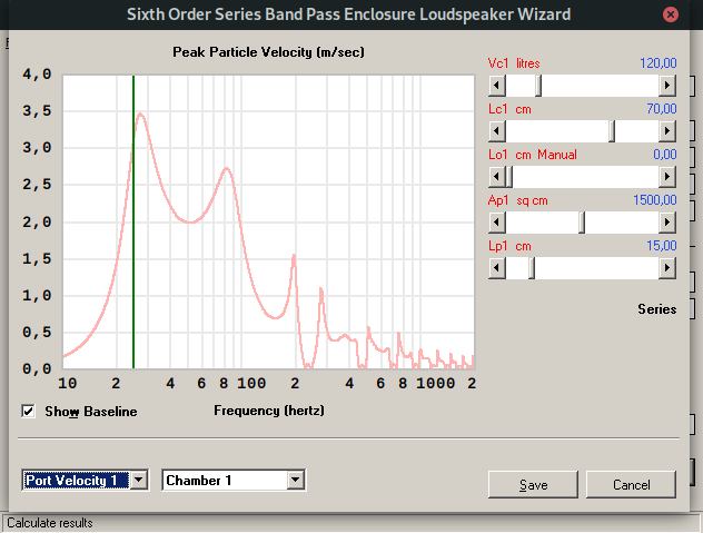

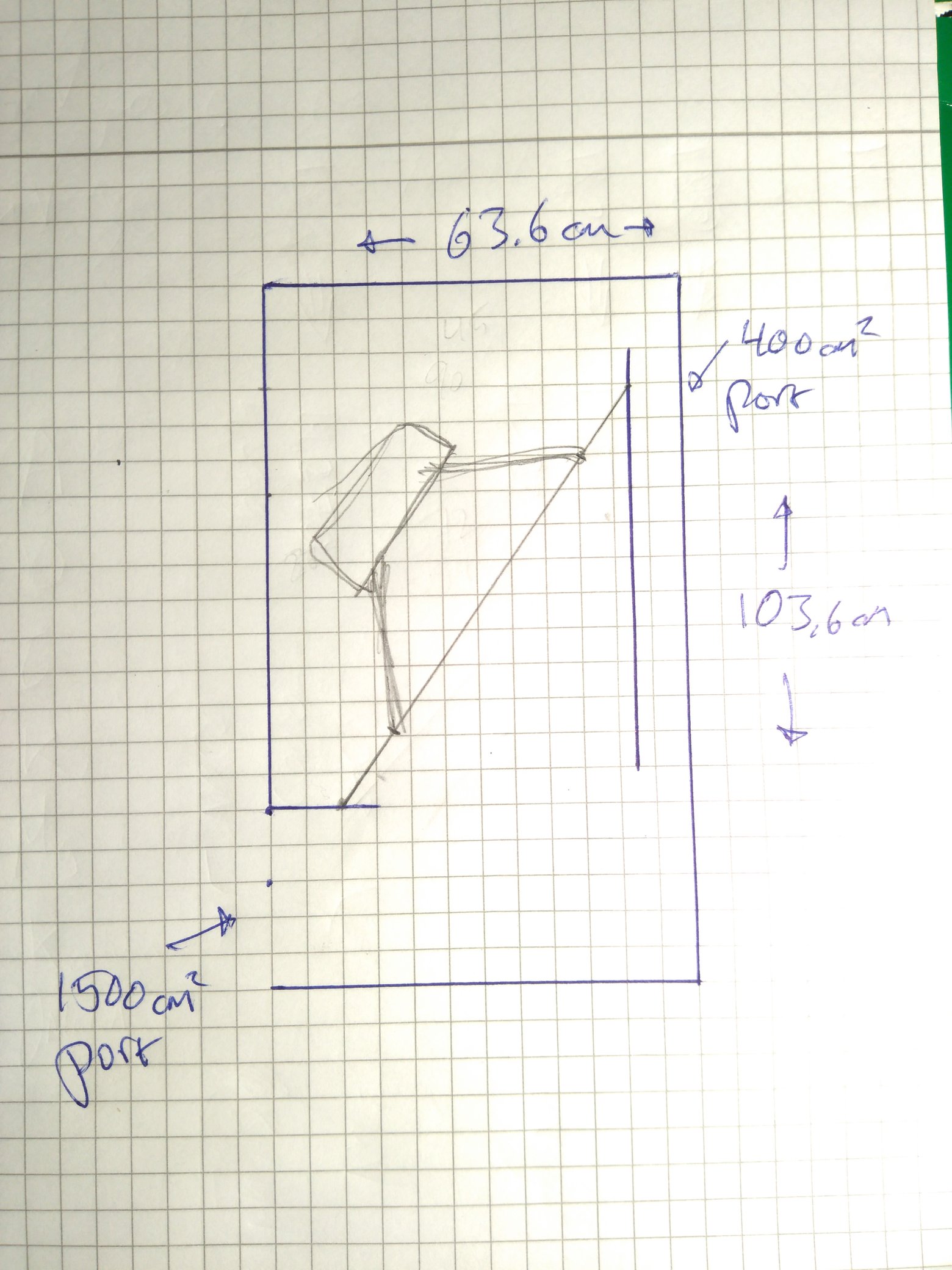

With a slightly larger exit port you gain some efficiency in the upper part of the passband and lower port velocity at high spl. I have optimized the spl response for indoor use where the slowly falling response down to 25 Hz will interact with the typical room gain profile to create a more flat total in-room response.

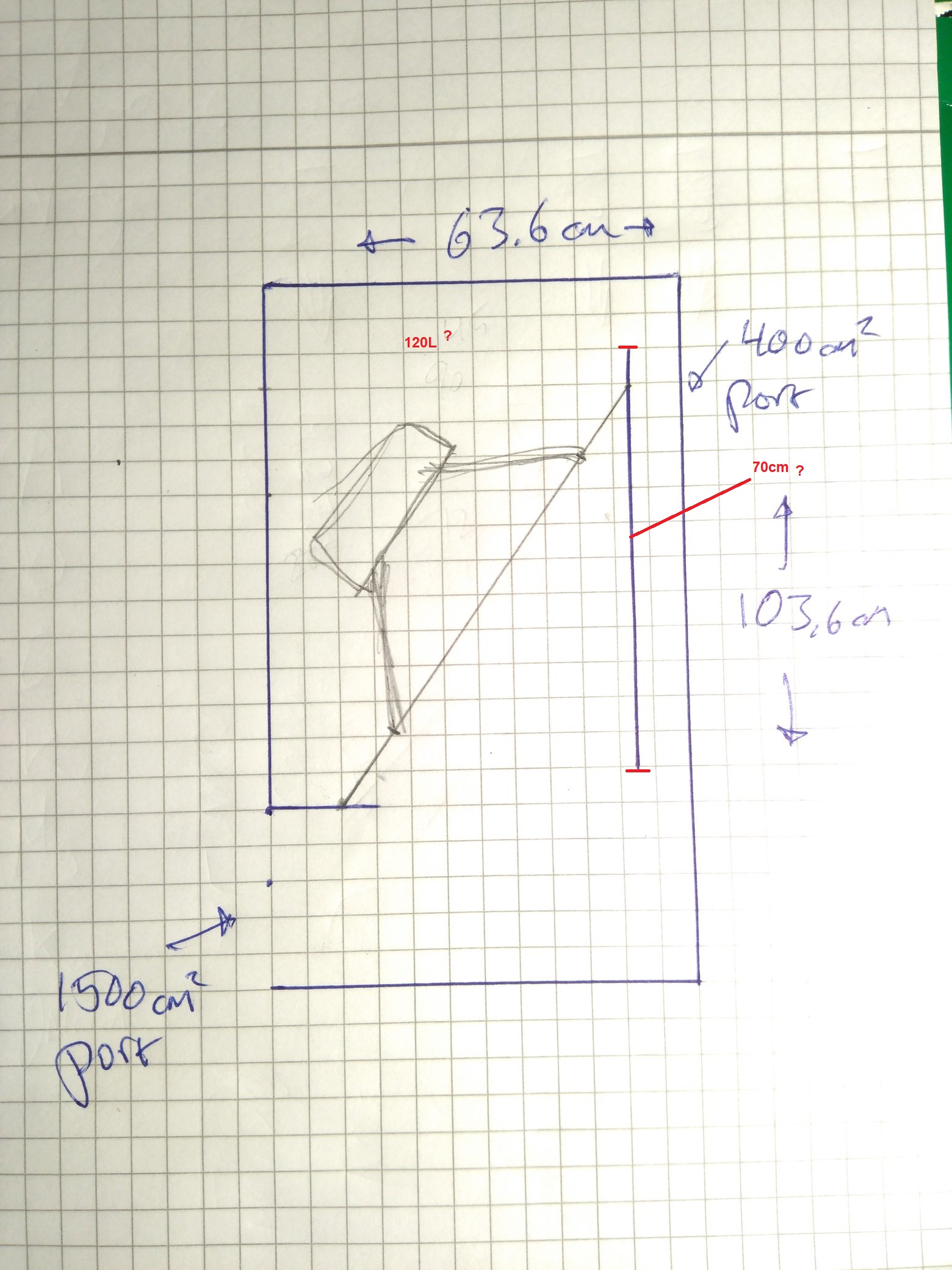

103,6 x 63,6 x 63,6 cm outer dimensions if built out of 18 mm plywood.

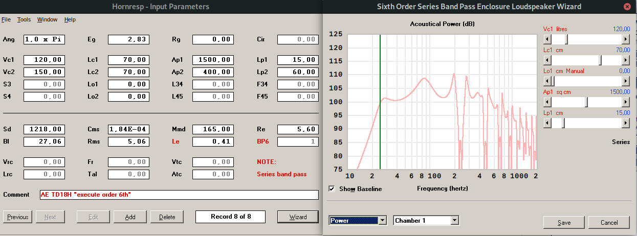

With 30 volts from the amp (112,5 watt nominal into 8 ohm) the internal port reaches 10 m/s at 25 Hz and the exit port reaches 3,5 m/s, al while it does play a solid 120+ dB from 25 Hz and up indoors. Add 3 - 6 dB room gain in the lower end of the passband.

Thank you Circlomanen. I was looking for bass solution for this driver lo-o-ong time.
This is exactly what I'm looking for!

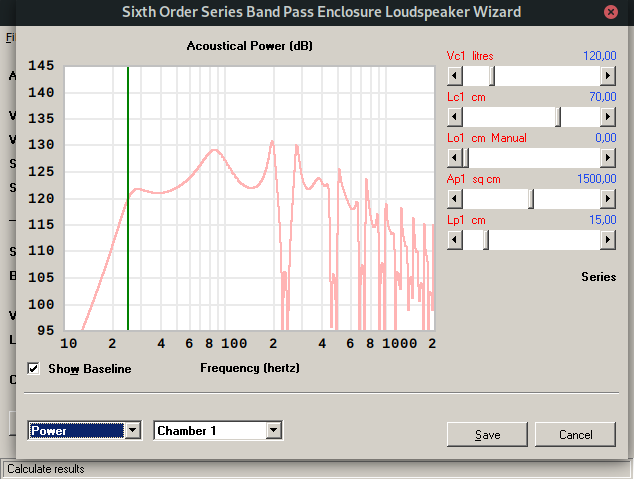

What frequency range would you suggest - 25-90hz?
Is those red marks correct?

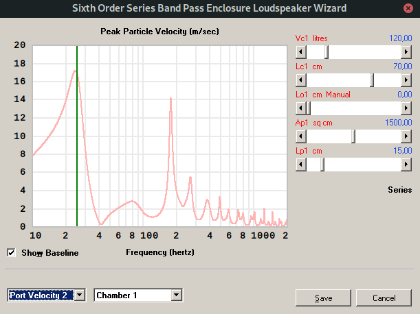

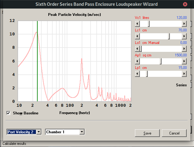

Usable frequency range is 25 - 90 Hz. The first chamber is not 120 liters. It is 150 liters large. The 120 liter is the chamber directly connecting to the large 1500 cm2 exit port.
The first small 400 cm2 cross section area port is 60 cm long in my simulation. You can make it 500 cm2 cross section area and 70 cm long if you want to keep the port velocity as low as reasonable possible at high spl. It does not change the simulated response, but it lowers the port velocity from 20 m/s to 17 m/s at driver xmax. Both are acceptable for an inner port terminating into a chamber. You should make a 10 mm radius with a router on the edges of the port ends. This will lower the amount of turbulence substantially at high power levels.
Max power level 58 volt (nominal 420 watts into 8 ohm) and driver xmax. Port velocity is reasonable low.

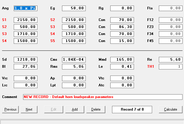

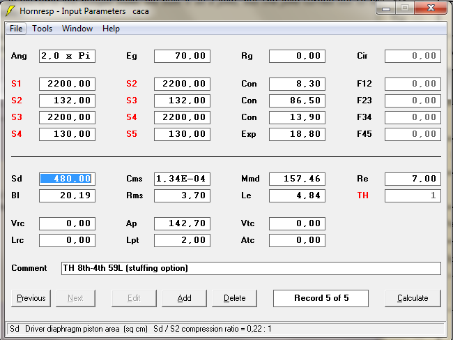

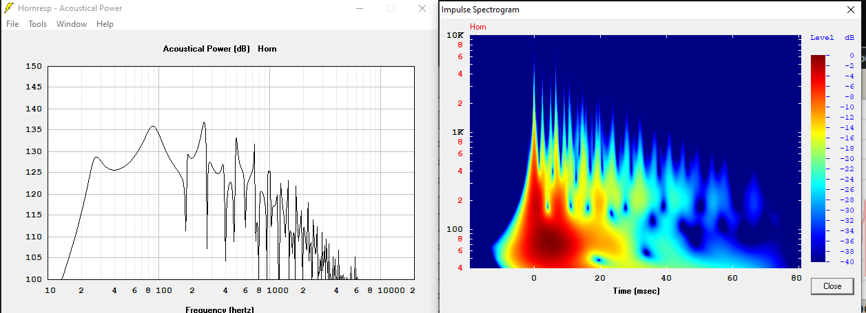

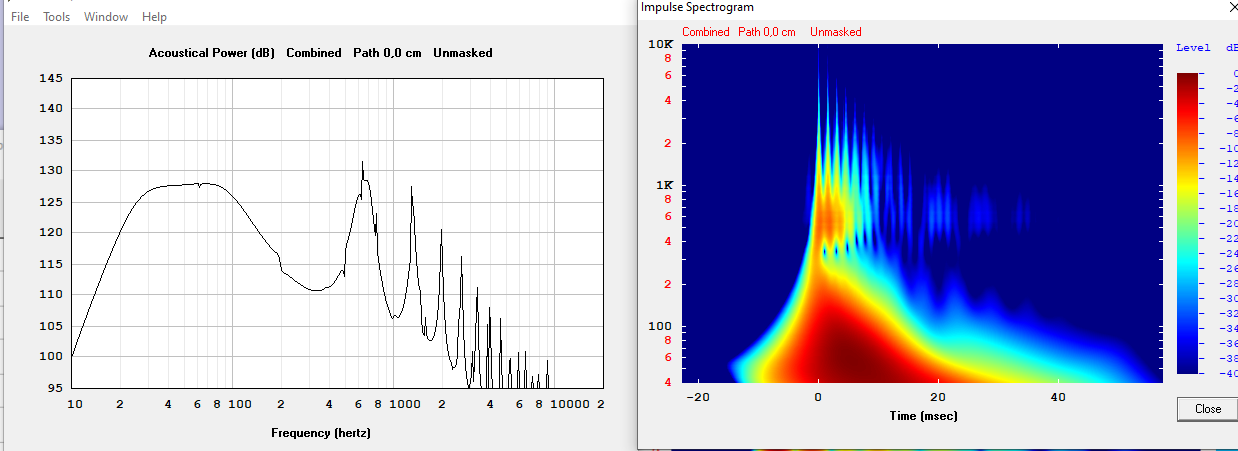

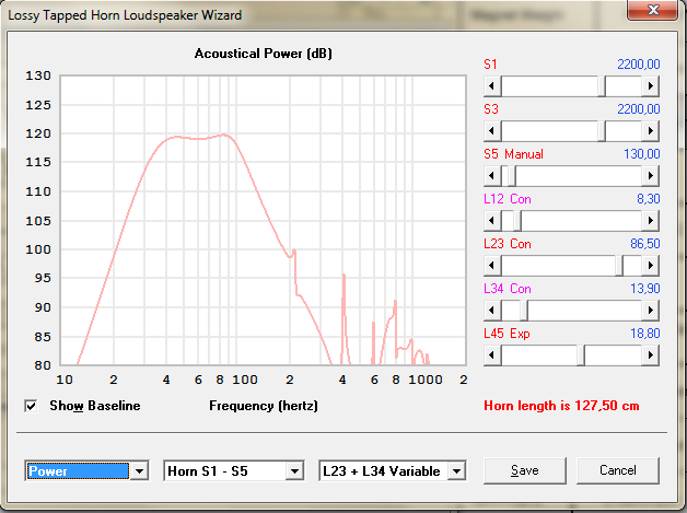

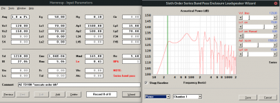

1/2 Simed as TH so hornresp can show impulse & spectrogram.
EDIT : since i had 10 minutes playing with hornresp 🙂

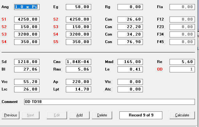

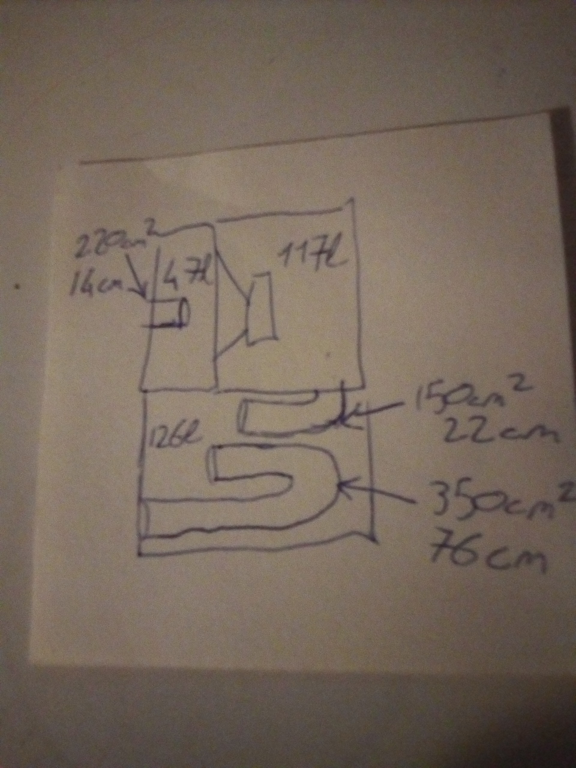

3/4 A front bandpass, with two back reflex chamber...+/- same bandwith, +/- same size, somewhat cleaner and smoother. Max internal port velocity 16m/s. Simed as OD, but can be simed as BPC in hornresp to tweak vent velocities.
