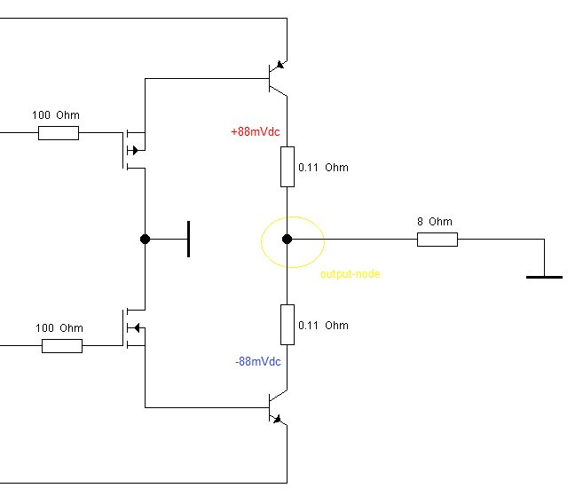

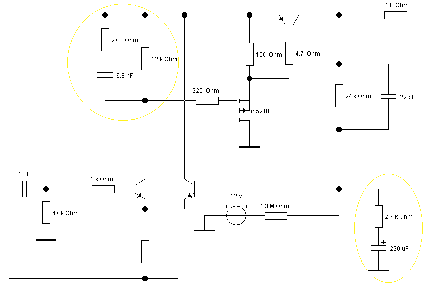

Modifications, changes in comparison with the original:
The
If I scale the posted distortion spectra and compare them with my current measurements of the current original, the modification and incarnation of "the Babelfish A1 Zen Master" is unfortunately not a bit better.
Is it perhaps more reliable?
HBt.
The
- "level shifter and impedance converter" has been replaced by a HEX-FET
- two fixed-voltage regulators replaced two Z-diodes with their series resistors
- sensor resistance (let's just call it that for a moment) was reduced from 0.47Ohm (max) to 0.11Ohm
- negative feedback was significantly increased
- "slow and ancient power transistors" were replaced with modern and very fast sprinters !
HBt.

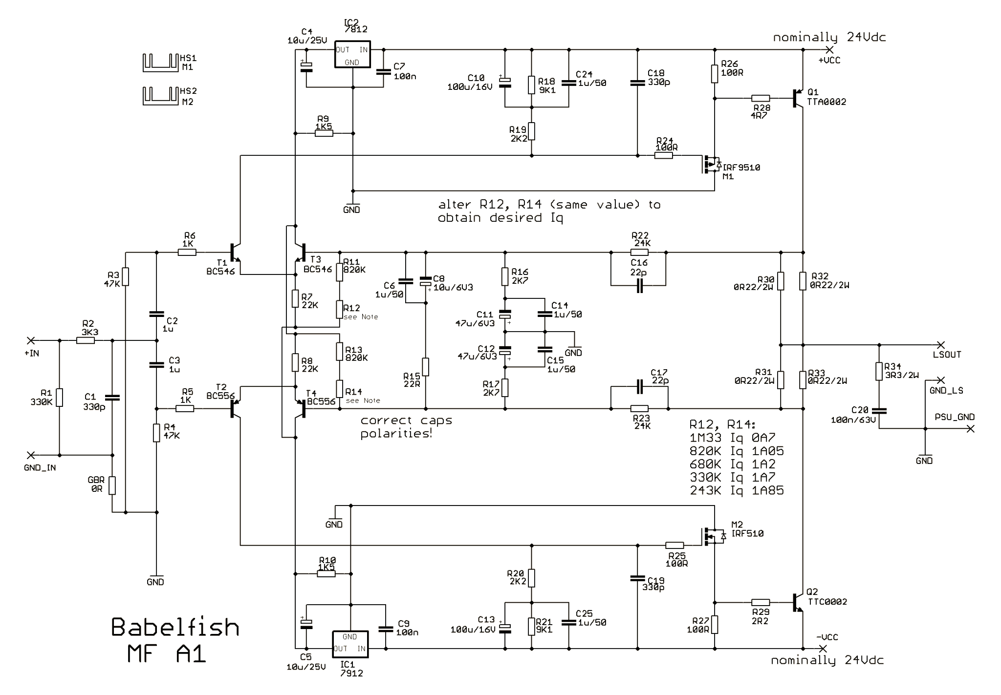

An Overview
of the current amplifier, an original, with the TL072 preamplifier ..!
I would like to add something interesting,
with this MF-A1 you /we can calculate the distortion factor and approximate it fairly accurately with a power function.
THD(%) as a function of P(W_rms) at Rload=8Ohm
= 1.285386*10^-2 * P^1.043256
THD(%) as a function of I(mA_rms) - loadcurrent
= 6.155162*10^-8 * I^2.087275

The power supply unit is only capable of delivering a maximum of approx. 1.6Arms loadcurrent in steady state.
One must never forget what the core of the A1 actually is, including two single-ended amplifiers working against each other ... dynamically they work in parallel, i.e. in push-pull.
If we are really honest, we have to admit that the circuit is "extremely strange". Basically one big design flaw! In terms of DC, you could even call it a ******-up voltage regulator.
Nevertheless, there is a splendid ingenuity in the whole construction.
This thing is crazy, isn't it?

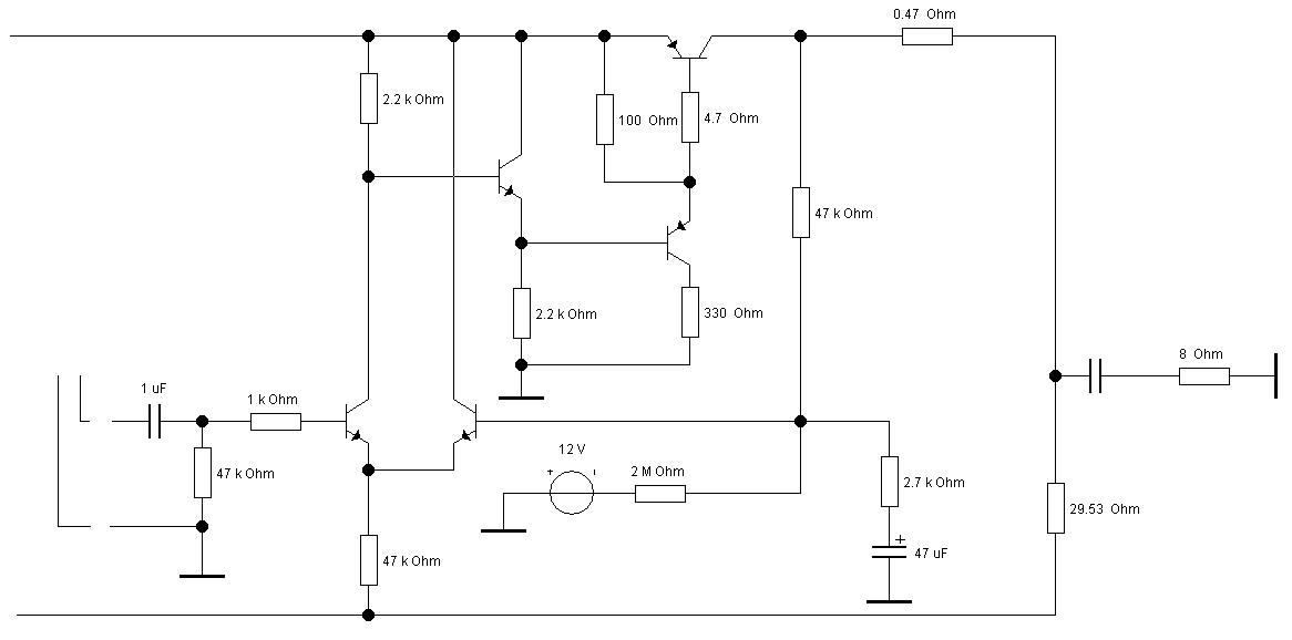

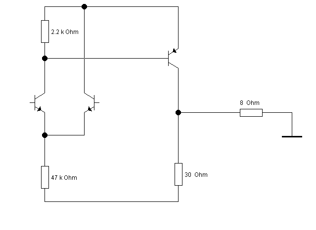

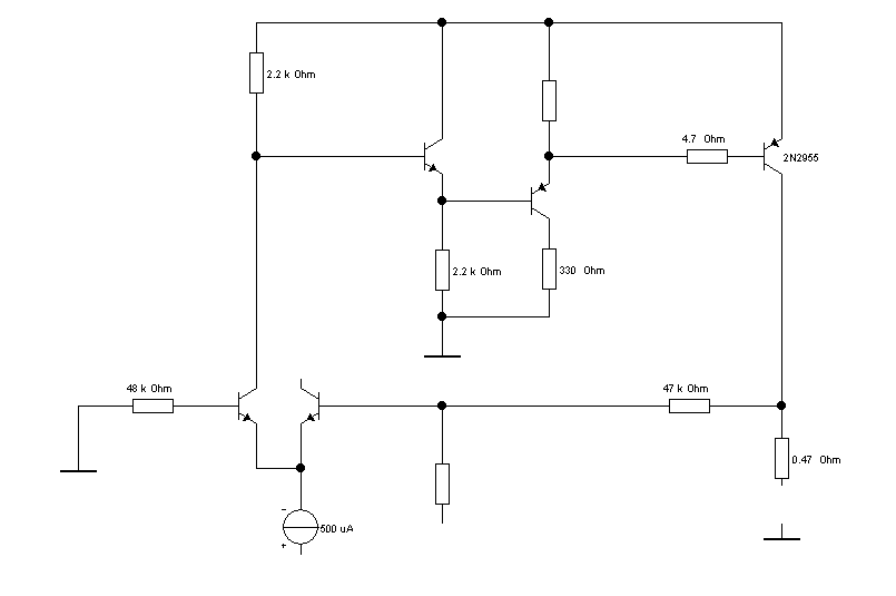

Let's look at the core and note that a meaningful output stage (EF2 or EF3) is completely missing. The present two-stage VAS will bring more problems (as a power amplifier) than solutions.
This idea can only work as a class A representative with really large quiescent currents. At the moment, a quiescent current of more than 2.25Adc would have to flow permanently in order to be able to supply the propagated 20Wrms to static 8Ohm loads.
Unfortunately, this crazy idea does not work without an active counterpart to replace the passive 30 Ohm resistor.
Without the impedance-converting level shifter between the IP and the VAS-OP stage, the principle outlined above with the specified resistance values will not work anyway.

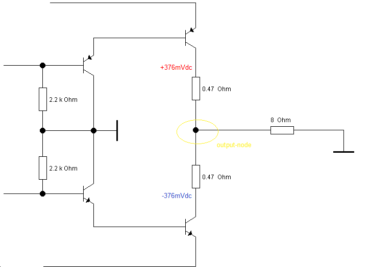

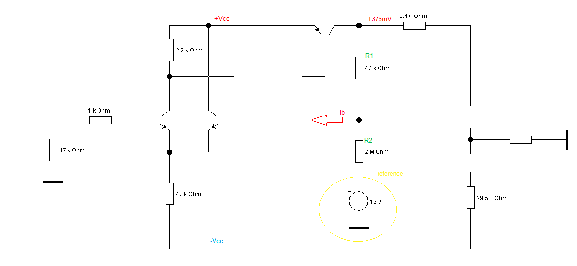

A deliberately created DC offset!
If we were now to short-circuit the quasi-voltage regulator with the static internal resistance of 0.47Ohm and an original /source voltage of 376mV, i.e. connect the output to the zero-volt potential, we would have a largely constant current flow of 0.8Adc.
The quiescent current of the original MF-A1. Unfortunately, we have to create a virtual short circuit (with our active opponent) at the output-node.
R2 without Ib (i.e. equal to zero) is exactly 1.5MOhm. Unfortunately, we never know Ib and Ib is not constant either ...
If we are not very careful, the output stage of the (two-stage, total) VAS will conduct beyond all intended limits.
Danger!
Our DC offset control circuit (R1 & R2 - loop) must function immediately under all circumstances.
Zen-Masters 1. Mod:
Nothing will happen here on its own, nothing at first! Unfortunately, this modification does not change the actual crux of the entire circuit, i.e. the two-stage VAS concept remains untouched - with all its disadvantages.
Break ...

We should close and open the ac nfb loop.
OLG is approx +47dB, in closed loop it is +24dB as voltage-gain. Can the counterpart, the second SE amplifier so to speak, improve the situation?

Let's compare the scenario with the modification proposed by the "Zen Master" !
CLG approx +19.2dB and OLG approx +43dB
43 - 19.2 = 23.8
vs.
47 - 24 = 23 !
There is no significant improvement whatsoever - only the impedance converter (and level shifter) is fundamentally different. It is single-stage (as a source follower) and not self-conducting.
However, the longitudinal element is now (still to be replaced by) a 30MHz ft BJT instead of the usual <3MHz boys - that scores a few points.
Now we should take a closer look at h11e, h12e, h21e and h22e - but one thing is already certain, the use of a HEX-FET promises no advantages in terms of THD response and distortion spectrum. What we need is a much larger OLG!
HBt.
43 - 19.2 = 23.8
vs.
47 - 24 = 23 !
HBt.
Without the 101µF ac-short cap ---> OLG approx +56dB and fh' is about 22kHz.
