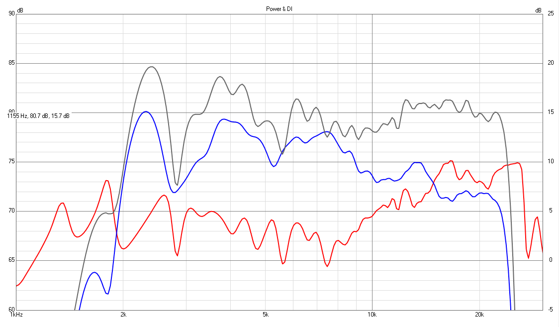

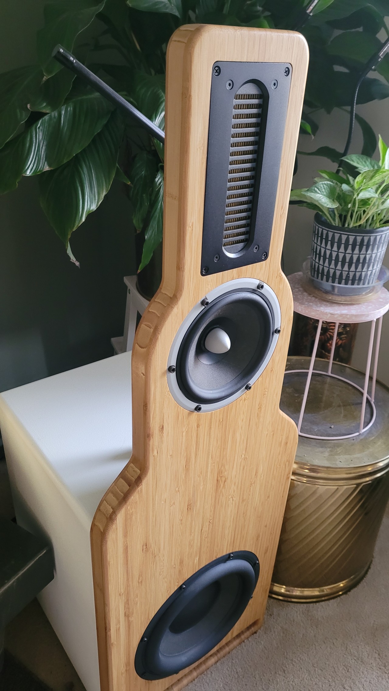

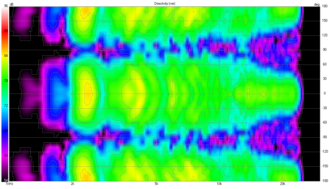

Just want to contribute my own measurements. I am using AMTPRO-4 in a dipole arrangement, and have a complete set of measurements at 15deg increments with no felt applied to the back side. Photo below of the speaker baffle the AMT is mounted on.
The AMTPRO is a capable tweeter, but unfortunately due to the size and shape it has a confusing directivity pattern - very wide horizontal and very narrow vertical. I think it gets the "pro" name simply because the directivity dictates that the ideal listening distance is further away than what would be present in most home living rooms. More of a "sit and listen" type of speaker at home, and in my space I am able to keep 3m+ distance from speaker to couch, but the top end is still like a laser beam. The only correction to this is to add another tweeter crossed at 6kHz or so. In my case, I am using some DSP to shape the response and keep some of the on-axis lift in the response in order to partially compensate for the directivity.
The good news is that the wide horizontal pattern contributes to a decent overall in-room response and power response, and it can sound very good, but misses some of that top end "air" that you get from smaller tweeters. I have a crossover around 1.5kHz to a Peerless 830883, and some DSP EQ applied to fine tune to satisfaction.

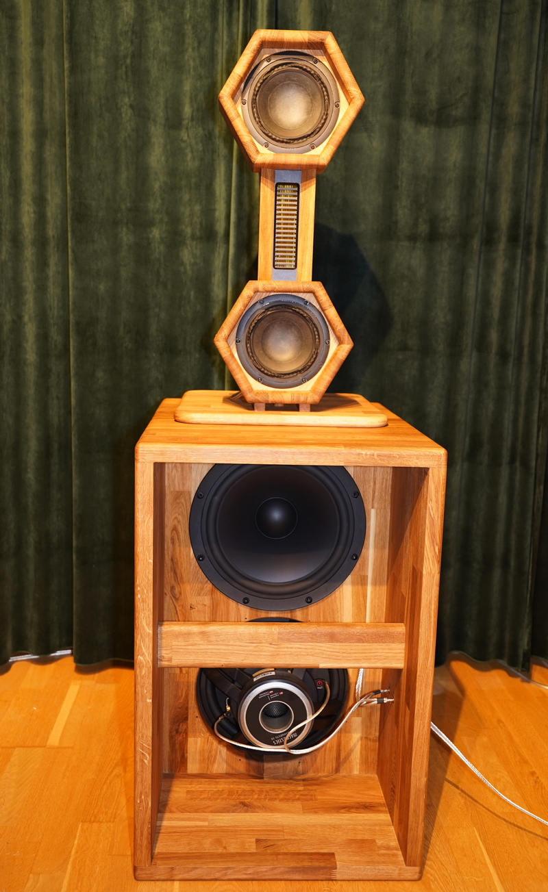

This is how full speaker looks. Bass section is also H-frame with dipole cancellation compensation.

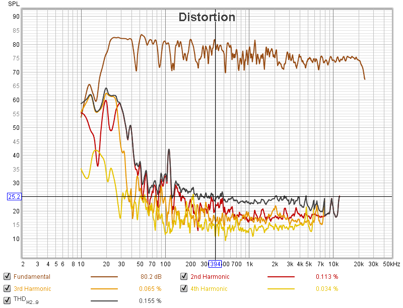

Preliminary THD measurements from listening position also, actual level is higher, little below 90dB, I had not calibrated the SPL level.
The woofers aren't compensated, they are wired parallel, so neither the impulse (they go in the same direction) nor asymmetric in/out behaviour (only works on isobar coupling (which they aren't) of two 180° drivers).
That looks very good. What's the max spl?
No, that's not right. In the bass, the ear is so much less sensitive to distortion, the distortion can be much higher there without it being noticable. And that measurement does not answer the question since the distortion does not rise linear at all, there will be ranges where it will be higher and others hardly increase. Though, you don't have to measure the max level but an increase of 6 or 10dB shows a very clear tendencies and allow a good estimate when comparing the measurements.
Actually when I increase SPL level THD will fall, this is because mostly THD in last measurement is defined by room noise, measurement is made from listening position. I cannot increase SPL level very much as bass amplifier will clip, because +20 dB compensation EQ on low end.

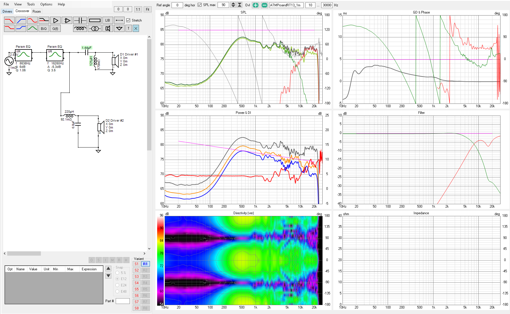

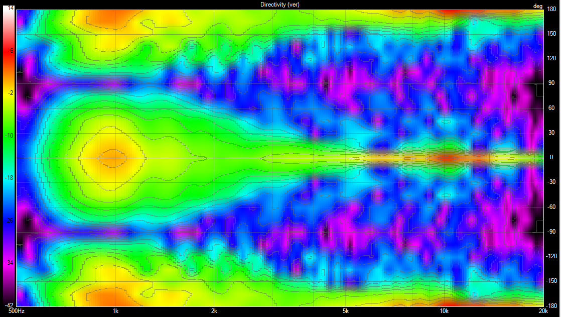

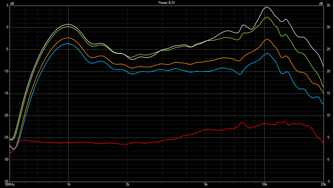

I get small open back version of ATM named as RT13, by label produced at Plat Audio. Overall outside measurements 40x40 mm, radiation opening on both sides is 20x20 mm.
Plan is to use it as super tweeter for AMTPRO4. Only as my DAC had 3 stereo channels, I must use passive filters.
On measurements peak on 16260 Hz is EQ-ed down by 5.3 dB.
